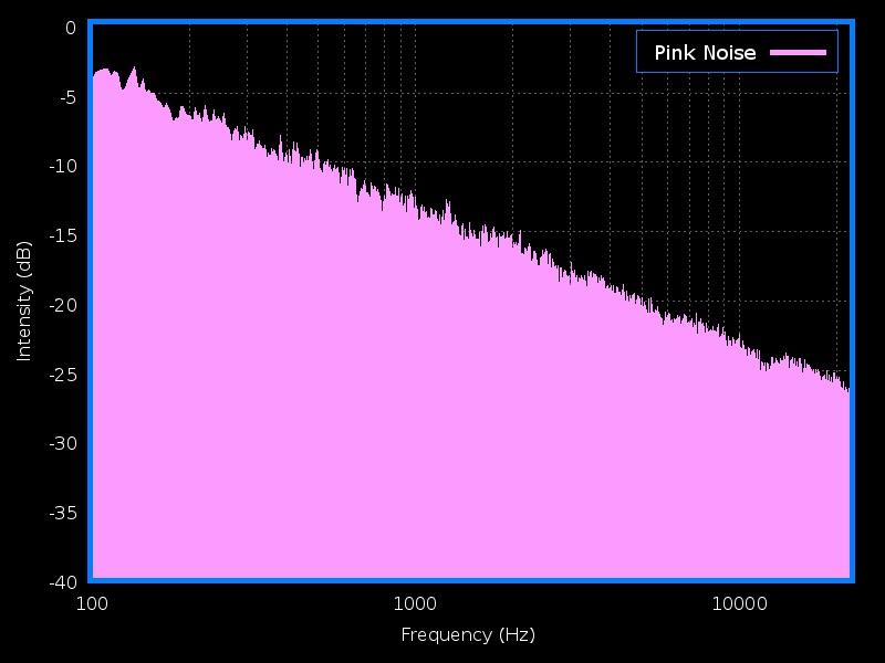

I think if we look at it from an output power level coming out of the DSP it will give a base level to analyze from...Aiming for a nominal level of input signal (output from the dsp...this is actually technically called gain staging) whether I add or subtract, if I adjust the unity gain back to the neutral level the result will be the same.
That makes sense to me, so between 90-110 db lets call it 100db sensitivity. Covering from 400hz and up I think I'll be aiming somewhere near the max system goal, just shy....
Basically aiming for applicable usage versus sine measurements....
Thats why I think Marks approach is good, it sort of is a middle ground of the natural Fr which rolls off up top vs white noise.
so as long as I am interpreting the above graph correctly....115db system volume will result near 88db at 20khz....and desire 108db (20db headroom) for the headroom allowing peaks to be represented unadulterated.

What I would need is to know how to predict how much headroom per frequency in so many words. I guess I could just look at the pink noise response and add 20db on top of the slope. Also I must consider that this max 115db system volume will reflect a musically play back with a 115db peak likely in the bass region with a slope very close to the Pink Noise as we go up the spectrum.the peak level of actual "music" signal @1K is usually 20dB or more higher than the peak @20K.

This isn't correct...I need to look at average spl I believeAlso I must consider that this max 115db system volume will reflect a musically play back with a 115db peak likely in the bass region with a slope very close to the Pink Noise as we go up the spectrum.
I just realize that if I am going to aim for a practical amp power, I need to see where spl sits with a 85db averaged spl measurement using pink noise. Looking at the equal loudness contour my guess is something like 105db at 30hz.
I look at raw response and do the math from there, for each frequency.
Raw response is the key, for assessing potential SPL and headroom, ime.
Whatever EQ's took frequency response to flat really don't matter, when it comes to the driver's real acoustic output/headroom..... per frequency.
As EQ's become a form of gain staging.
Caveats to that 'simple-math headroom extrapolation', are drivers excursion and thermal limits on a per frequency basis.
(of course assuming there are no amp limitations)

You baseline sensitivity is around 100dB (400-10k) in this case, and should be slightly higher with the EV horn. You don't need to consider the top octave, because the transmission efficiency is determined by the horn properties (and the extent to which it matches the driver).
The plan is to play pink noise and monitor voltage, in order to figure out how many watts to aim for. Tomorrow (today)
Imo, the 'watts to aim for' is provided by the power spec, which for the AXI is program 300W @ 8 Ohms. I wouldn't use an amp smaller than that, simply to know i have the driver's full headroom available.
I'd put an RMS voltage limiter on the amp, somewhere below the AES rating of 150W. So something below 35V, with attack and release times based off the lower end of freq response.
Peak limiting could be at program rating or even a bit higher. So like 70Vpk, and timings based off high end of freq response.
Oh, hopefully you have a voltmeter that takes time averaged measurements, as pink noise can really bounce around.
If you do, measure the average pink voltage for 30 seconds to a minute, and at the same time take an average SPL measurement. (LZeq in REW.)
If you do that with processing in place, you will get a measured sensitivity of the full integrated passband. A no BS spec.
To make it easier, accept any pink voltage average reasonably close to 2.83V , and whatever distance works,
...and then just use the sengpielaudio calculators to bring it to 2.83V/1m.
(Which is 1W/1m for 8 ohm nominal)
