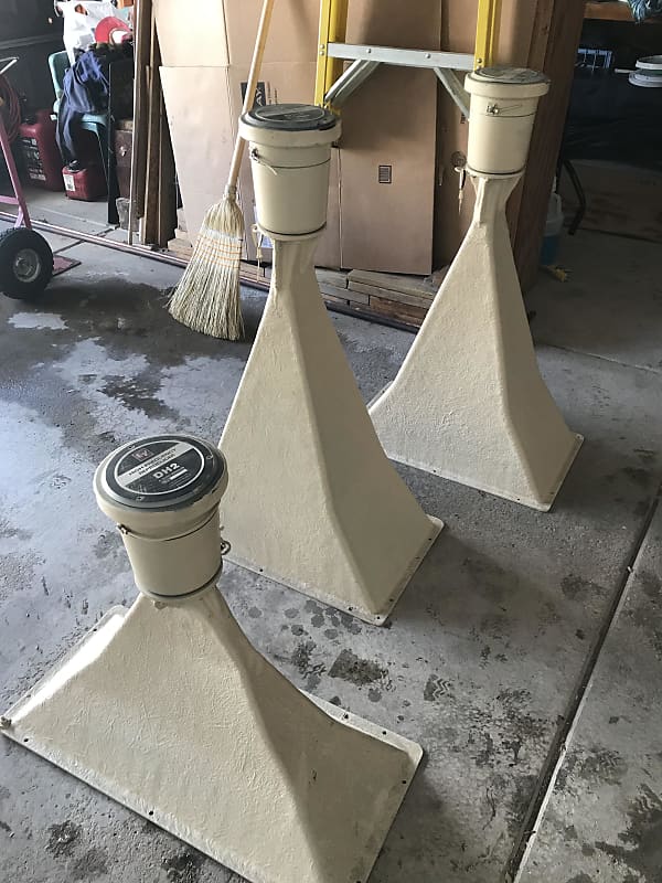

I bought another pair of horns, seemed like the right thing to do....
EVDH420's...should help broaden my perspective.

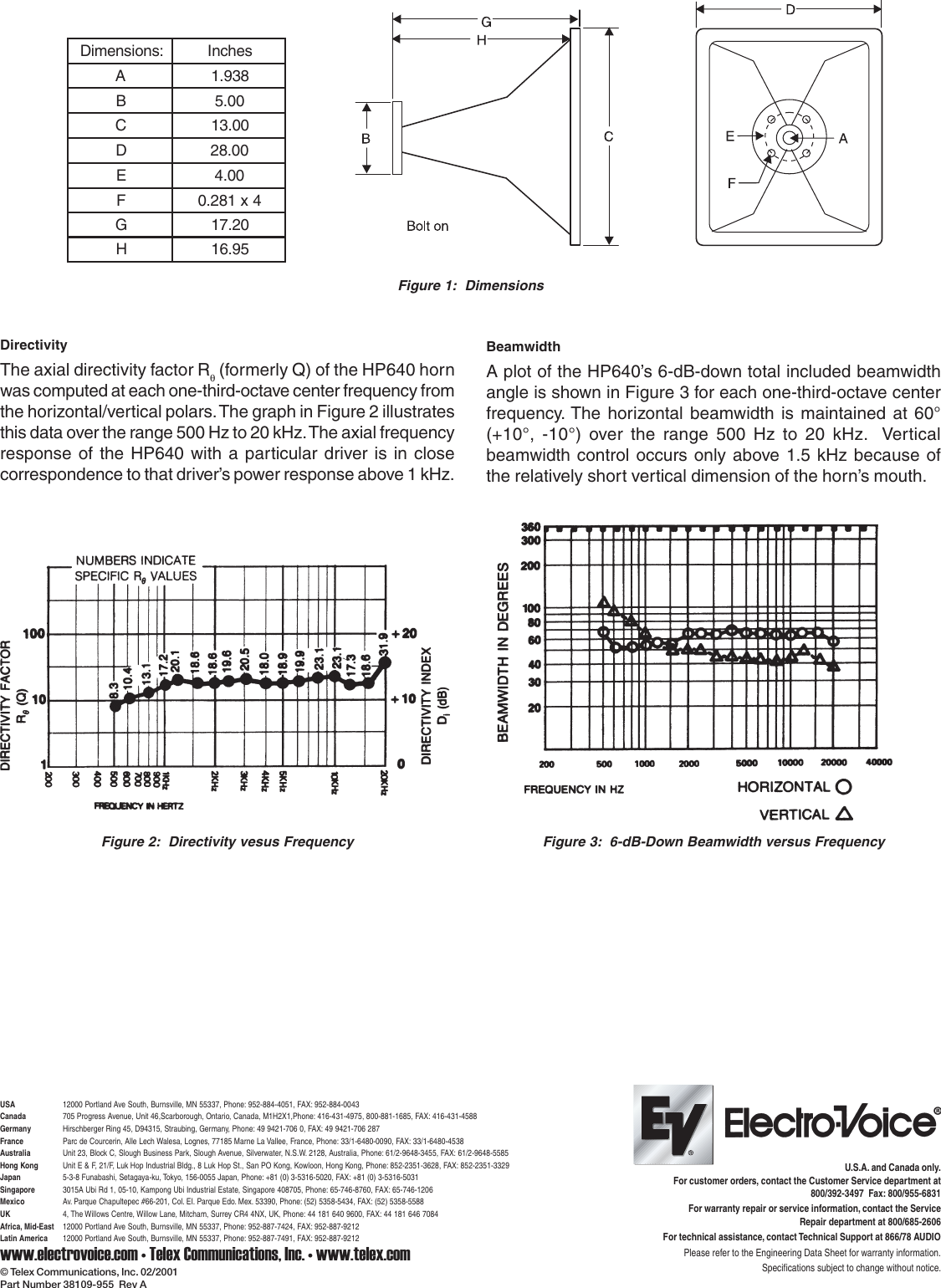

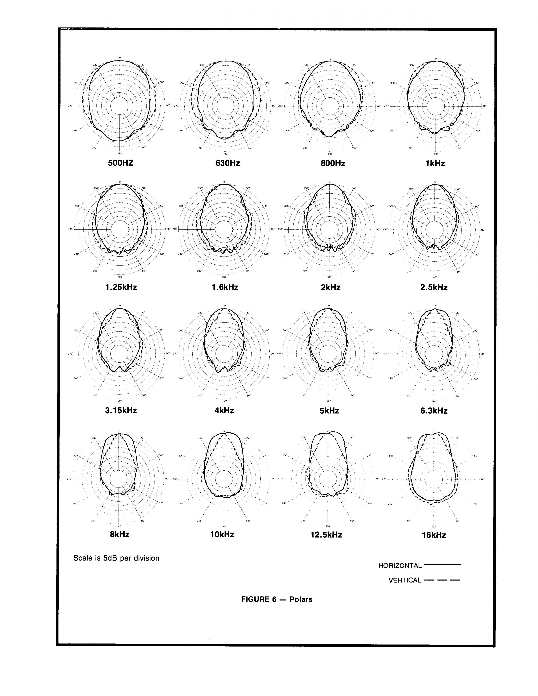

It's the HP640 in the foreground?
Said to be one of the better EV horns.
  • ElectroVoiceConstantDirectivityHornHp640UsersManual539429-User-Guide-Page-1.png
  • ElectroVoiceConstantDirectivityHornHp640UsersManual539429-User-Guide-Page-2.png
Im thinking so...No pair there but you can find them...the 420 interest me because of its length, it should be the lowest loading horn in that series and in my collection...30inch axial lengths gotta count for something...the mouth size is about the size I'm wanting....beamwidth up top should be interesting since Ive been ok with smaller polars already

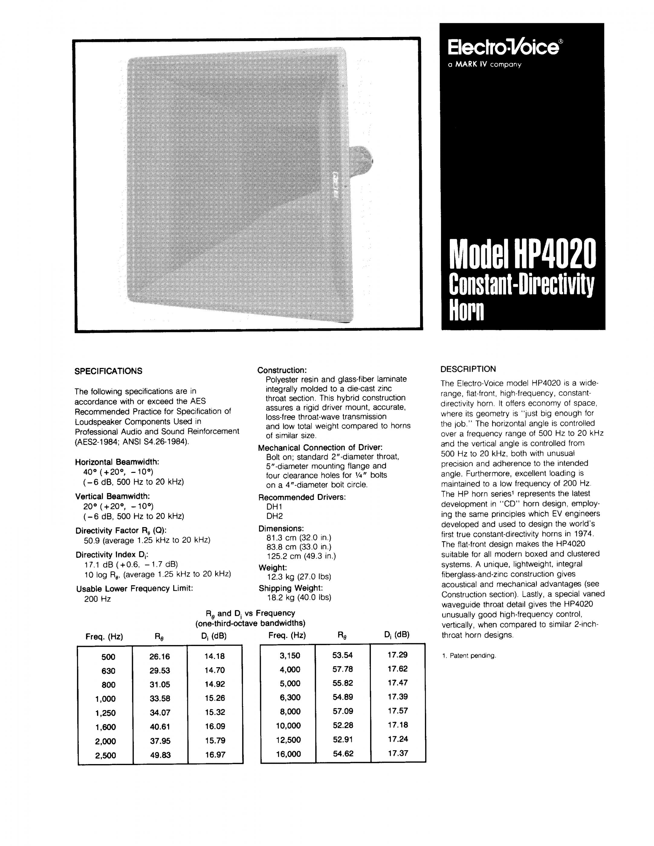

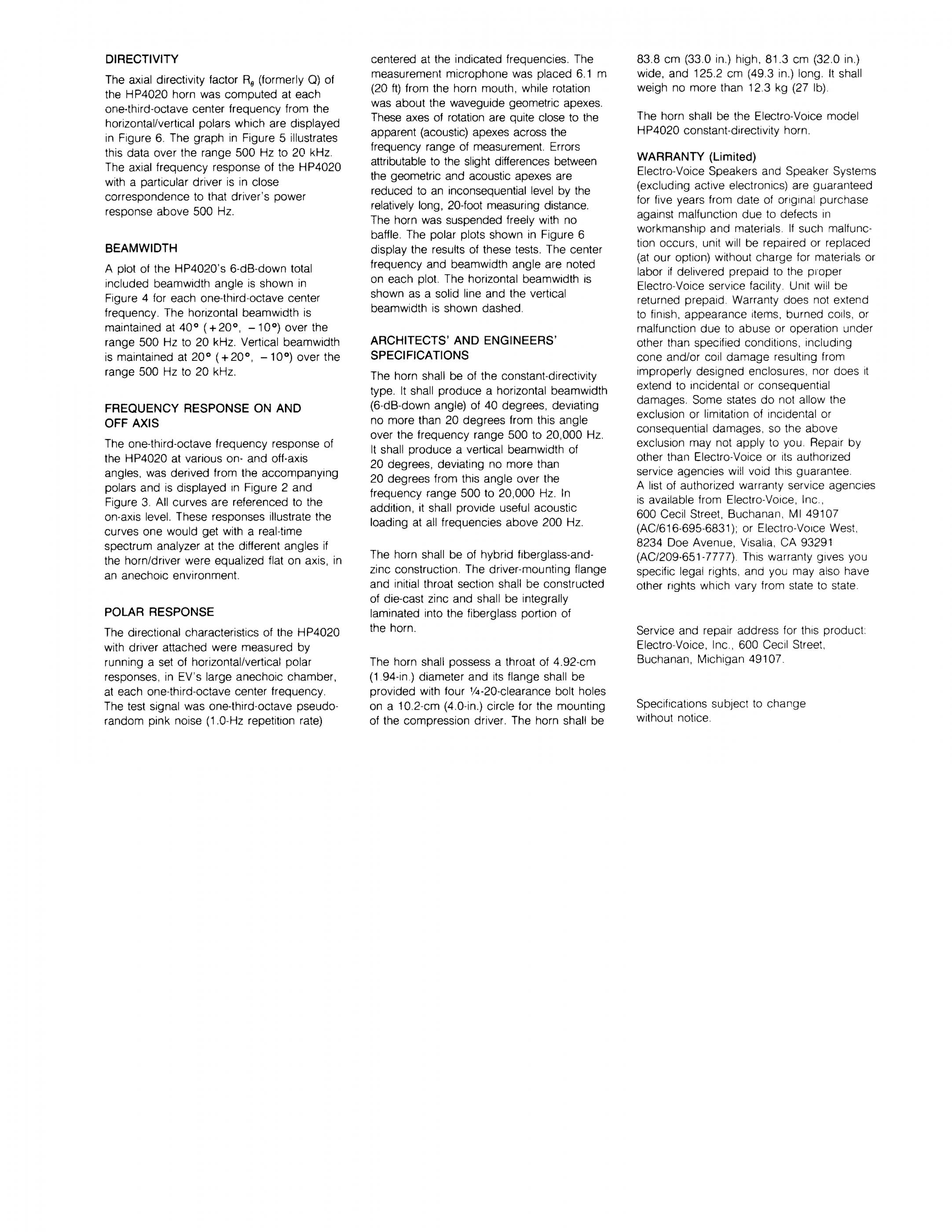

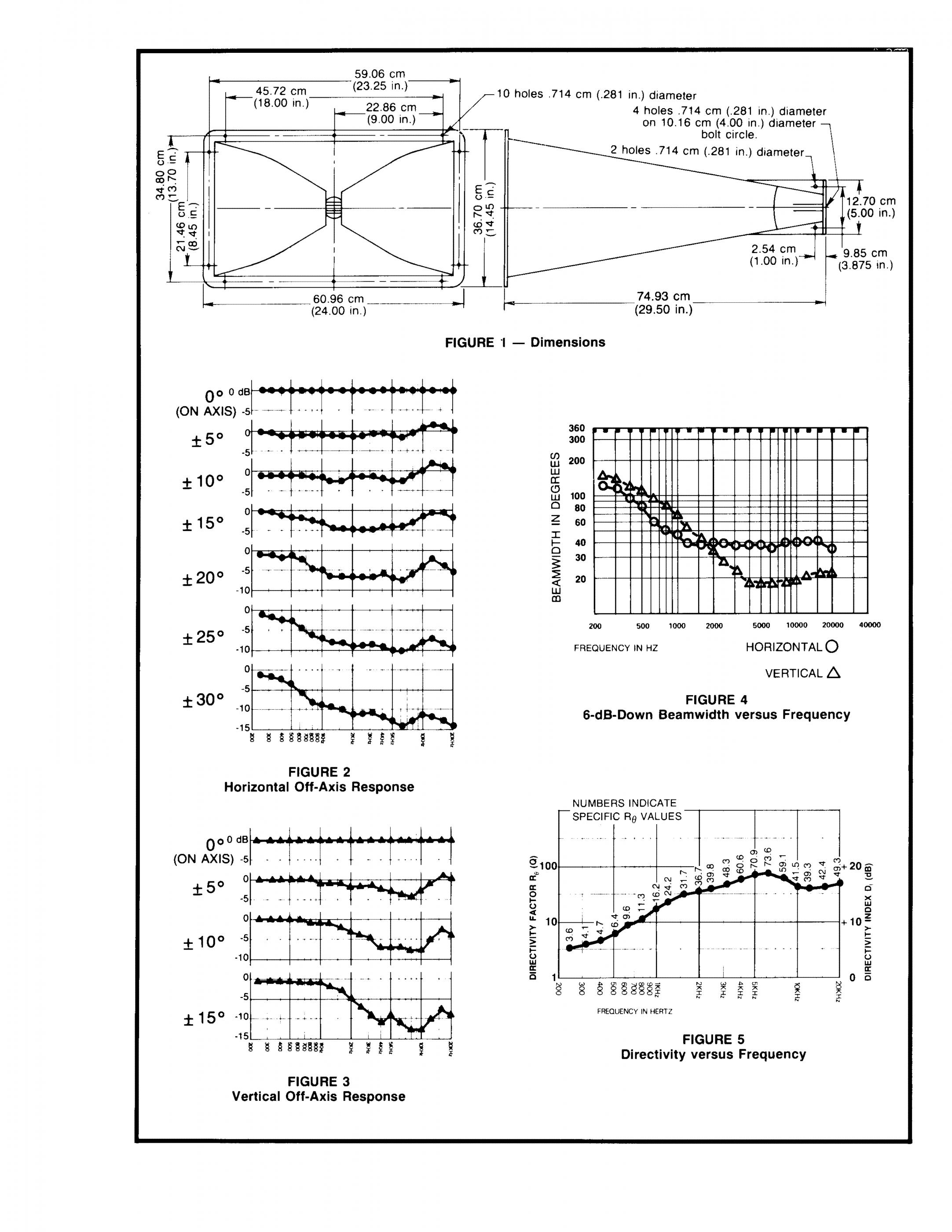

The HP4020 is most likely the only factory horn that loads the driver from 200 Hz and its DI is nothing to sneeze at.
Specs.
It is highly recommended to buy a sheet of 30 ppi foam and cut out a piece in the shape of the last 2 cm of the throat (using heated metal wire). The foam piece should be about 1 mm bigger than the slot area, just thick enough to stick inside the slot without being squeezed. Then measure and listen. Depending on the results you may reduce or increase the length.
I have found this works wonders with my diffraction horns. To say it makes a night and day difference would be an understatement. This trick, ironically popularized by Dr. Geddes, is imo more effective at taming diffraction horns than waveguides.

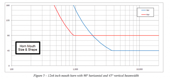

That's not what pattern flip is about.
Pattern flip is illustrated in the attached image depicting the beamwidth of typical 90° x 45° horns.
Below 2 kHz the vertical beamwidth is actually greater than the horizontal beamwidth. The vertical coverage pattern of the horn, which is supposed to be narrower than the horizontal coverage pattern, is now the broader coverage angle. In other words, the horizontal and vertical beamwidth have flipped with respect to which is greater and which is lesser.

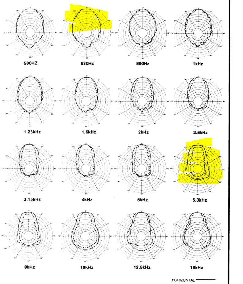

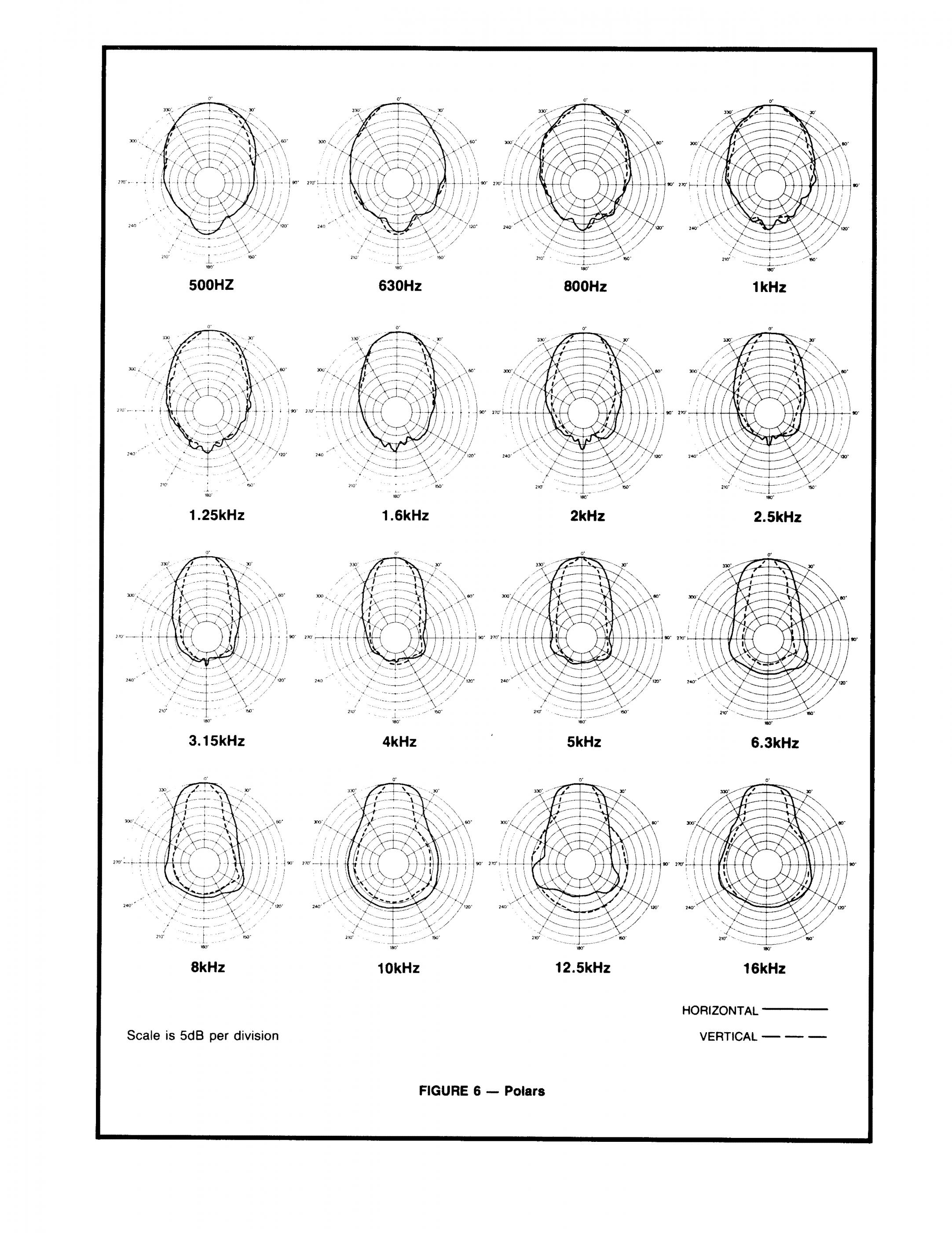

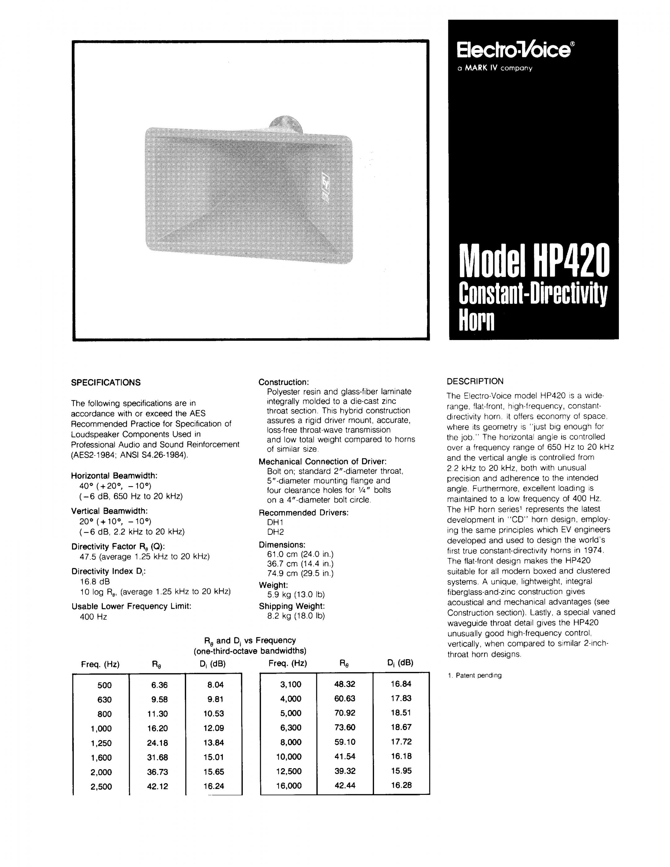

However, I was wrong about the type of horn. Camplo has bought HP420s instead of HP4020s.
Pattern flip of the HP420 is apparent at 1700 Hz. Below that, polars remain close to each other, so the flip isn't very disruptive.
so the same effect, just the extent? essentially the plots stop where they would completely flip. depends if you think power response matters I guess...

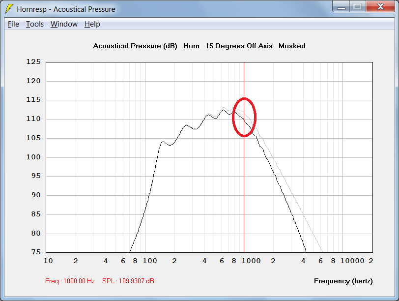

It's unlikely that the power response matters much below 500 Hz (see attachment).

  • on-axis (0 degrees off-axis) pressure response, black trace shows the 15 degrees off-axis pressu.png

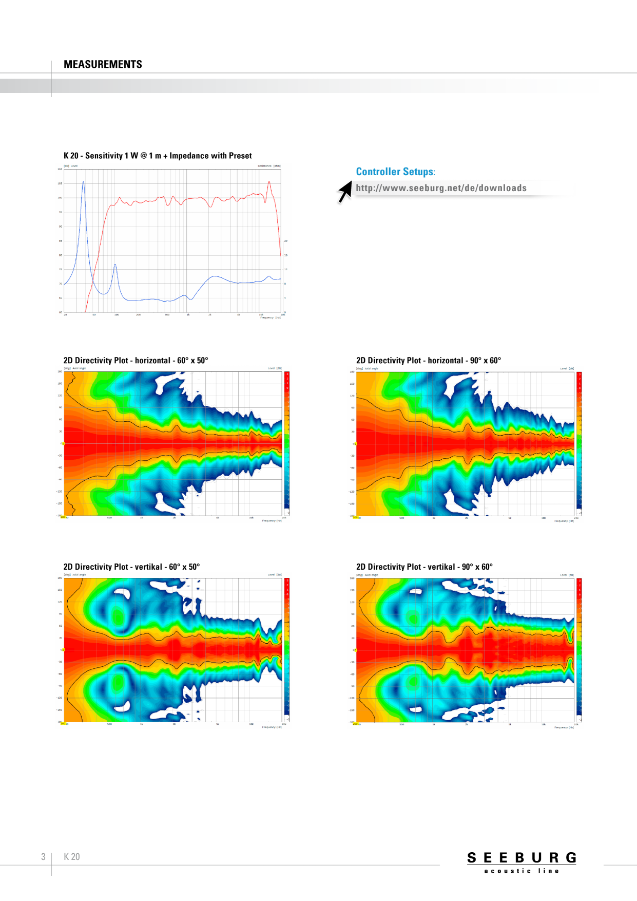

I guess the one pictured is the 60x50 version because there is no diffraction slot visible. But there is someting strange with the sonograms: The LF range of the measurements look logical (vertical radiation narrower than horizontal). But I have the feeling that the waveguide was turned by 90 degrees on the 90x60 version. It looks as if its vertical radiation was broader than the horizontal radiation at HF. Doesn't it ?
