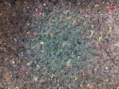

I have used fairly lightweight fibreglass with a layer of felt in front of it. I find this to be a good and cheap combination.
The felt I used was called underfelt and is used in auto soundproofing and under carpets. Looks like this

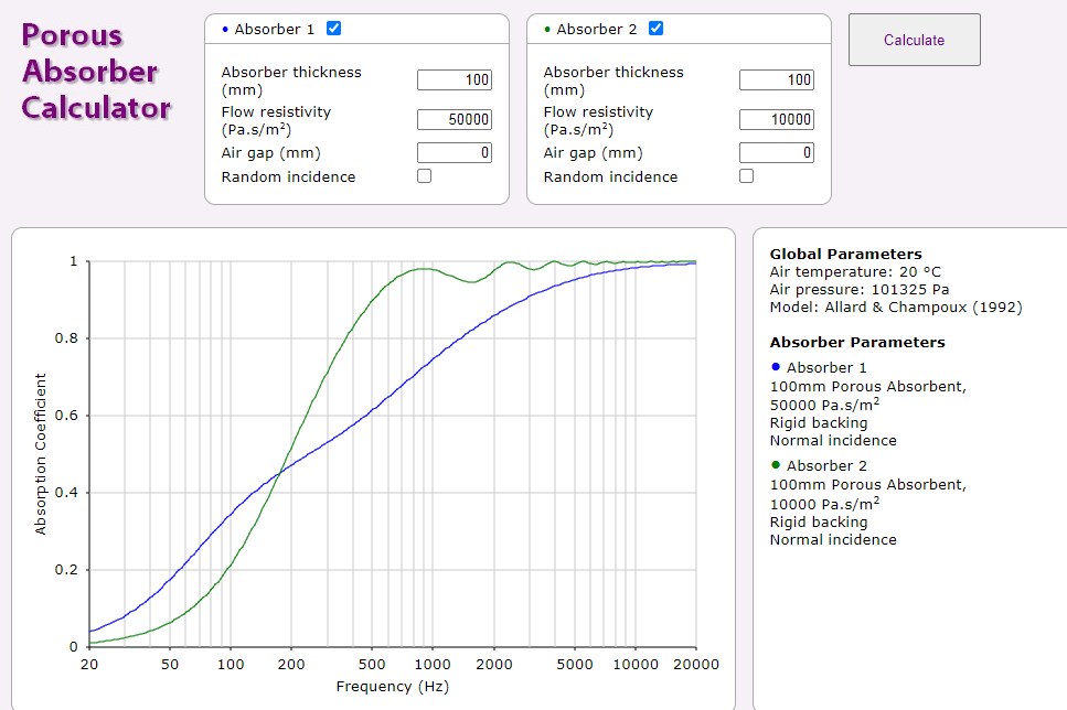

I think more cheap fibreglass in greater thickness is a better choice (when paired with felt). To get a feel for how the GFR numbers work in an absorber, try the porous absorber calculator.
Porous Absorber Calculator
I've attached a screenshot of 50000 vs 10000 in the same thickness I'll let you decide which you think is better
