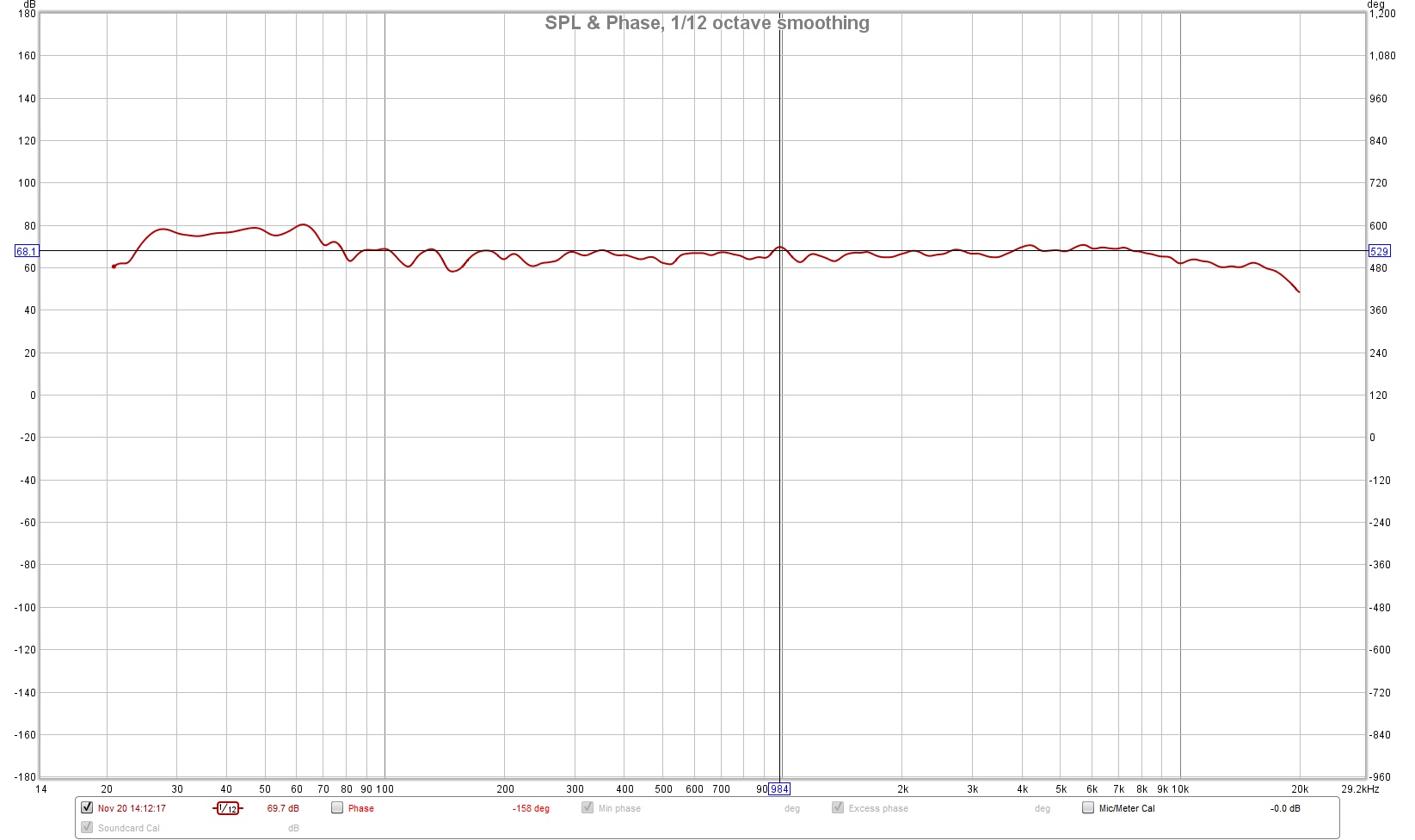

your thread has over 6,000 posts, i didn't read the whole thing. i was responding to your first post where you ask about a 2-way, full range, low distortion setup involving a compression driver and a woofer. my system, as i described, is just that. if you're curious about measurements, i attached it. a couple remarks:
-this was measured at the listening position, stereo, room as-is (no treatment); 1/12 octave smoothing since that's what stereophile uses. can you tell where the xo is on the measurement?
-there is some DSP adjustment, but not as comprehensive as i'd like (only 5 biquads available)
-over 200-10khz it shows very solid results, within around +/- 4.5 dB
-below 200 the bass gets a little more uncontrolled, and i have applied a bass boost for preference at 100hz

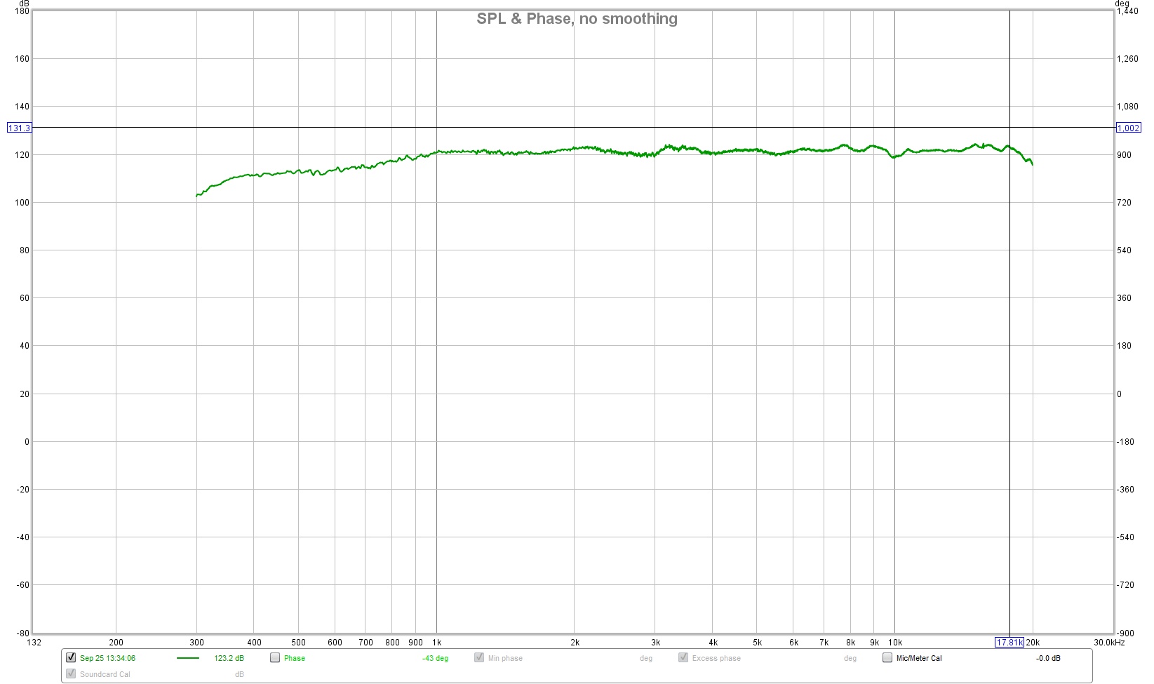

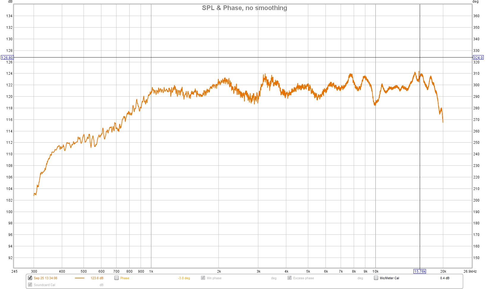

-above 10khz we're getting steep drop off: i have adjusted this in PEQ to get the result shown, but it still doesn't look great on measurements. this is due to the low cost tube amp i am using which has a huge rolloff. i tested the drivers without the horn on a solid state amp and the results are exactly what you expect for the TD-4001, which is a rolloff around 17.7khz
-the TD-4001 results are a separate measurement with no horn, SS amp for more linear response. even unsmoothed the results are remarkable imo. i'm not sure what the slight rolloff at 1khz is, that may be typical for this driver.
at any rate, the sound is superb to me. the woofer doesn't sound weird at all integrating with the horn, but i'd love to have more people listen to these and hear their feedback. on the bass front, with a little PEQ, i certainly don't need more than what the 15" provides. on the highs front, even with the rolloff, there's definitely enough treble energy for me. i don't feel like i'm missing out. i have plans to get a more linear SS amp on the 4001s, improve the horns, room treatment/bigger room, etc. but as is, i still think it sounds great.
