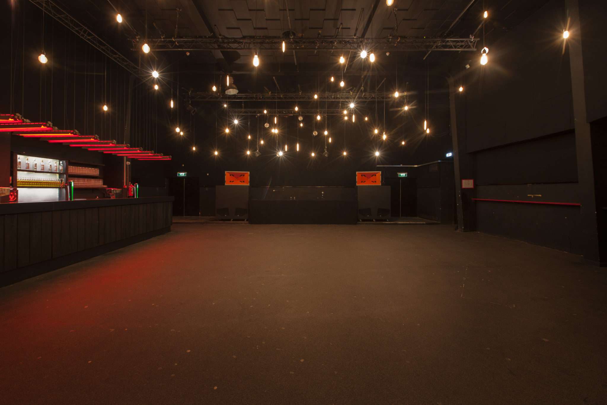

Danley Pure Groove impression Part II
Room 2
The second room wasn't used for the party and mostly blocked, apart from a passageway to the smoking area. This passage is the space between the Pure Grooves and the bar, visible in the attached picture.
Background music was being played through the SH96HOs, at a level many people would consider to be loud at home. Subs were switched off.
I had the opportunity to listen in the nearfeald (2-5m) to either one of the SH96HOs. There wasn't enough space in front of the Danleys for proper stereo.
