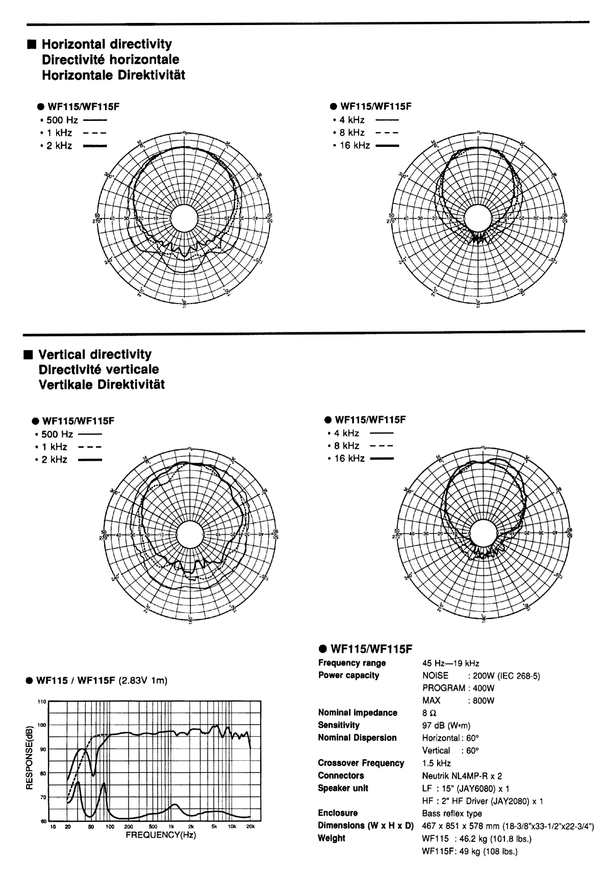

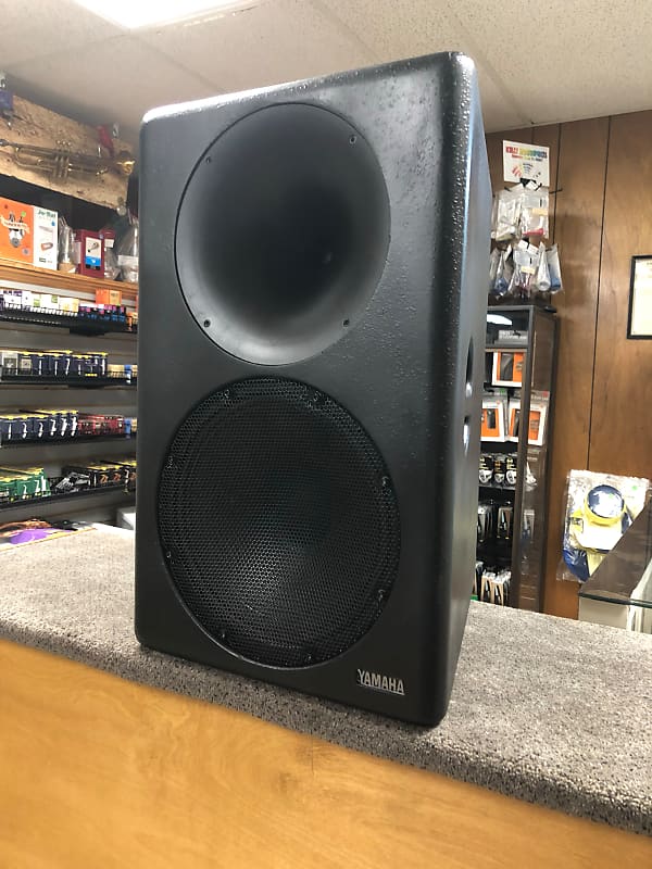

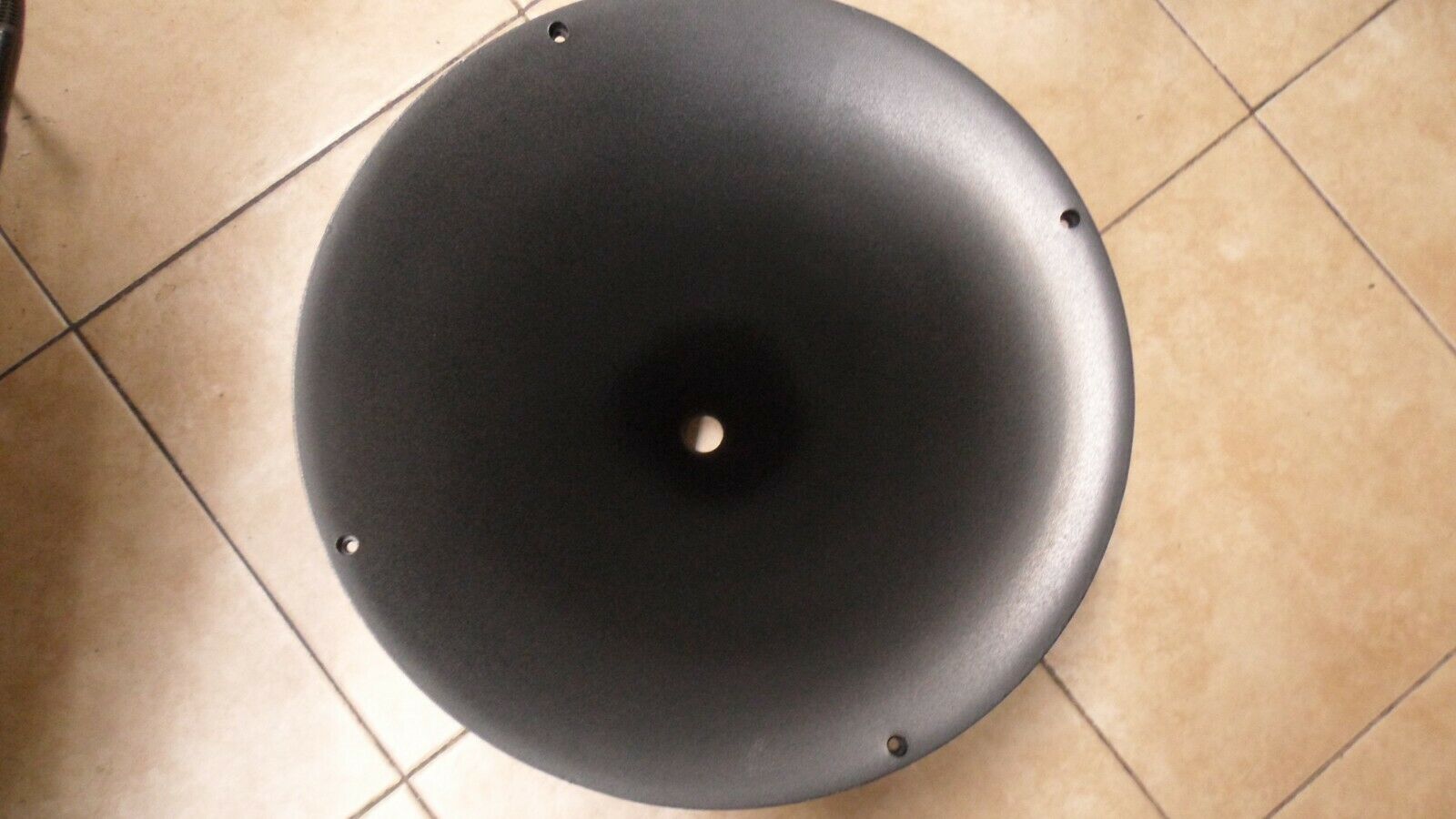

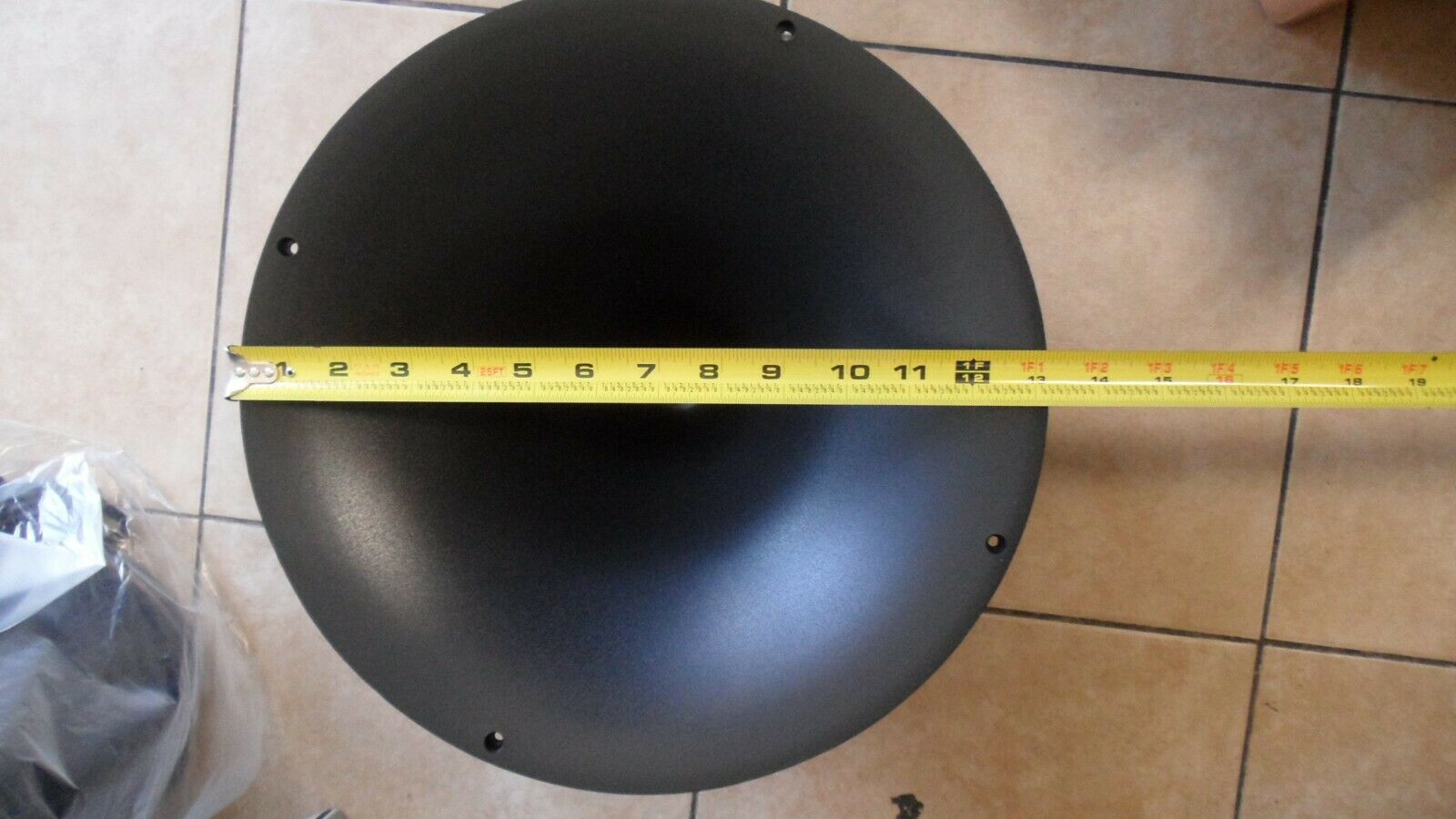

A bunch of these horns (YAMAHA CBY02920 HORN- 60 DEGREE WF115) are currently for sale, new in box, $80 each.
It's the most interesting part of the Yamaha Waveform loudspeaker series, and apparently pretty decent.
It's a 2" horn though and way too small to be used below 1000Hz, therefore not very appealing compared to other offerings.
