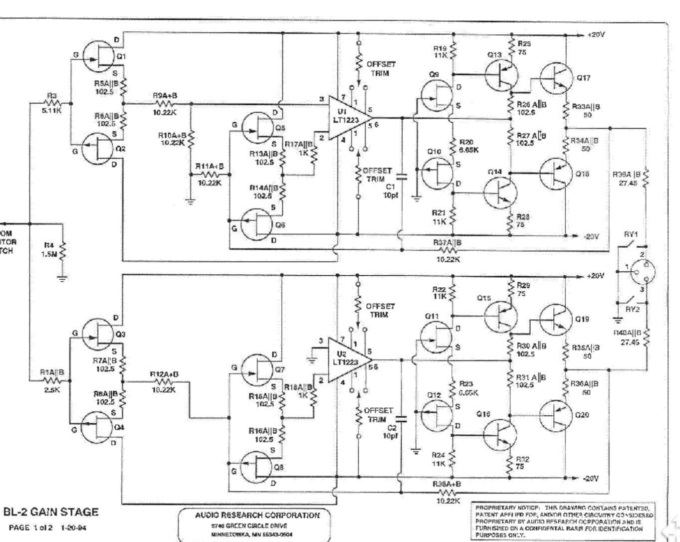

I will soon take position of a fully-balanced Audio Research LS5 preamp. I know I can use adapters to run single-ended gear, but I was wondering if it was possible to modify my amp to accept a true balanced connection? The schematic is attached. I don't know enough about reading schematics to know if it's doable not.

If anything, see if you can get schematics for the BL-2.

@6L6 That could be done in a little inline converter box, right? What’s the purpose of the ground switch? I didn’t totally understand your diagram.
It's a ground lift switch. With the switch closed, the shield is continuous, but you can get ground loops. With the switch open, you can't get ground loops, but the shield is interrupted. Leave it closed unless you get hum, then listen if opening it improves that.

Ignore @tonyEE he has passionate opinions but rarely reads the whole thread, as his suggested piece of equipment is the wrong direction for your application. (The BL-2 is SE to BAL…) Changing power amps may be interesting, but doesn’t address the question at hand.
Yes, you can go from your balanced output preamp to a SE input power amp with either just a cable, where the negative phase is grounded, or with a transformer, where the differential signal is maintained for the preamp, keeping everything as happy as possible for the respective equipment.

My take is to follow the design of the BA-2, I posted the schematics, for the input side.

Ay, Jim... I do read the threads.... if you read my post... hmpfrr... you will see that ARC specifies using the BA-2 to provide SE input capability for the LS5. See here... there is indeed a gain control in the front panel, but this was quite common in all ARC preamps until about 20 years ago or so..

Anyway, BL-2 is SE to BAL. (Schematic attached) @SoaDMTGguy wants to keep his balanced preamp balanced and connect to a SE input power amp. This is a perfect job for a transformer. The Preamp will see a differential load and operate in it’s perfect world, the power amp will see a SE input signal and be happy, and there is galvanic isolation between the two breaking any ground loops. Nice!

CineMag or Jensen. Probably a 1:1 quadfilar as if you need to step down (not knowing if the ARC preamps are at pro levels or not) you have the ability.
@6L6 I wasn't sure if the transformer would preserve the noise rejection. That's fantastic! I have to have crossover boxes inline anyway for my speakers, I could probably combine them with a transformer and run them at the end of the line.

https://www.jensen-transformers.com/wp-content/uploads/2014/08/jt-11p-1.pdf
