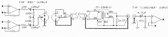

Is that what I see as the very first thing after the RCA input in the BL-1 schematic: https://www.arcdb.ws/Database/BL1/ARC_BL1_schematic_and_parts_list.pdf
Google Jensen AS060.
All the information you need can be found readily in the net.

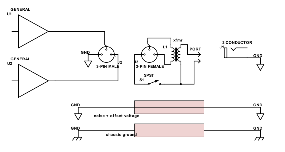

@6L6 I wasn't sure if the transformer would preserve the noise rejection. That's fantastic! I have to have crossover boxes inline anyway for my speakers, I could probably combine them with a transformer and run them at the end of the line.

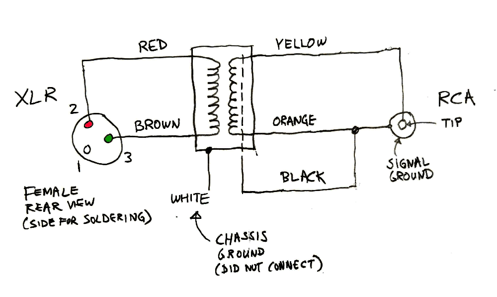

Alright, I've ordered a pair of those transformers, and I'm going to try an make a box that does Balance to Single-Ended, as well as incorporating the high-pass filter for my speakers. Thanks everyone for the help!
If it's a passive transformer based, will it work backwards too? I'd love to see a single ended to balanced gizmo.

I think it is. At least, se to balanced is next on my list, because ARC only made one phono stage with balanced output -_-If it's a passive transformer based, will it work backwards too? I'd love to see a single ended to balanced gizmo.
