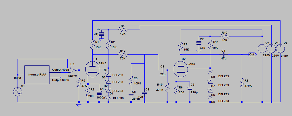

Is an output impedance of 15k ohms low enough for a phono stage in this day and age?
I figure these days, a phono stage is likely to drive the volume control on a class D or similar power amp, which is usually 10k ohms, sometimes as low as 5k ohms. So a phono stage may have to drive a load as heavy as 5k ohms. Therefore, said phono stage should probably have an output impedance of no more than 500 ohms. A cathode follower or MOSFET source follower on the output will solve that problem.

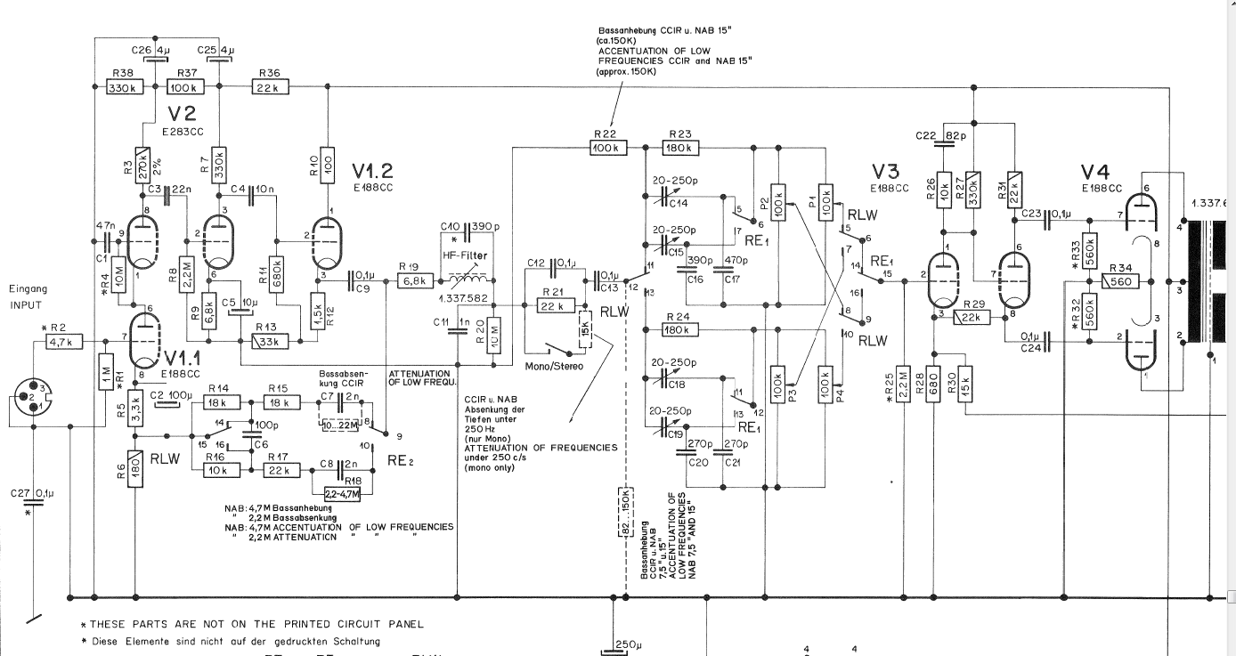

It is also very difficult to accept trading input saturation capabilities and soft clipping behavior for useless SNR...Every single method i found avoiding all the problems at once was expensive.This topic started with a NO-NO to d3a for actual price reasons, but using the best pentode for audio outhere isn't the best secret could be given away by people really knowing what low noise audio is about.I have d3a, i can use them any time, they are litterally 6 feet away from me, but for a few years i stopped trying random opinions and tried to find and understand the best equipment already designed and built by the best companies that were active in recording industry when the tubes were the only option . Better start with the best from the tube era if you really want to understand what tube use is and maybe ask yourself why you find almost nothing relevant on EMT jpa-66 schematic(basically i'm the only one ever to talk about it here, while i can bet there are on this forum guys having its real schematic, but never mentioned anything about it, and that is because people who know real valuable secrets never give them out for nothing.The best vintage audio equipment were all swiss made, and swiss people are known for protecting secrets for as long as possible...We barely accepted switching power source in audio in the last 10 years while Studer a820 had it in the 80's recording pretty much all european and a good hunch of american music you get today as vintage...
for pure fun:
EMT 139st phono schematic | nvduybom | Flickr
What's the purpose of the notch filter in the EMT139 st b ?- Vinyl Engine
EMT139について(1) - Decca Decolaがお嫁入り

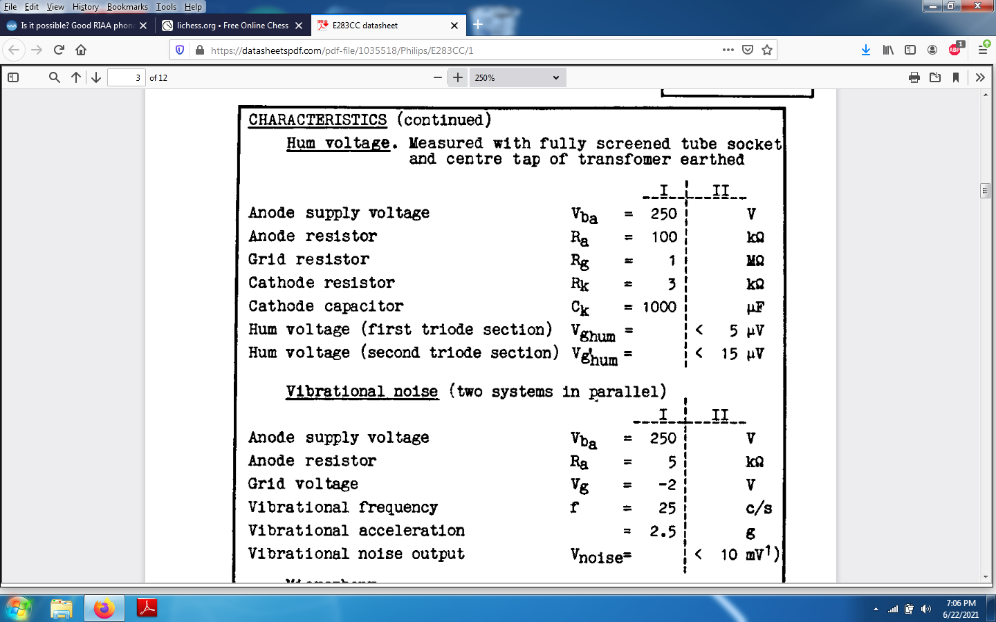

Now tell me if you know what the picture below represents and of what importance might be for a phono preamp:
