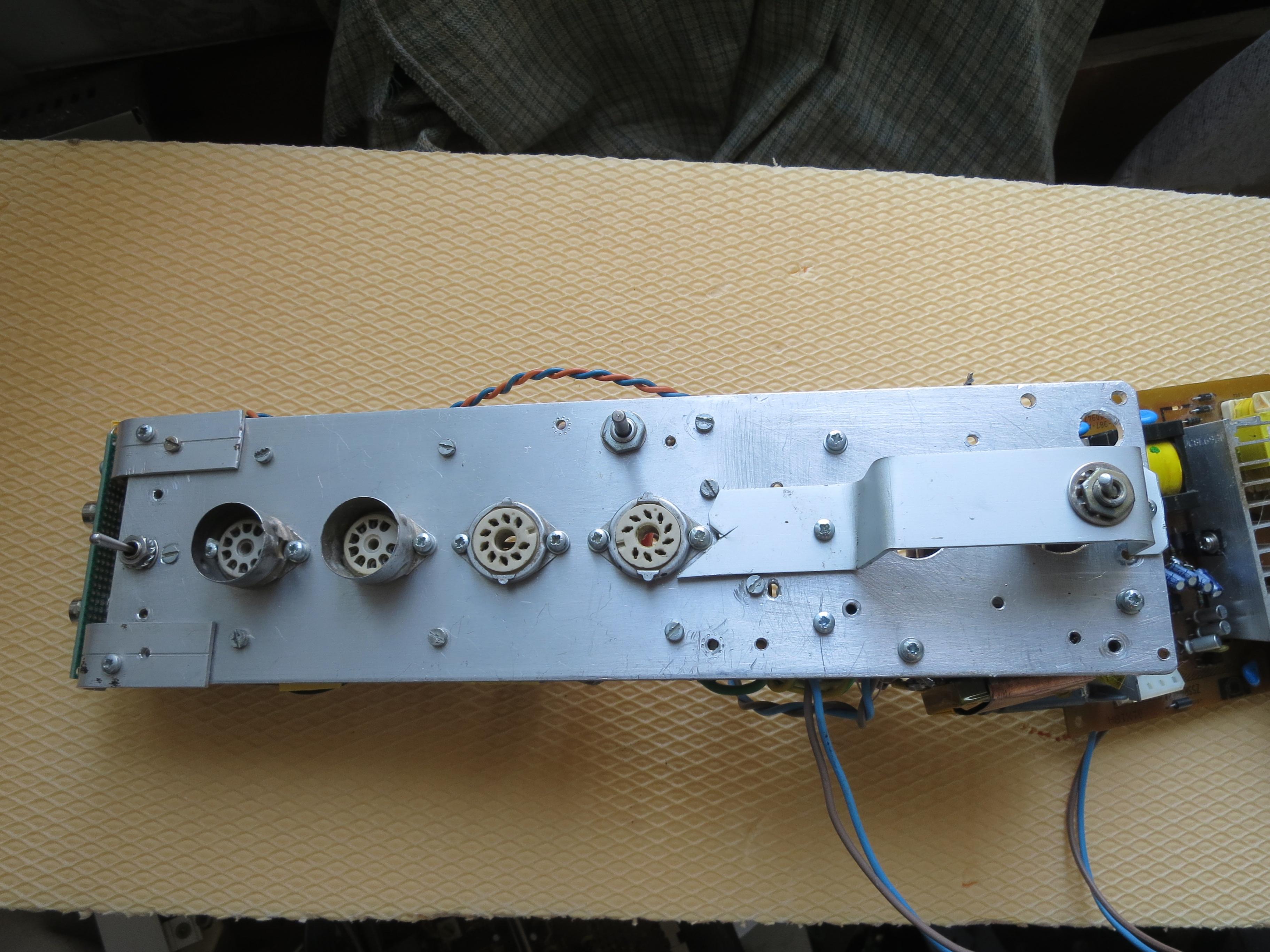

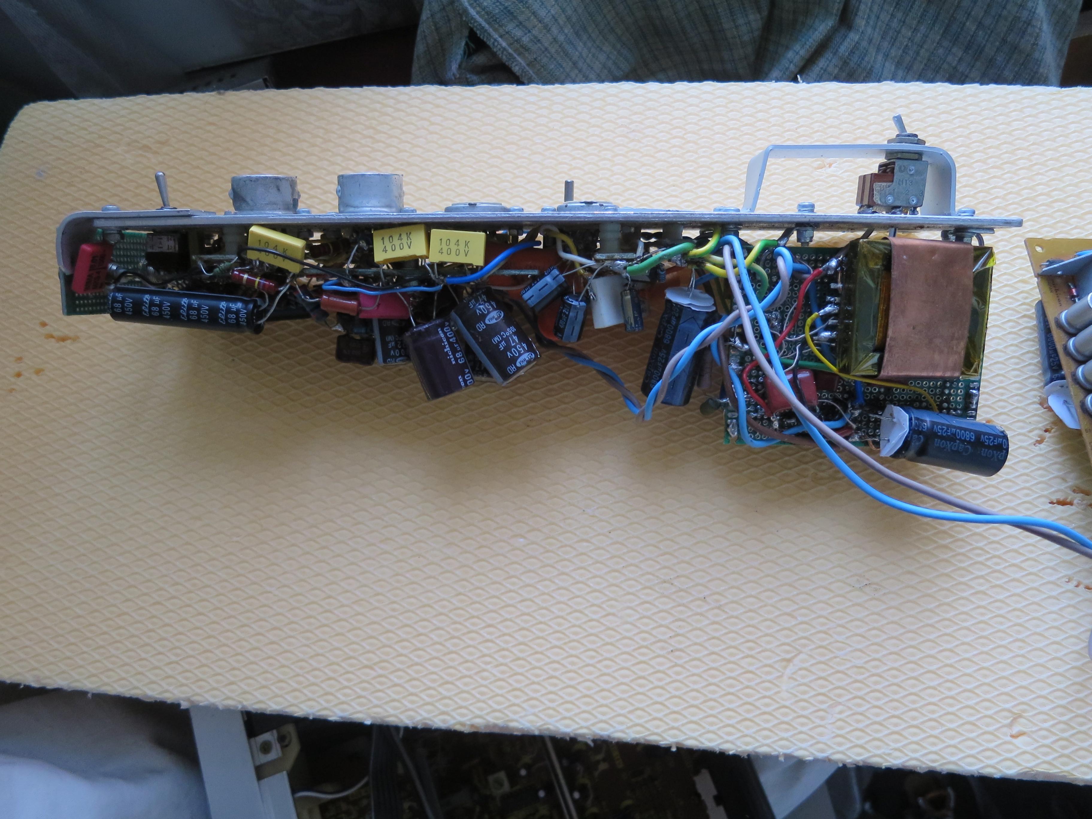

With this circuit, Junior phono I got the following resuslts:
12BZ7
G= 49,6 dB,s/n = -73,2 dB weighted A
12AX7
G = 48 dB , s/n = 74 dB
5965
G=41 db s/n = 78 dB
7062
G= 42,6 s/n= 80 dB
ECC81
G= 41,3 s/n = 73 dB
In attach the diagram, I use always this condfiguration where the RIAA network is at low Z
And it is possible to change the tubes ( with a matrix for filaments) and the gain ( with jumper.
In my opinion very good results.

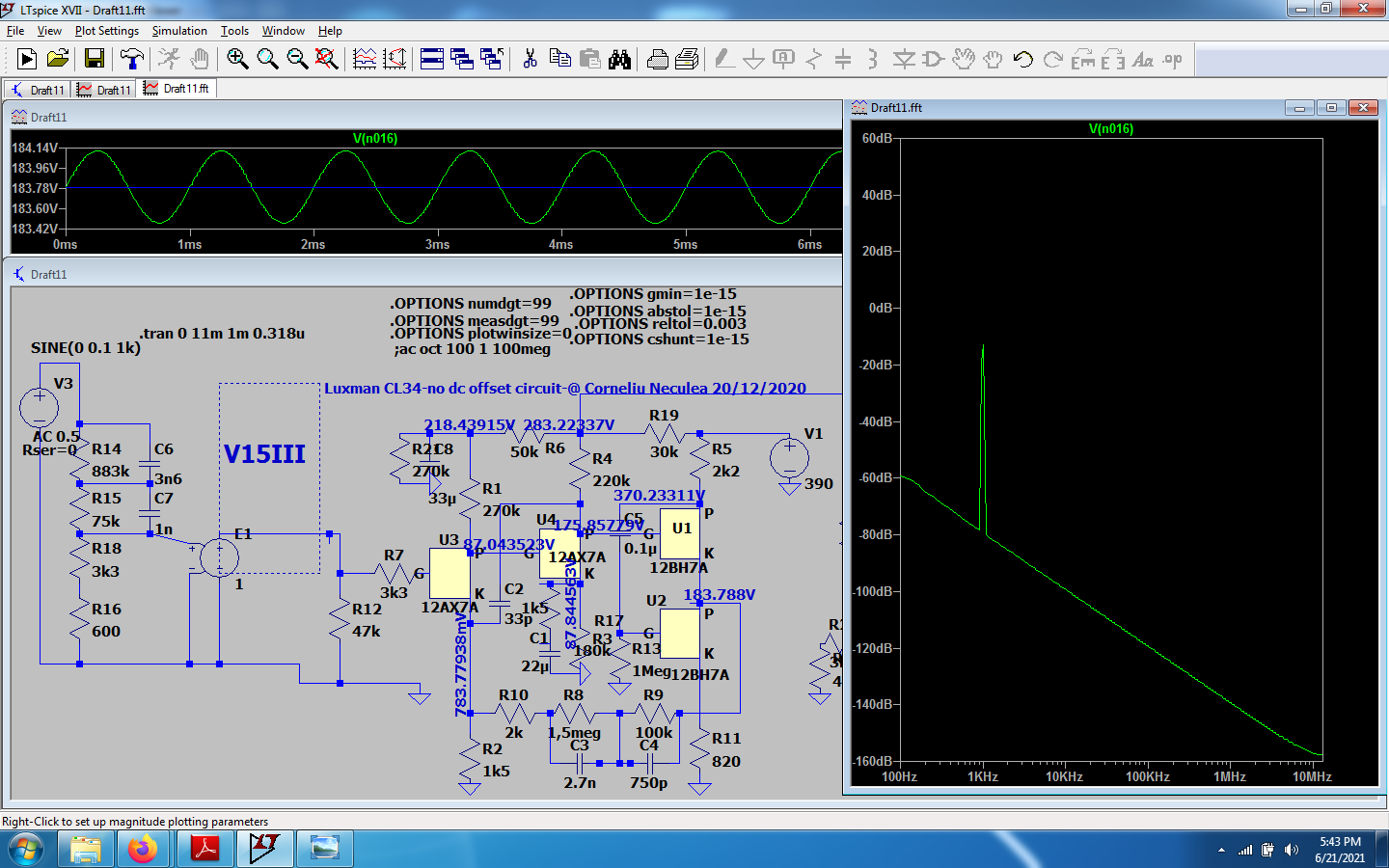

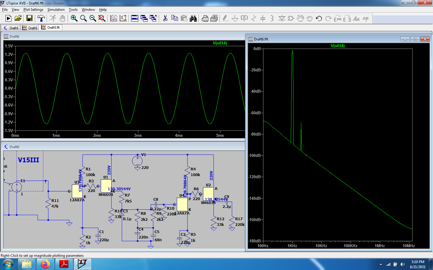

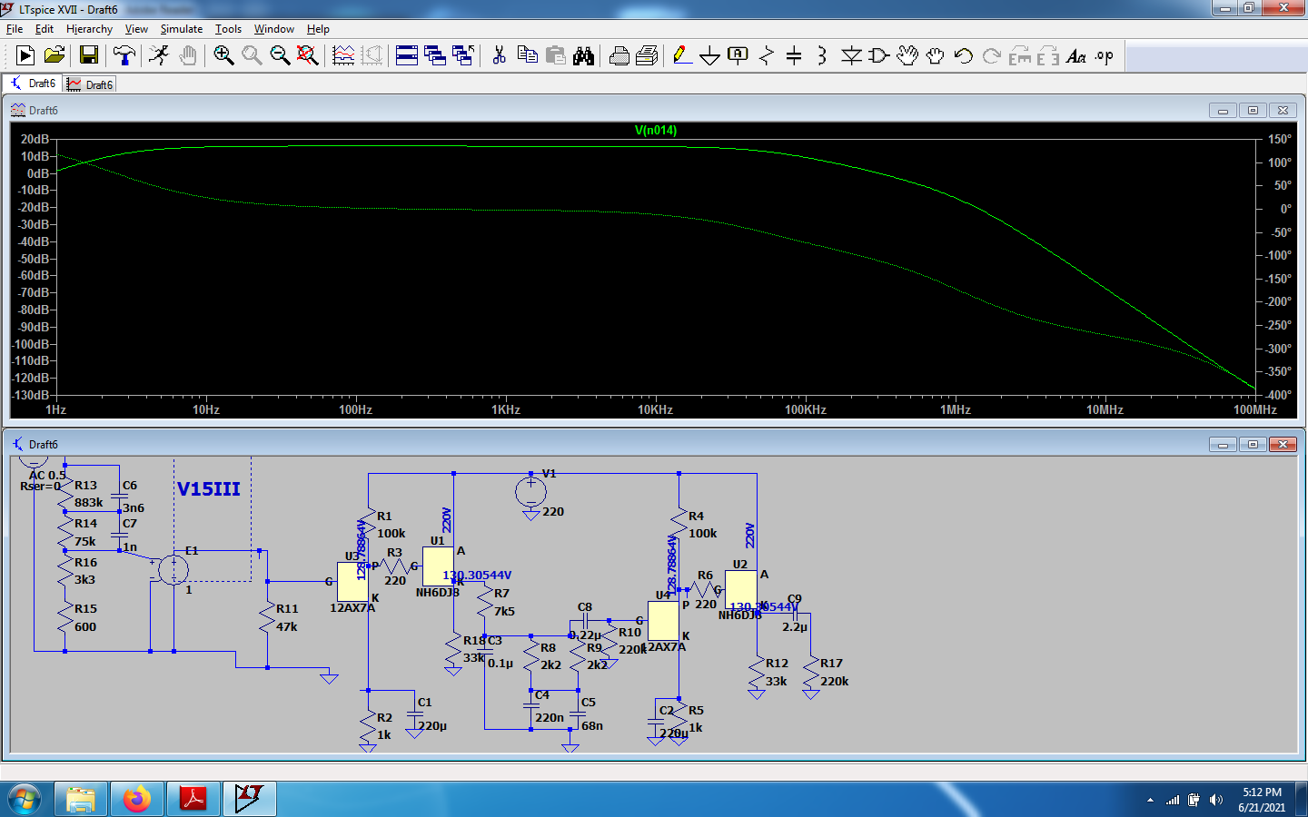

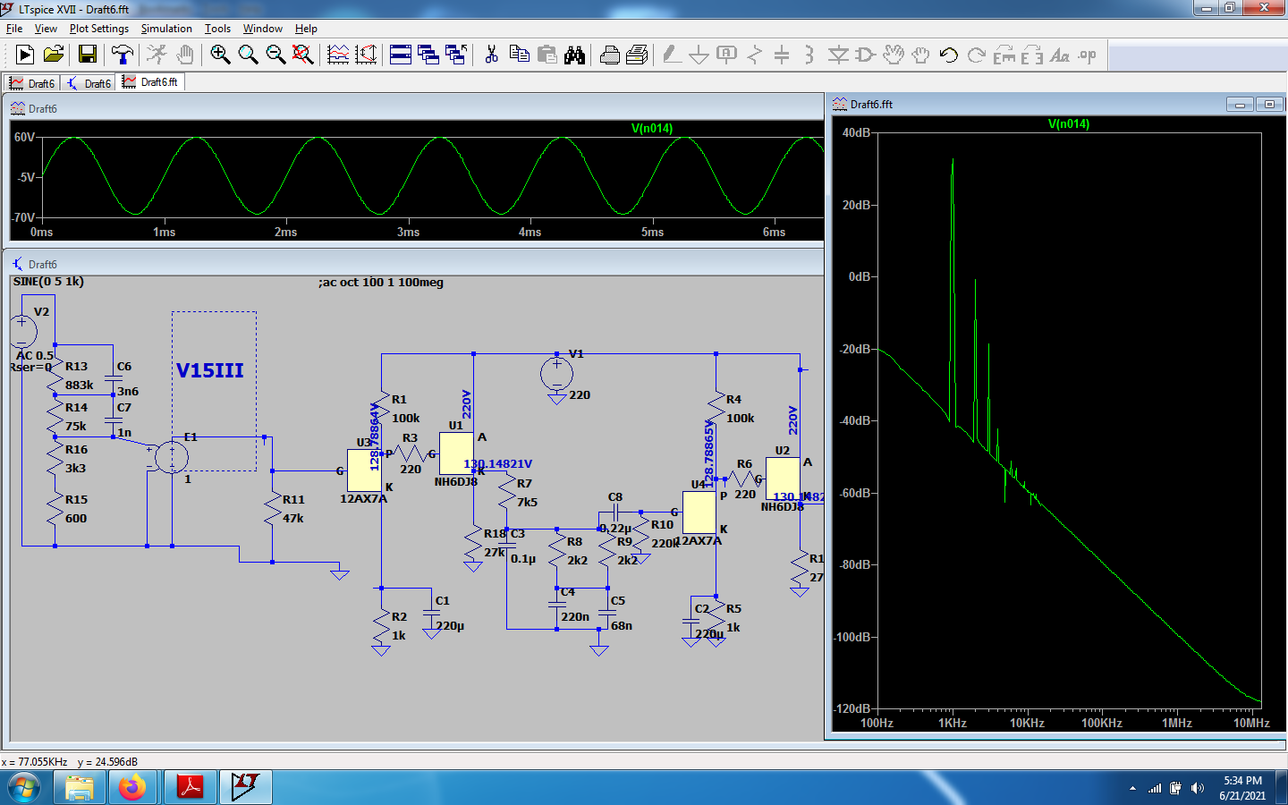

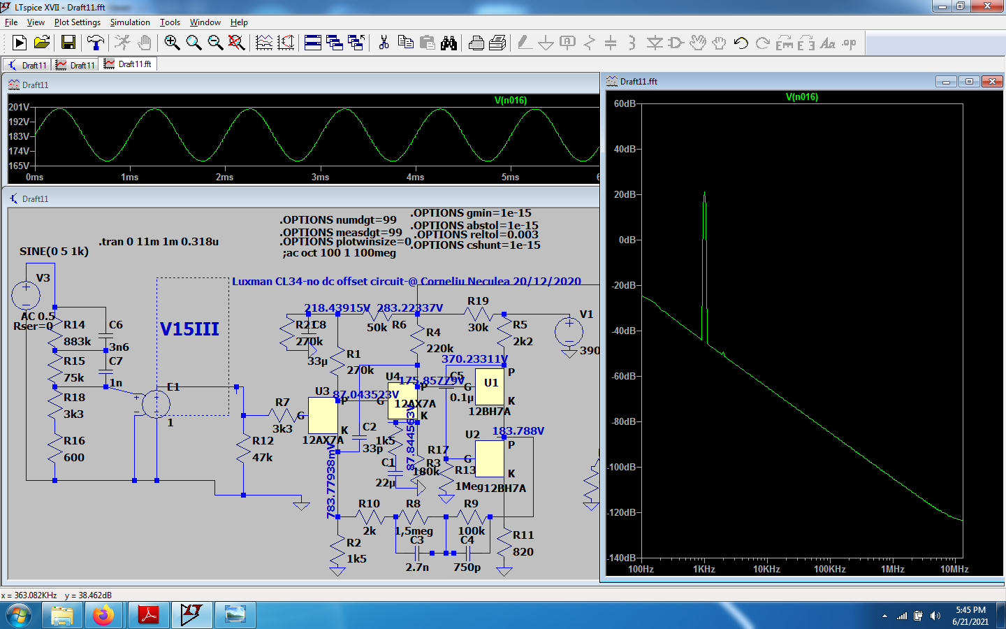

I didn't know your exact values for ecc88 cathode resistors so i just used some typical values(27k and 33k) that keep ecc88 around Vak =90v at good current capabilities and indeed the frequency graph is superb, just the input saturation might not be that great as over 220mv input signal the simulation needs serious convergence rules to even get started and i don't really have the time for this, but 220mv input max signal is most of the time ok and tubes don't behave the same as silicon.Maybe with the right anode and cathode resistors value it will work a little bit better .

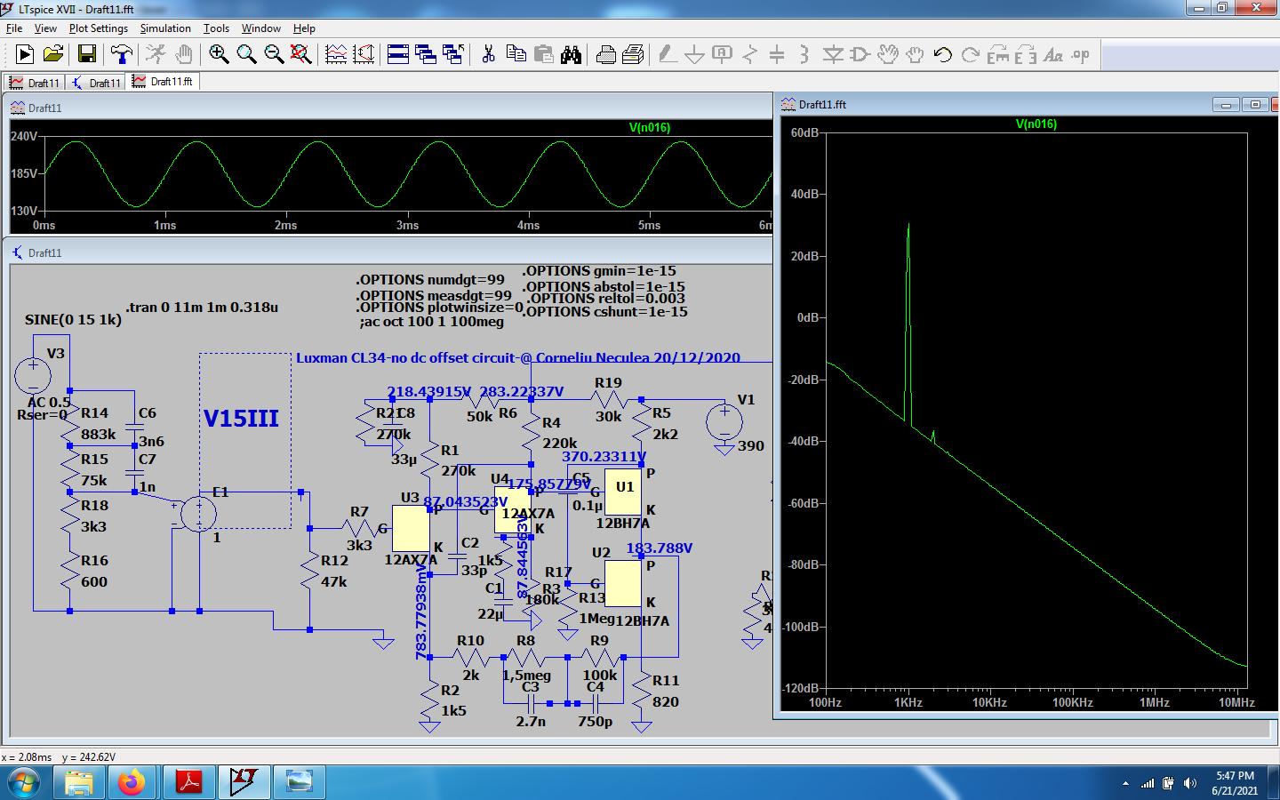

On the other hand here's also a modified version of Luxman CL-34 clone, active riaa, with no dc offset supplied only from a 12v dc smps that's already simulated, built and listen to and its input saturation goes up to insane values like 12 RMS with tube like distortions and clipping occuring at 15v rms as for its distortion behavior...it speaks for itself.12ax7 mullard and 12bh7 CEI tubes were used in the real circuit.I don't want to get you through my d3a hybrid circuit with pasive riaa that could reproduce perfect square waves at 20khz, it's just that i used National Semiconductor(now TI) riaa from that datasheet and also a 3 times lower impedance riaa network than yours in the same circuit and i could measure same square waves at 20 khz on both networks, but the higher impedance network sounded more relaxed and i preffered that to the lower impedance one.I couldn't simulate it at the time to see its harmonic content , i didn't know how to use a simulator back then, nor i had a soundcard at least to measure some harmonics, but i bet it was pretty different.The lower impedance network sounded more analytical, clearer, but i preffered the larger impedance one in the end for its more vibrant and more relaxed sound .
I still have about 10 d3a tubes i bought years ago when 19euros/ piece was somwhat affordable, but i can't find the time to rebuild that circuit.

The Rk of both 88 are 12kohm and the current is around 8-9 mA with Vdc of 200 volt (around)
That , in my opinion, is very good.
The 83 works at 1 mA
In a low gain the max input for 1% of THD is 70 mV at 1kHz( = 8,5 volt rms out); the gain is 41,7 dB
This is good for all purposes.
Of course changing the brand the working point moves a bit but it is not a problem

I think I already deleted the asc.file with your schematic, but iItried 15kohm and 22kohm while 27 k and 33k performed better allowing 220mv input , while you don't really need the lower noise provided by the usual 8 ma of ecc88.It might help though at driving a littel bit better the riaa network, but i found no evidence for that in the simulator cause higher input also means higher drive for that riaa network .
I decided to set in that way the circuit after some lab test in addition with listening test.
I also tes the 6N6 and 6H30 at 10-12 mA; they are also ok
The reason is also the possibility to change the gain stage and CF using a good range of alternatives
Last, the ss HT stabilized power helps on s/n
note: I have a AP Riaa test ( software compiled) that is the most precise curves possible indipendent form Zsource (I can work with 20,150 and 600 ohm) and this got me a great help on trimming the response
