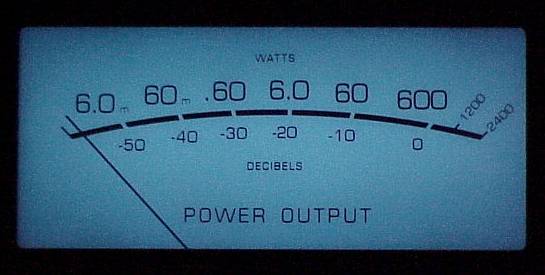

So now I have to ask ... exactly how loud is your music that you need more then 100 watts??? 😱
"But I run my 600 watt McIntosh up so the needle goes half way across all the time..."
Mcintosh power meter...
Most non-destrutive listening actually occurs at 2 watts or less.
