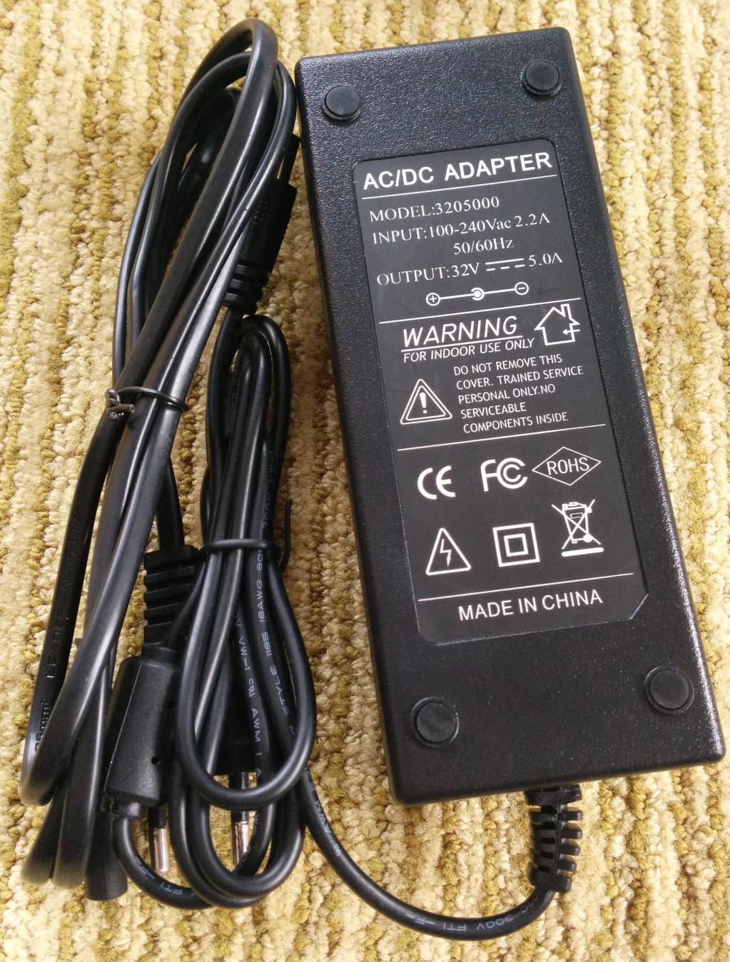

Does this 18 US dollars power supply look good enough against little power surges which are sent from nearby devices or caused by plugging it in the wall outlet?

Yes it will be fine.
Hook it up. Leave it plugged in... and just use it.
As I've explained far too often without anyone seeming to understand, that start up surge where it's feeding both it's internal capacitors and those of the amplifier can shorten it's lifetime somewhat if you keep unplugging it and plugging it back in.
I don't know how to say this any more clearly, so please stop asking.
To be honest, it's not possible to tell just by looking at the outside of a box, it will probably be fine, you pays your money and you takes your choice. 🙂
Well, if there's a NTC with a cold resistance of, say, 10 ohms in series with the input, the maximum surge will be 230V/10*sqrt 2 = 32 A, even if the device's output is shorted, won't it? The designer simply has to chose the NTC and the rectifier diodes so that they can cope with that, plus some safety margin.But you are fogetting one small thing ...
