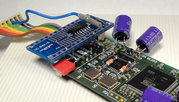

Here, the long leads mean the OSCON is not only useless, but will actually degrade performance :
Another example, much worse (see second picture). Here, the film cap and lead iductance form a LC resonator with the large cap. But the worst is the wires, which will add a lot of L, which is kinda sucks, since at the other end of the cable, there are ... more capacitors, of course. Not to mention the fact that the wire's impedance will turn rectifier current pulses into nice voltage pulses... arg.

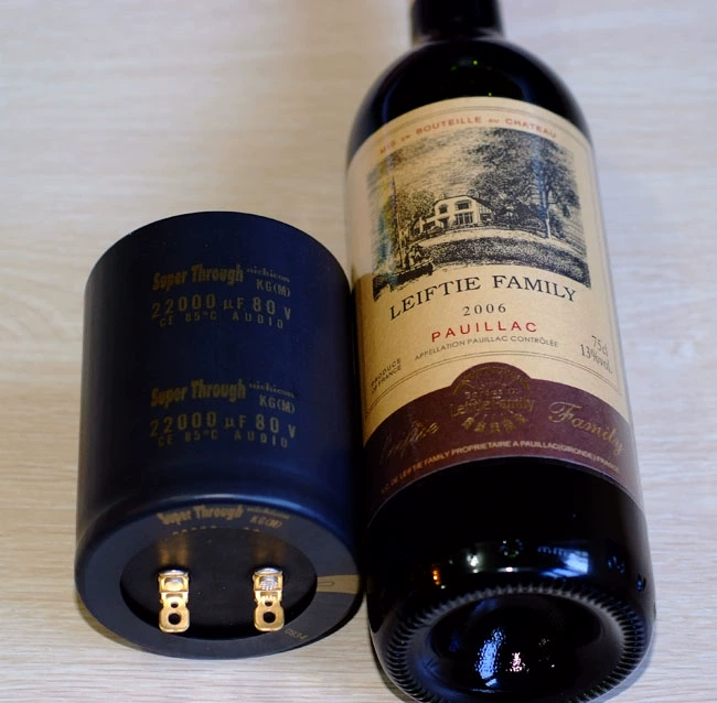

I always thought like that, specially in terms of cutting cost. A brand new Nichicon 22,000uF 80V KG series Super Through cost like a Ferrari...
ticktock why on earth would you compare a high quality capacitor (one large) to several small non-quality capacitors. I use good capacitors period, and parralelleling is wonderful. The non-believers use network analyzers while the rest of us enjoy greatly improved music.
