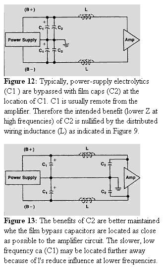

I prefer to use much closer to the audio circuit.
Where I think they will do any good.
See my attachment
for how I suppose we should use those capacitors we have bought.
... I really do not expect any reader to agree ....
but I post it anyway.
Somebody may get my point .. eventually

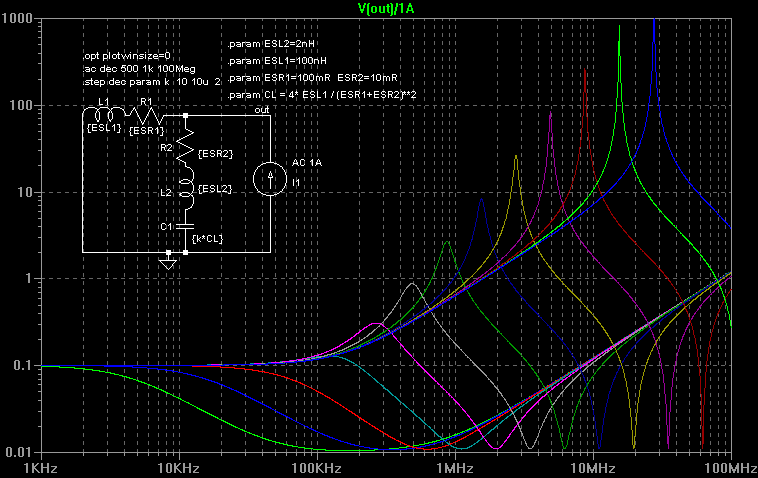

Adding to EVAs's excellent comments, I'd like to repost a simple simulation I posted here quite a while back, when this topic was already discussed "to death".
This is what happens to the output impedance when the bypass doesn't perfectly match the cap to be bypassed, including wiring inductance etc. These are the exact same resonant frequencies that EVA's ESL equation describes.
The red line is the optimum case, that is when the condition
C=4*ESL/ESR²
is satisfied (which is just another way to write EVA's equation, making some things more explicit, like not neclecting the bypasses ESR).
C is the bypass capacitor, ESL the total series inductance it sees, comprising the master cap's ESL and wiring inductance ahead, and ESR s the sum of both cap's ESR's. Now both ESR and ESL are ill-definded (one needs to measure them in situ), and ESR is used squared, increasing the uncertainity and therefore it can quickly happen that the bypass is to small, then we see the impedance peaks in the problematic region of 1...10Mhz. And this is only a simulation of first order effects, in reality it tends to be more complicated.
Bottom line, only bypass when the ESR of the cap to be bypassed is known and rather large, and try to go on the "too large" side.
- Klaus
