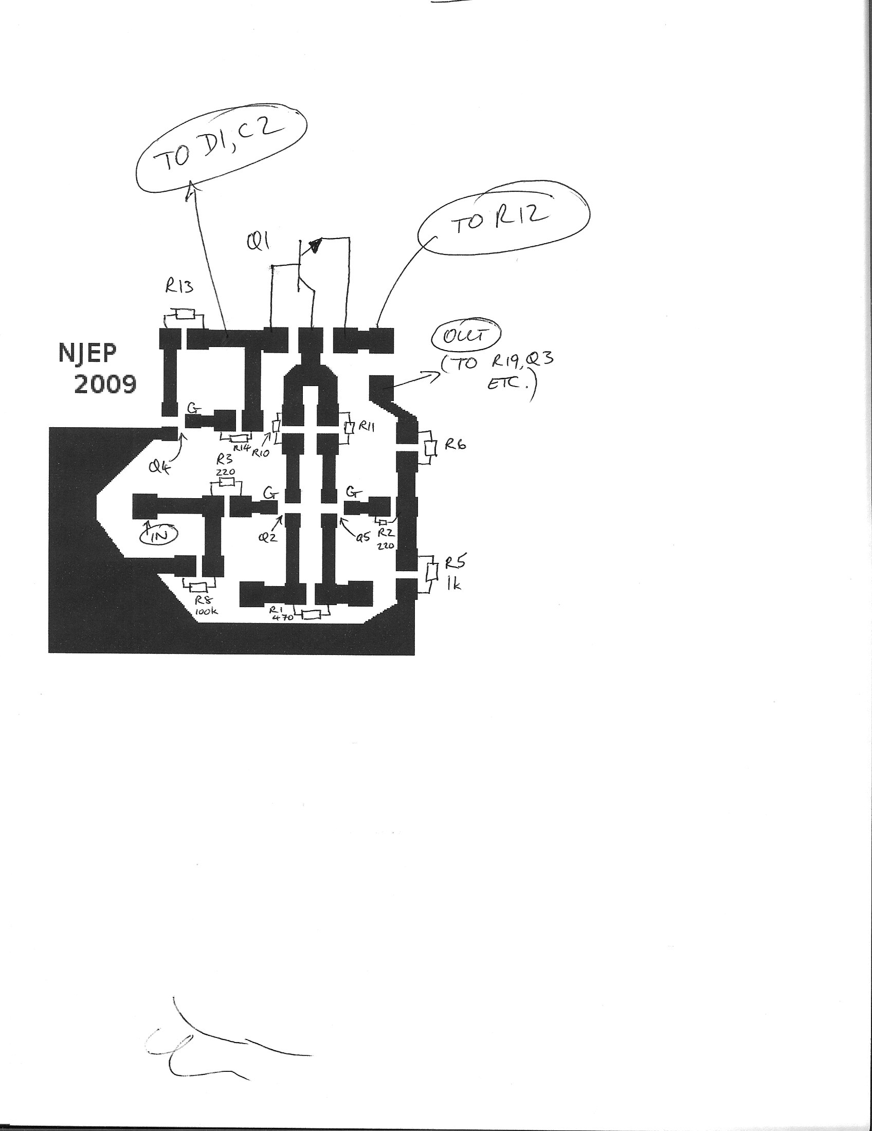

I have drawn out a plan for the (partial) PCB,and would be grateful for any comments.
If you remember from the discussion above, my plan is to use a small PCB containing all the BF862s, and with all surrounding resistors as SMD devices, which can be soldered into a larger protoboard with all the mosfet/high current stuff done p2p. I drew the file in GIMP and saved it as .pdf, but I couldn't manage to be clever and add the notations except by adding in hand and scanning ..... So here it is as a .jpg... Hope it's clear enough (and I'll happily post a clean .pdf once final version is ready if anyone cares.) The final board is for one channel (obviously) and should be square, about 2.5cm on each side. There are five or six points where there will be a pin connecting to the rest of the circuit.
Anyone have comments?

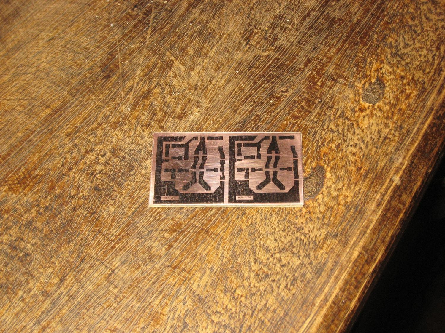

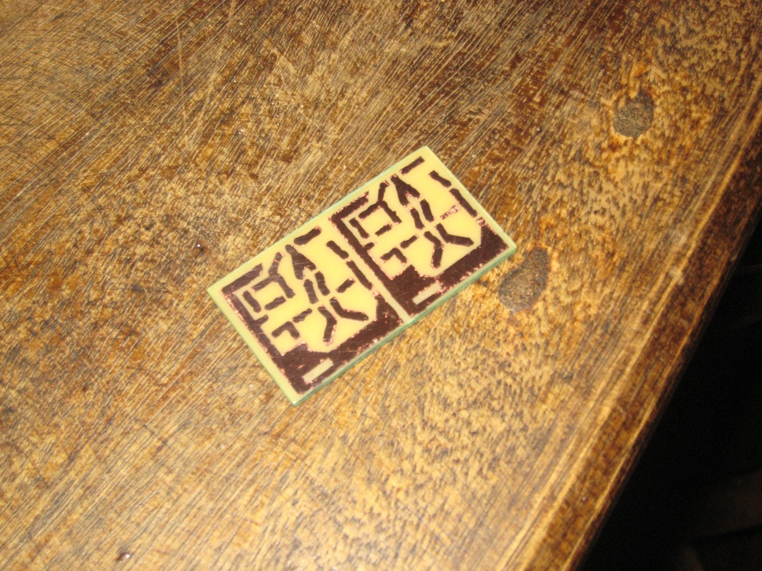

So I did the PCBs this evening. I use a laser-printed mirror image which I ironed on, and then used a pen to try it reinforce it where it looked a little thin. The final result is better than I expected, since this is my first try at doing my own boards. I've posted photos below of the boards with the design printed on, but before etching, and one of them after. In real life they are much shinier than they appear in the second photo. Oh, and the layout is a little different from the one I posted above, since I had to redo it at a higher pixel count, but the basic design is similar, and they are indeed 25mm x 25mm as I estimated above.
