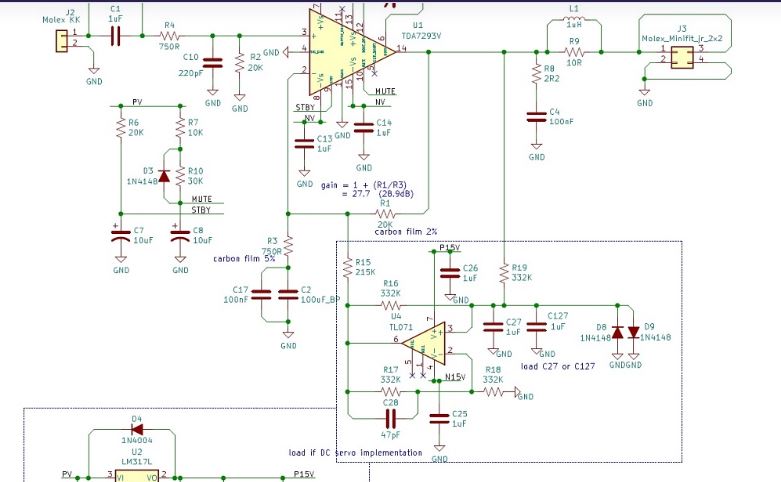

Not only does a DC servo allow you to remove two capacitors (input, feedback) and their associated poles, it can also remove DC offset from the source.I've seen many high end amplifier topologies here use a DC servo. Is it really that necessary to include this in a high end design? I'd rather eliminate the offset voltages by using high quality components and calibration as a servo seems like a patch rather than addressing the cause of the problem. For example using a differential op amp at the input whose common mode voltage can be adjusted would help.

I think it's a trick to make a non-inverting integrator using only one capacitor in the signal path, I think "load C27 or C127" means that only one of them is mounted. A disadvantage is that you need good enough matching between R16, R17, R18 and R19.
It's only a pure integrator when R16/R19 = R17/R18, otherwise it's either a damped integrator or a circuit with a positive real pole. In the latter case, the integrator is unstable, but not the entire amplifier; you just get worse suppression of the offset, like with a damped integrator.
It's certainly original, I've never seen a negative-impedance converter in a DC servo before.

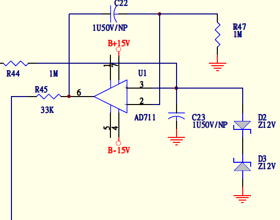

The attached schematic is from Parasound. I notice that they use two back-to-back zeners in series thus limiting op-amp input voltage to approx. +/- 12.5 volts as opposed to other implementation where the input is limited by two diodes in anti-parallel, limiting input voltage to about roughly +/-0.6 volts. What are the advantage of one over the other?

If yes i think this is to protect the servo from potential overvoltage ( from amplifier stage which use higher voltage rail than servo's one): theorically the servo works on restricted voltage range to reduce dc compared to the 'amplifier stage core'.
Thanks, this makes sense.
Krivium: Yes this is from a Parasound A21 power amp (approx. 300w).
EdGr: So I guess the diodes will only serve to protect the servo from secondary damage in case the output stage is driven to full rail DC-voltage in case of a major failure of the output stage by limiting differential voltage on input 12-volts. I.e a couple of volts below the 15-volt supply used on the AD711.
The schematic in post #15 above uses D8 / D9 to limit the diff voltage to +/- 0.6 volts on the TL071 input, guess one solution is as good as the other.
