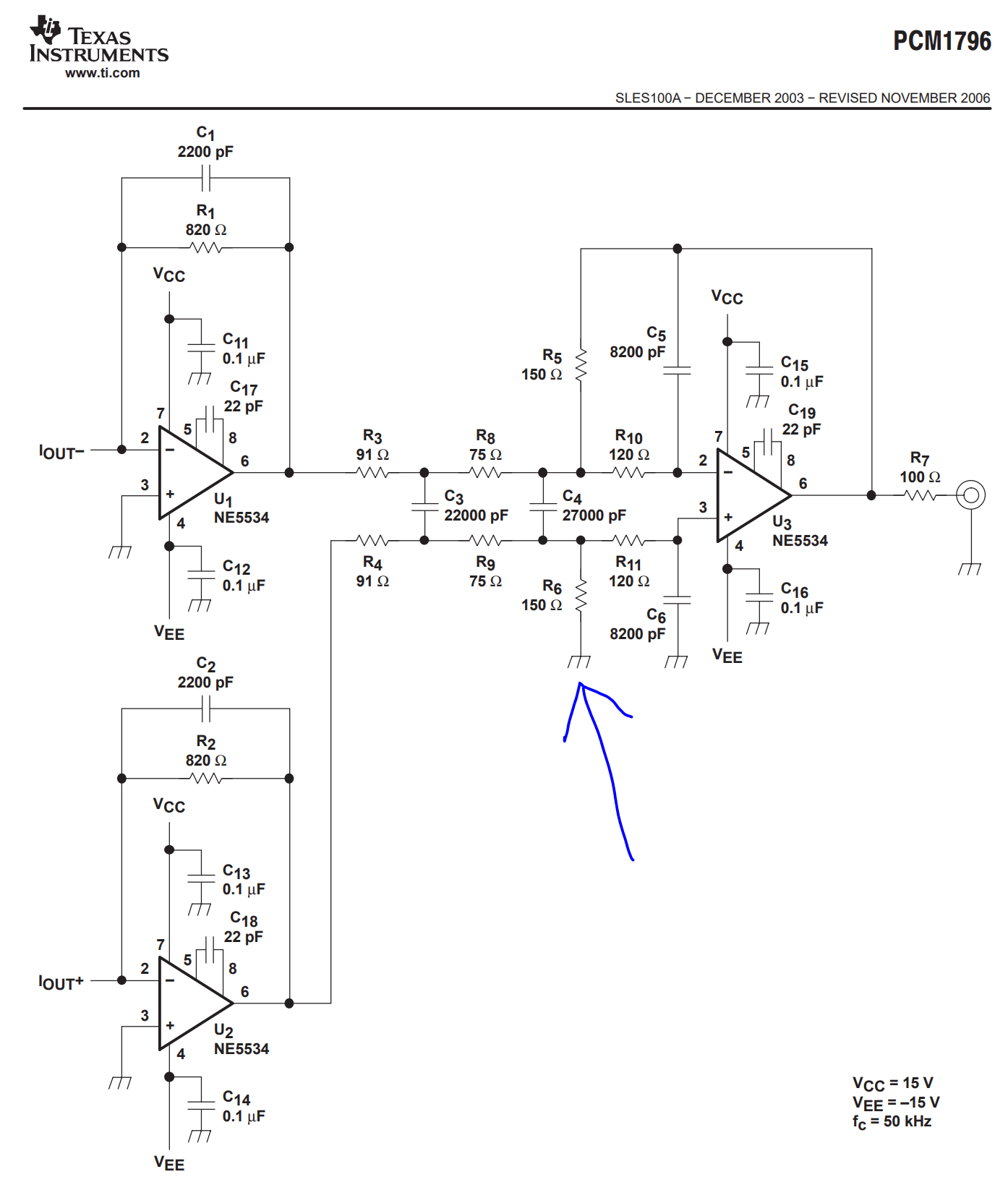

Is a budget DIY balanced DAC feasible from a cost effectiveness perspective
Conversion of single ended to balanced won't add much, on the contrary. Making the DAC having balanced outputs is work but one learns a lot.
Kicking in an open door alarm: of course it is most effective to buy/build/choose devices that already both are balanced (or both unbalanced) 🙂 Any other combination is called a "system choice" so error by own choice. The challenge is then to make the partners work together which costs time, energy, ingenuity and elbow sweat.

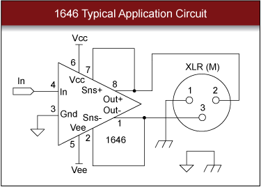

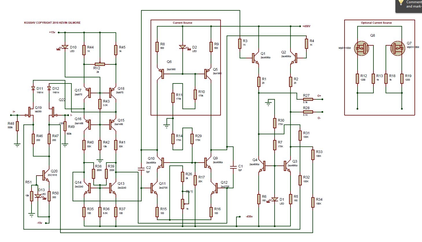

Don't have that. Did find some version of a schematic of the kgsshv HPA to be driven. Lowest cost would of course be go unbalanced, or else passive balanced. Considering the expected SQ of sdac (AK4452 based design), not sure it makes sense to throw good money after bad.
That said, cheap and easy way to balance would probably be with 'budget' transformers. No +-15v required, simple to implement, etc. https://www.aliexpress.com/wholesal...15042005&SearchText=audio+transformer+10k+600
