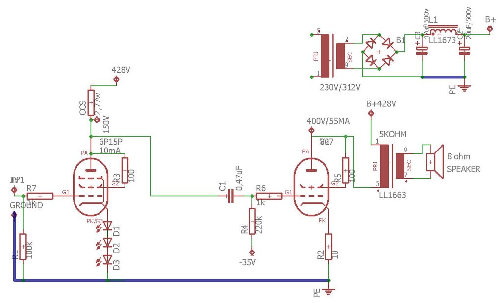

Anyway I started to rip appart the EL34 amp to (hopefully)use the chassie for an 807 amp,(no IT trafos) I am going to use CCS for the input tubes, might try 6P15P,what current should it run at?

EL34 is better than 807. 6P15P works like a charm on 10-15 mA.

What voltage do you run them on with 15mA?Triodestrapped.6P15P works like a charm on 10-15 mA.
150-200v?

The graph is above. Just draw your load line and see what kind of swing are you getting as the result.
I´m not really shure about loadline and CCS.
But if the bias point is 150V/10mA and I use a input signal of 3,5vP-P do I get about 100v p-p out?
Another question is this the formula to calculate the OPT impedans?
Z = Va^2 / Pa
Z = Va^2 / Pa
Ok at 150v/10mA -4,5v I should be getting 98v p-p,then it should be able to run a 807 to fully out?

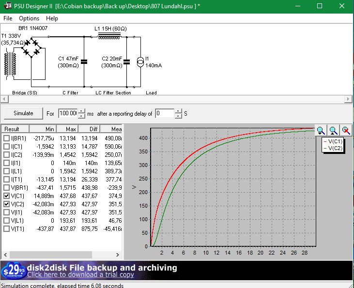

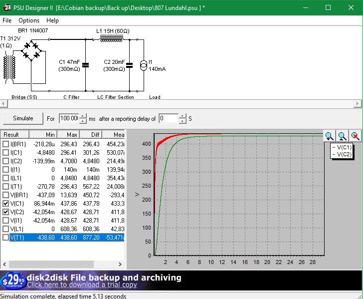

Been working on the PSU on the Schema above,and all voltages seems right.
trafo 312v ac x 1.41=439,92v at C1,428v at C2.Currentdraw 140mA.
Except one thing ..the secondary winding is 1ohm.
Could this be right??
