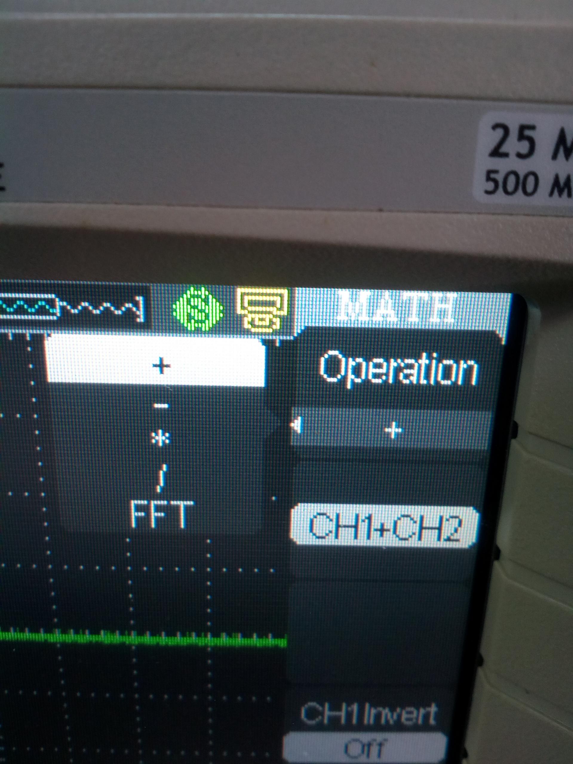

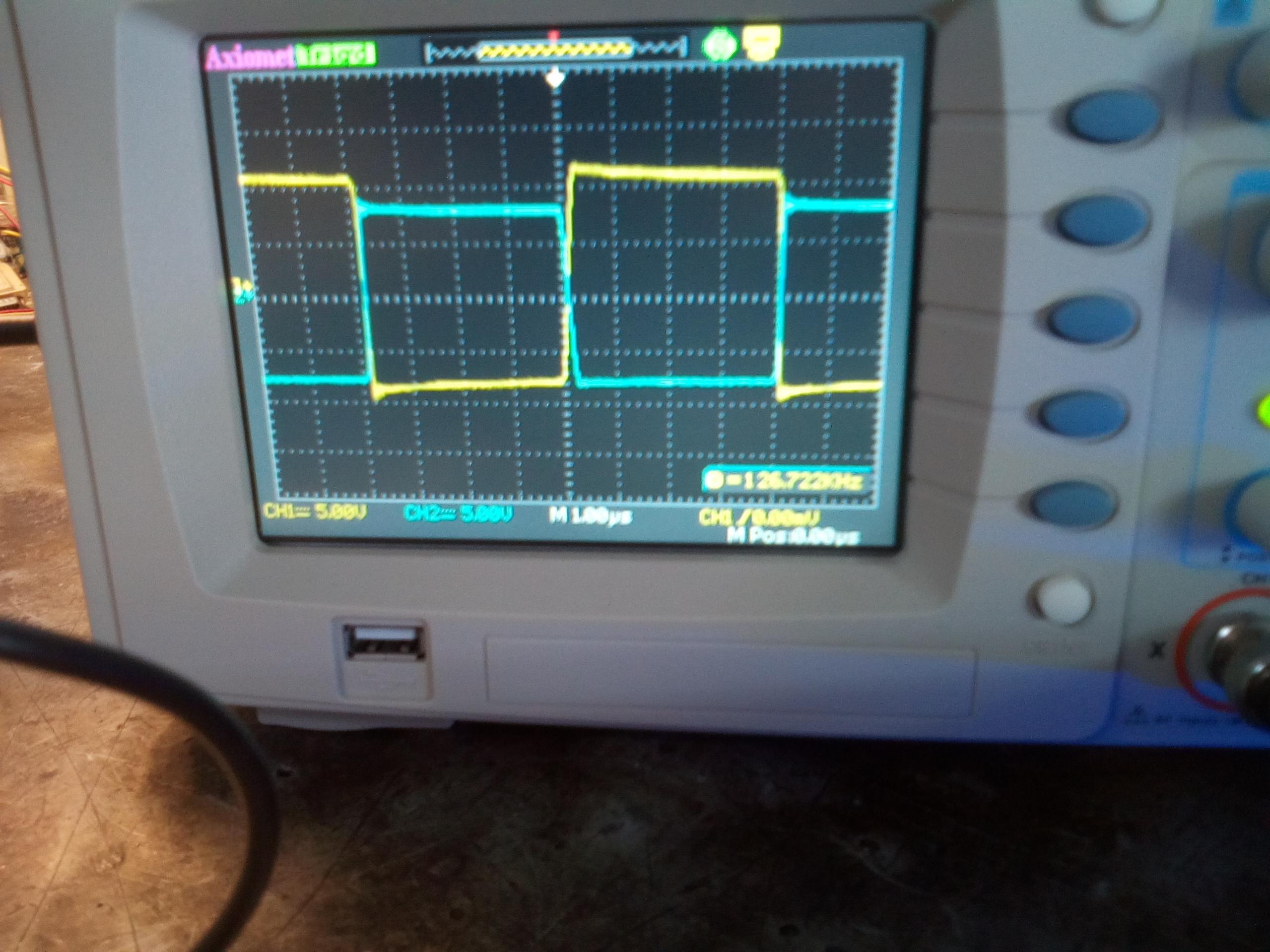

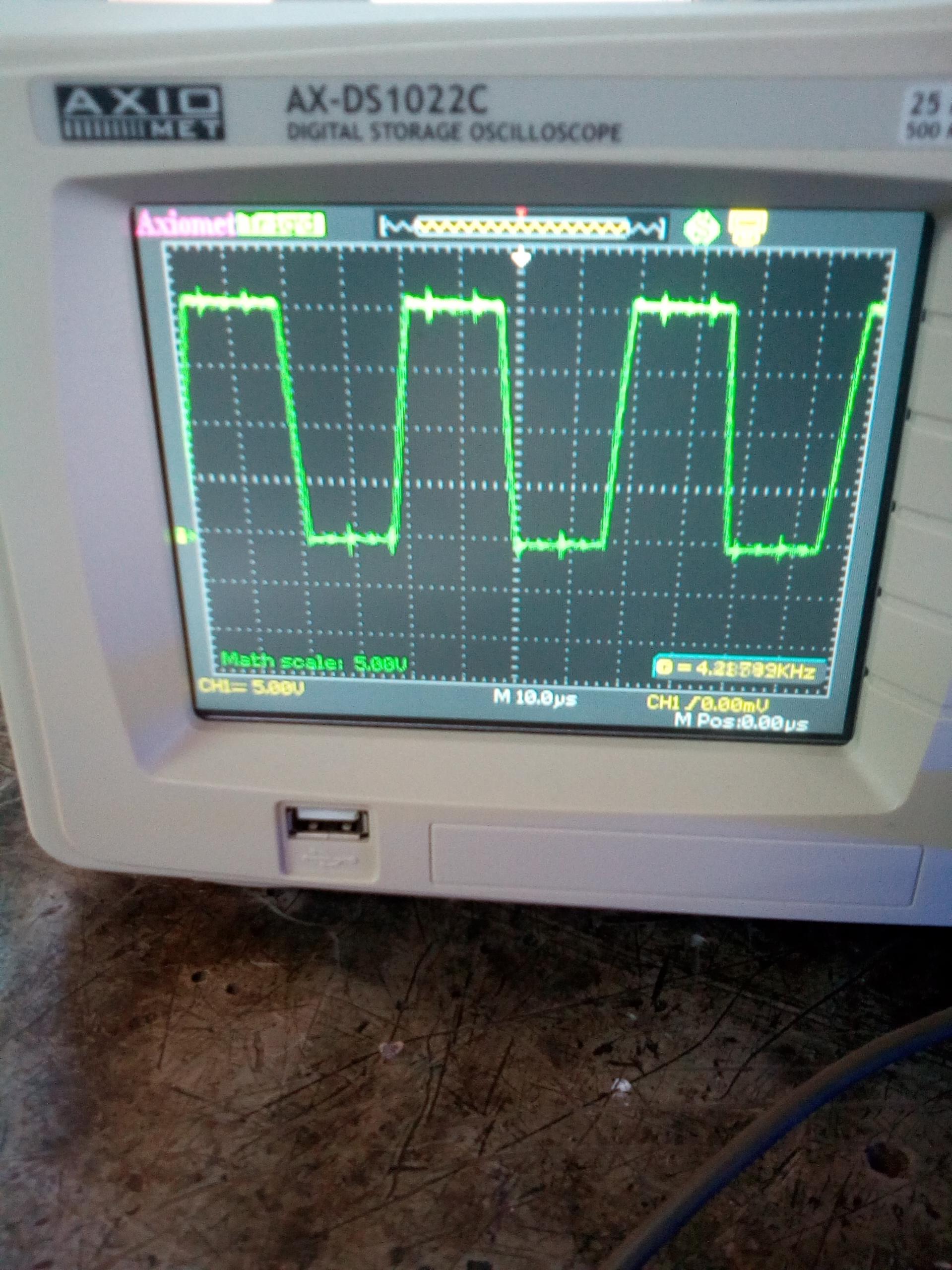

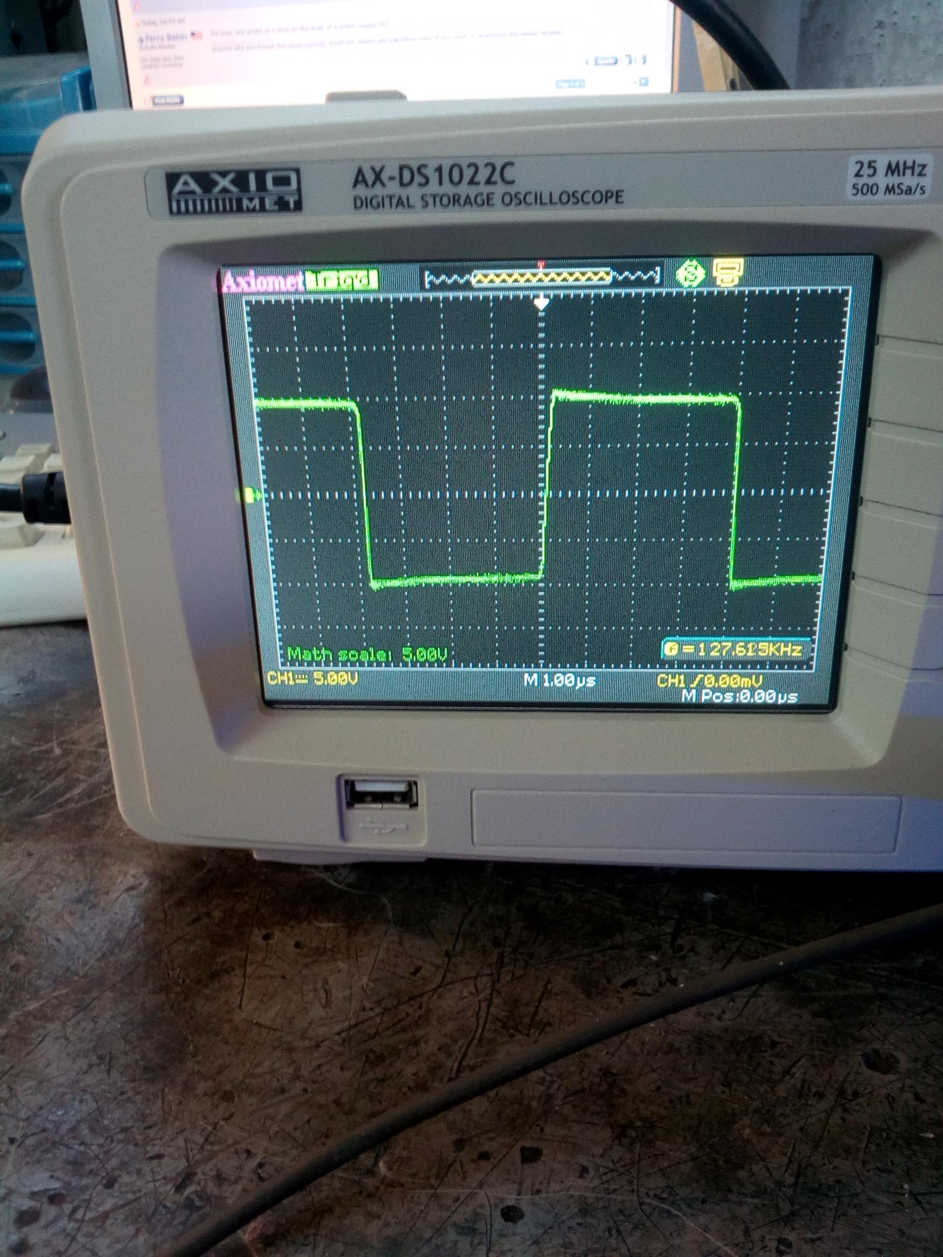

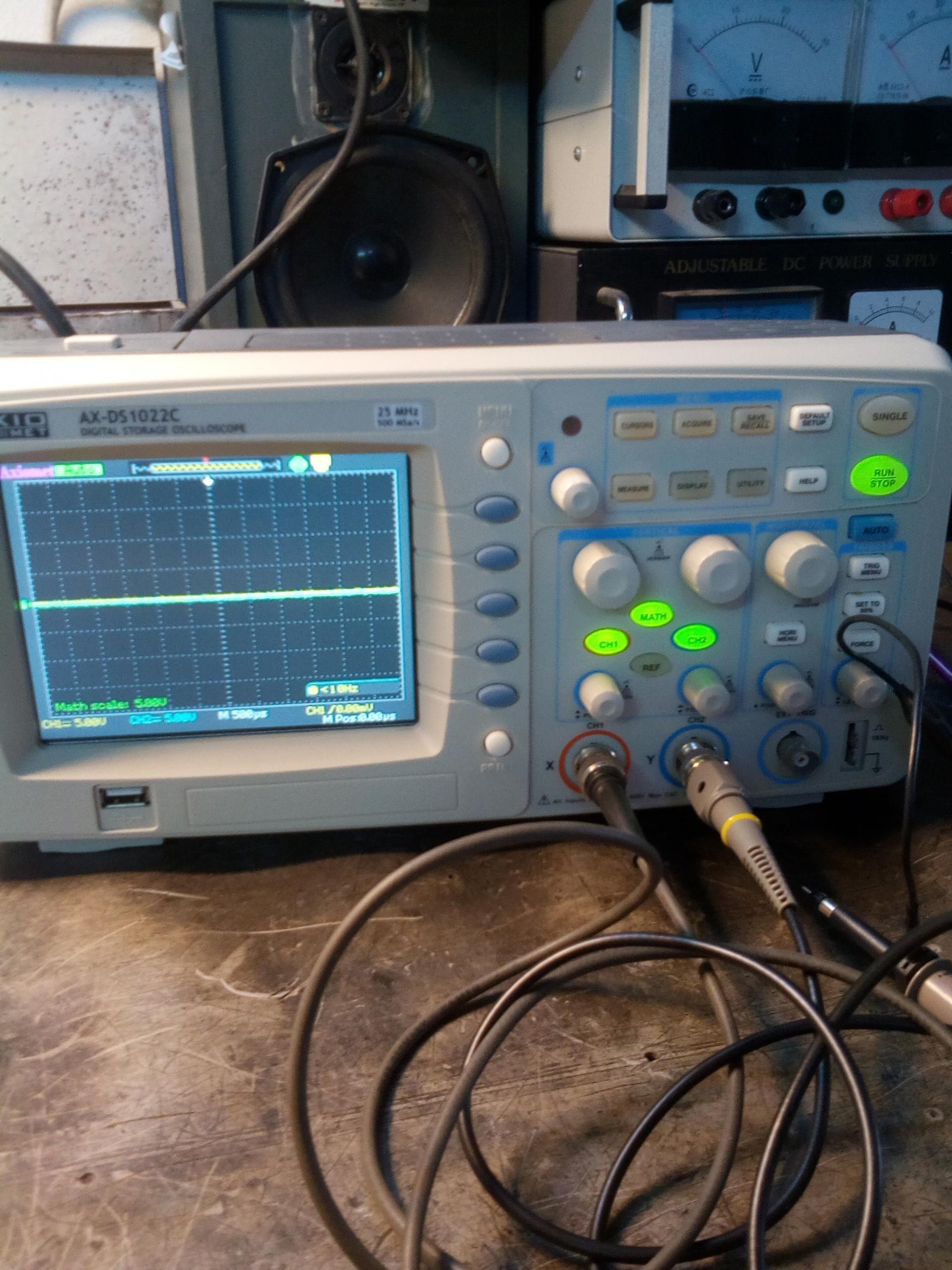

That's not how it's used. Differential mode turns the scope into an isolated scope where you use two probes on the same component to measure things like the drive signal. This gives far better resolution for signals that are referenced to the rails.
Take both probes and touch them to the drain/tab of a single PS FET. Post a photo of what you get.
You should have only one trace showing, not two. You missed a setting somewhere. Probably the 'add' setting.
