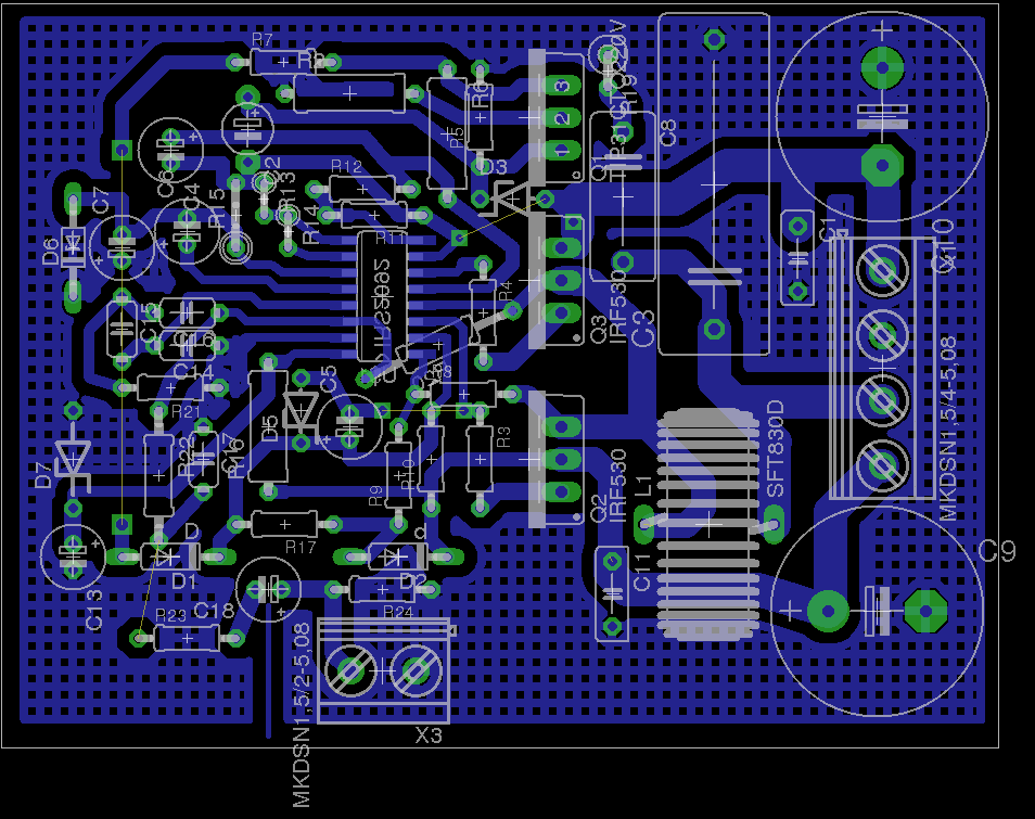

Hi.
Can anybody tell me whether it will work?

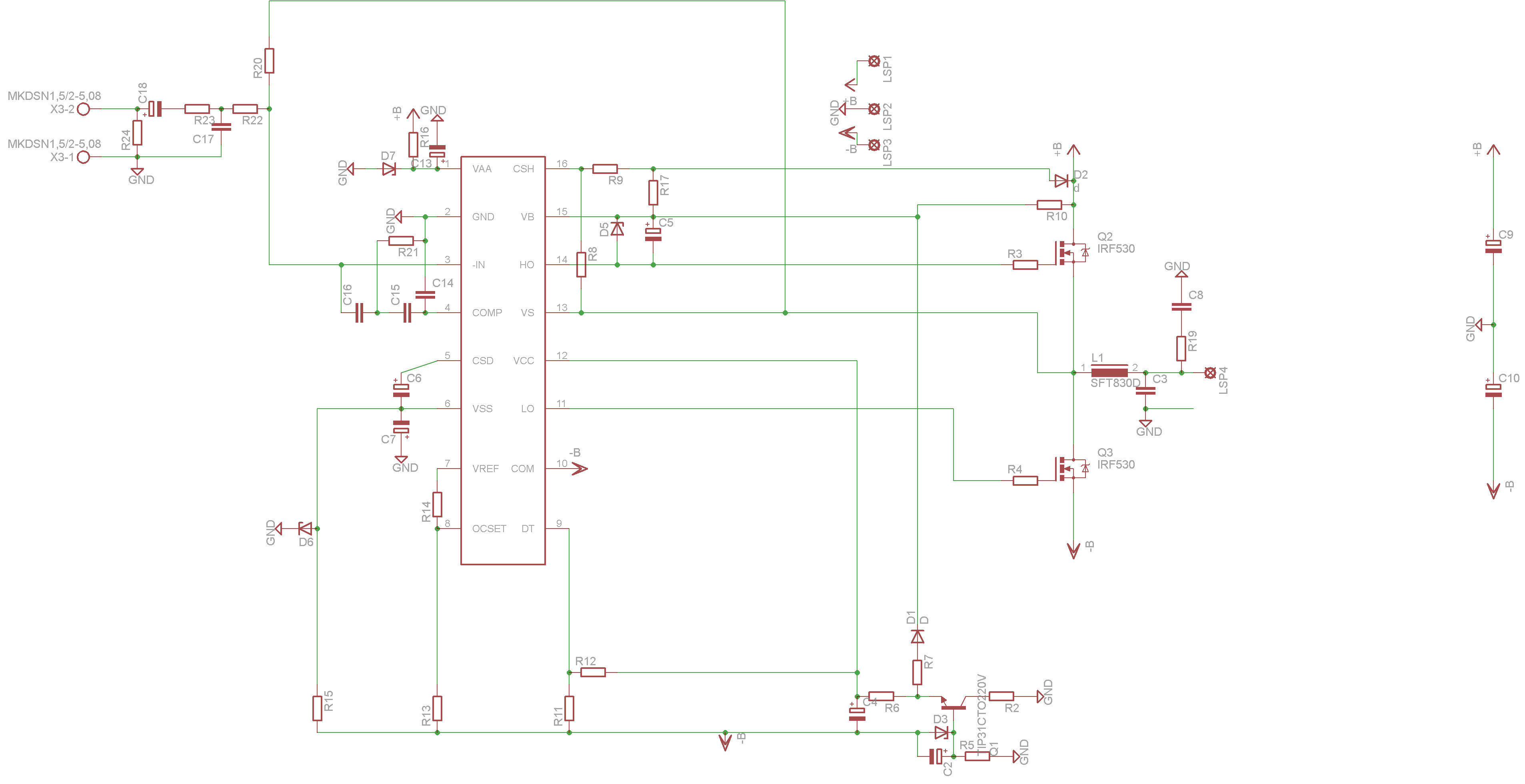

hi,
this is a basic way to use ir2092.
No need to use high side external zener.

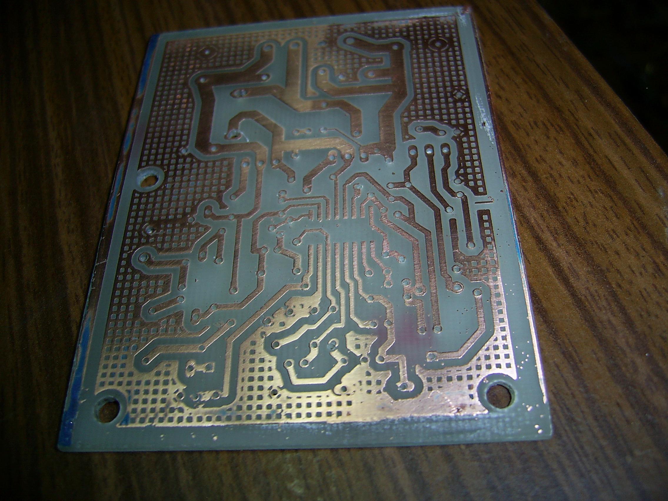

Double side pcb , using the other side as shielding would improve your Project and some smd 0.1 ceramic at switches from +B to _B as well.
Good idea but high frequency device can work properly on this PCB? Routes are as short as possible, but I'm only hobbyist...

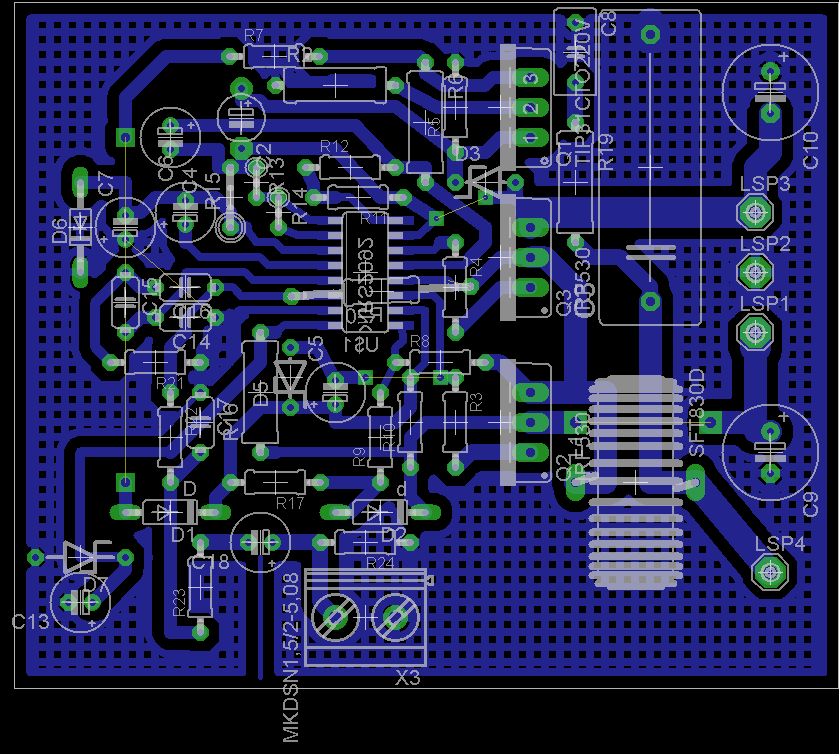

I cant see much decoupling.
The 2092 and the mosfets need decoupling closely.
The layout needs to be as tight as possible.
Better now , but could be better if you move the coil and out cap to the place of electrolitics decouplers and place them nearer the MOSFETS.Try to make vs conection thicker .Keep in mind you have to place 0.1uF as close the MOSFETS you can.Place all the circuitry from pin 1 to 6 nearer 2092 to avoid pick emi .

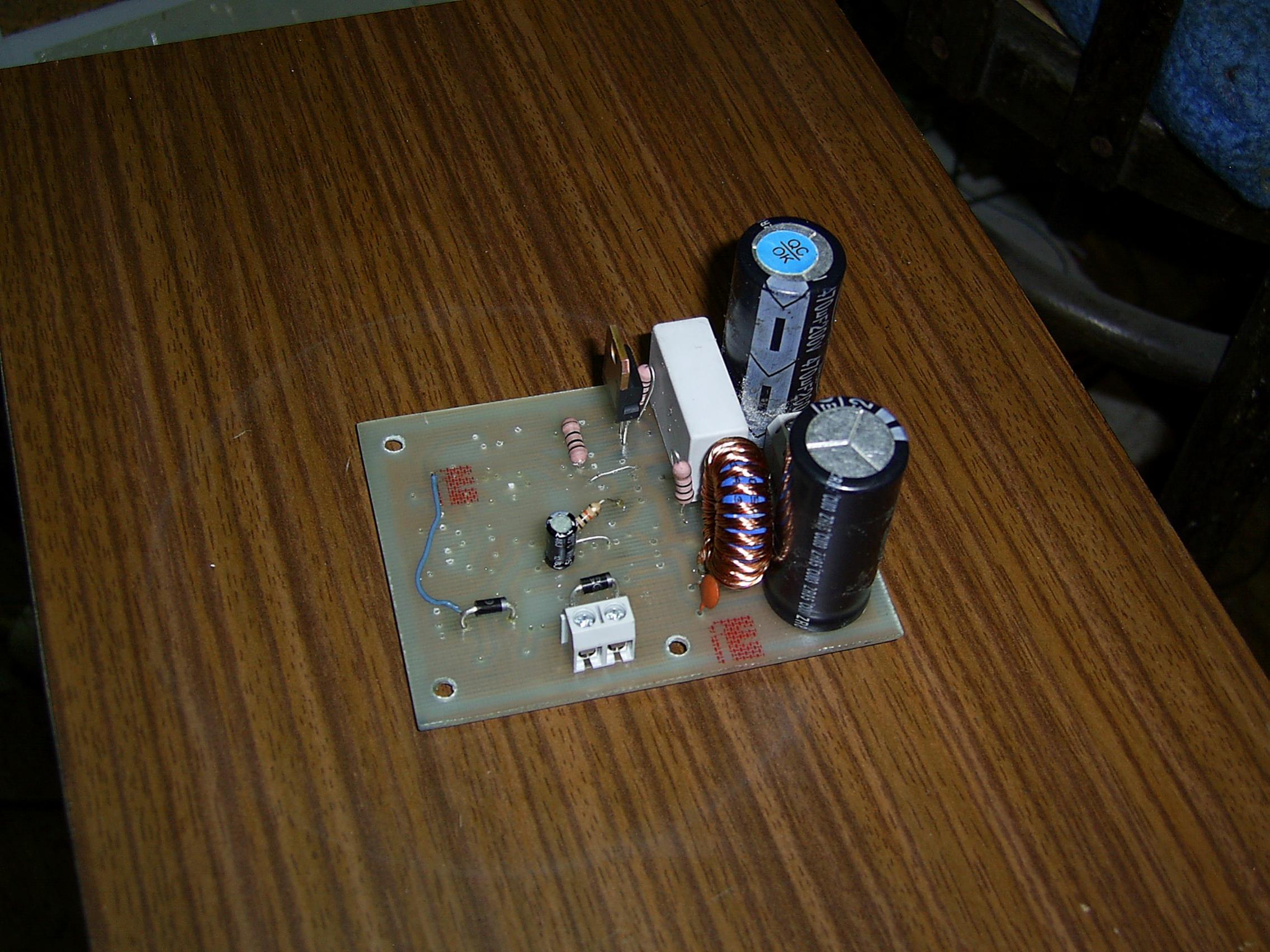

The most of parts arrived, if everything is ok, I will put it all together on this board and turn on...

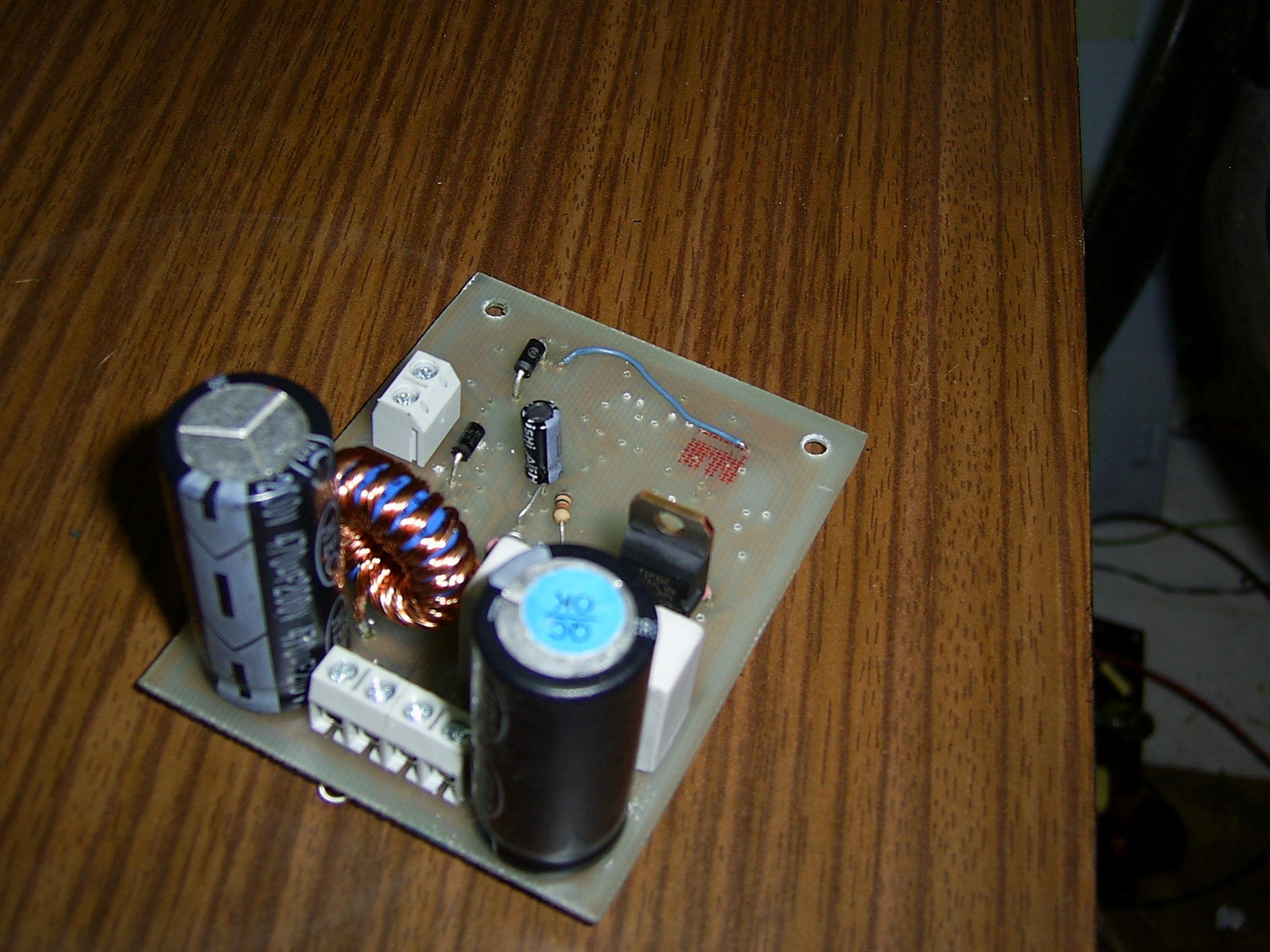

Done, amp was playing, but when I had disconnected speaker, everything on PCB was hot and in a moment IRS and fet-s burned.
Unfortunately there wasn't C8A and heatsink, I have connected additional parallel resistors to R117A, R118A, R17A, because amp was clipping, when power supply was circa 2x35V, is possible that leads of that resistors was to long?

The 2092 doesn't like not having a speaker connected.
The output will have lots of high voltage ringing from the output filter choke and will probably fry the output filter capacitor.
