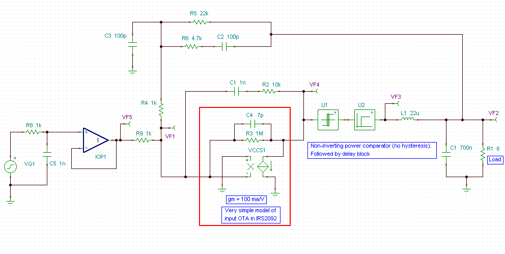

Hi Pafi, perhaps I was a little too hasty in saying this can't be done. I've been doing some SPICE simulations of a configuration where the post-filter NFB is taken to the summing junction at the input op-amp. It does need a reasonably fast op-amp, (though nothing exotic, I was using an OP37 for the SPICE sims). You have to be careful about the dominant-pole frequency compensation of the op-amp, as well as the NFB network to ensure it will be stable with all expected input signals, as well as oscillating at the desired frequency, but it does give much lower distortion at low frequencies than the standard 'Philips ap-note' UCD circuit.
This configuration described abaove is different from Bruno's schematic in his AES paper, where he shows an input op-amp providing an active pole, but where the switching signal NFB path is still feeding into the comparator. In my simulations I have a single NFB path feeding into a summing junction at the op-amp. The comparator input is connected to the output of the op-amp only.

This is the sort of thing I am looking at for the 2092. (At a very simple simulation level in TINA).
The complex frequency compensation network around the OTA in the IR reference design is required for their pre-filter NFB design, but will not work in a post-filter design. My sim schematic shows a simple C-R compensation network across the OTA, which works well, but of course my OTA model is a simple VCCS, with feedback to set the maximum gain at 60dB, and a single pole roll-of.
Might be a starting point for others though.
