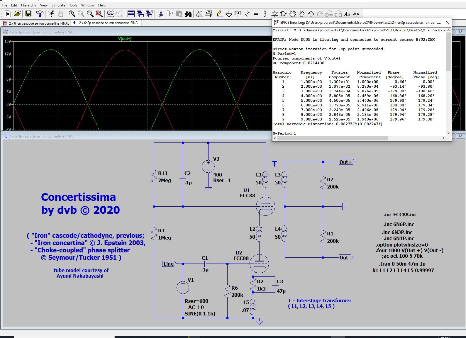

Having read the good writings and ideas of Lynn Olson, mentioning N. Crowhurst and D.E.L. Shorter from BBC (Illusion Engines)

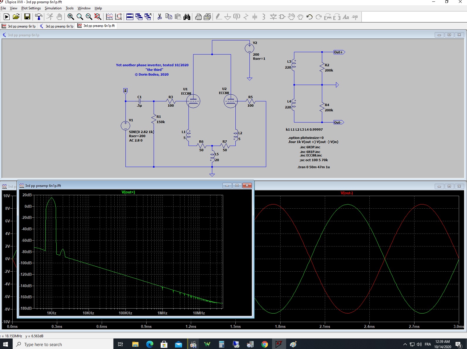

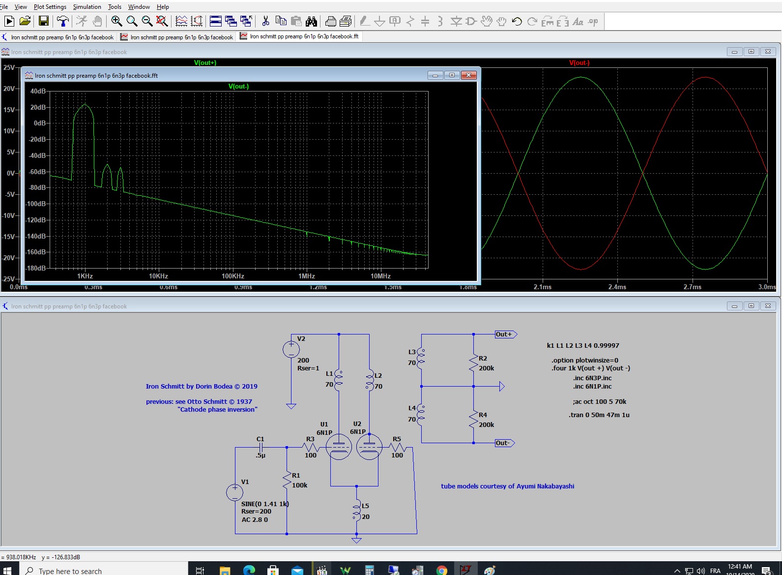

I have decided last year to imagine some transformer based phase inverters aiming to obtain the lowest THD possible and consequently using small amounts of negative feedback, if any. The classical phase inverter in which the primary is driven in single ended and the two secondaries are winded in phase opposition is no good for me, the THD levels are too high and the phase shifting begins at around 14-15kHz.

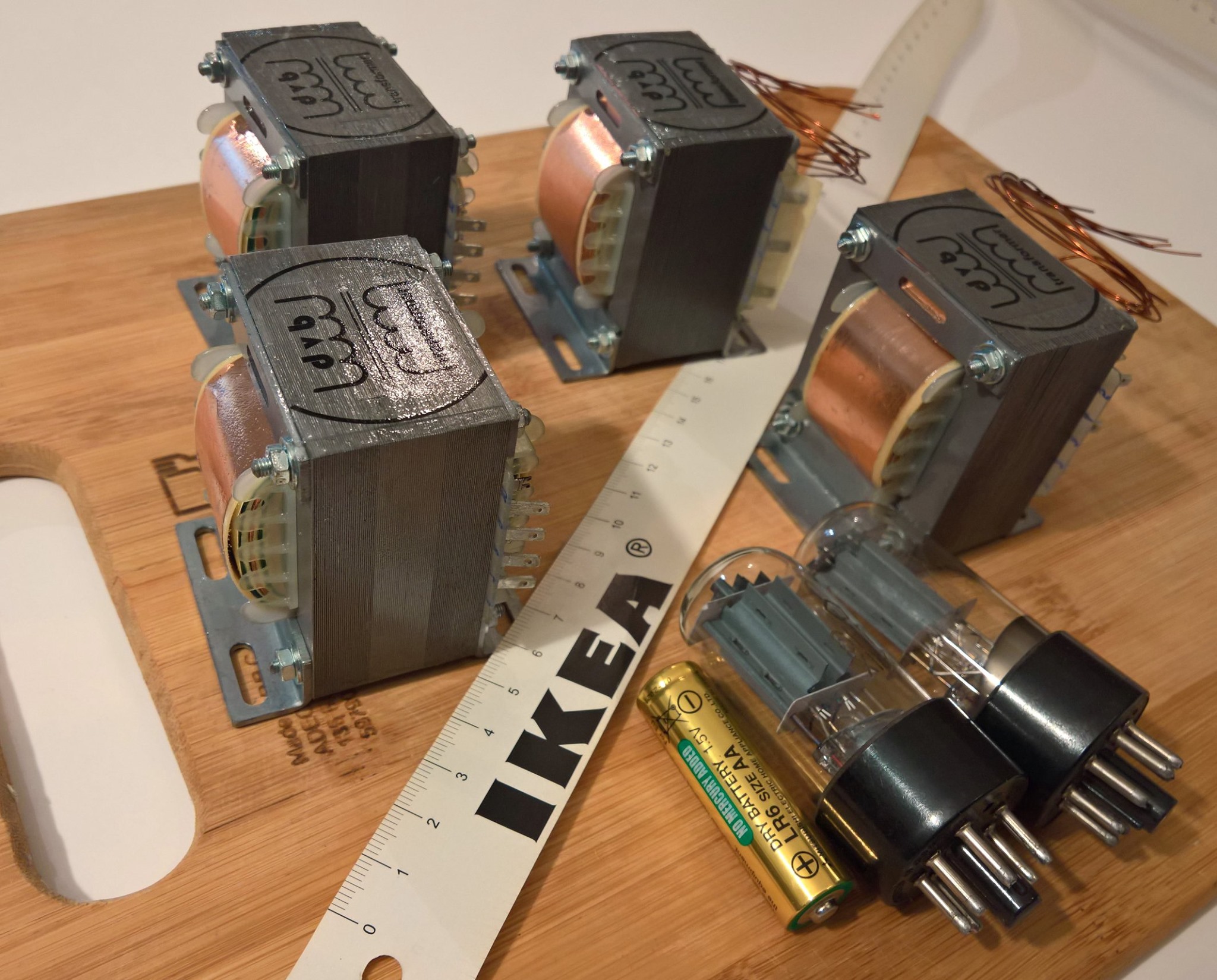

To the best of my knowledge the following 3 circuits are new but please feel free to correct me just in case you have seen it elsewhere. In all these circuits I have used transformers made by me, of a special/custom design, after countless hours of tests and "trial and error" attempts. "Iron Schmitt" and "Concertissima" are built around CRGO/GOSS, while the last one is built using permalloy 47% core. For the time being I can't tell more about these xfmrs but this situation can be changed in the future, we'll see...

The output stage is the main source of THD, so what is the point to reach 0.05% at phase inverter when the output tubes generate 2...5%?
If you use ultralinear or triode mode the THD isn't so high... but you have a good point, nonetheless.

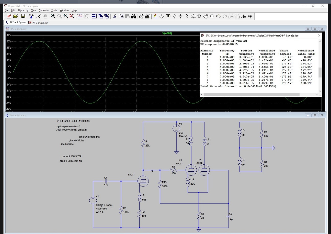

Now, try to imagine a PP using "Iron Schmitt" and 6AS7 as final tube... this tube has a healthy region in A2.
What you've shown to us here are just phase inverters with transformer coupling to the next stage, as phase inversion still happens with the tubes. Anyway, due to the transformers' relatively small primary DC resistance when compared to conventional designs, higher signal swings are possible especially with your Iron Schmitt and your totem pole (I'd not call them similarly with Concertina). I'm not sure about that with your 3rd design, though.

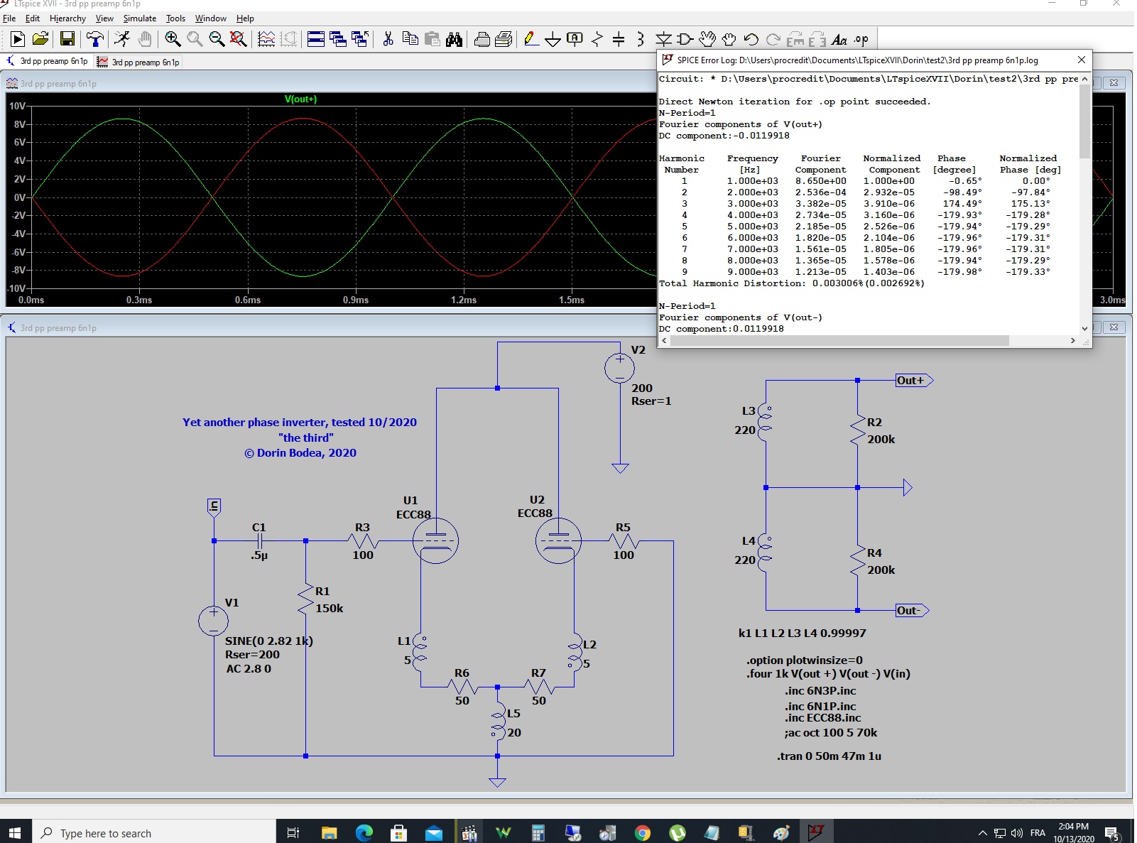

Yes, that and one more thing; if someone will try a LtSpice simulation (or whatever simulation engine) will see that using two dissimilar output resistors, say, 200k and 20k, the signal will still remain equal on those two branches...
"The third" is based on cathode follower principle, where the higher gm the lower output impedance. Here tubes with gm=12mA/V and higher are suitable, but the voltage amplification is done by the xfmr

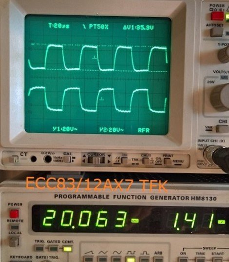

This is the very first "Iron Schmitt" prototype, not necesarily optimized very well, still demonstrates its potential... 10Hz-50kHz sweep, 2V input, output about 2x30Vrms out...
"Iron Schmitt" driver - phase splitter interstage transformer - YouTube
Second video with this basic setup...
"Iron Schmitt" 6N1P loaded with my own 6k6 PP into 8 Ohm 3.5-35kHz - YouTube
Your first and third sims are missing L5 from the transformer statement. Are they (L5) separate chokes in those circuits?
Nothing is missing, L5 is an audio choke built after "parafeed" rules, meaning minimal capacitances. It can be avoided with the disadvantage of complicating the circuit a little but is not worth it because THD will be anyway higher w/o choke. I have tested both variants.
When I started playing with these inverters I've also considered a variant with 2 extra windings, as in local reaction, sort of... but as I said, the circuit with choke is better and simpler. You can see the choke as a constant current source, the most vintage one

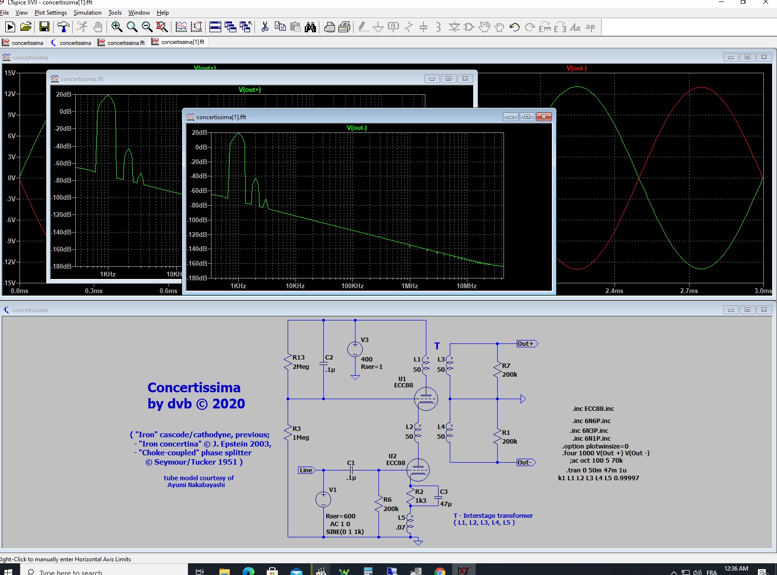

Hi Dorin,
Have you considered a MOSFET Concertina for testing / comparison? THD can be quite low, I tried...
Regards, Gerrit
Not yet, I doubt it will work in A2 (AB2) capacitors coupled. I also try to use less sand (silicon) . This can change too in the future, nonetheless.

"Decent" is a good choice of word, I'm aiming a little higher, by circuit design. If you ask Bud he'll tell you that classical interstages 70-80 years ago can be improved employing new, better materials, but not 2-3 times better.
For the specs you mentioned that IT transformer should have at least 40-50H in primary and 2x400-500H in secondaries... this is hard enough to achieve. I've done it, but as I said, I've obtained much better results with my new circuits.
I've not mentioned yet but my interstages have rigorously same Rdc for corresponding windings, obtained using a hybrid winding technique, proprietary in fact.
