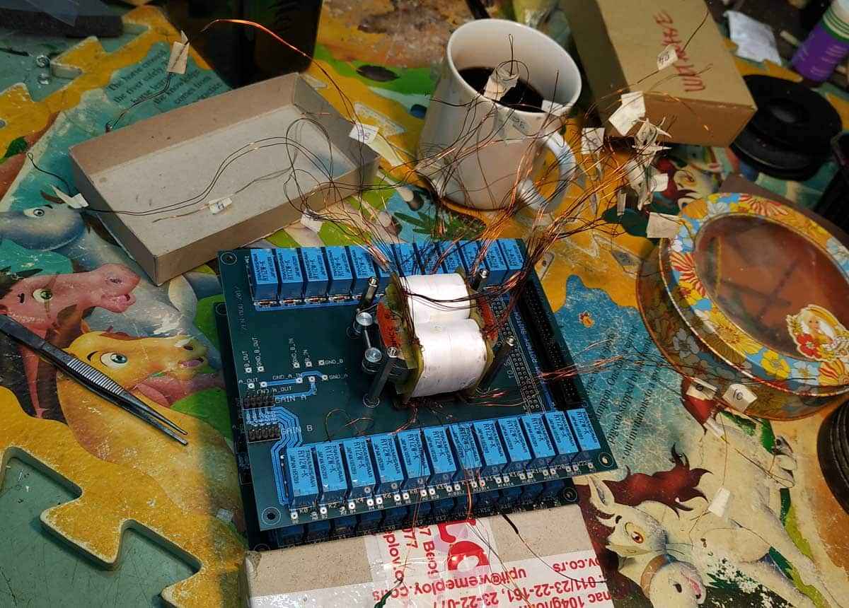

this piece - fully balanced/differential Iron Turtle AVC - from bare pcb to fully assembled unit - no more no less than 24 working hours**
of course bobbins pre-wound by my (crazy ) guy
**am I just slow or I'm also old ....... that's 0.2mm enameled wire , 100 ends , of which 8 are single/solo strand , rest are double strand

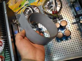

if nothing else , it'll do (taking care to not make short circuit with mounting method)........ though - if donuts are nicely made , you're good even without screening
I did use , this time , same thing which boyz in Donut production are using for magnetic screening - I believe it's same strip of which cores are wound
made two turns then rolled it with Tesa cloth tape , to look faaaaancy 🙂

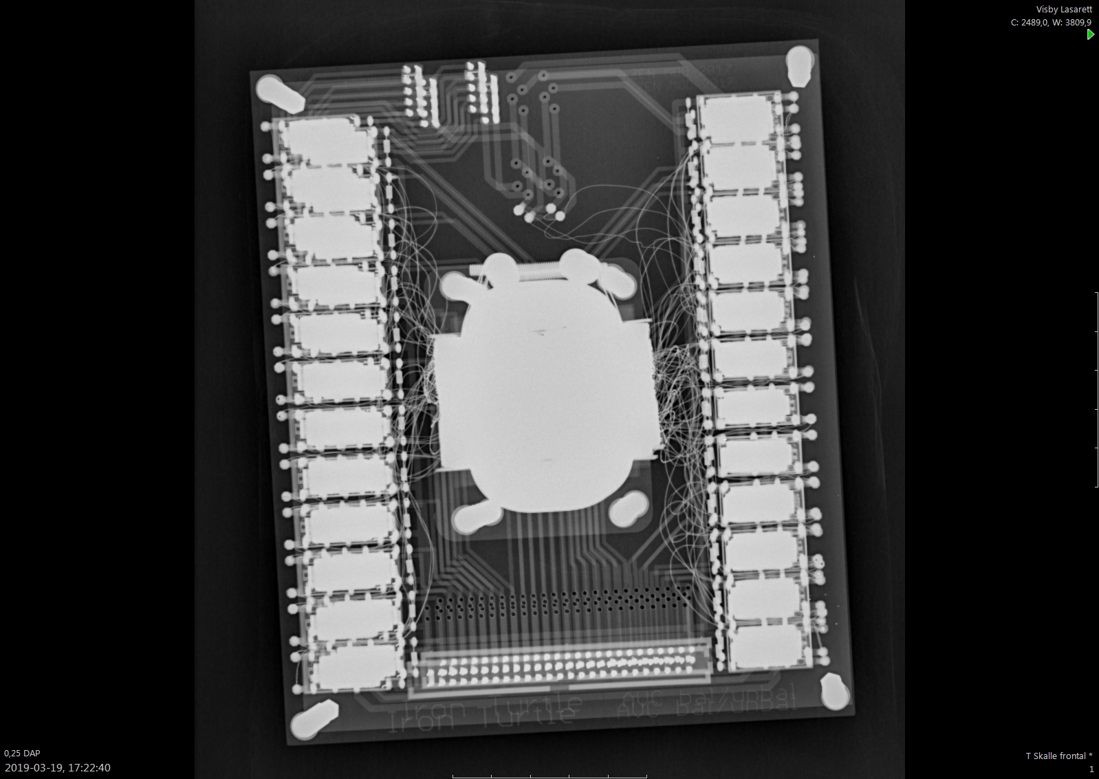

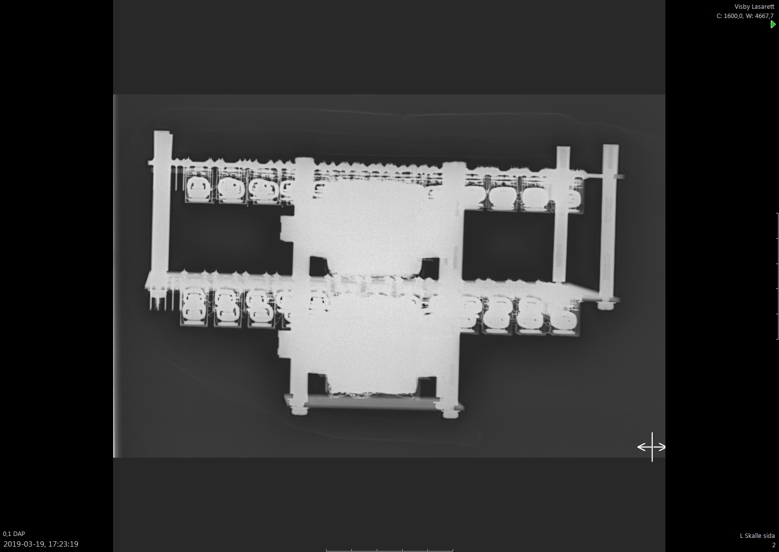

August: X-rays with 55kV and a few mA. Next time a 3D reconstruction from 140kV scan?

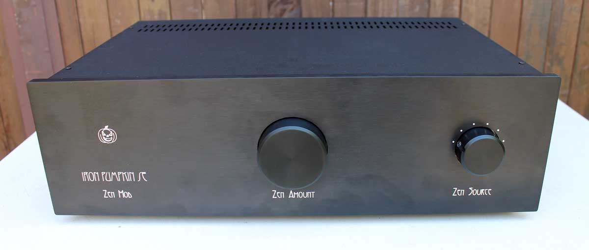

Opened package, carefully removed the black box inside. No external damage seen, front panel layout is perfect-big knob in the middle for Zen Amount, smaller one to the right for Zen Source, ID and logo to the left.
Ergonomic perfection, big one in the middle makes the noise.
So what next?
Well, turn the knobs, of course.
Zen Amount rotary switch knob size is not just for looks. Some leverage is helpful to reduce torque required to move from step to step which occurs in approximately 12deg of rotation with a very positive, very smooth and solid mechanically sound fashion.
It is very satisfying to operate.
Ditto on a smaller scale for the Zen Source.

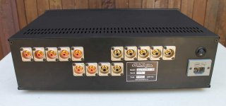

On to the back panel. Neutrix everywhere-Bravo, ZM.
The numbering sequence for the inputs is a bit unconventional. Signal (R) are grouped to one side as are signal reference (Bk) on the other, and numbered from 1 through 5 right to left.

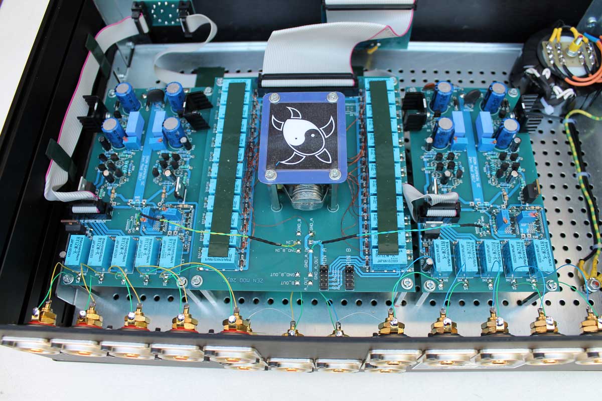

Oh my, even prettier than the pictures, she is. Gain jumpers are both at 8db, better move those to 0 as my Aleph J with a unity gain pre provides more than adequate power for my situation.
Also, please observe that the signal wires are all the same length and well spaced from each other. Remember the "odd" grouping and numbering of the input connectors?
All is neat, tidy and laid out thoughtfuly.
Very well done.
