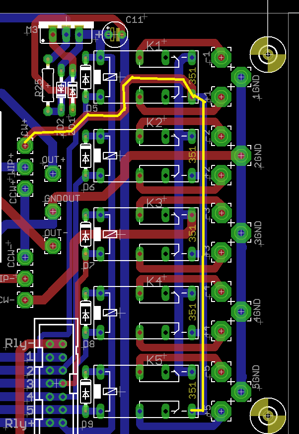

it can't be Cinemag
CW pad, when nothing soldered to it - is connected only to common signal of all input relays
I wrote that already
and now - really there is no other way than to use beep on your DMM and eyes and brain and solder iron
you need to check trace connected to CW pad for short to GND, not "relay and diode"
it must be something visible, veeeeery small possibility that pcb got ooked from pcb factory

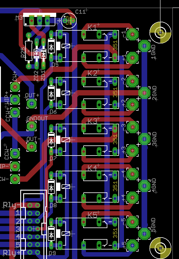

see enclosed, trace marked with yellow line
clean pic too, for clarity

it can't be Cinemag

Get beep with DMM in diode setting, when probes between CW+ and K1 (0.2ohm)
it's not just K1 pin, trace is common for all 5 relays
if you can't see any whisker or solder bridge (use strong light, lens), then you must desolder all 5 relays
be patient doing that, to not melt them with excessive heat
