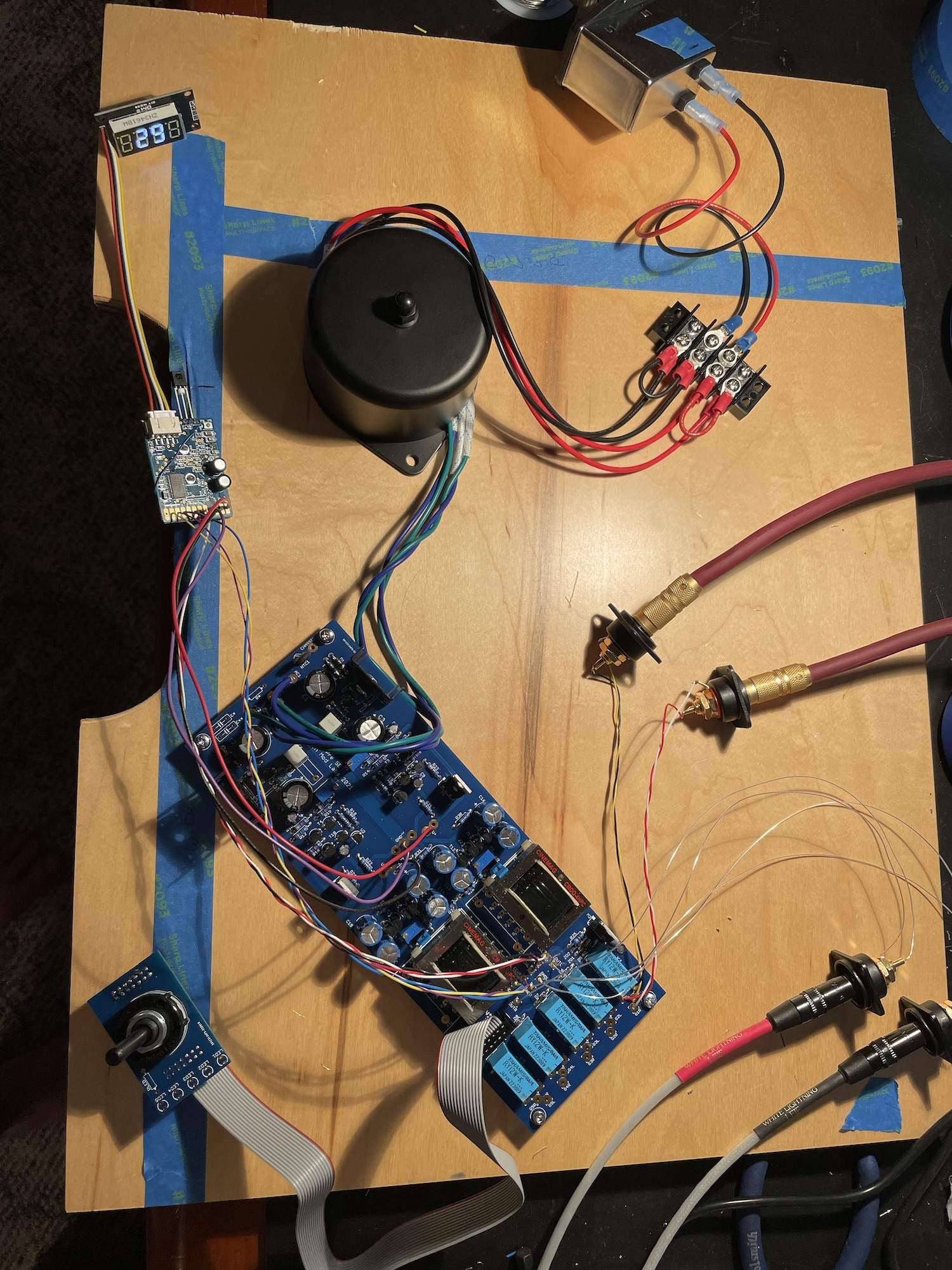

It works! I jumped in the deep (for me) end and ordered a MUSES board from Academy Audio. It seems to work like a charm. I need to read IAIMH's gain musings (pun very much intended) more closely, as I'm a little surprised by the amount I have to "turn it up" on the 6db SE Iron Pre compared to the zero-gain preamp things were plugged into beforehand. Many are the differences.
This has been an incredibly fun project. Like: the most fun. Coming soon is a chassis from Gianluca (the ordering of which could not have been more straightforward, professional and pleasant). I look forward to the finished product, but kinda dread the process of cramming all of this into a very finite space.

TonyEE, Yes. It is the Iron SE version. And it is powered off the Ground, V+, V- pads on the Iron Pre PSU, which it would now seem is an unrecommended. This is the precise product. The numeric display is volume.
ZM: why not? Power consumption is less than 15mA per rail. For sound, it's on the "I don't mind if I blow them up" speakers right now... but it's great. Your advice and counsel on this and the KISS thread has been fantastic.
Reactions: Holzarbeiter
considering all oscillator circuits on logic boards, whatever local isolation of rails on them is, I wouldn't trust them of not injecting some hush backwards
take small 3VA or so xformer with rectifier etc. and use it to separately power logic boards
decent care is invested to make Iron Pre regs proper, why risking injected noise?
ok, problem being strictly academic or not, but when going to build anything with premise of highly optimized thus of high performance capability, we are better not making any compromise
remember - even atomic bomb is made of bunch of tiny details, each one being pretty insignificant when observed separately
edit: all that presuming that of Muse you're using just attenuator section of circuit - its buffer/OP section is redundant if Muse is used in context of Iron Pre; so, full isolation of Digi PSU is sole thing I can recommend
