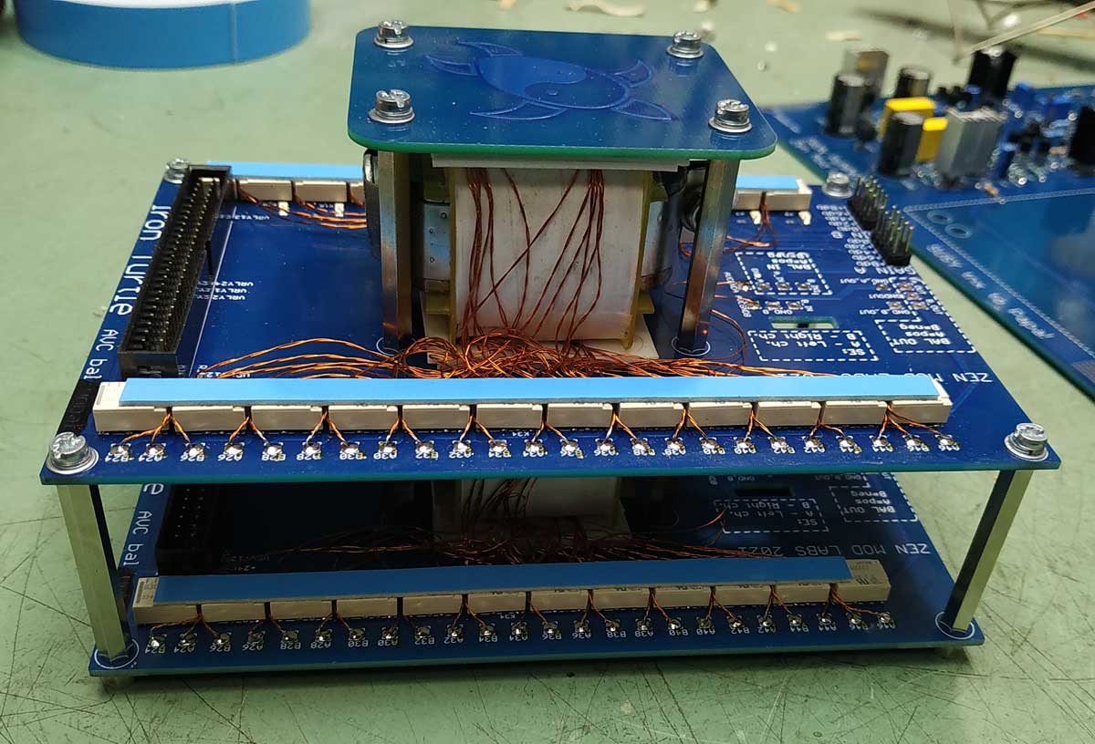

I want to add the question--- What are some of the worst choices to make with this Iron Pre concerning wire? It has already been stated to use a fine ga wire, but is there an electrical reason for this? And what if you went the other direction? I am not talking about the 'sound' of a wire, but mostly the workability. In this build, because of the number of wires needed to connect all 5 inputs (which in my build I will probably only use 4 of them), it can become a circus for the hands to get around these connections.
I've used some stranded solid core UTP cable, as you can see on the pic.
Just because these was in hand, and I was so impatient.
I was afraid because of noise issues, but there isn't any, even with that long wires from front panel pots to the panel.
Later I will move ALPS pots to the back.

Meanwhile, back at the ranch, I am still curious about wiring in the Iron Pre or other applications as well. What wire that is and where. Not to mention why. I realize that a good bit of it is about the ability to carry current or have the proper insulation when needed.
What views would any of you have to use magnet wire for example in signal wiring?
do not overthink that
How to wire damn Iron Pre
- for primary - if you need to extend those from Donut, use similar wire as you already have on Donut primary, heatshrink connection points and doesn't hurt to heatshrink entire line additionally
- for secondaries wiring, if you need to extend those from Donut - just use similar and heatshrink connection points
for signal:
- pot on front panel, use thin coax (2+screen per channel)
- pot mounted back, use any thin wire which make your heart warm, twisted triple per channel
- for RCA inputs, use any thin wire which make your heart warm, twisted pair per input
- for RCA outputs, use any thin wire which make your heart warm, twisted pair per output
- for XLR inputs, use any thin wire which make your heart warm, twisted triple per input
- for XLR outputs, use any thin wire which make your heart warm, twisted triple per output
