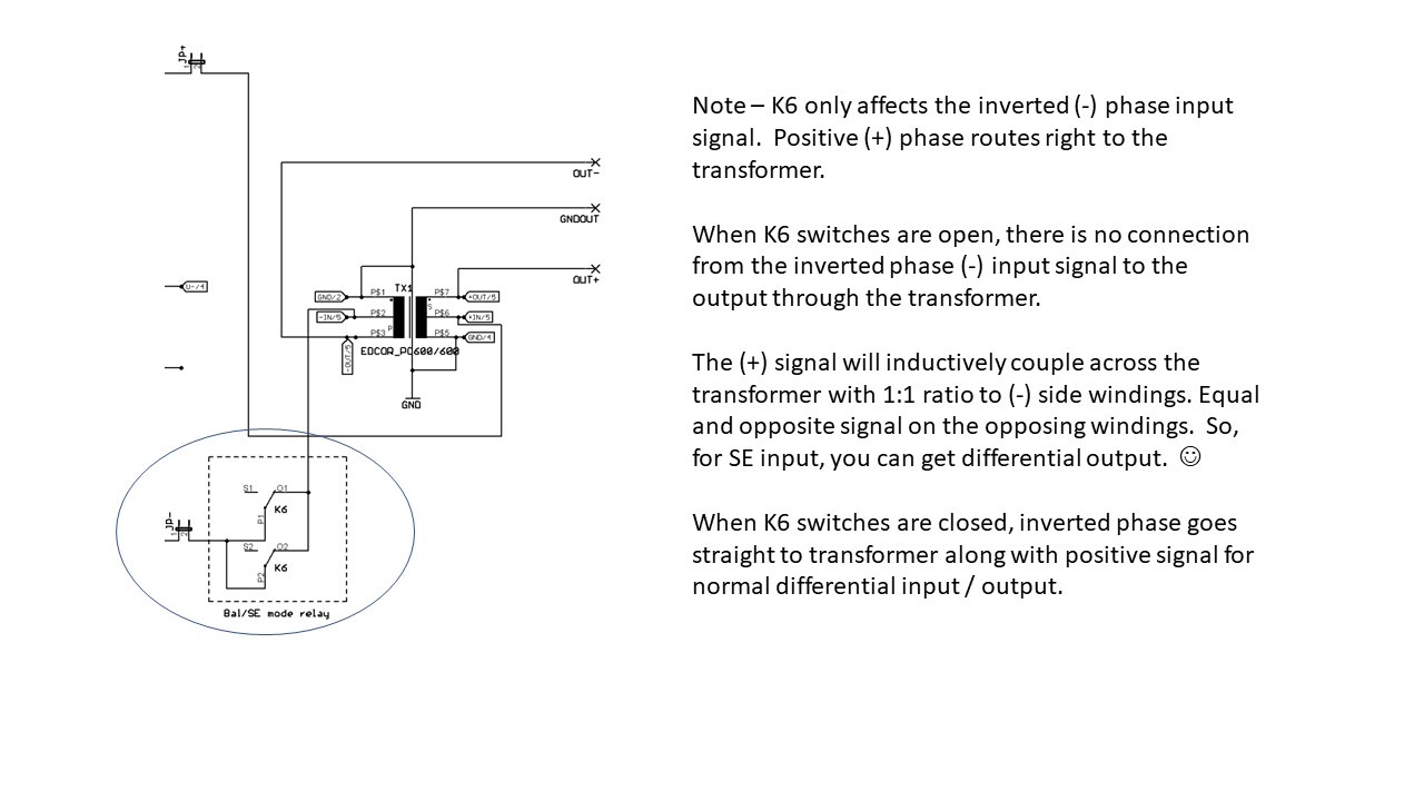

I built the balanced Iron Pre with both XLR inputs and RCA inputs. My DAC puts out 2 volts on the RCA outputs and 4 volts on the XLR outputs. When I compare volume levels between the RCA inputs and XLR inputs on the Iron Pre, they are the same volume - no 6 dB difference. Is this normal or did I wire up my XLR inputs incorrectly?

I am using XLR output, into rhthatcher's Aleph 2 boards set up for XLR inputs (and what a nice combo it is). Phase is inverted from the iron pre input to output.
XLR pinout is always:
1 GND
2 +
3 -
Iron Pre balanced is - as explained several times in these 2 threads, having 6db of gain nominally , details here:
- input Bal 2V , output SE 2V, output Bal 4V
- input SE 2V , output SE 4V, output Bal 8V
if you take a look at schematic, understanding that "SE" is 50% of "Bal" voltage-wise, everything is clear

...... and even clearer, all for Iron Pre Balanced preamp:
- Bal In to Bal Out, gain is 2V/V = 6db; if you're taking SE out, that's one phase of Bal, so 50% of Bal voltage ....... live with that
-SE In to SE Out, gain is 2V/V = 6db; SE Out is also Bal positive phase ......... and then you have also (as addition) Bal negative phase for free!!! .......... live with that

Many many thanks for this sketch. I'm just trying to make sure I'm understanding it right before I do anything stupid. For each channel:
One tap from the Slagle goes directly to the E5 pad (Slagle tap selection sets gain as clearly depicted in the graphic).
Jumpers installed across CW and WIP volume pot pads to bypass resistive pot.
(Here's where I'm a little unsure) -- The AVC controls volume after the Iron. So the output wiring from the Iron board goes to the signal inputs of the AVC attenuator. Then the preamp output RCAs are connected to the AVC attenuator outputs.
So, basically, the final AVC volume control wiring is the same in this configuration as it would be if we weren't using the AVC for gain (such as using the Cinemags instead)?

exactly
step 1 - short resistive attenuator Volume pot pads
step 2 - wire Autoformer Volume instead of (original intended) Autoformer
easypeasy
now, how I did show wiring on that sketch - wiring of AVC instead of originally intended Autoformer is in such way that you're taking preamp outputs in original way - from output pads on pcb
what I forgot to note - in case of using Slagle AVC (or any made in similar fashion) - arrange stacking of EI lams "all alternating", resulting in highest inductance; that's making buffer's life more leisure
