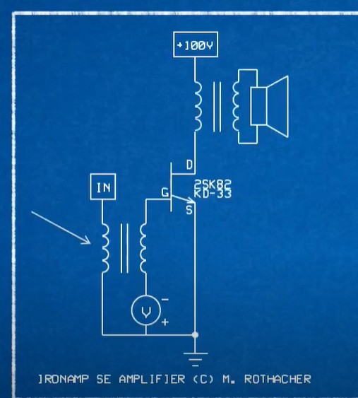

I would like to build this amp and I need the power supply ( about 100v 200ma on the v-fet but a bit higher because the Output transformer primary impedance ) to be particularly silent since it is connected to a compression driver with 113db of sensitivity. I was thinking of using a CLCLC power supply (to have few mV of ripple) and I was wondering if the use of a Saligny power (HVHF in this case) could be useful.
My problem is that at most I can use PSUD II and therefore I have no idea how to model a power supply with a Saligny bridge. Any suggestions?

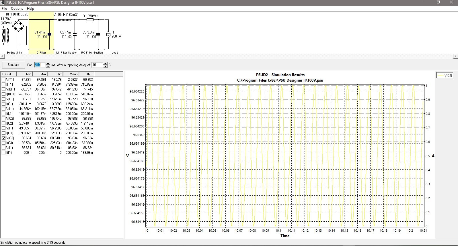

I ran a quick PSUDII simulation and getting sub-millivolt ripple for the power supply is not too difficult with CLC and RC for local decoupling.
