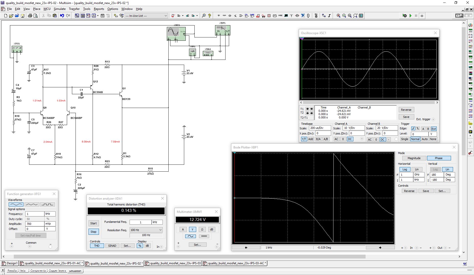

OK, as promised. Did not even touch stability yet - too many issues of the lower level of complexity.
Let's put the output stage aside for now. First of all, we need a well-performing voltage gain stage.
Your operating points combination is confusing. Guessing? Random choice?
Very low quiescent currents for LTP and VAS and then... BD139 will feel bad at 56.6mA (more than 1.3W of dissipation). For what reason?

Some simple ways to improve the performance

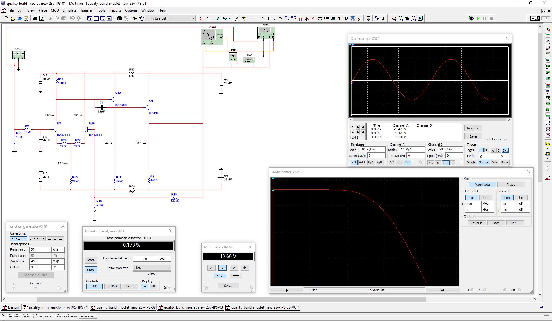

OK, the last attempt to convince you reading some books.
Trying to keep it as simple as possible. Keeping your choice of active devices and overall topology.
1-st step - just making operating points reasonable and matching the impedances.
2-nd step - adding dynamic loads.

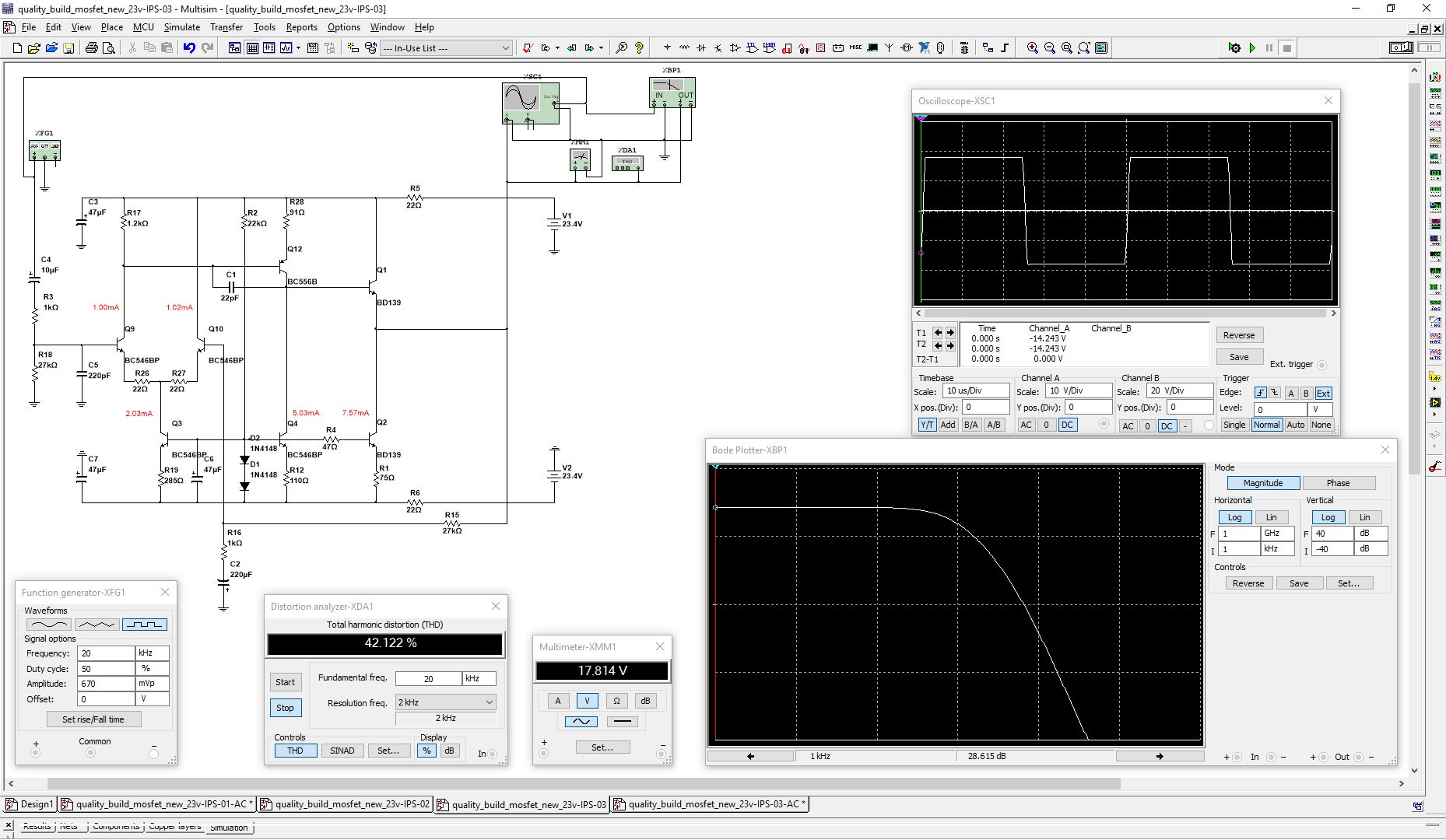

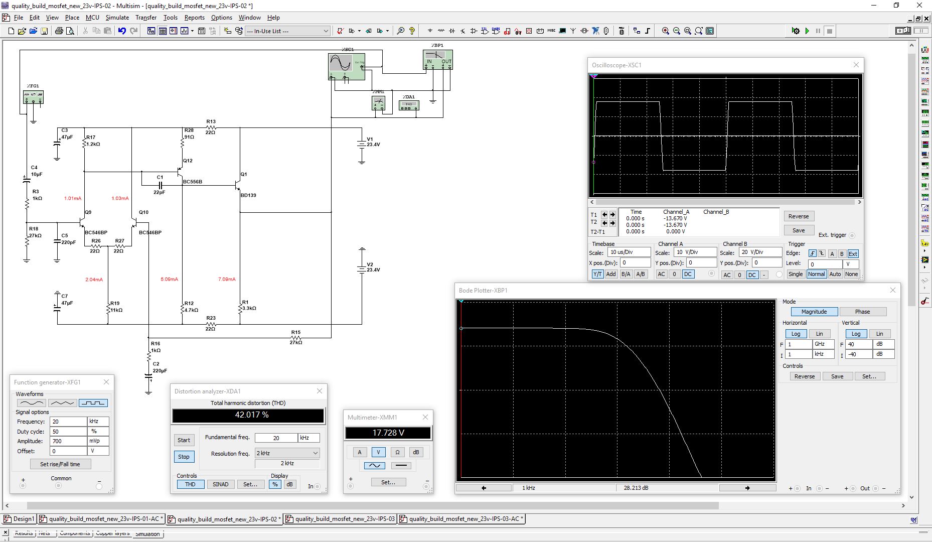

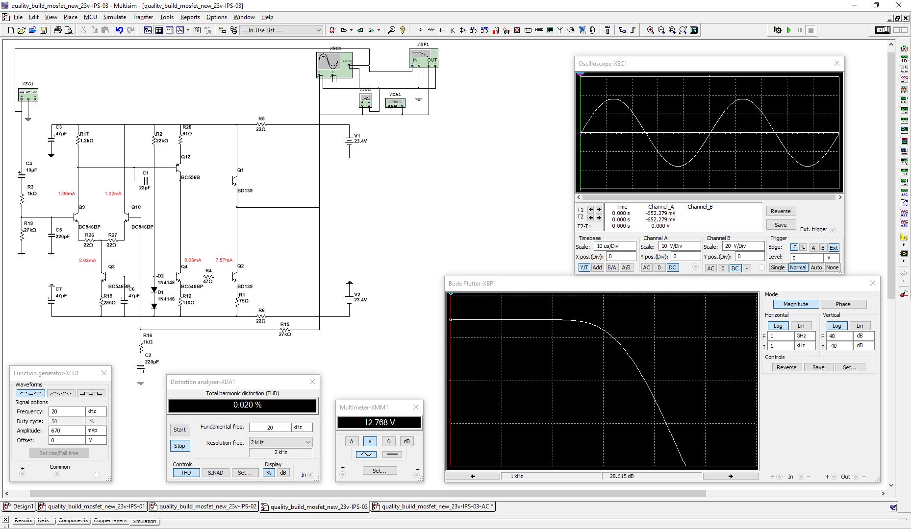

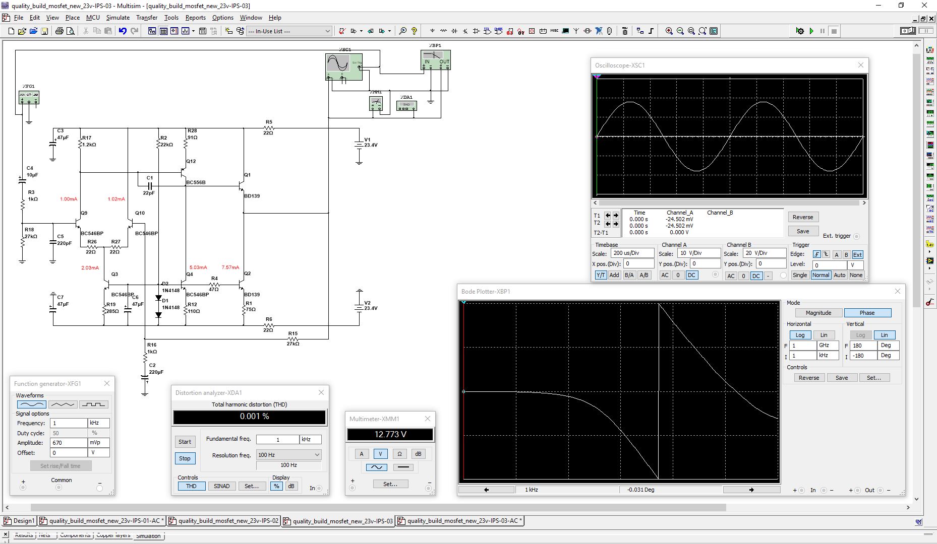

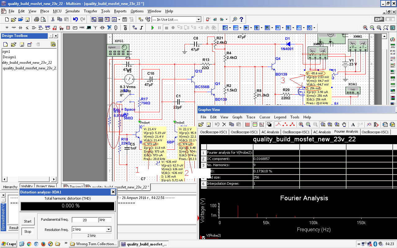

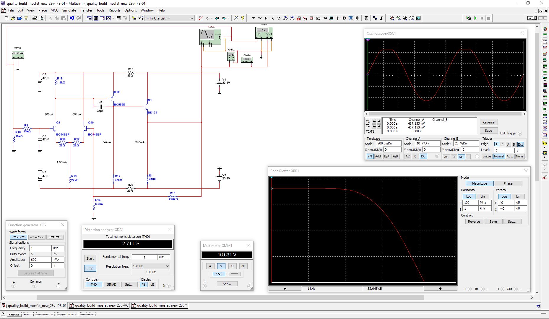

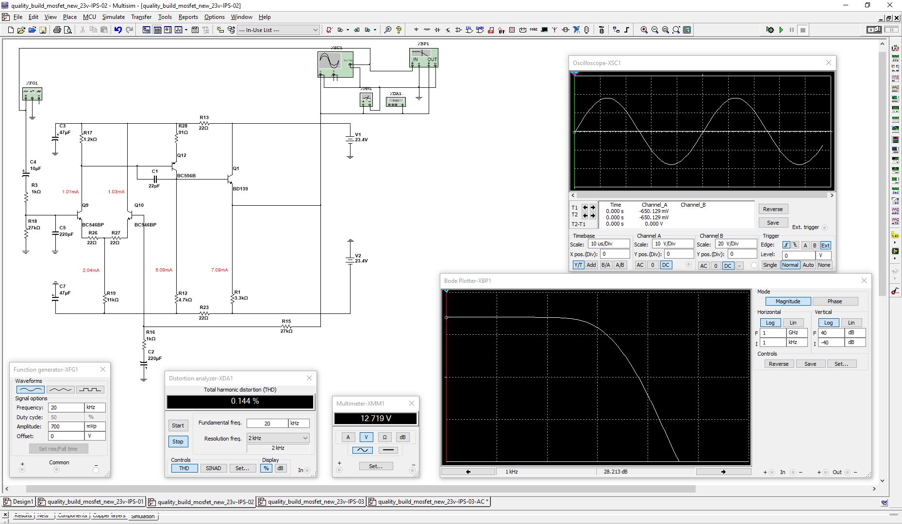

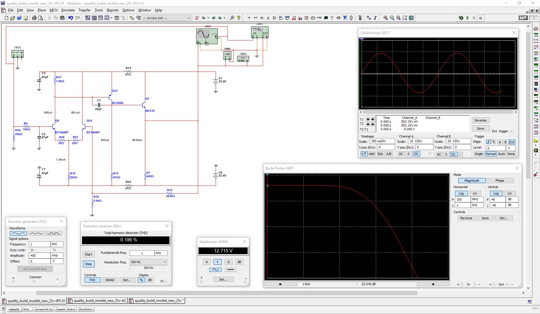

These values were for close to zero offset. When i made both ltp currents equals it resulted in a very big offset.Your operating points combination is confusing. Guessing? Random choice?
Im heatsinking it. For more IPS output current.
vzaichenko, this is my updated version,
I calculated that 27mA for the ips bd139 will be good without heatsinking.
This means 1.1k 0.5W R1 resistor.(2x2.2k or 2x2.4k in parallel)
*In sch is 3.3k because i calculated it after that.
What is the Pc of BD139 with a very small heatsink>? Minimum size one. I have one very small and want to use it squizing max current from the IPS. I know i am not needing but want to use the heatsink 😀 (My goal is 2W Pc from 1.25 -> 2W)(maybe this is possible with the smallest one but what about 4W ? )
R8 is 22.8k in simulation only, for fine tuning (its22k)
I am confused about the optimal values of R18.(without volume pot)

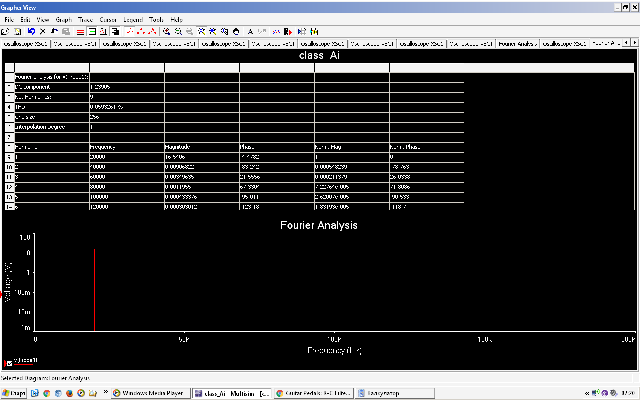

fft analys is @ 20khz.
i readt from here -> https://en.wikipedia.org/wiki/Line_level
that line level is 0.316V for consumer audio.
And i tuned it for it. Its perfect scaled.
This 1000000 times better than this im listening now. :OOO

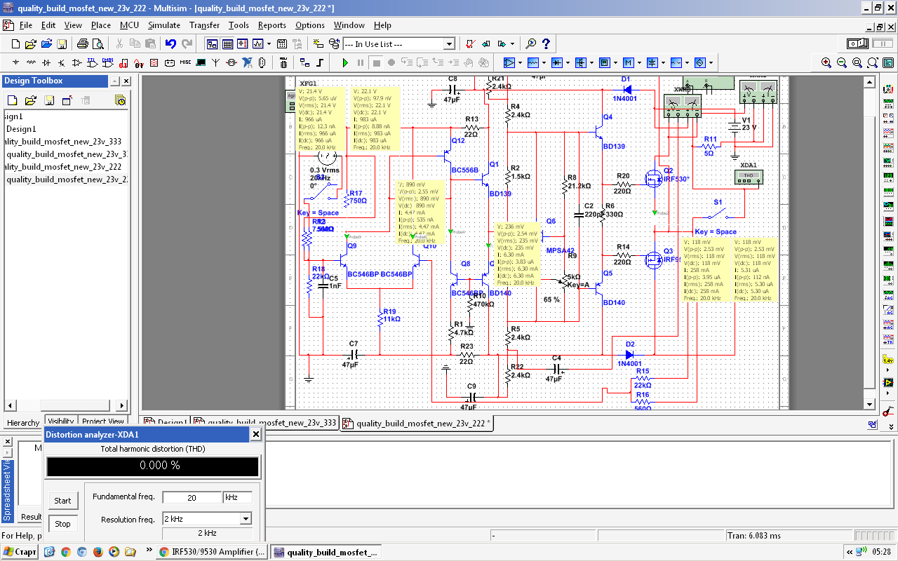

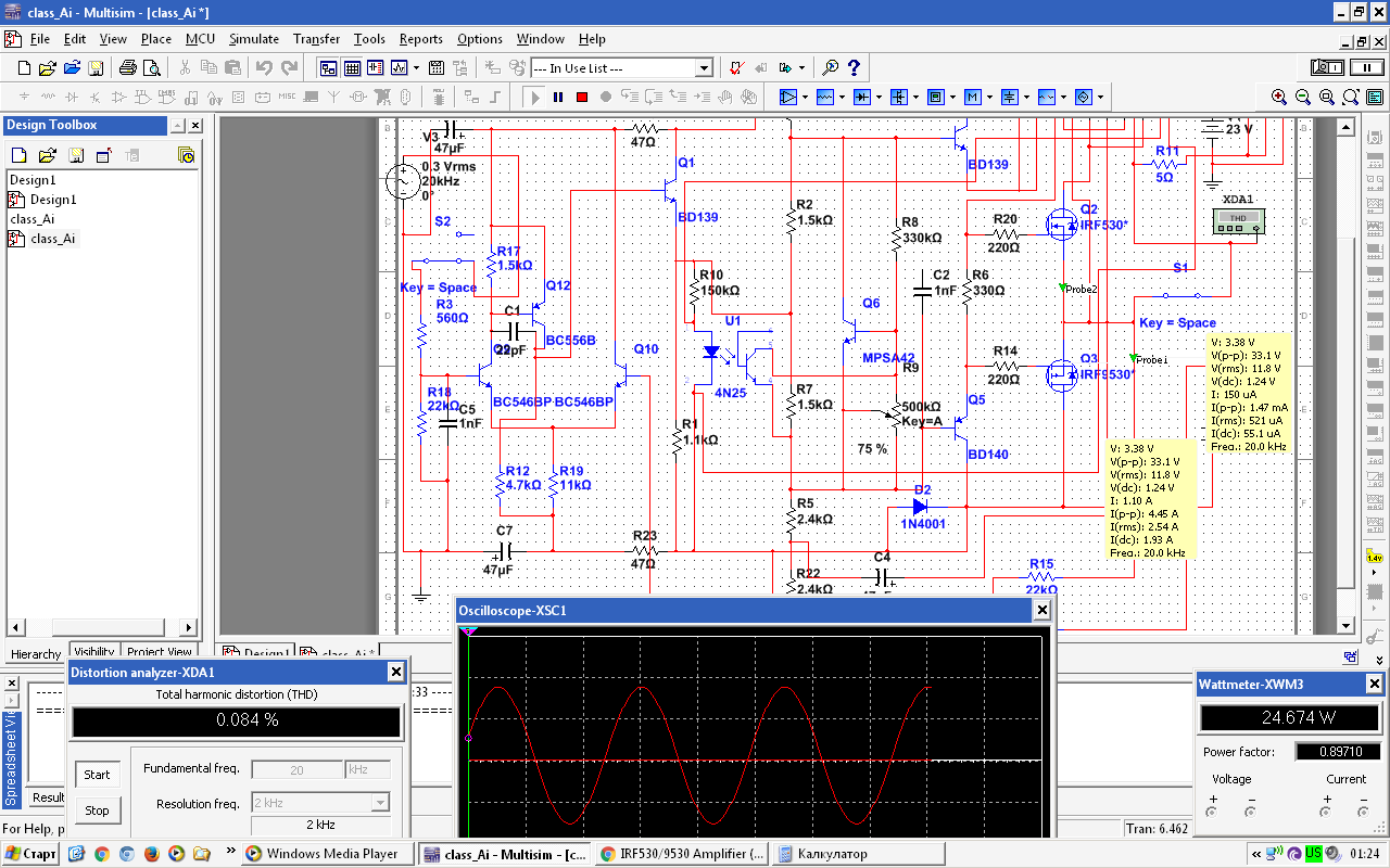

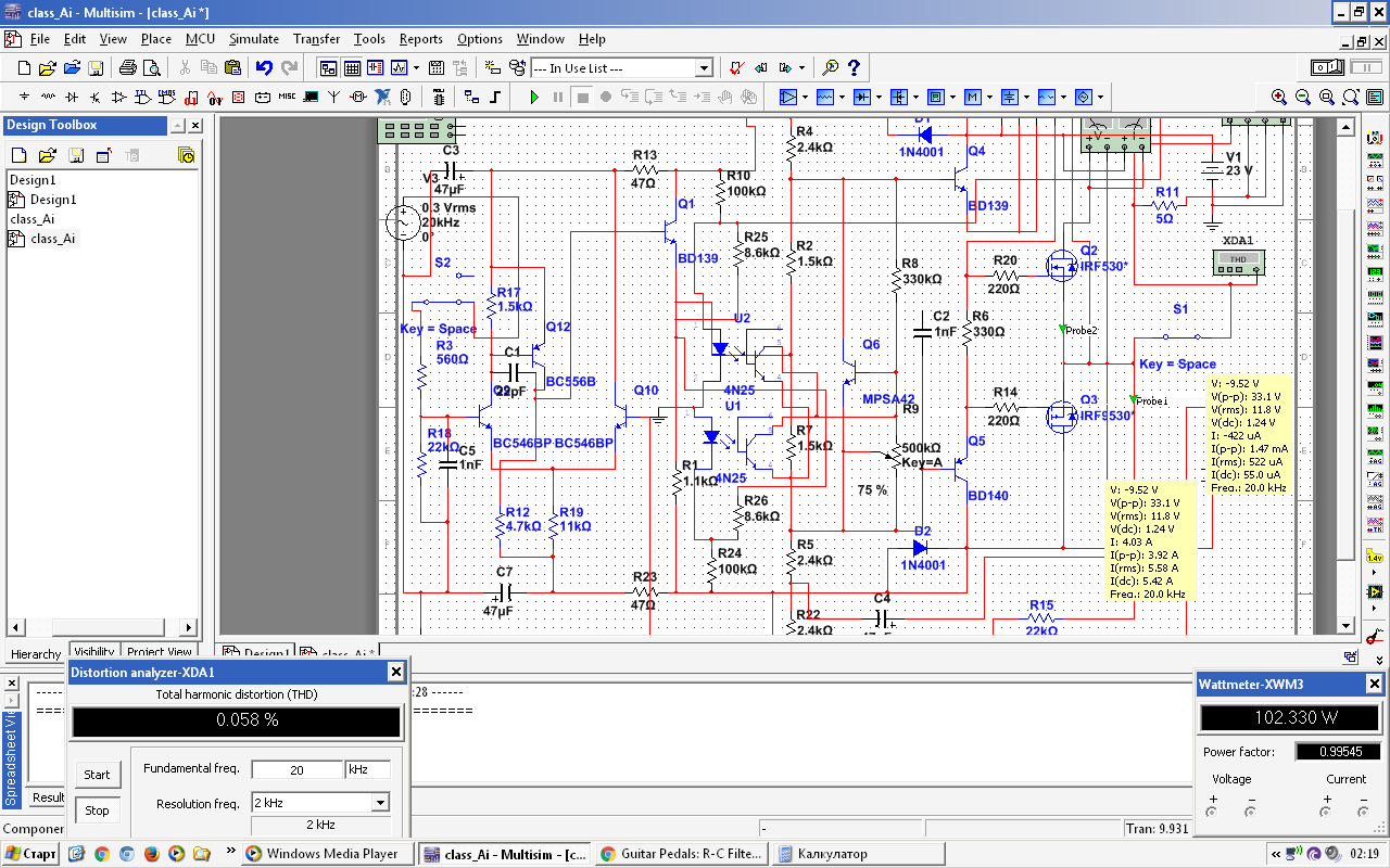

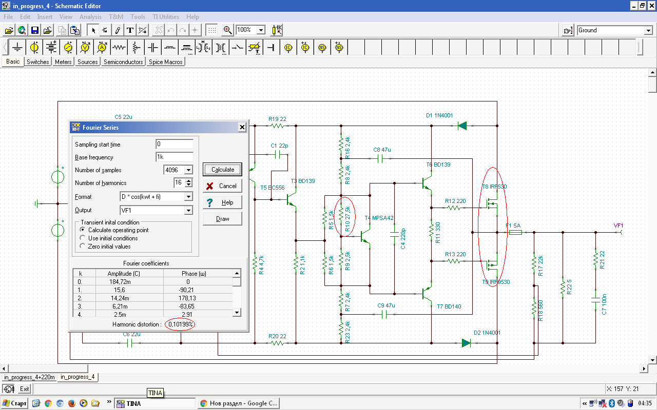

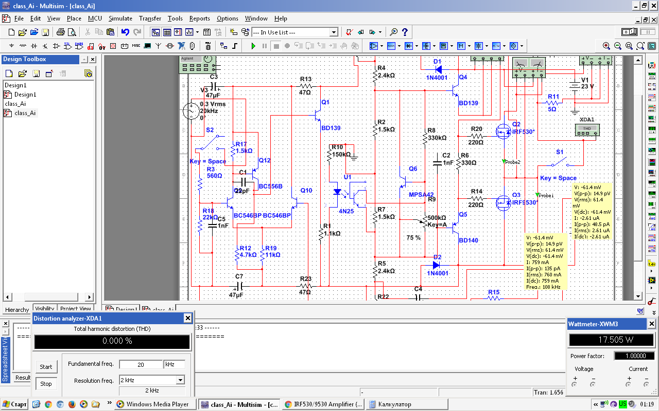

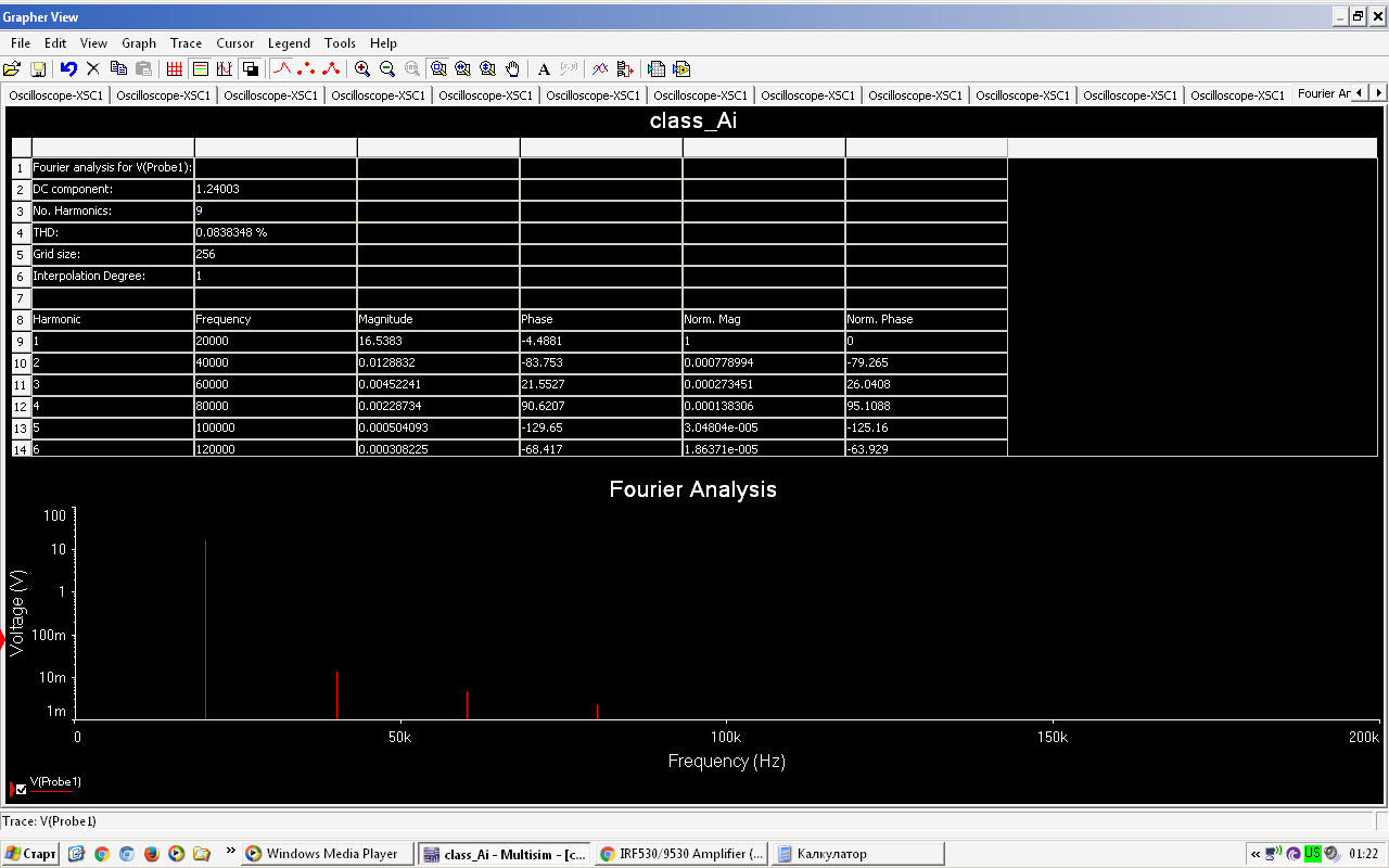

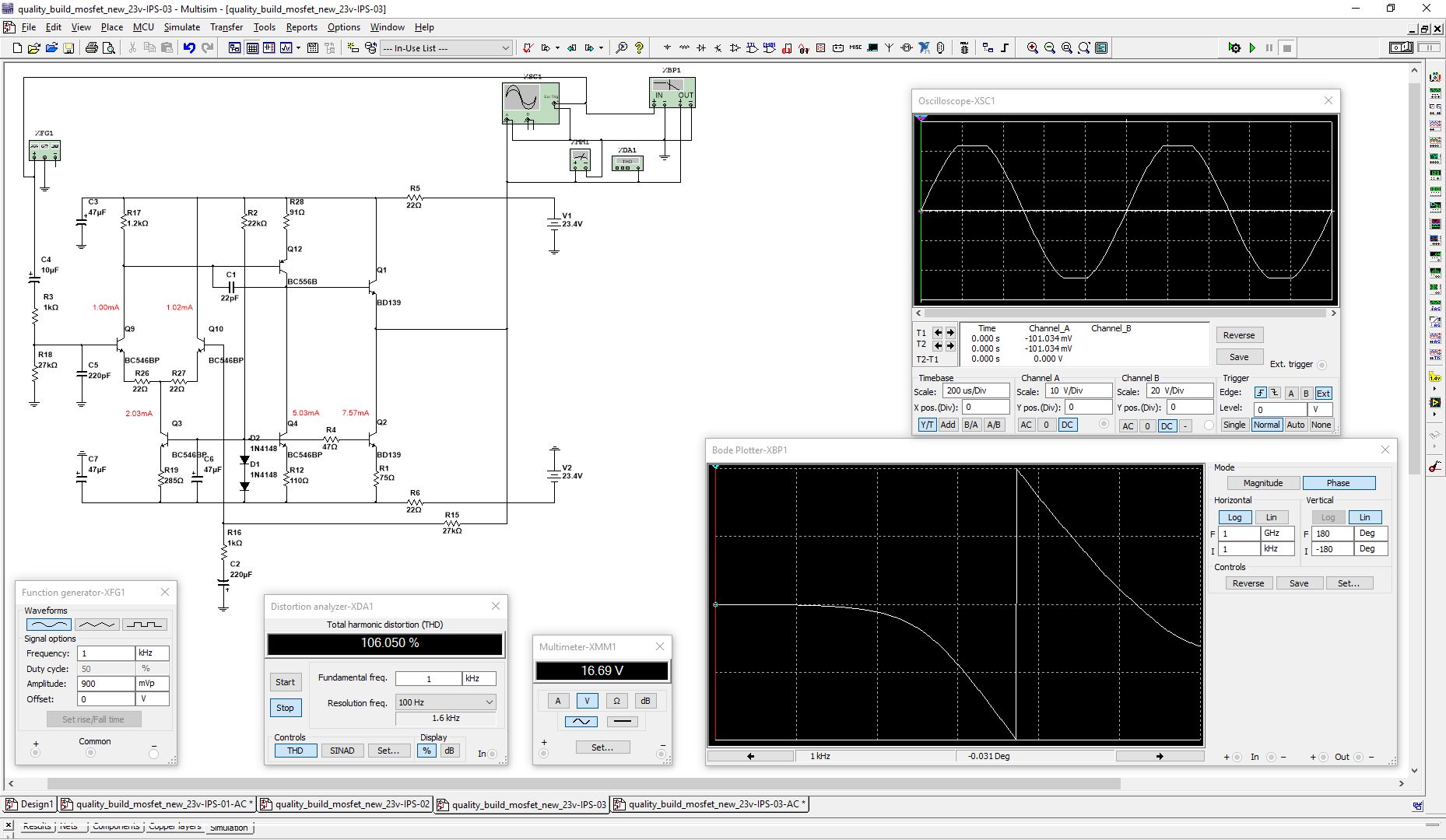

Im ready with my class Ai (improved) 😀
Im using optocoupler to hightening the bias (maximum @ zero volts input) 😀
Normally its 70-80mA. When input goes close to ground, it goes linearly to 760mA. This provides class A only when its needed, near crossover region.
Im not sure is it correct, i should bias this optoled and his katode must be to ground 😀

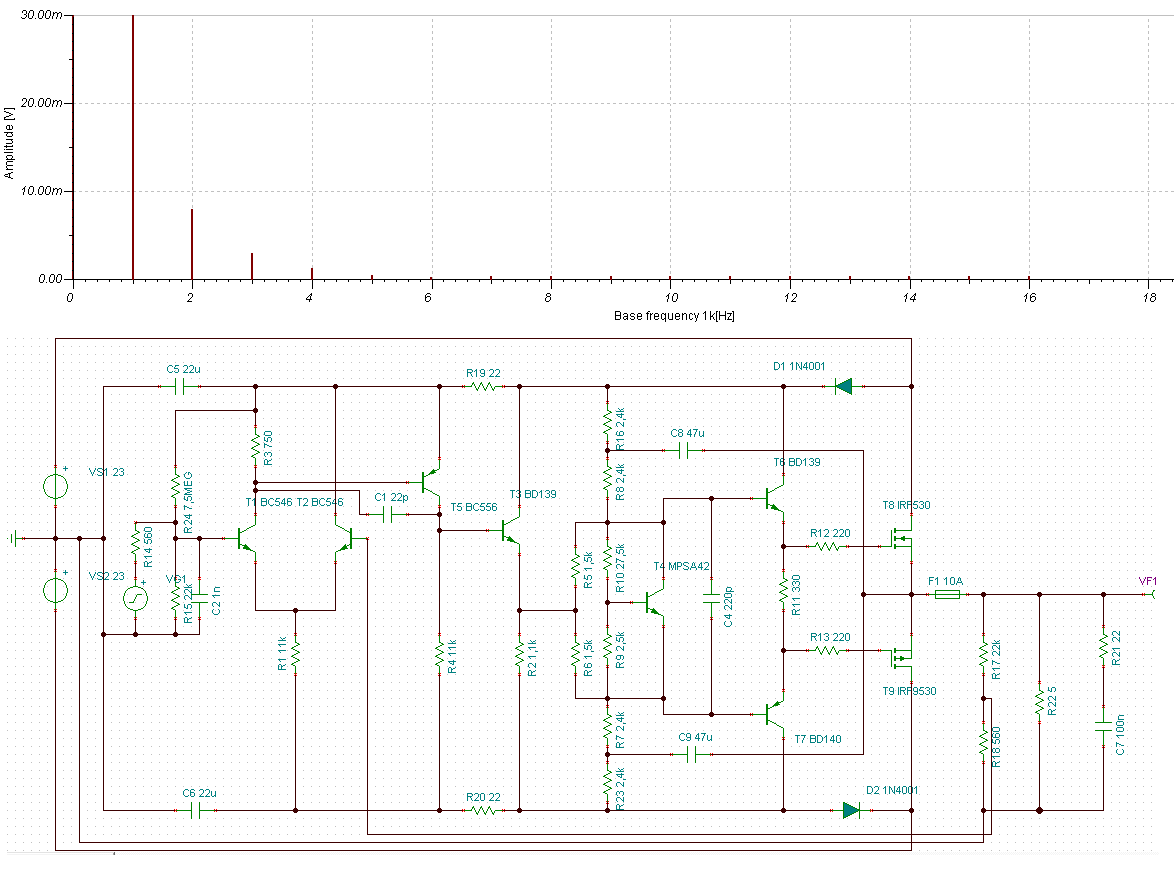

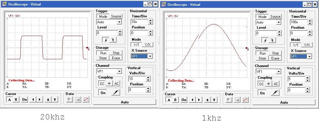

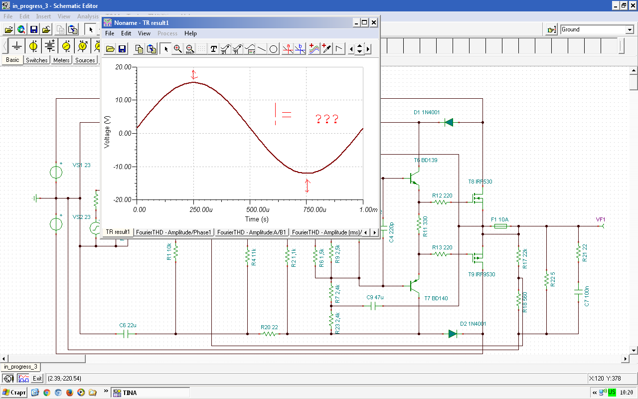

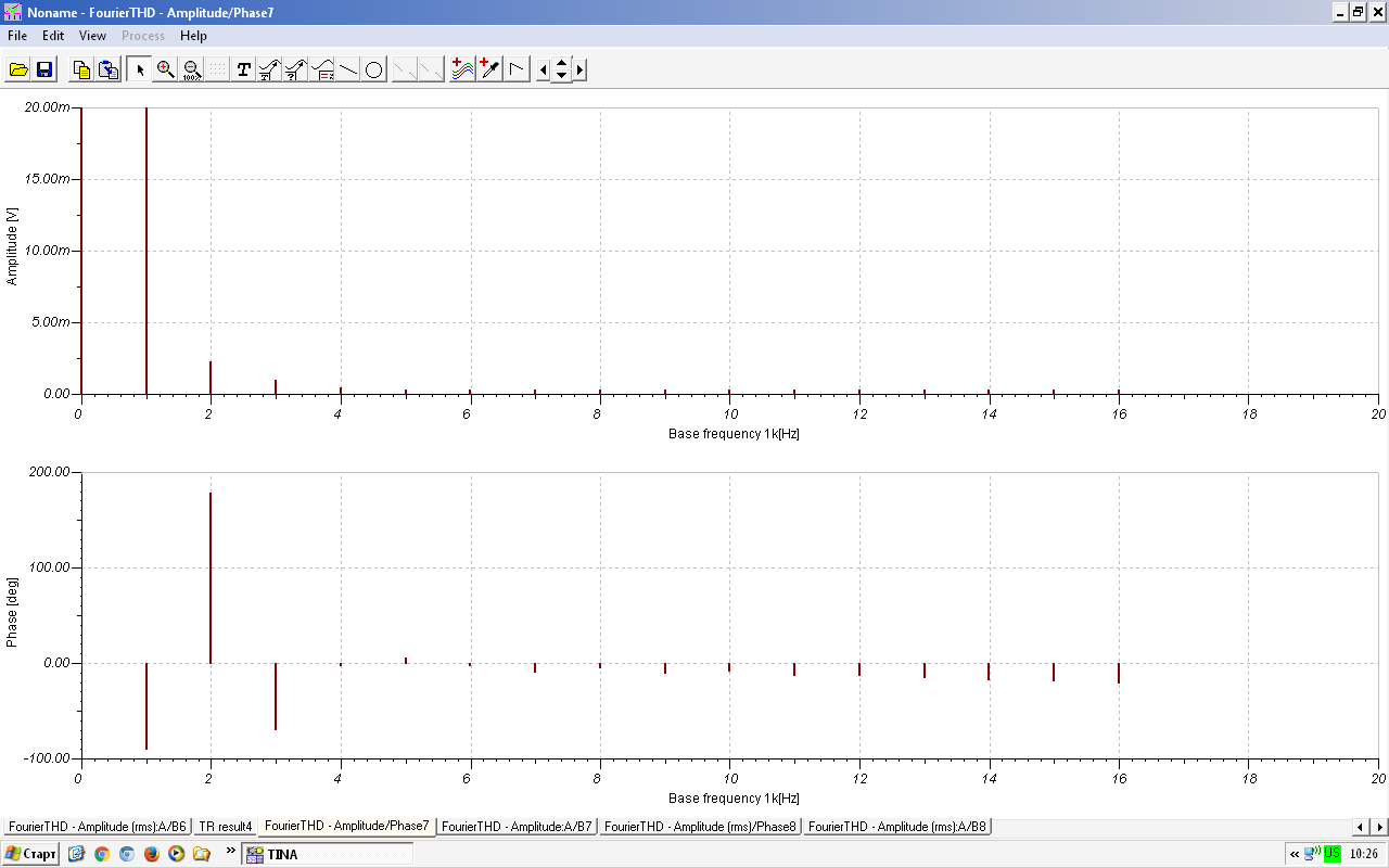

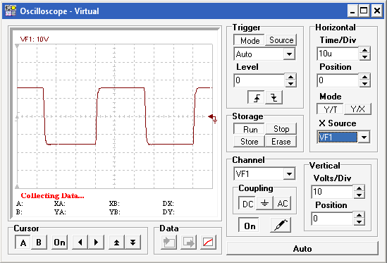

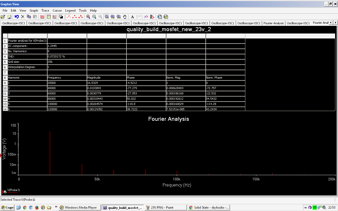

->->->TINA results:
THD@1khz->0.04% (better than Multisim)
THD@20khz->0.72% (worse than Multisim)
offset@DC->63mV
offset@AC->very big :O
square->excellent 😀 😛
offset@DC->63mV

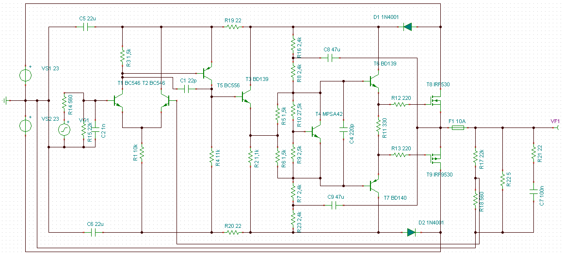

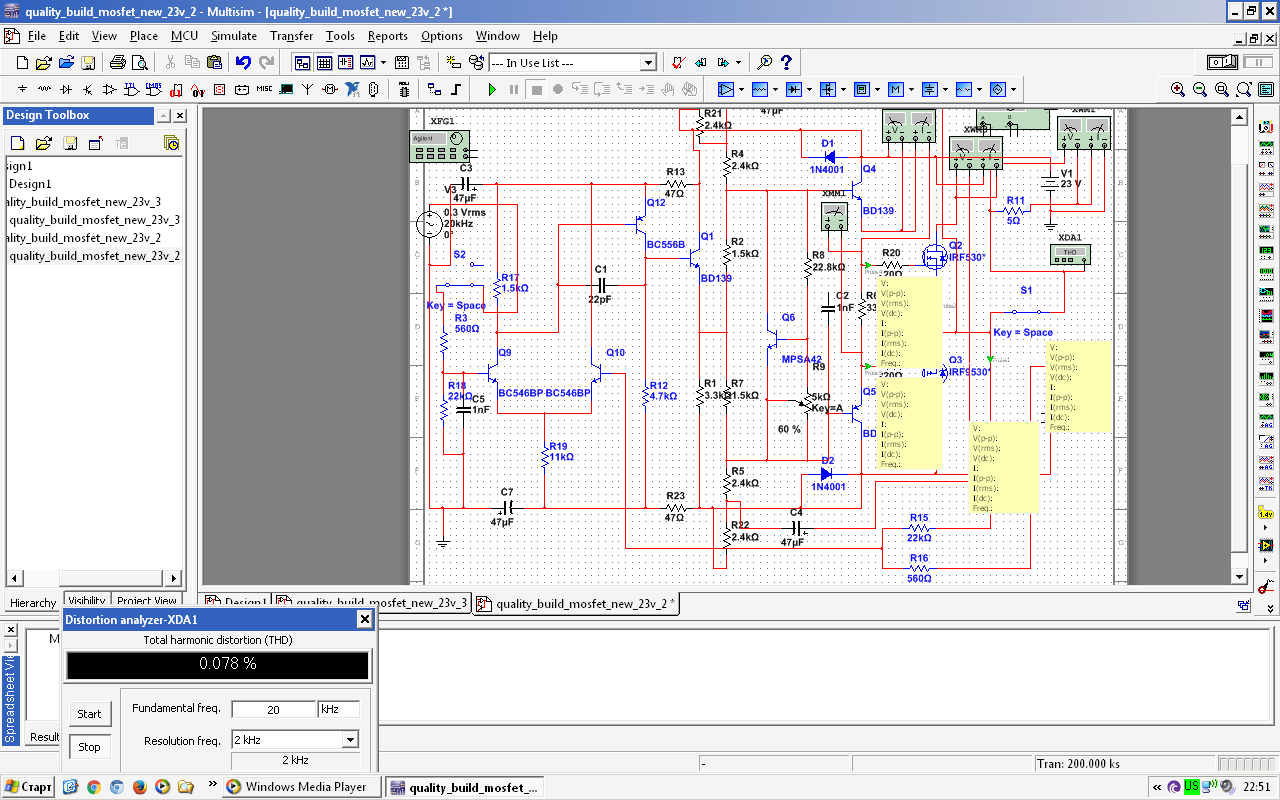

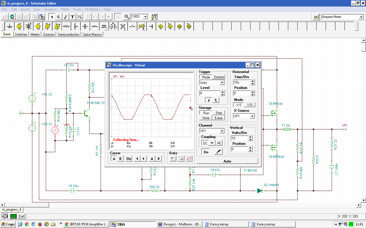

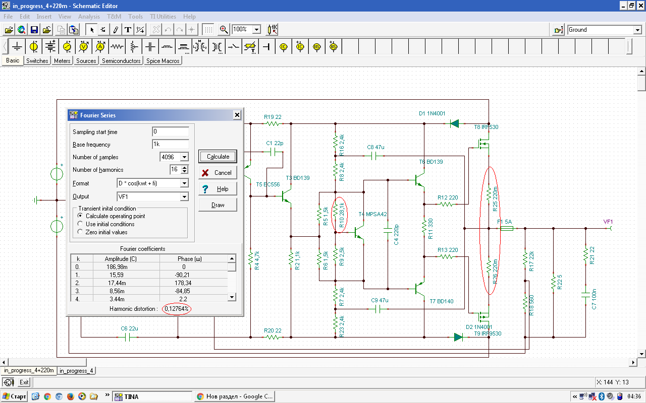

new tina results with this setup.
there is only 1 last thing to modify the ops a little bit.
i designed it for 2 to 4 Vth but it must be little higher (Vth+Vbias(256mA))
if im using mosfets with 4V thrs voltage i will be unable to set the 256 mA bias current. 🙄
P.S. i forgot to change R4 to 4.7k. i need to test again 🙁
P.S.2. This is my first time using the MEGAOHM resistance range 😀 (R24==7.5MEG)
P.S.3. Gives 0.1% THD @ 1khz and 0.7% @ 20khz.

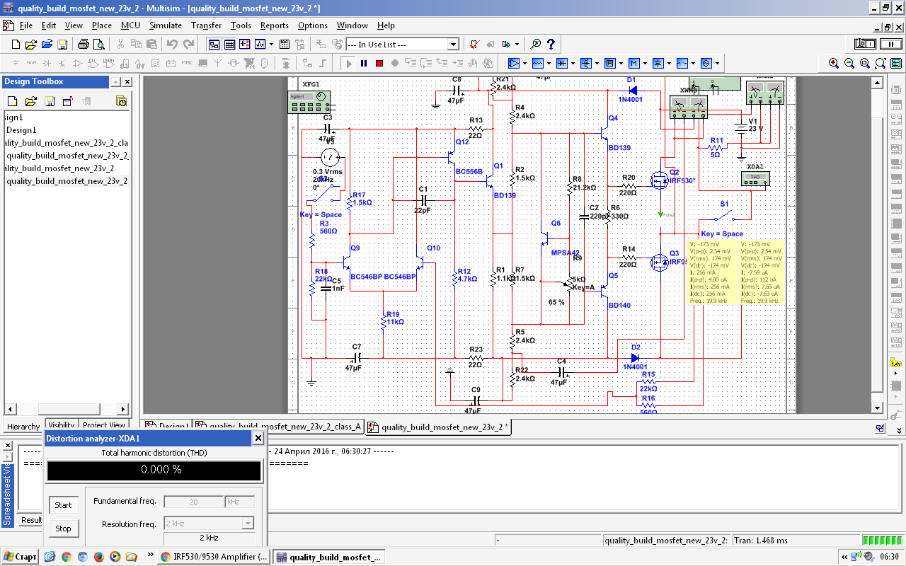

They are high impedance but thats why because their impedance gets lower as freq goes high.(capacitance reactance) For example -> irf530 have 670pf input capacitance and with 20khz this forms 11.877k resistor to source ;p(much lower gate input impedance)
=> my R11 must be 5.9385k instead 330 => with 330 i can drive 5.9k/330 = 18 pairs of mosfets.
hey i can use tiny TO93 if im using one pair only.
search google "capacitance reactance calculator". this shows resistance of a capacitor @ a freq.
This is also why you need low value gate stoppers. iT seems that my 220r is high again. i must use 100 ones.

Exactly opposite. They result in worse distortion, see. I readjusted idle current with them because it gets lower.

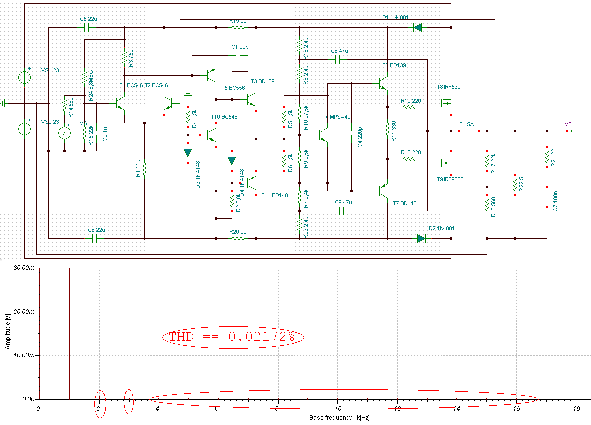

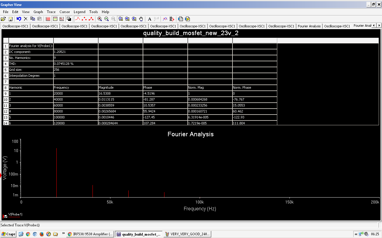

Vz, i made it with very good result. Harmonics are not visible 😀
THD == 0.022%
DC Offset == -84mV
P.S. Its better with R4=2k and R2=4.7k. Btw is 32mA good for BDs without heatsink ? This is 736mW Pd with 23V.
Next update is to change T6 and T7 with BCs546/556 and R11 with 5.6k for only 1 pair of mosfets, this is 2x80W amp, not powerfull beast.
P.S.2 There is 0nly 56.14uA difference in LTP collector currents.;p
THD == 0.022%
DC Offset == -84mV
