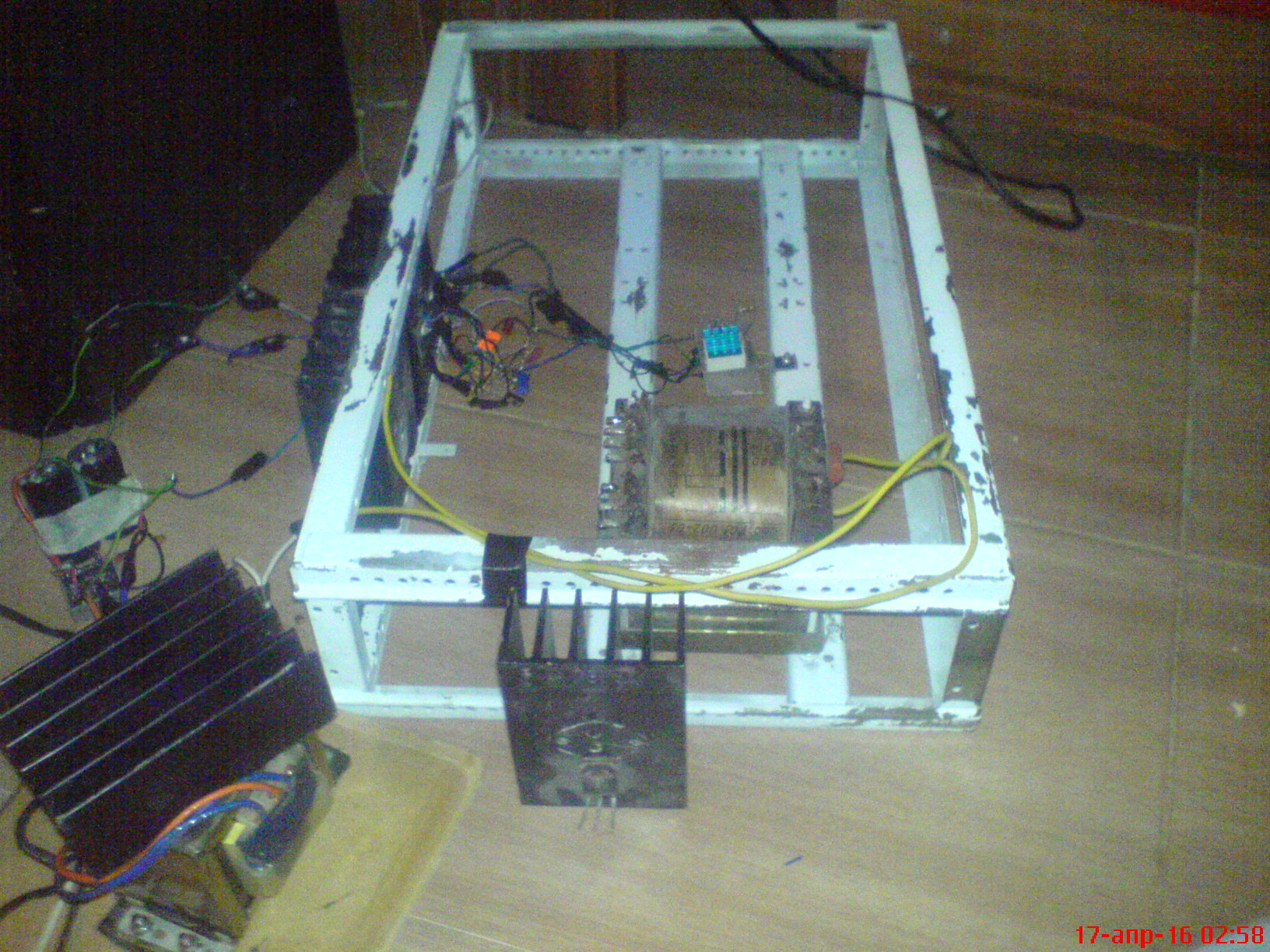

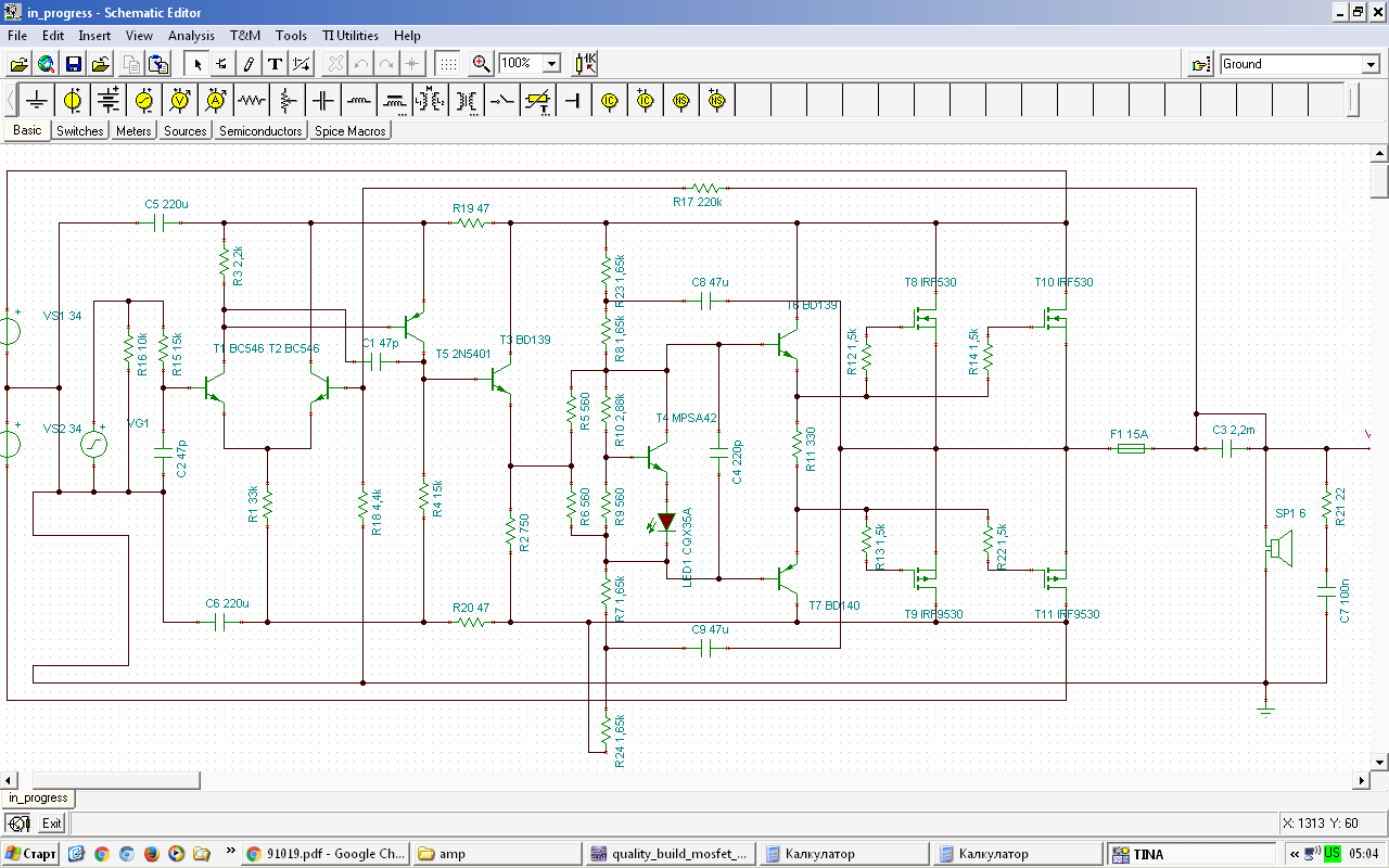

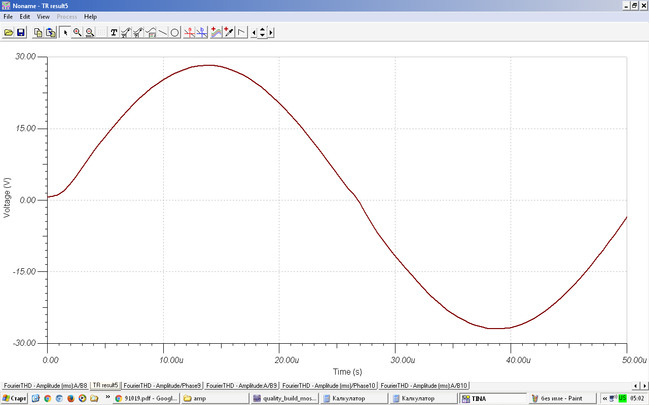

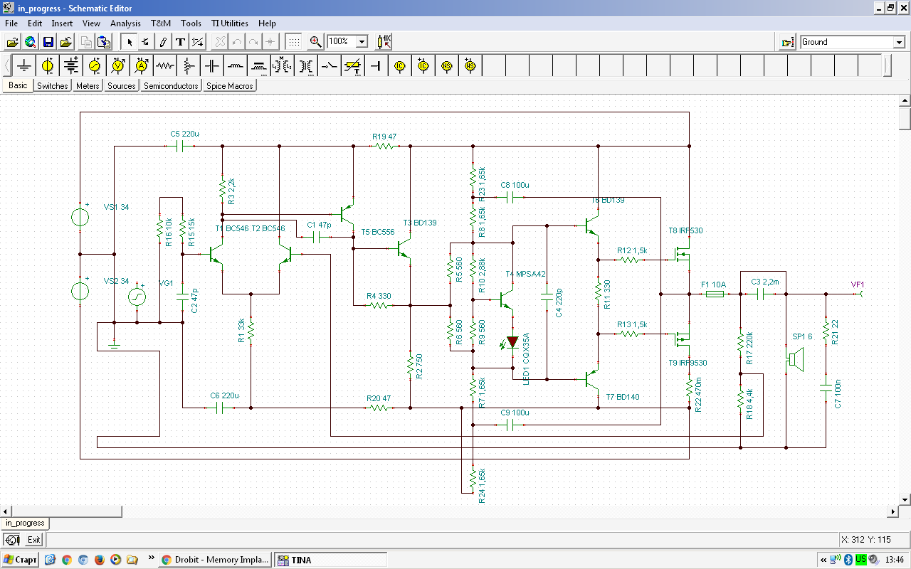

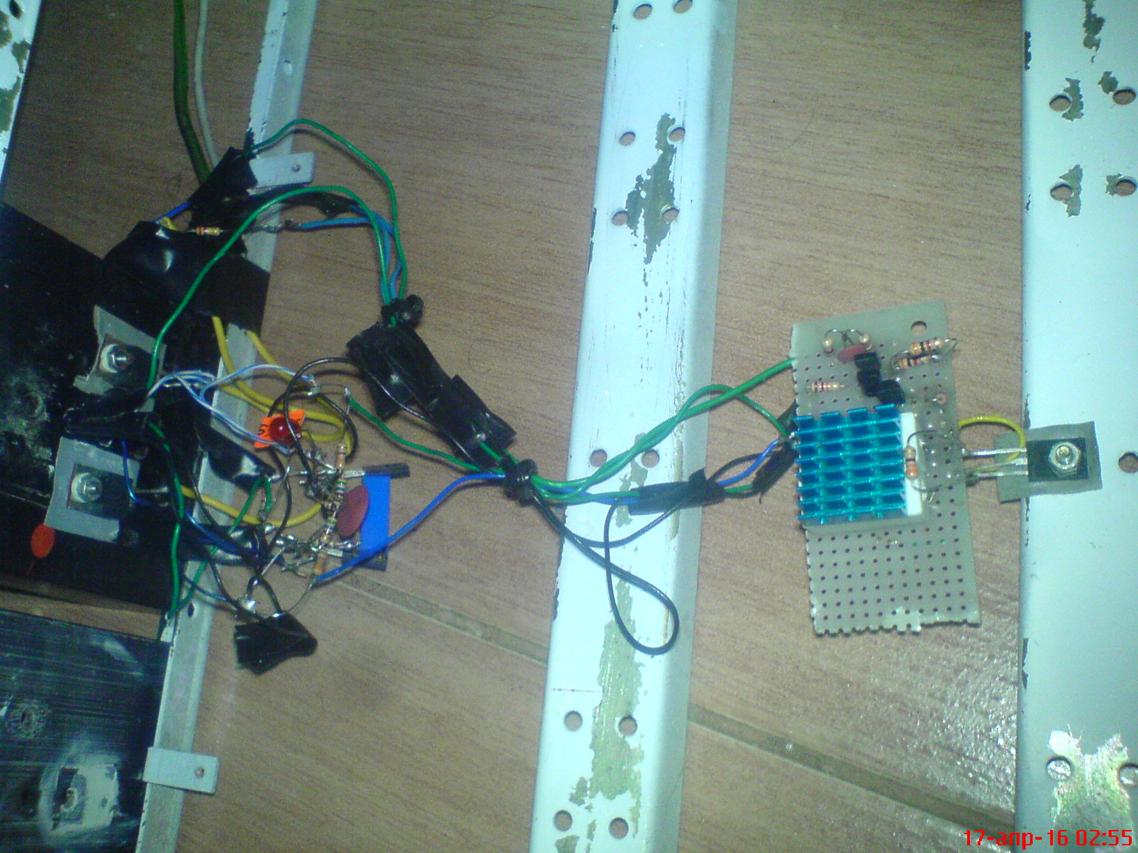

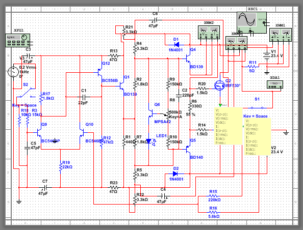

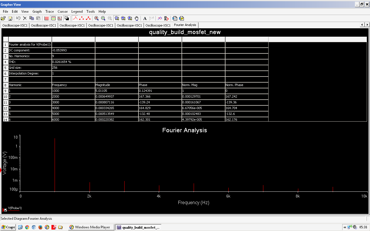

HI alls,
here are the sch, analyses and pics of the build.
it sounds good, clear, hifi.
When its warm gate-gate bias voltage goes up with 100mV.
I designed the sch for +-35V but i have +-34 when playing music.
Is it better to design for +-34 ?

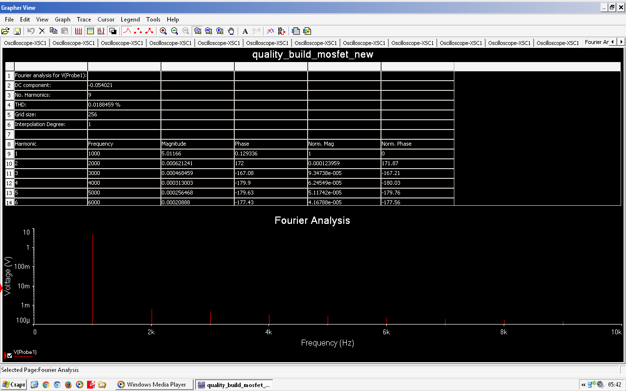

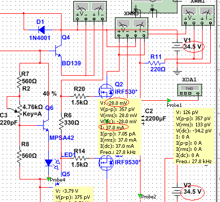

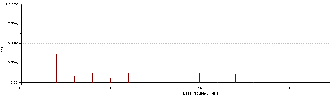

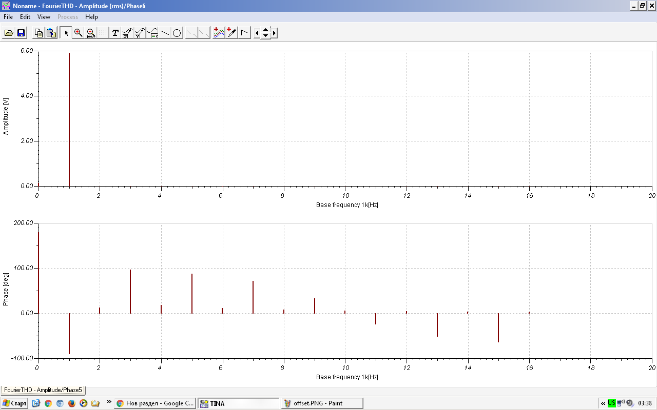

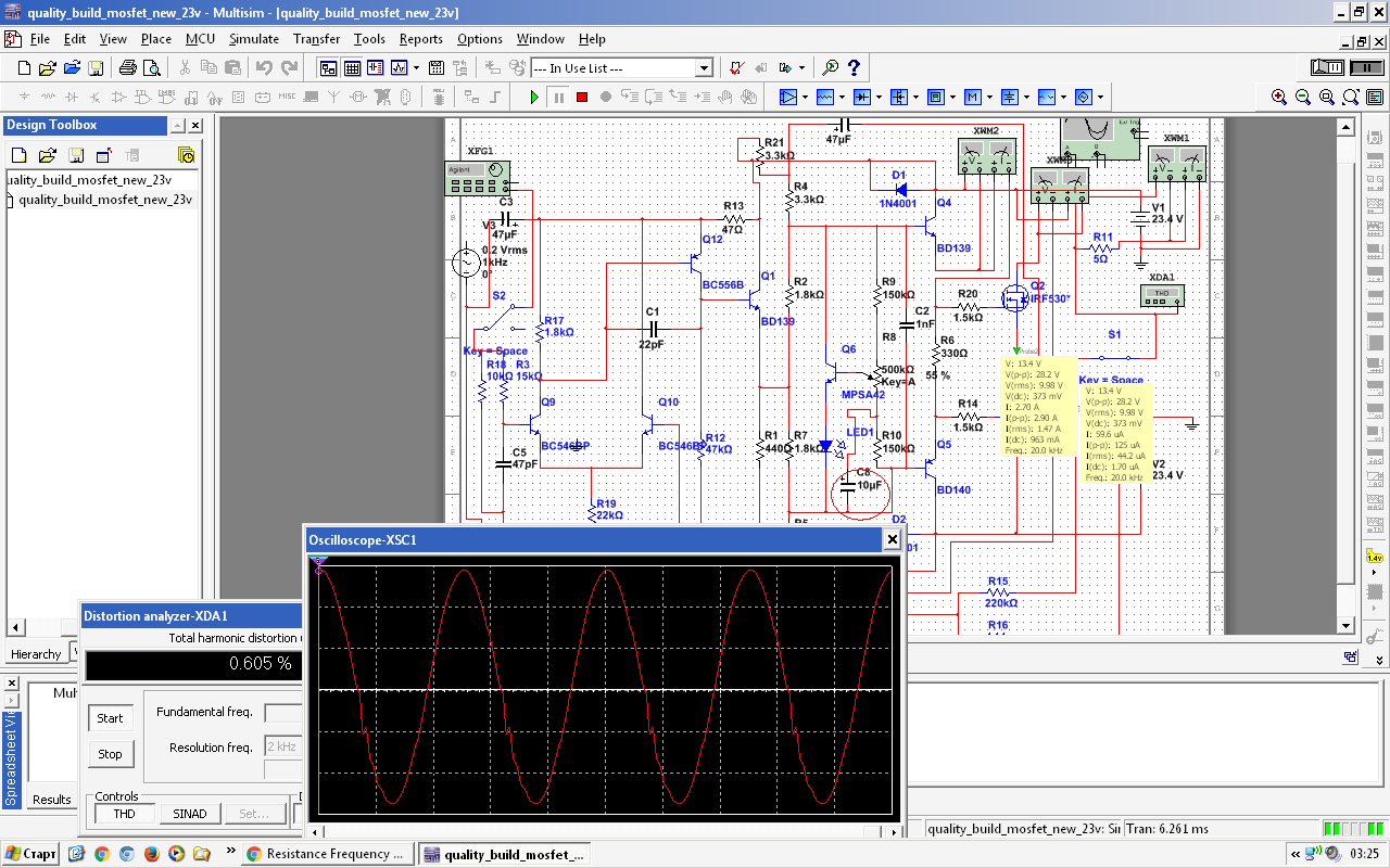

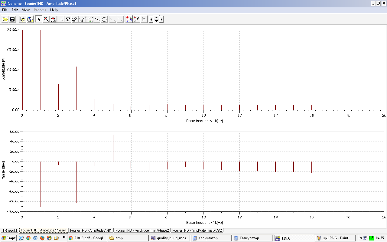

There are two Multisim harmonics analyses because the worse one is with 7ma bias current instead 86mA@35V supply voltage. In one of the screenshots there are 30-40mA because supply voltage there is 34.5V instead 35.
I tested with 7ma because to come close to reality.

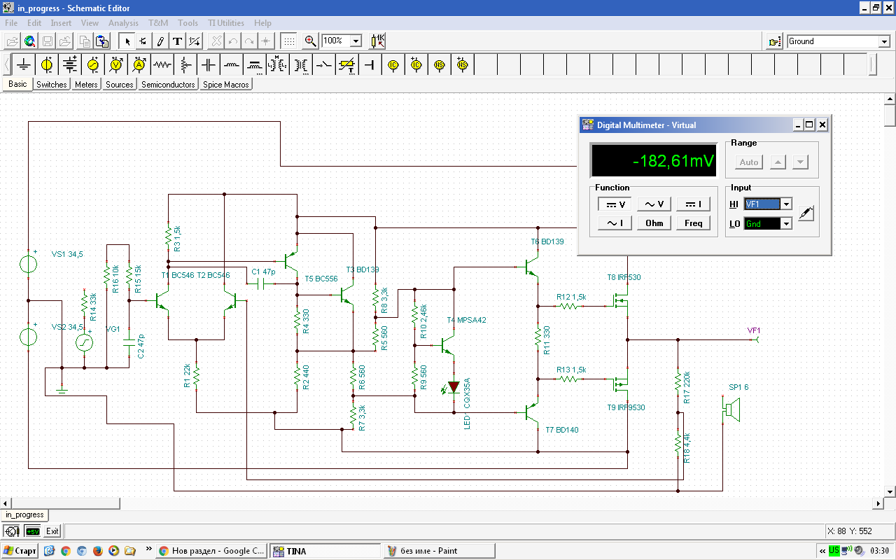

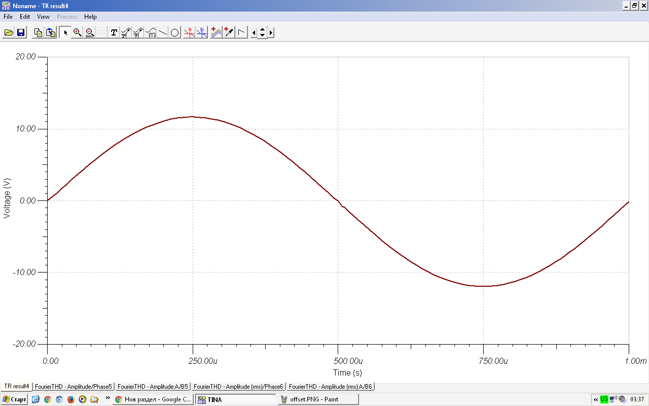

i measured 200mv offset in reality where in Multisim is only 16mV.
I divided 200mv/16mv and there are 12.5 difference.
This means 86mA/12.5 -> 7mA 😀
i found out its 200mv in TINA too, this means TINA is more close to reality and actually its very close 🙂

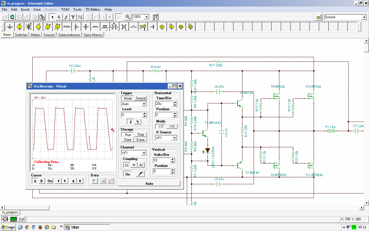

R11 is 220ohm in multisim's screenshot because i was measuring how many watts i can get at 220 ohm 😀 Analyses are normal with 4 or 6 ohm load. i forgot what i tested. 4 or 6 .
I want to mention that firstly i tested with beta-enhanced VAS (collector to ground) but it gives poor results comparing to this.
maybe i need 2n5401 instead bc556 but thats why i added 33k series to input to limit the signal not getting too high.
I dont like the way to drive OPS with one transistor upside or down.
I like to "inject" the signal in the middle.
I think this is very big mistake in every amp !
P.S. I noticed that 1n4001 diodes must be replaced with 47 ohm resistors becase the distortion is very worse with them.
P.S.2. Forgot to mention that R10 is 560+5k trim pot for full range bias tuning (2Vto4)
P.S.3. With 750 instead 440 ohm is better with less Pd for bd139. this R must be 5W.
Im using 440 because the only powerful resistors i have are 220ohm. They are 5W and im using them in series. It cooks them very well 😀

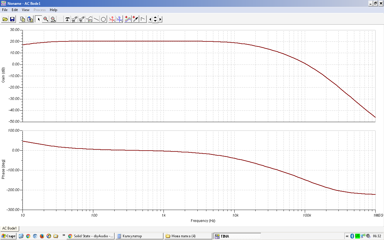

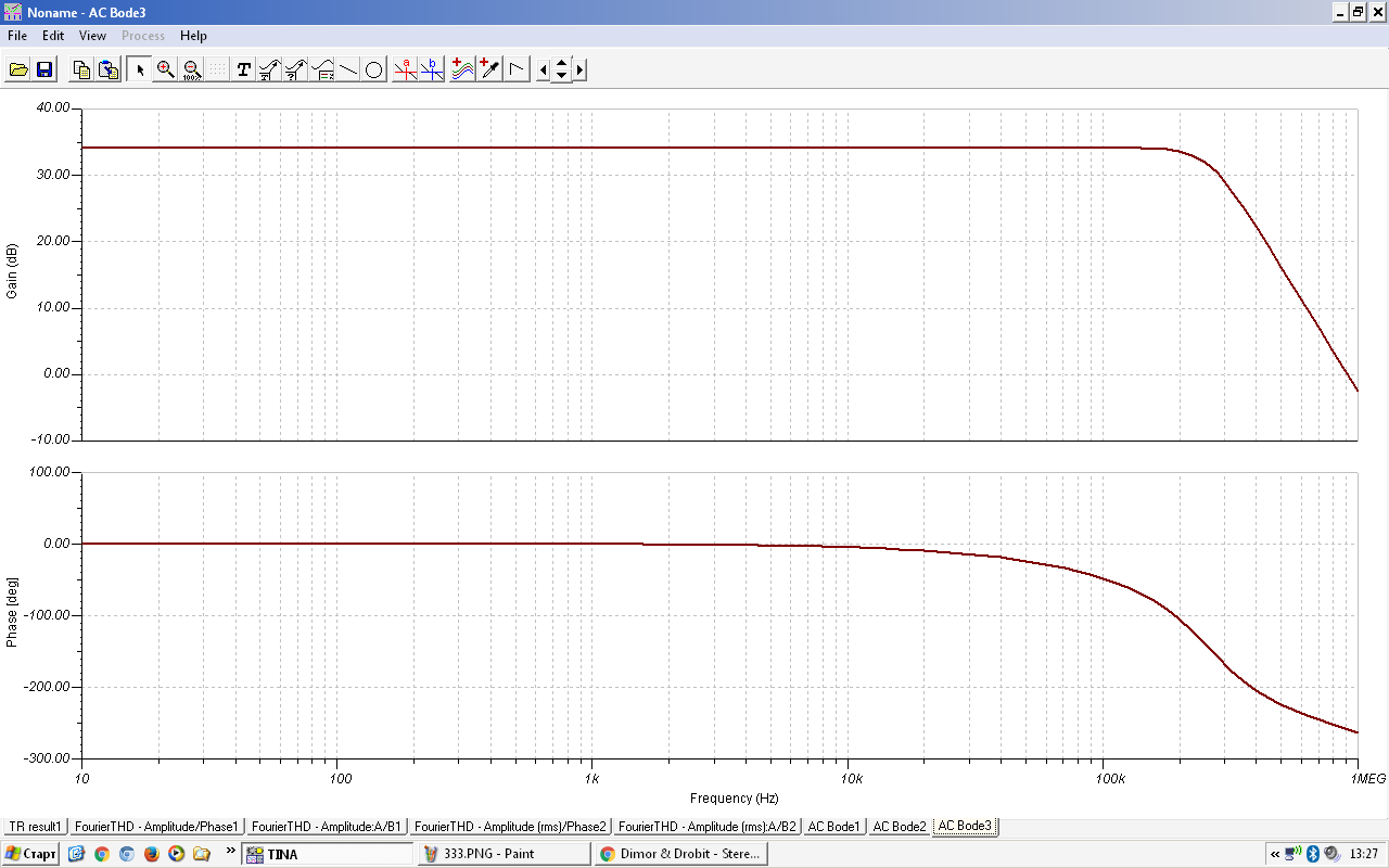

Forgot AC transfer
P.S. From now i will design for 5ohm load because min is 2ohm, max is 8 and AVG(2,8) = 5 ;p
P.S.2 Im going to redesign this because the transformer in the case is 4*17.5VAC 250W (im powering this with external one).
I will use only 2*17.5AC ->2*22DC. This would give me 20/5*20 -> 2x80W peak power @5ohm which satisfies my needs 🙂

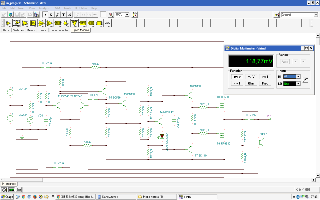

Updated sch -> R3 is now 2k & R1 is now 33k
this gives 119mv offset with these 47R resistors for filtering 🙂
i will add fuse between mosfet sources and FB.
in TINA there are no fuses 😱
Oh i need to do new analyses in TINA because i analysed with 34.5V insted 35 and thus lower the bias to 30-40mA instead ~90mA
I need to retune the biasing, now im designing this for 34V.

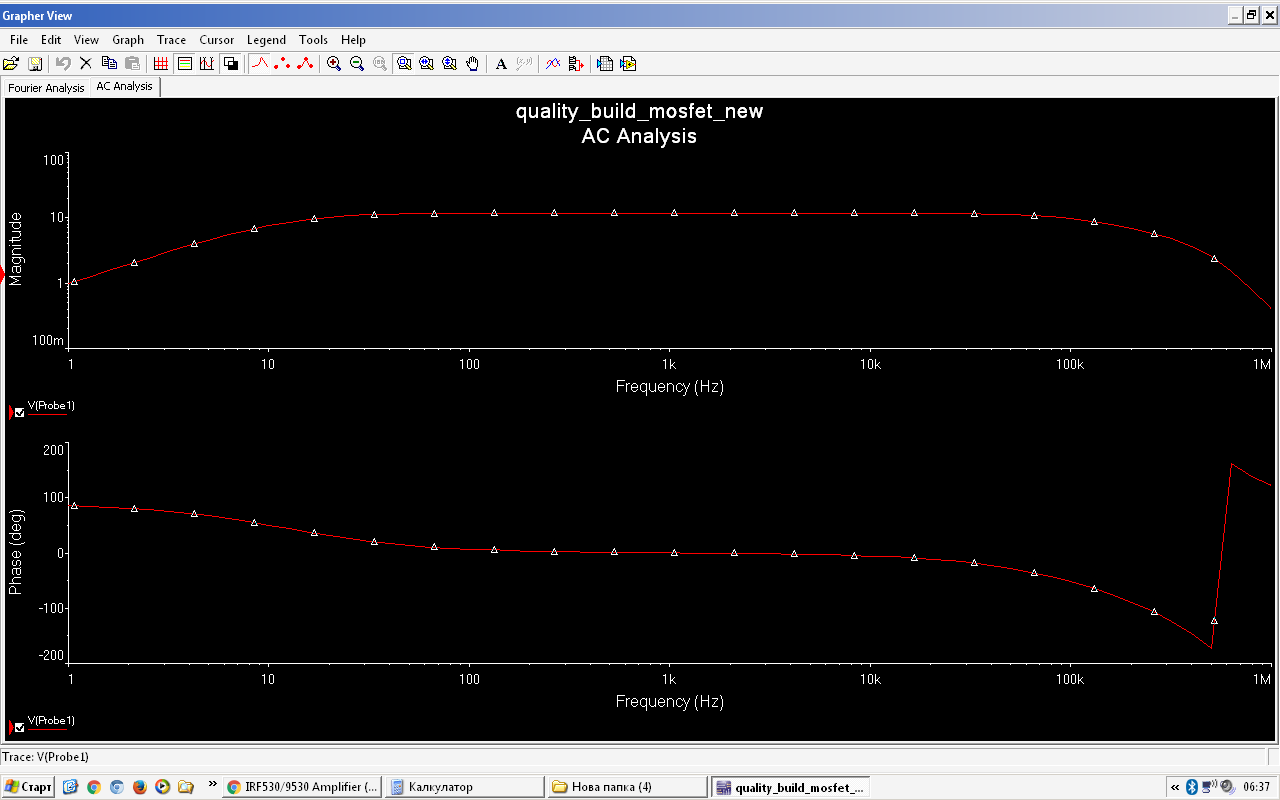

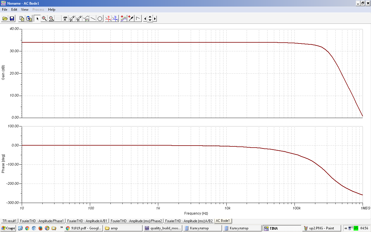

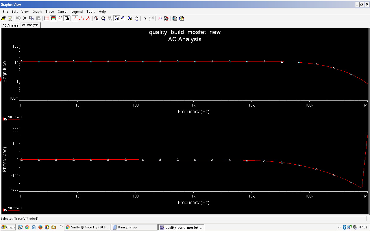

when i bypass C3 i get better AC analys.

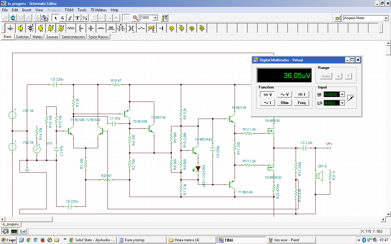

I changed R10 to 2.88k to get 86mA with +-34V but im confused why can't measure that. Look i added 0.47 resistor to measure the current but there are only 36uV instead 40mV 😕
And i was mistaken the offset voltage because i was measuring with signal 😀
i said 100-200mV, without signal its 37mV ! even better ;p
I think using CCS is very bad idea.
It makes no sense and even worse -> worse thermal stability.
Its floating resistance. Tail current must be stable, not termo dependable 😉
T5 must be 2n5401 for the bootstap improvement.
And one pair of mosfets is not enough. There must has paralleling.

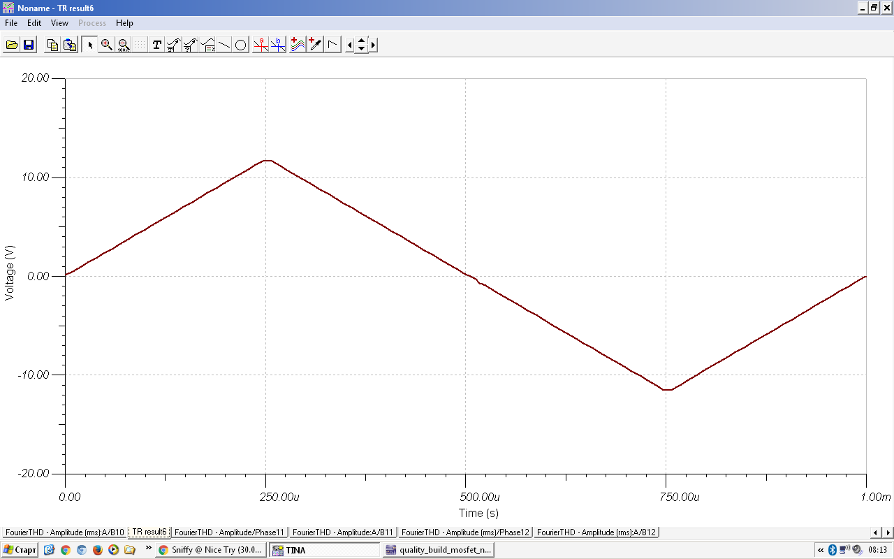

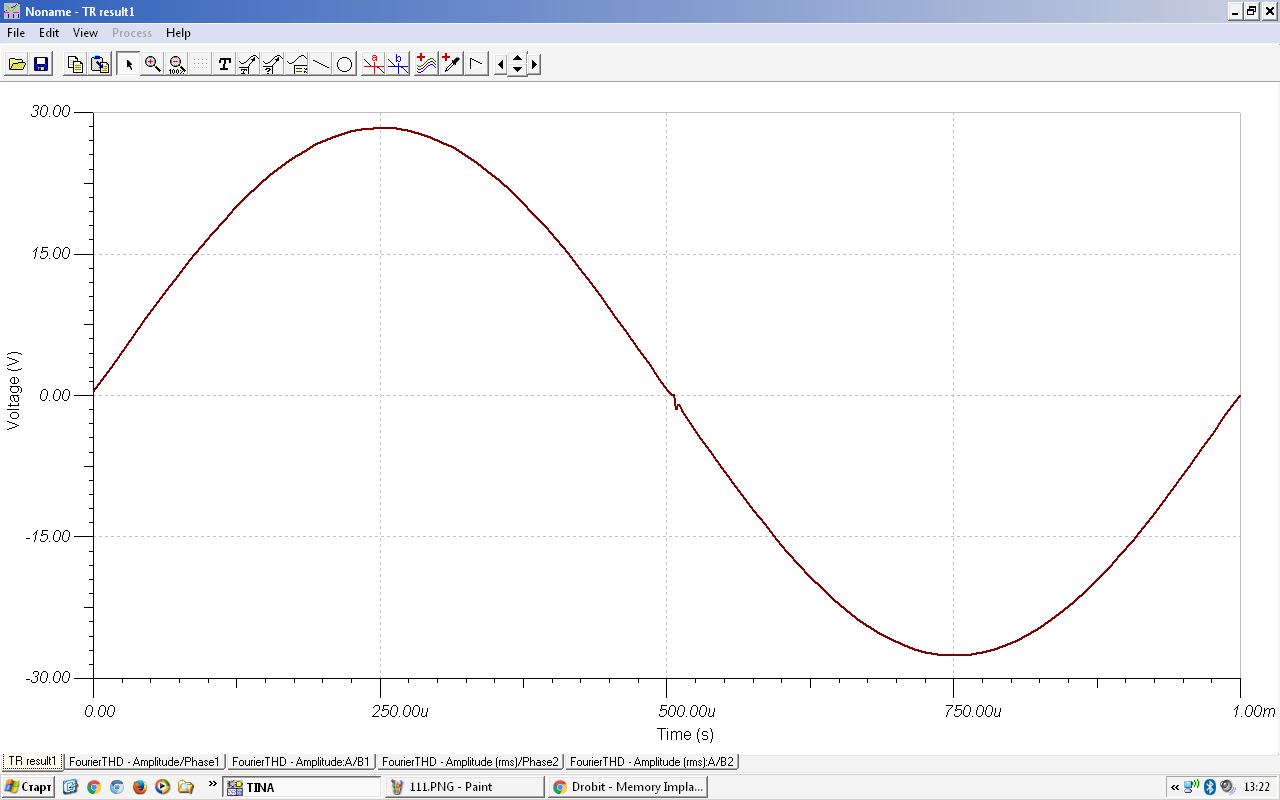

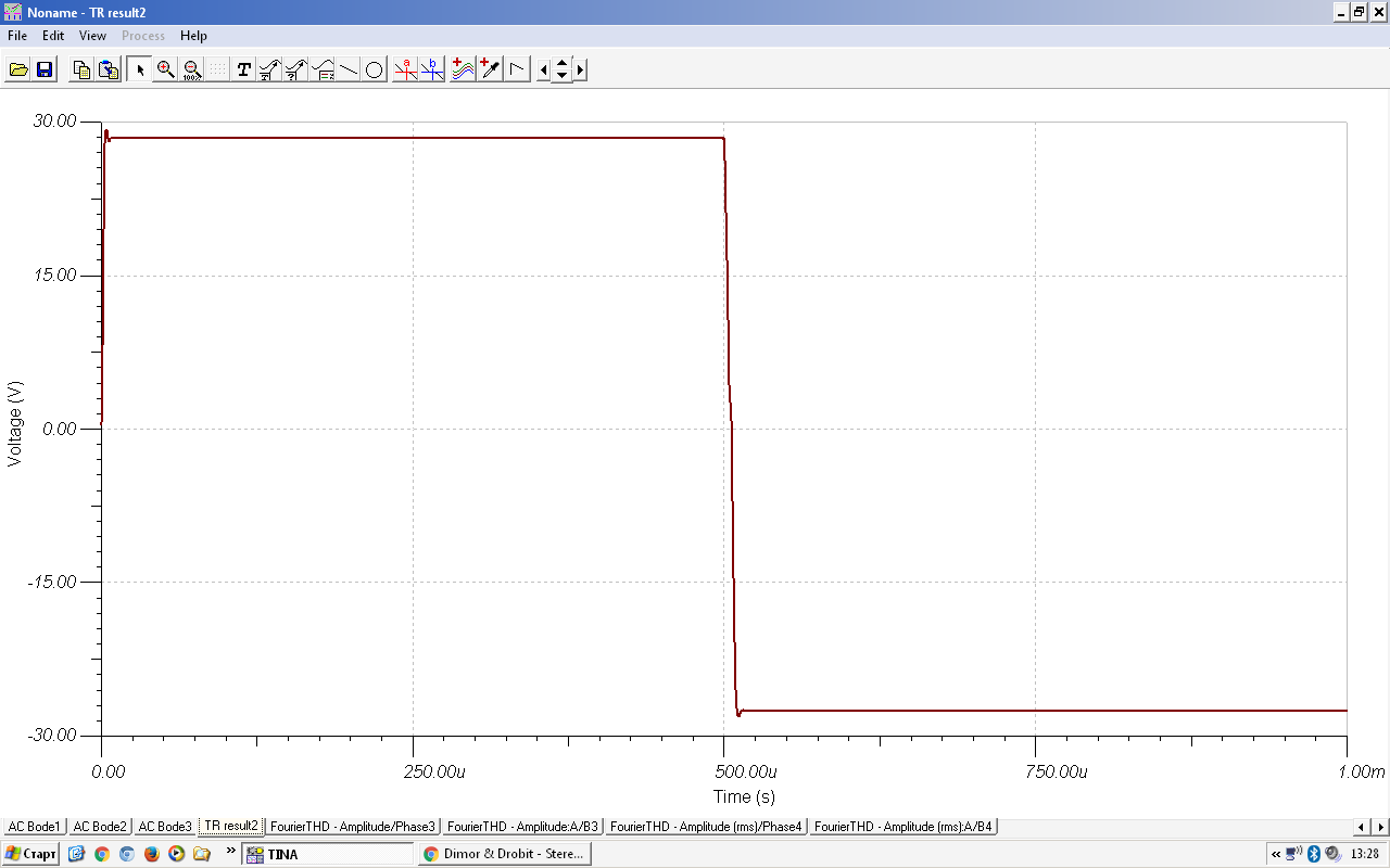

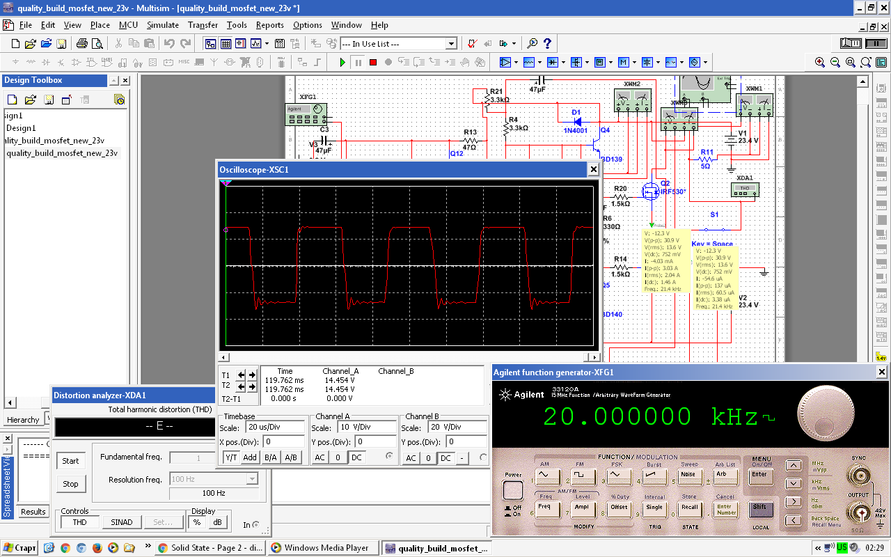

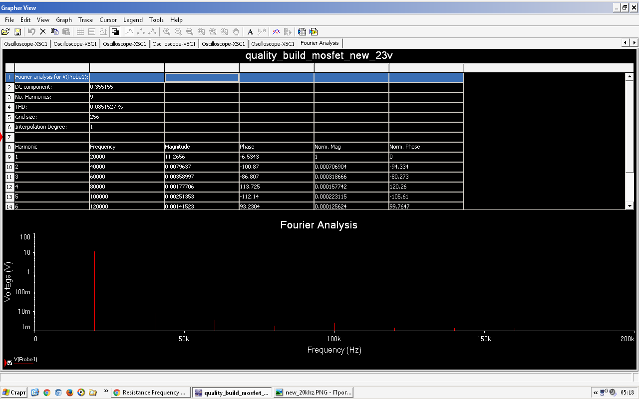

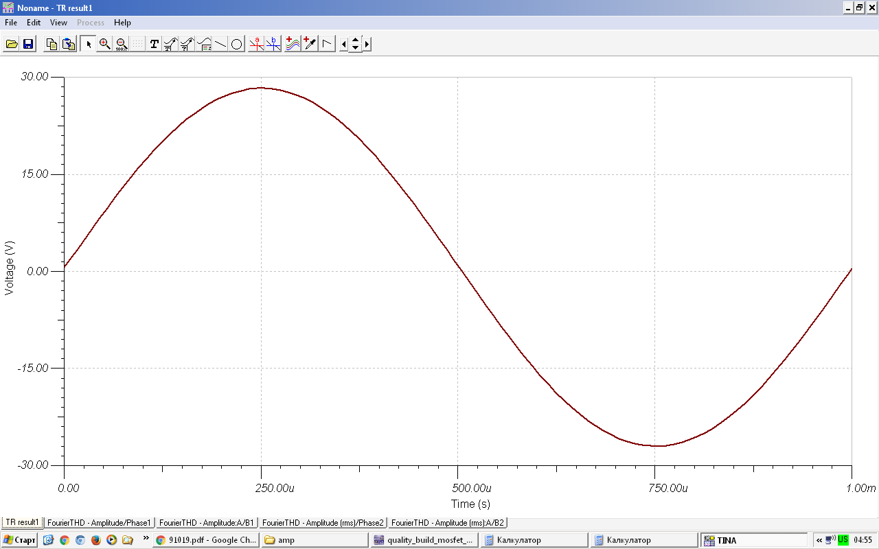

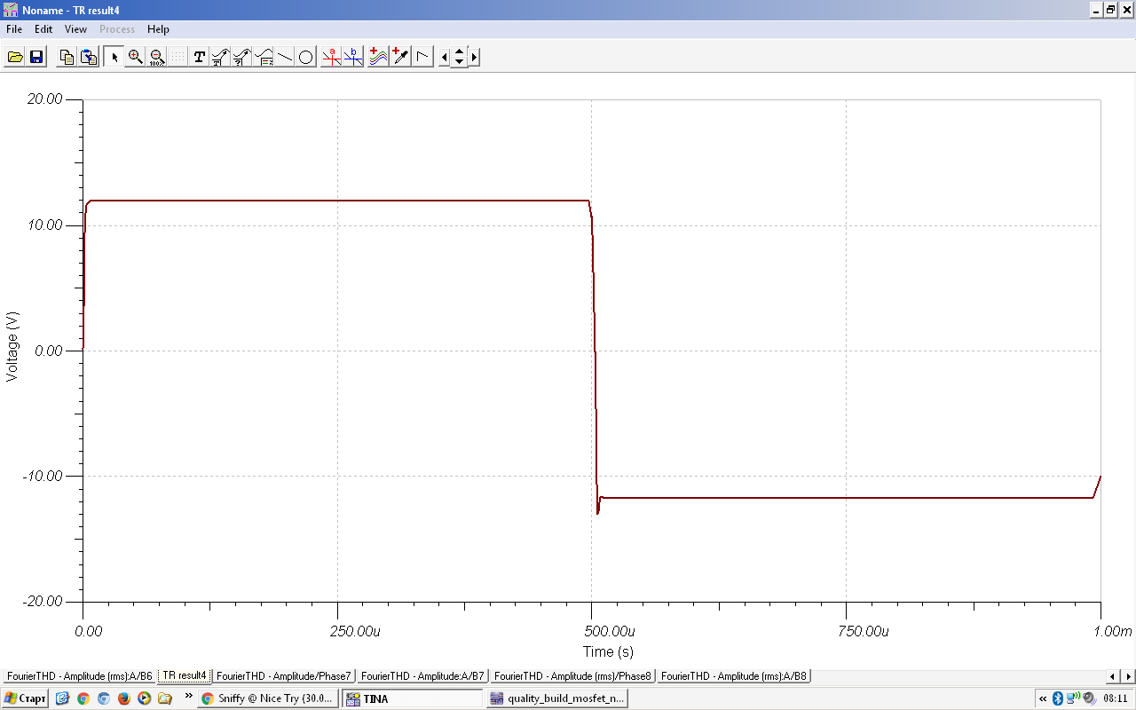

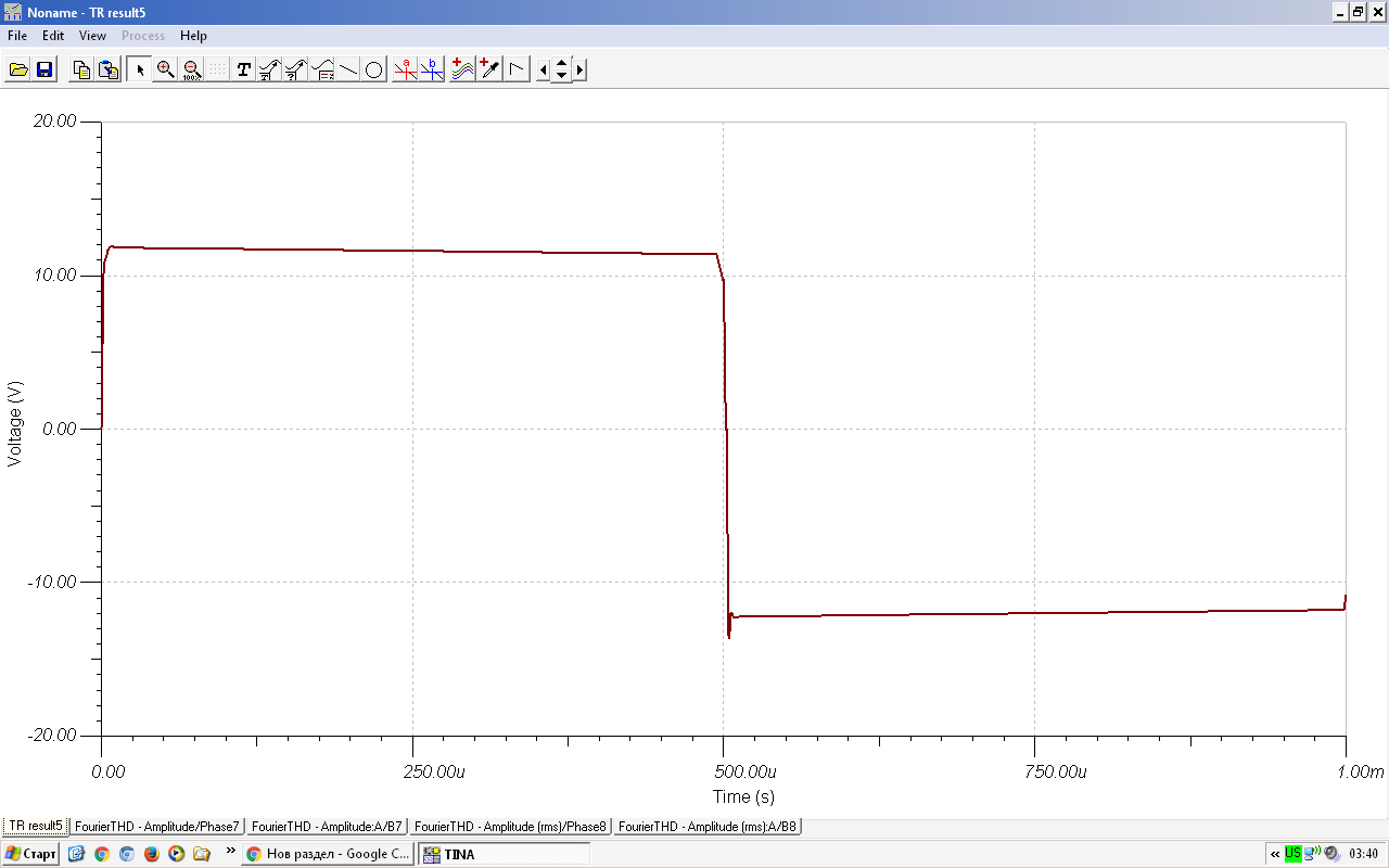

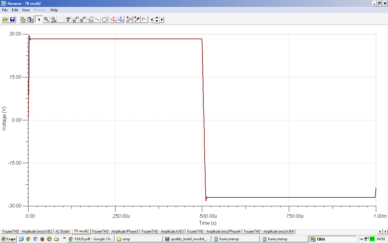

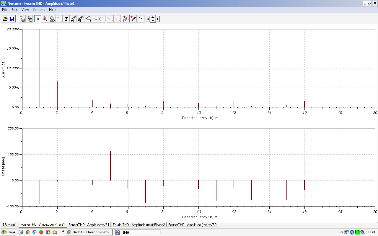

Updated sch and new analyses ->
square 1khz, square 20khz, sine 1khz and sine 20khz
harmonic dist - 0.1% 1khz ; 2% 20khz

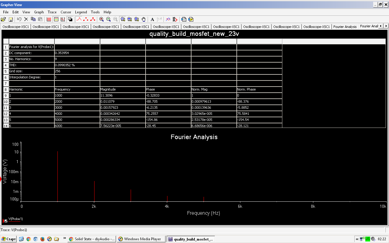

this distortion gets lower with 22p compensation but is this enough ?
If you send me your Multisim file, I will show you the stability margins, possible issues, etc. I just don't want to re-draw the whole thing.
vzaichenko@gmail.com
Files are in post #2 but i sent you the new version (23.4V one). Im uploading it here too just need to be renamed from .ms12.asc to .ms12
I measured 23.7V but im designing it for 23.4 (for high volumes).
I have very good idea -> to add shunting capacitor across R10.
this will short R10 @ 20khz -> more bias current from 94mA it goes to 378mA. Its possible to be even more,
this means class A at high frequencies 😀 😉
This is very good idea ;p

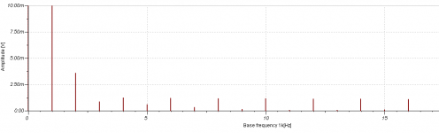

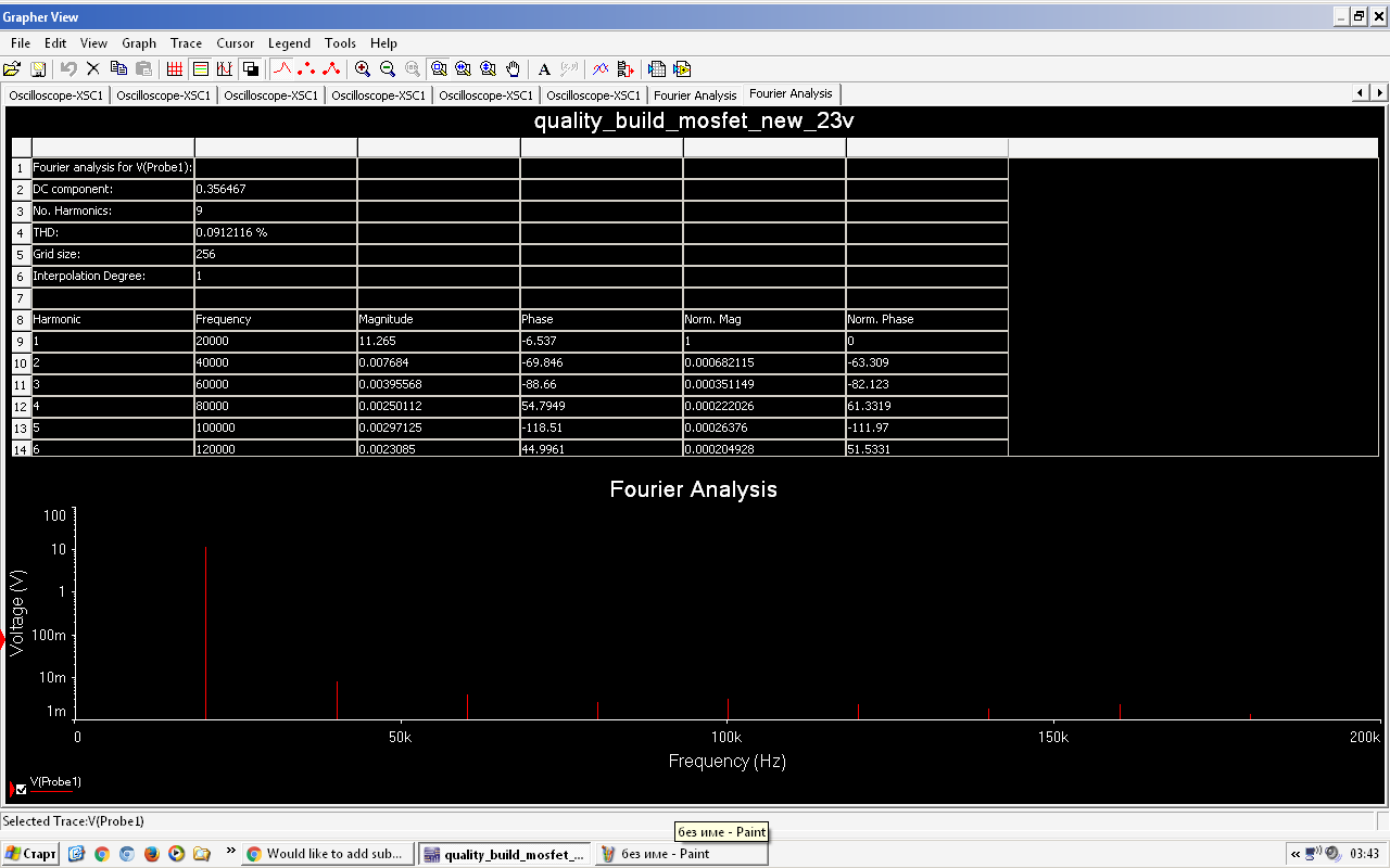

I calculated that 10u is needed for the good idea and tested it but its not working ? When i short circuit there its working dropping 20khz distortion to 0.2% which is very good. with the capacitor its 0.6% 🙁
I found out its better to use low value stoppers instead 1k5
i was calculated them with rc filter calculator and the capacitor inside to source.
P>S. Now with 220r stoppers im getting 0.12% @ 20khz & 0.1% @ 20khz with short across R10.
Maybe im not needing this idea no more 😀
i improved it bootstrapping the vbe, never seen technique before 😀
but is it worth ?
i very like the idea to be class A in 20khz but must think about it how to implement.
what bias current is needed for class A operation ?
Also i know how to improve this bootstrapped VBE allowing more bias current.
Changing the 1.8kiloohms to 2.4k and vbe's resistances. this will allow more bias current in the booting
P.S. this fourier is again @ 20 khz
but is it worth ?
