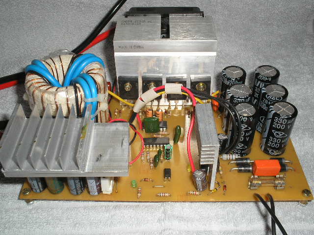

SMPS picture
Hi SMPS builders
This is my SMPS. 13.8V, 75A, Only 0.1V of voltage fall.
Thanks for all.
Sandro.

Mr. EWorkshop1708
Hi Mr. EWorkshop1708
Thank you very much. I'm so happy with your comments, ok?
There is two 2 in. outer diameter toroid cores one up other. 19 turns primary winding and 3 + 3 turns secondary winding (blue wire). I like it. It's so strong, no voltage fall in my power test with 0.18 Ohms resistor (76.6A).
About the cooler in the heat sink I think it's no necessary because the IRFP460 stay "ice", only the diodes heatsink stay warm.
REgards
Sandro

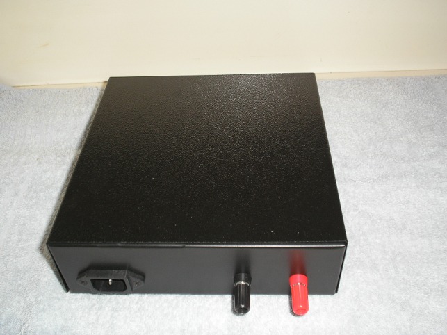

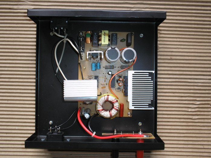

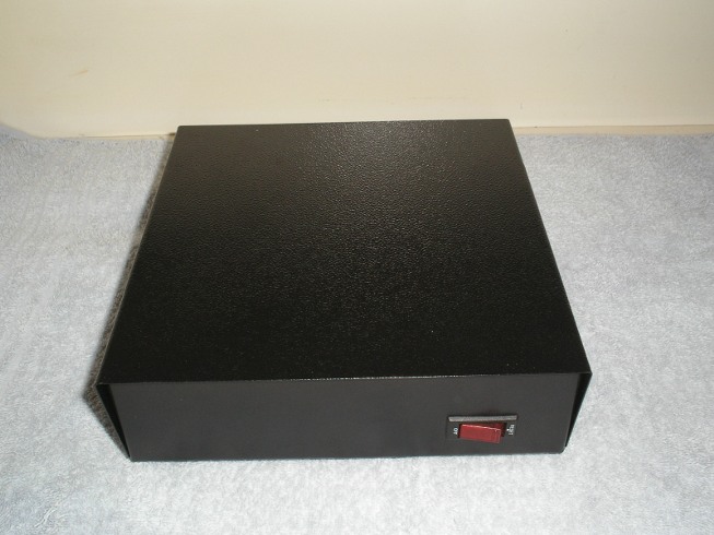

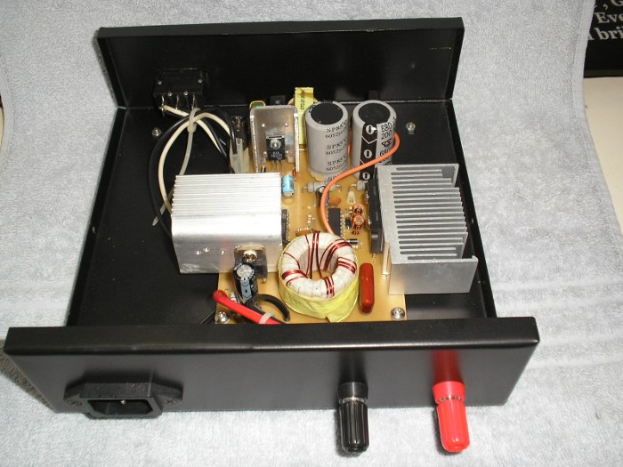

ANOTHER SMPS
Hi Dears
This is another SMPS. It's "factory" look :))
Only 25A in 13.6V. (127VAC input).
It's my "baby". Good for HAM activity, it can to supply HF rigs like ICOM IC706MKIIG, Yaesu FT-840, and others 100W TX.
Bye
Sandro
