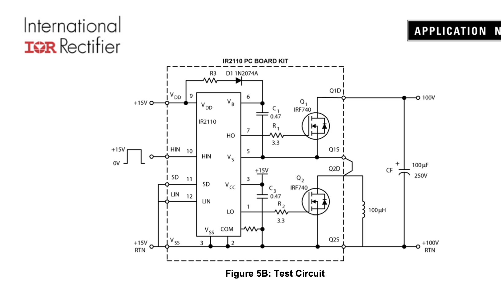

IR2011 class D issue

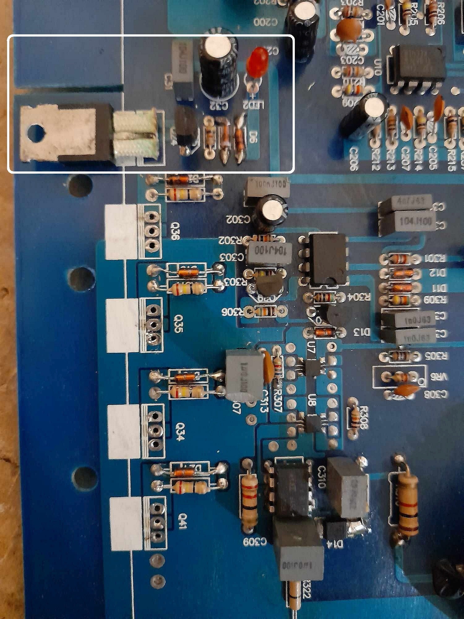

Do You want me to zoom in certain area ?

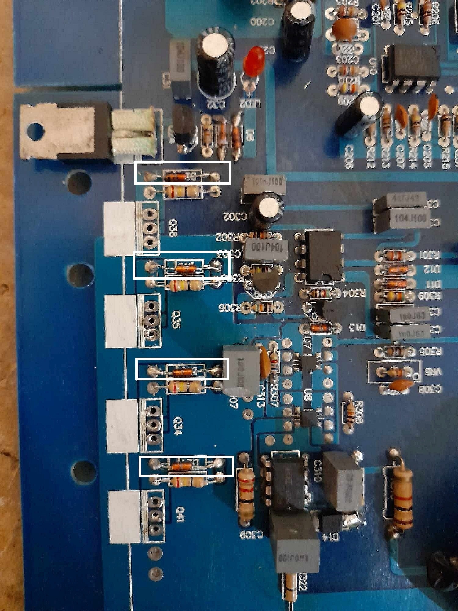

Does the problem get worse when going from 4 ohms to 2 ohms? - i would say stays almost the same...
I've noticed one of the mosfets in the output section (fb41n15d) is getting hot, much much faster than the rest 7....sadly these ones are obsolete
Can you swap that FET with one in another bank to see if the heating follows the FET or if it's due to the location? - this is what i'm doing right now
I'm assuming that you've checked all of the drive circuit components. - i've even changed all the 1n4148 diodes with new ones, new gate resistors just to be 100% sure.
Okay..,this exact one mosfet is the issue...it's heating up more even at idle comparing to the others, no matter where it is in the board....so now I have to swap all of the 8 mosfets with something else, because I can not find 1 fb41n15d....
