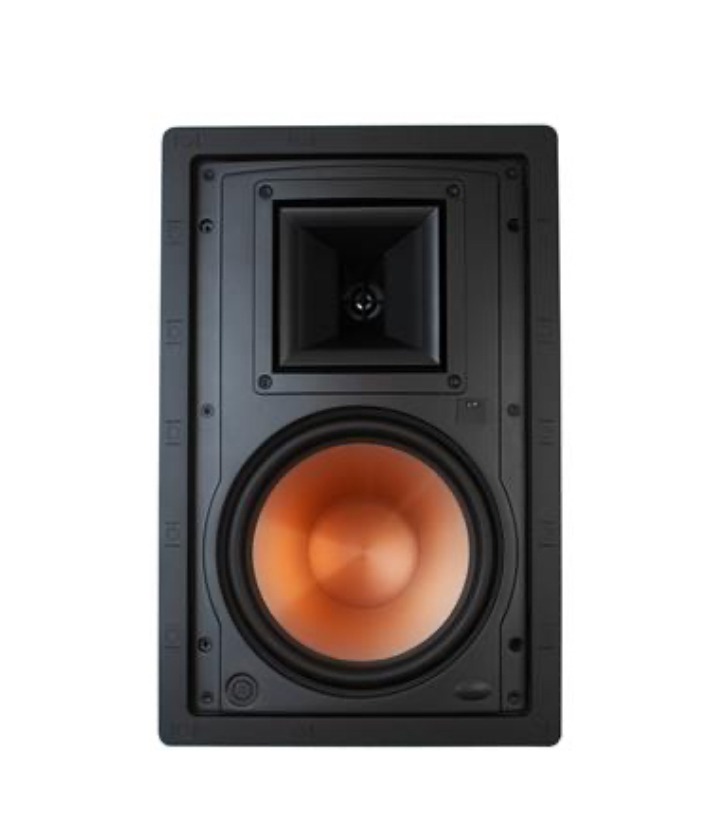

In my living room i have Klipsch inwall and the little horn can be adjustet to a little toe in. It works:

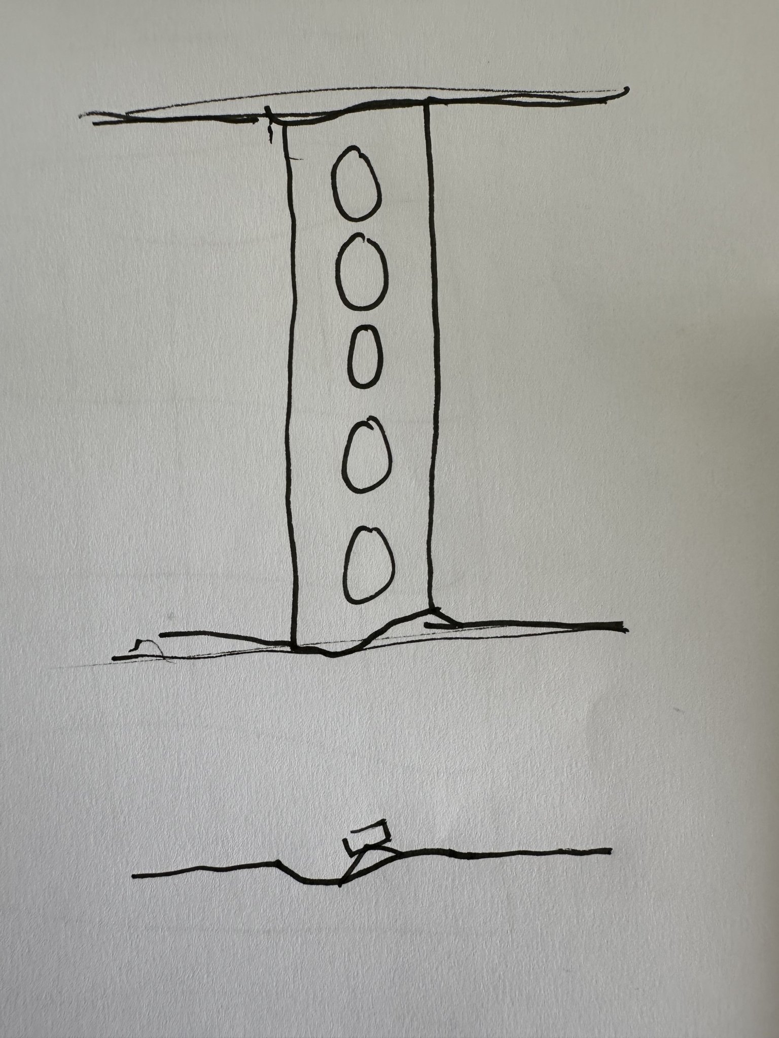

My main question is: how to i build the ultimate inwall system with the best depth and resolution as possible?

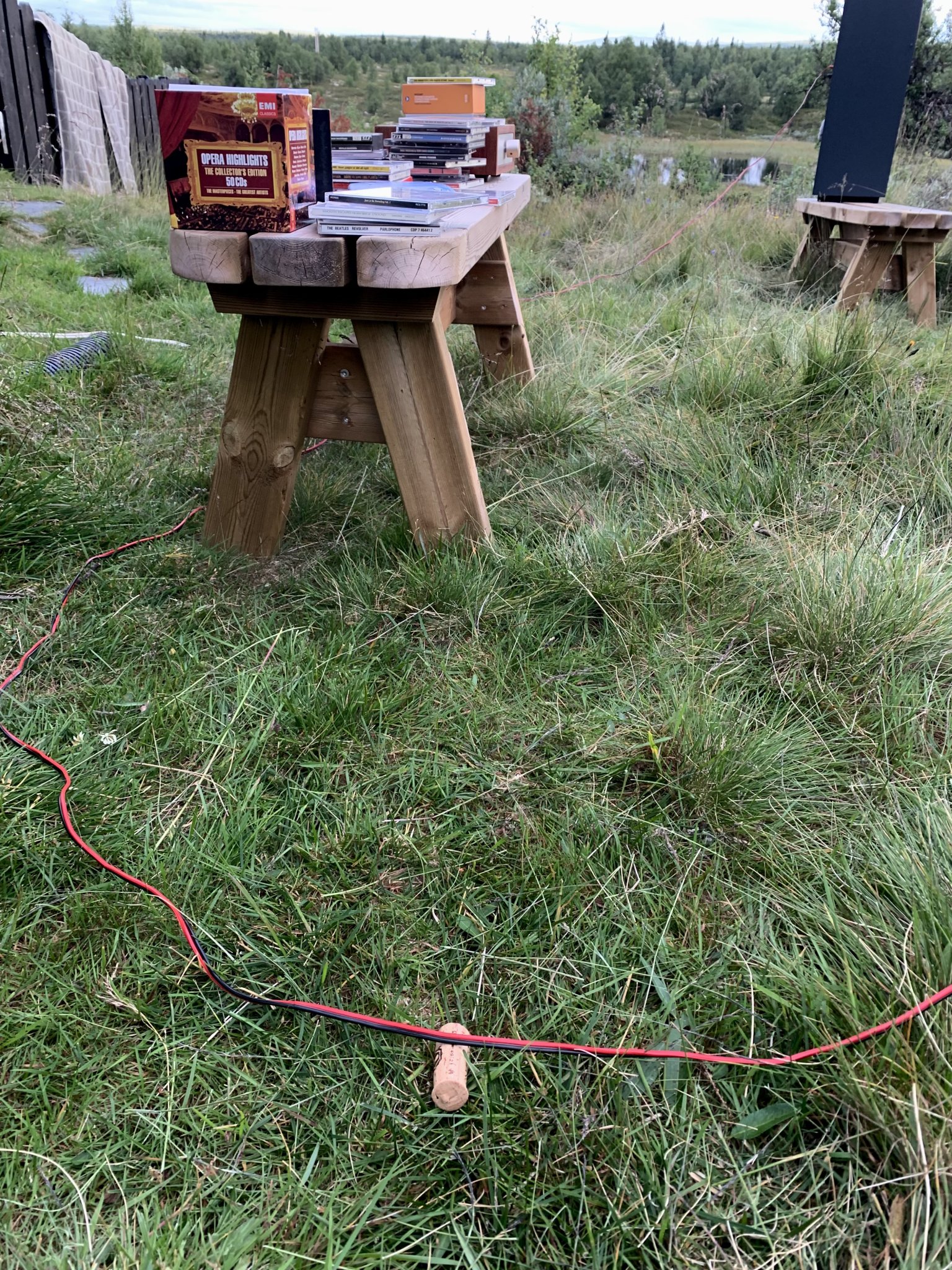

Why don't anyone of you listen to your speakers OUTDOORS ???
shame on you lazy tards 🙂
(spring is coming refresh your ears)
Good point 👍

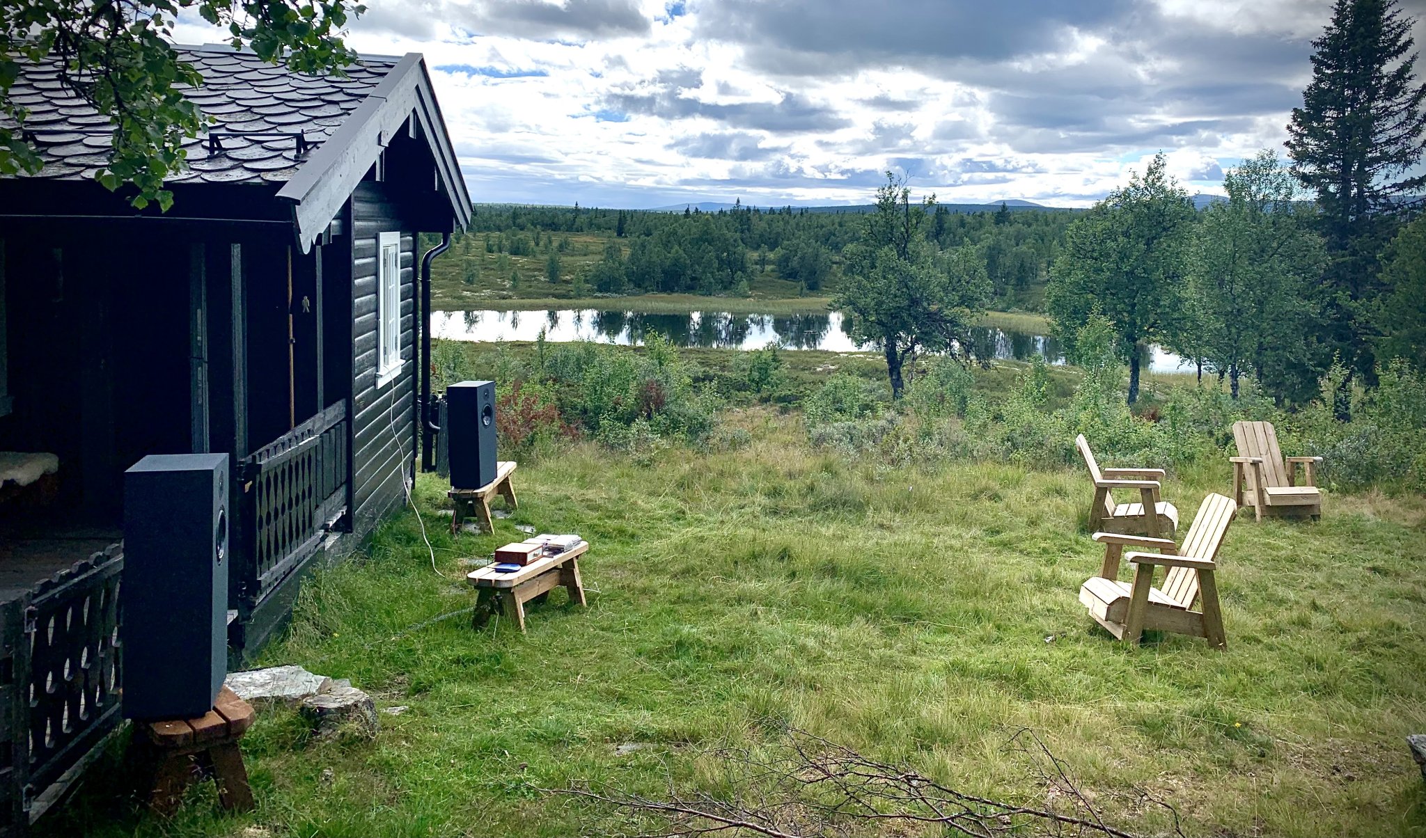

At my cabin sometime we bring the loudspeaker out and it sounds very good and uncoloured 😊 …… ok, maybe a little green 🤭
I friend suggested a tweak; cable lifters. During the long and bright Norvegian summer night we got more and more lifters 🙄
What a wonderfull green carpet you have layed out there 🙂
no fear of floor reflections anymore .. we need such natural carpet tiles for our hobby , sticking with magnets and easy exchange option!
The true barefoot listening sensation - very relaxing over the weekend , feels like having a vacation 🙂
With a average 140-200 days a year with rain.Why don't anyone of you listen to your speakers OUTDOORS ???
Very little daylight or sun for 3 months.
Temperatures between +10 and -10 for 4-5 months.
A well behaved winter day is <- 10 m/S of wind, some 50-100 m/S wind gusts with unknown frequency in winter months.
And of course the joy of snow, ice, slate, hail and any combination.
One can wonder why we don't listen much outside🤔

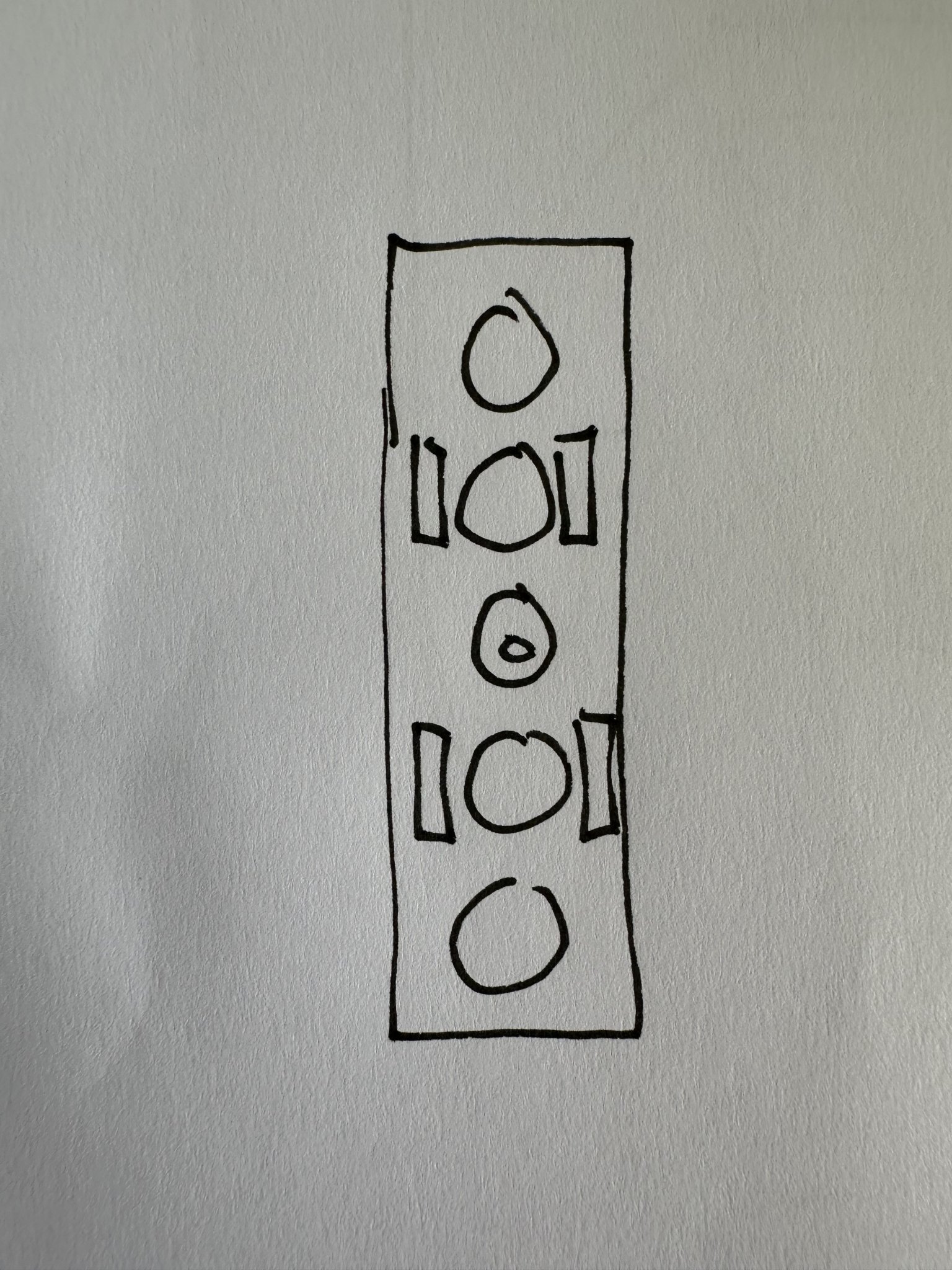

One of my options is WWMTMWW (+ subwoofers) with Seas drivers i already have:
Woofers (>80Hz): https://www.seas.no/index.php?optio...rnx3&catid=44:utv-prestige-woofers&Itemid=461
Mid: https://www.seas.no/index.php?optio...&id=611:e0115-08-w16nx005&catid=49&Itemid=246
Tweeter: https://www.seas.no/index.php?optio...10-04-t29x&catid=50:excel-tweeters&Itemid=247
And i am very curious of the diamond tweeters 😬🙄

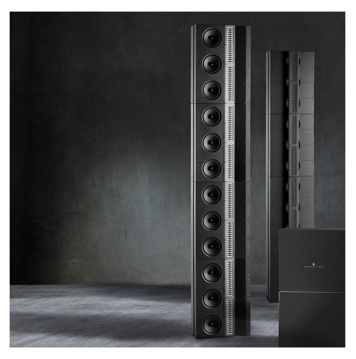

https://steinwaylyngdorf.com/steinway-sons-ls-center/
