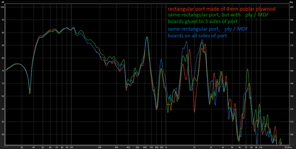

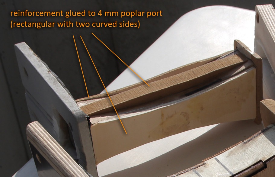

I wanted to keep this for later, but as the issue was raised now:
here are my measurement regarding port wall reinforcement (stiffen them plus adding weigth). mic outside the port 10 cm to the side, 1V input swept sine.
the resonance around 1,8 kHz (second harmonic of fundamental resonance) is getting stronger with stiffer (also heavier) port walls. the influence is not as strong as I thought when tapping on the port.
the first strong resonance at 650 Hz is the enclosure length resonance, around 900 Hz is first port resonance.
generally I would say: a non-resonant material and construction makes sense for the port. adding weight to the thin poplar plywood (thus making them more resonant) was counterproductive.
I suspect the difference of green graph between 100 and 500 Hz may just be a mic position inaccuracy.

That could help break up the resonance.
Maybe just a few “bleed points” along the port surface.
yes, that is possible.
the problem is to keep the efficiency of the port for the helmholtz resonator.
thus I tried to dampen resonances with as few port discontinuities as possible and putting them at the most effective location.

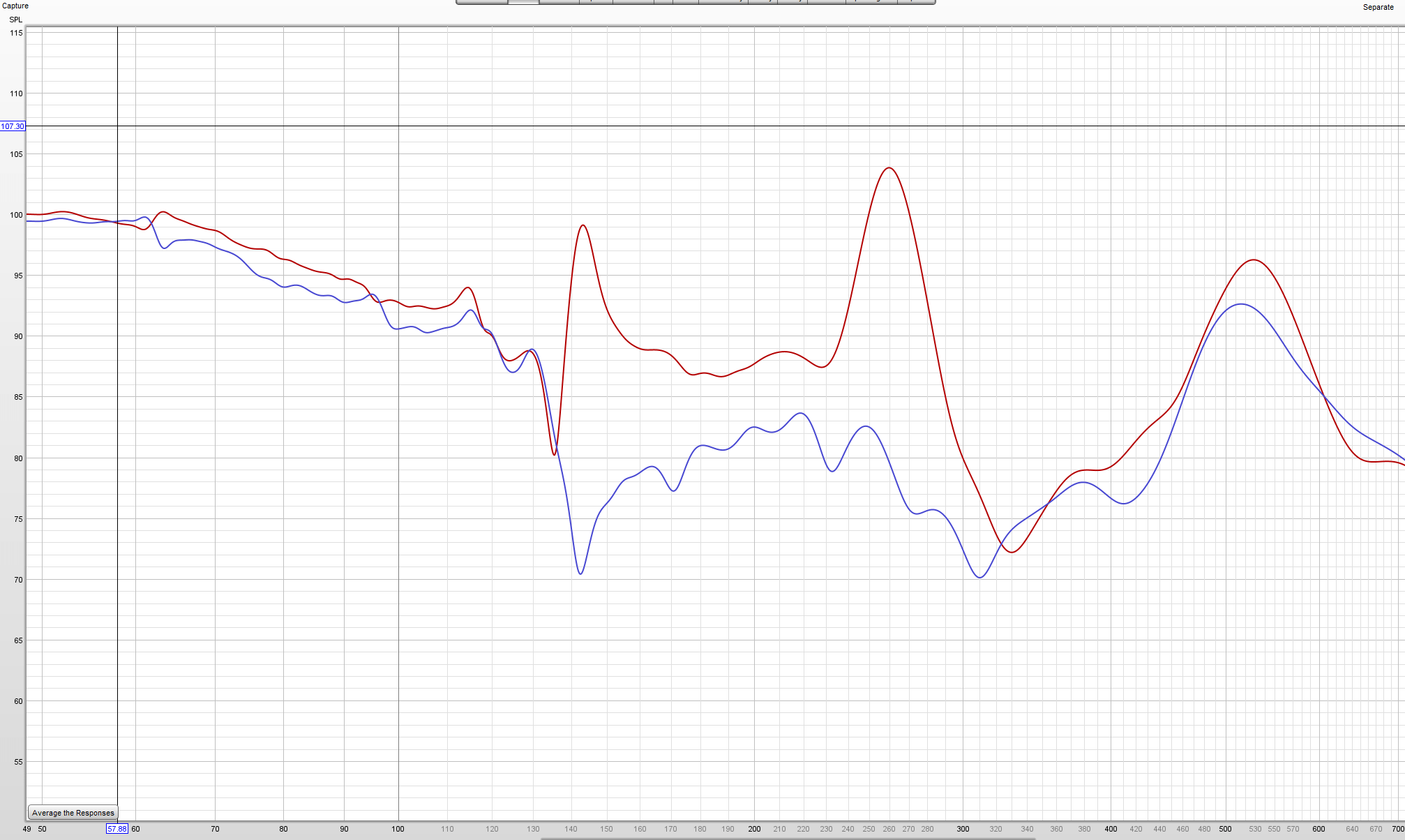

Here was the outcome of polyfill from my favorite pillow, just filled inside the box and measured few years ago(probably to little more than medium level fill).
Results? the graphs look better and I am a insomniac now.
It's not really clear to me what the whole discussion about the port walls is about ?
A poor wall will just result in losses, since that is being transformed into energy to move the walls of the port.
Or another way of saying it, is that all ideal calculations/simulations are done with ports with ideal walls aka infinite amount of inertia = very heavy/stiff walls.
So a very thin flappy wall will just bring the Q-factor of the port down = less high impedance peak.
Which is not always easy to see from just the acoustic output from the port itself.
In general just a standard PVC tube thickness is often enough, the roughness of the tube is more significant.
So in theory it's beneficial to 3D print into the length of the tube, although that is not the easiest way to print.
If you want to go more stiff, you can go for aluminum pipes, they are cheap as well.
I guess, when we stretch the theory a bit more, this could have some effect on the harmonics as well.
Since they become less pronounced.
But I doubt that is a good thing. Or at least not the right way to solve the problem of these standing waves.

from my side it was just an experiment to check the influence of port wall resonances.
it was a quite non-scientific experiment that I wanted to do after knocking a port and hearing the resonance.
conclusion of my experiment was: the port walls have relatvely small influence at the major lower resonances and I followed another way to reduce those.

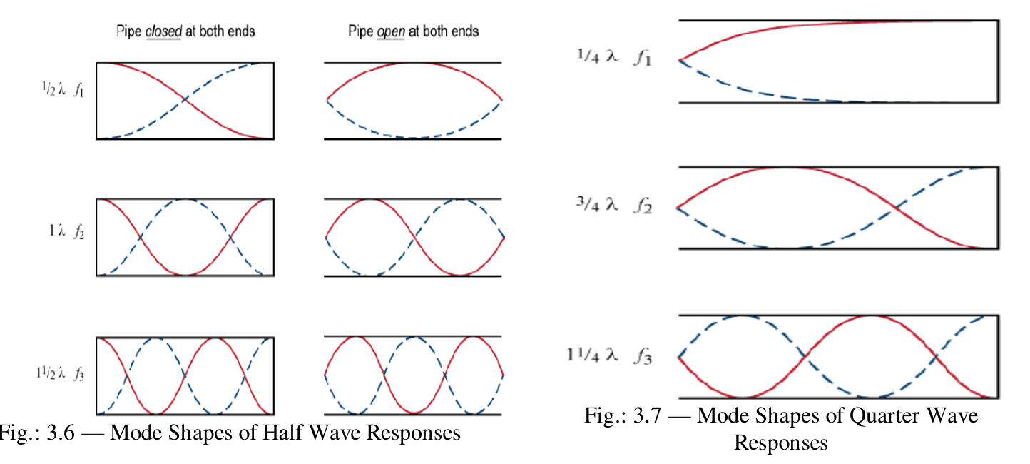

@stv
I was kinda confused about the max and min pressure modes.
But all of a sudden it hit me that I was thinking about a tube with two closed ends (aka a cabinet or a room).
They have the same harmonics and fundamental as function of their length.
Which makes it sometimes a bit confusing 😀
Easy trap to fall into sometimes.
These are pressure waves:
Reactions: Tenson and stv

@stv
This also means that my theoretical tinker ideas from post 76 and 80 are gonna be slightly different as well;

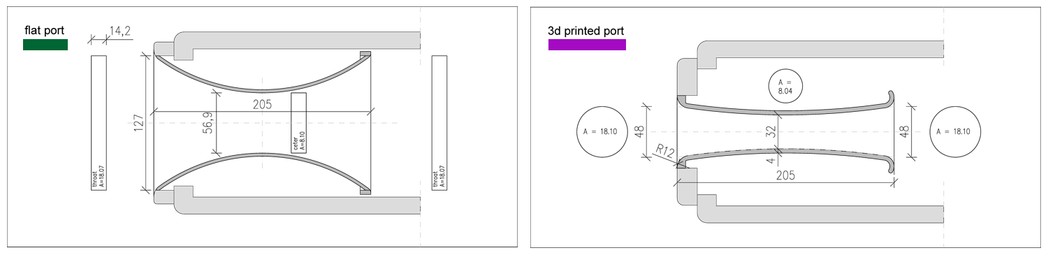

port variants in chamber 1​
also refer to photo in post 104.
in order to replicate and investigale the good results of curved wall rectangular port in chamber 2 (lower tuning) I tried different port shapes also for chamber 1. all ports except for the classic tube ports have the same (or very similar) cross section areas across the port lenght.
I removed the longitudinal enclosure resonance absorber (internal helmholtz absorber, see post 22) to better clarify the differences between port shapes.
here are the variant plans and the corresponding response curves, taken with 1 Vrms input, microphone 10 cm to the side from the center of the port.
due to the very different opening cross section shapes the mic distance from the port edge/roundover varied quite a lot, so i adjusted the responses for similar SPL in the useful bass region.

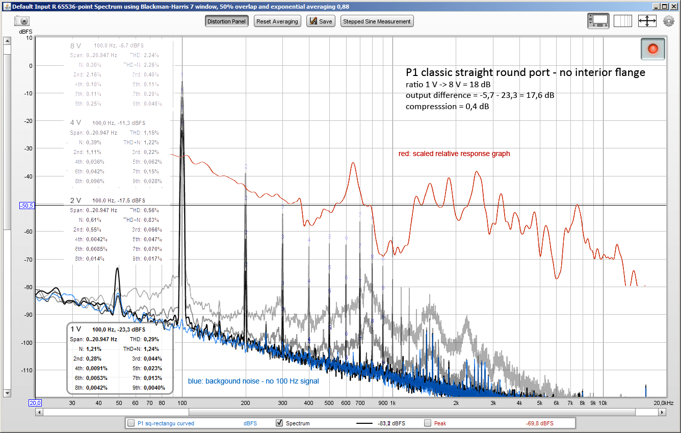

(chuffing noise and resonance results will come next!)

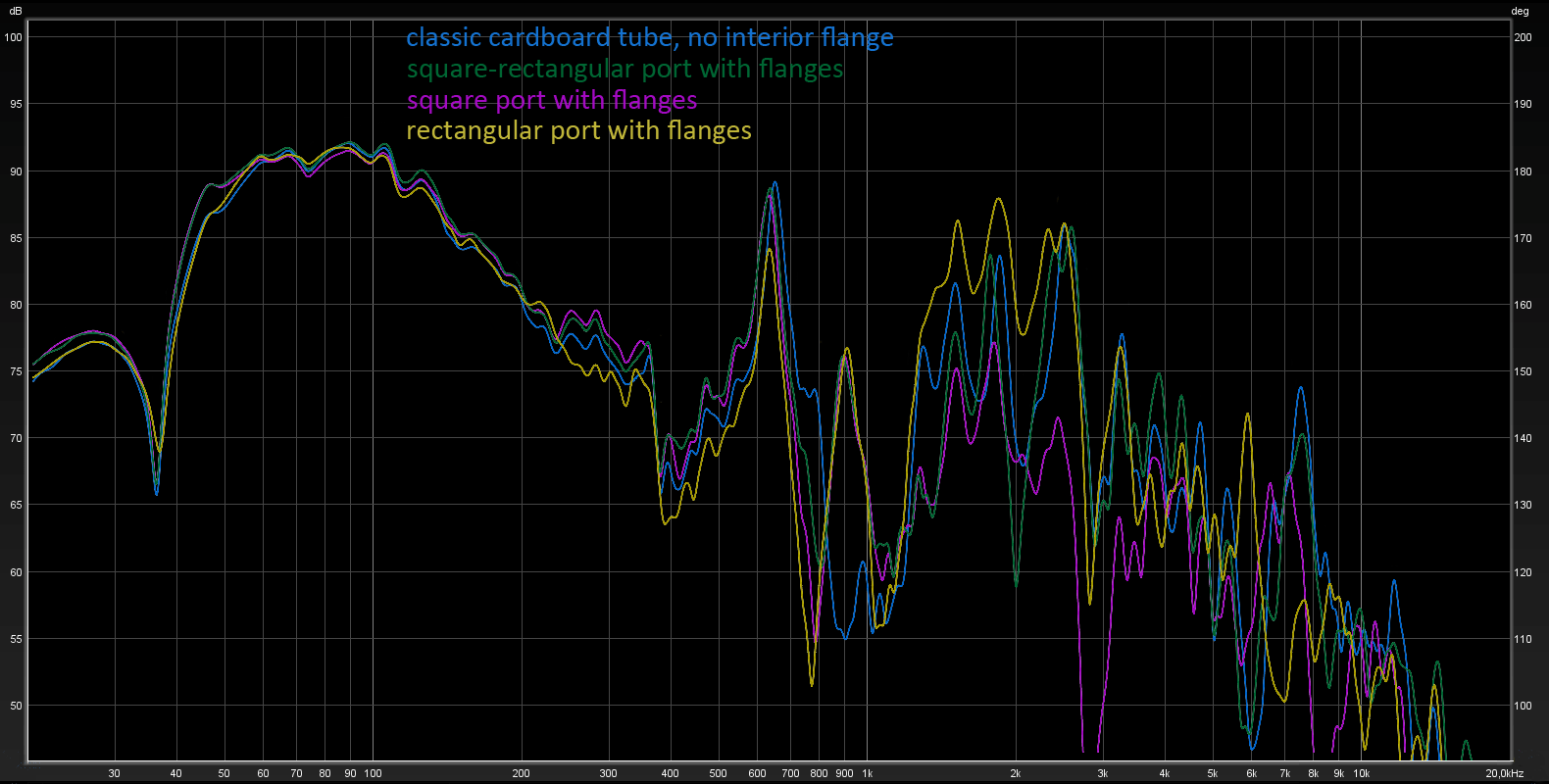

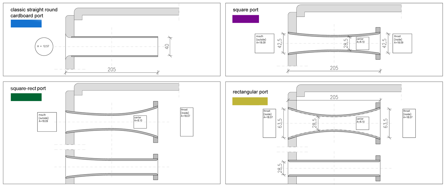

first the round cardboard tube port with exterior flange roundover and some different shape rectangular plywood ports:​
the most interesting detail is that the longitudinal port resonance at ~900 Hz of the classic round cardboard tube is non-existent.
this may be similar to the roozen paper, where the hard edge tube port had low Q resonance.
the enclosure longitudinal resonance however is the highest.
also, the rectangular port "picks up" most of the higher frequency enclosure resonances or produces them by itself.
as a general remark: the relation between enclosure volume and port size/ cross section would be very unusual for any bass reflex box, as this is the upper resonator of a 6th order parallel bandpass.
as far as I understand (and as can be seen below with small port) this results in very high resonance peaks. this would make a bass reflex box quite unusable.

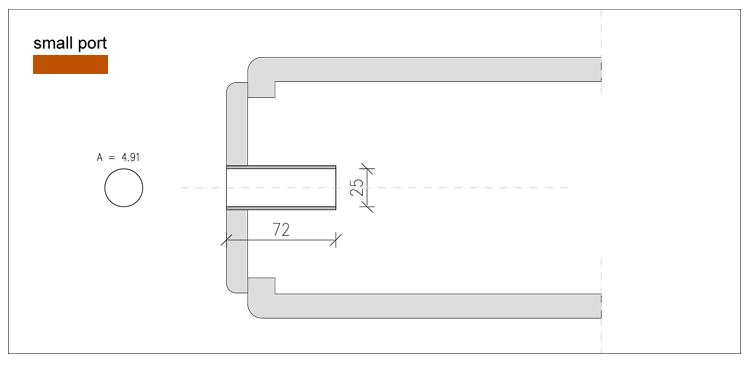

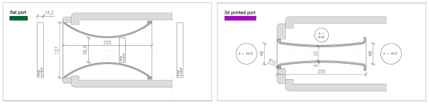

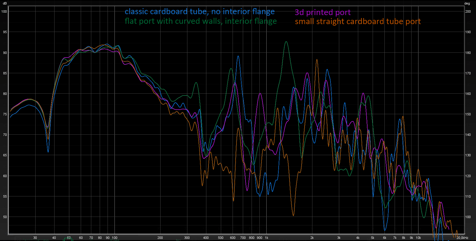

next a very flat and wide port, the 3d-printed and smoothed round port and a very small cardboard tube port:​
for better comparison i included the blue graph of the classic cardboard tube port.
my observations:
enclosure length resonance frequency varies.
the flat port seems to have no longitudinal port resonance at all (~900 Hz), but a very pronounced enclosure width resonance (1300 Hz, also 2nd harmonic of enclosure lenght). there also is a small resonance at around 350 Hz which i could not relate. maybe port structure resonance.
3d printed port is different: more port length resonance (900 Hz) but no enclosure width resonance.
i suspect the wide (side-to-side) opening of flat port picks up the width resonance pressure peaks.
small port (2,5 cm diameter, length adjusted to same helmholtz resonance with hornresp) generally has much less resonances. the peak at 2,2 kHz is the port length resonance. other lower resonaces are enclosure length (650 Hz) and width/2nd harmonic lenght (1300 Hz) resonances.
while the small port seems to behave best in the response graph the chuffing is obviously worst (hard edges inside and outside).
I have no access to a 3d printer at the moment but I will definitely print an optimized shape port with similar size as the small cardboard port to test it.
edit, for clarification of plans:
dimensions in mm, cross section areas in cm² (for easier simulation in hornresp!)
chuffing measurement of straight classic round port​
here is my chuffing measurement of straight round classic port without interior flange.
i used a sine with resonance frequency of chamber 1 (100 Hz) for maximum air speed in the port and took screen shots of the respective spectrum.
the spectrum of 1 V, 2 V, 4 V and 8 V are shown in shades of gray, background noise without signal is blue.
I also included the response graph in red for comparison.
on the left side are the THD+N percentages for the different input voltages.
as can be seen and as obvious, only the port resonances are being excited by the chuffing turbulences.
the port resonance were masked by the other resonance peaks in the response graph but not at all "non-existent" as I wrongly stated above!
chuffing only starts above 2 V. the broad peaks in lighter grey are the 4 V and 8 V turbulence noises and port lenght resonance chuffing tone.
as I wrote in an earlier post, the port resonance peaks excited by chuffing are the most annoying and noticeable, because they are mostly not related to the input signal frequency (music), here the port lenght resonance is 750 Hz with no harmonic relation to 100 Hz. second harmonic at 1500 Hz, third at 2250 Hz.
the generally raised noise for the 4 V and 8 V signal between 50 and 4000 Hz is not very noticeable, but it does cost sound output energy, thus there is a slight compression effect of 0,4 dB between 1 V and 8 V.
also note that N in the 1 V and 2 V "THD+N" window is slightly higher because of background noise (traffic, wind and a suspicious refrigerator in my kitchen).
in my previous measurement for the chamber 2 port I found a good correlation for harmonic distorsion and chuffing noise, and in addition for the low bass frequencies the THD is usually quite high anyway, so I focused mostly on the "unmusical" chuffing resonance peaks in my further measurements.
