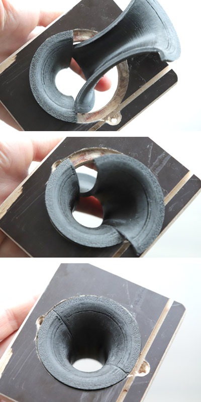

I may be on to something with the geometry as described in post 320.
well, it was to be expected, "elliptic shape ports" have been mentioned somewhere in the papers ... and many people already use them!

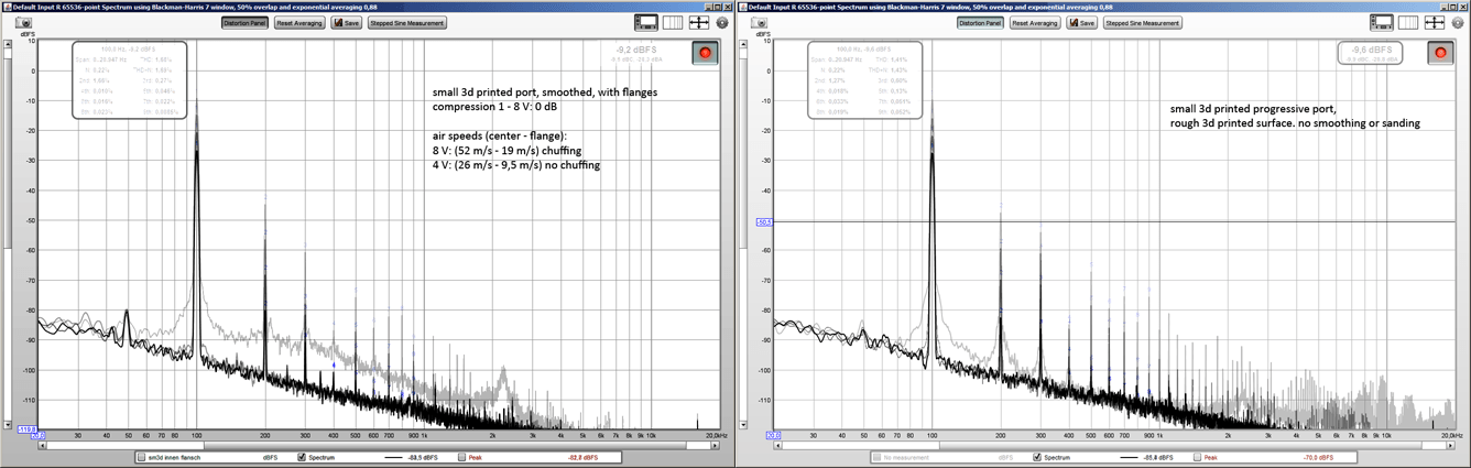

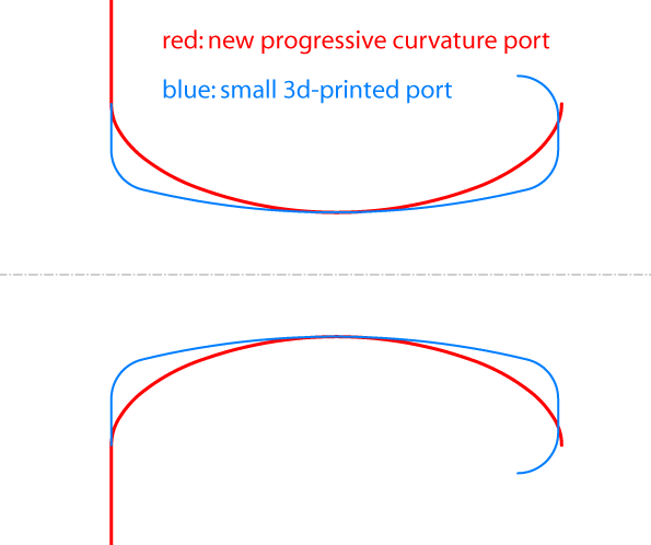

here is a rough (sic!) first chuffing comparison of small 3d-printed port (left) and the new "progressive curvature port" (right).
both ports have the same minimum diameter of 2 cm at the center. lenght is roughly the same.
the new progressive port has a bigger opening surface to the ends, thus the helmholtz tuning is slightly higher. the 100 Hz output is very similar however.
the new "progressive" port was printed standing up (thanks @augerpro for saving me some filament!) and I just joined the two halves with modeling clay, leaving the surface as it came out of the 3d-printer.
compare the light grey graph indicating the spectrum at 8 V:
the small 3d-printed port with a narrow radius opening has quite strong low frequency noise and the longitudinal resonance chuffing.
the new progressive curvature port has no low frequency noise and supposedly no "stalling" (which for the "small 3d printed port" also leads to longitudinal resonance buildup), but there is more very high frequency hiss, which for sure is the rough 3d-printed suface.
comparison of both geometries:
now I just have to find a correction factor for port tuning, compose a geometric formula (or is it just the elliptic curve?) and add the "latex resonance absorber" in the center. the main advantage of such a port will be the reduced dimension with subsequent reduction of resonance output and higher frequency port lenght resonance, ideally outside woofer pass band.
that's it. I found the perfect port! 😊

Amazing what that tiny 3d printer surface roughness does in the top octaves of the chuffing noise.
This is how I printed ome, split across the width, small flat flange for gluing and print bed ahesion. Allows one half to be flipped, so overhangs are all on the outside surface.
But your way does put the seam parallel to the flow, so maybe better 🤔

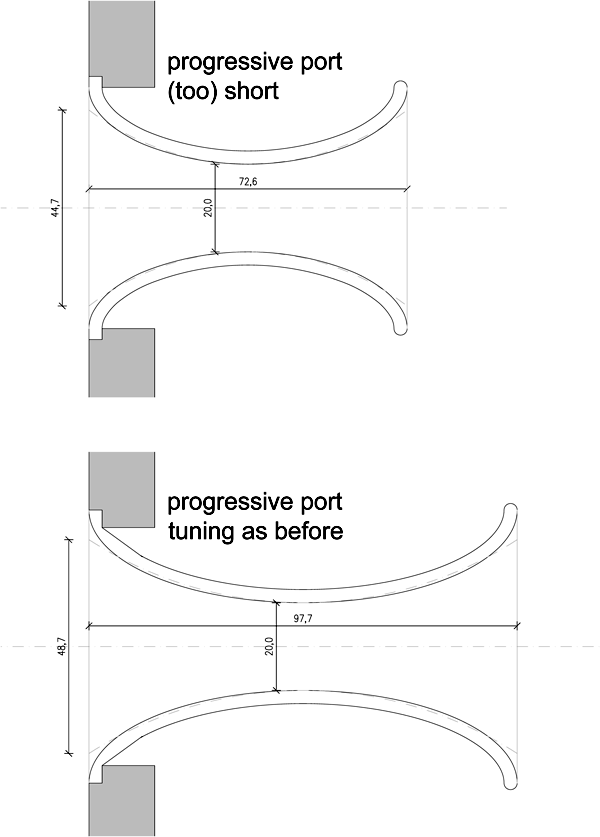

corrected tuning with the "progressive port"
I used the same geometry method as described above, but adapted it's lenght, based on the tuning frequency with the (too) short progressive port:

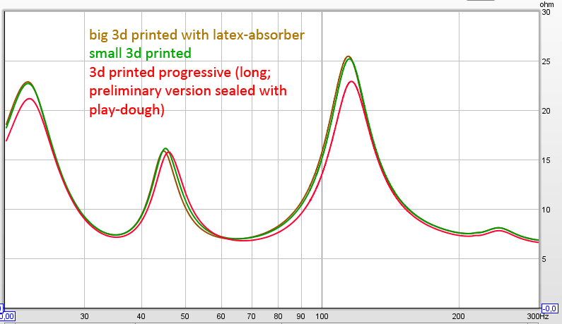

the impedance measurements prove the tuning is correct. however, there are probably still some air leaks due to the preliminary play-dough mounting:
my chuffing measurment image seems to be lost, unfortunately, and I am travelling.
there was some resonant chuffing peak at around 2kHz, but I suppose this may also be due to turbulent air leaks.
I'll provide an update once I am back in my measurement lab, aka: my living room 🙂

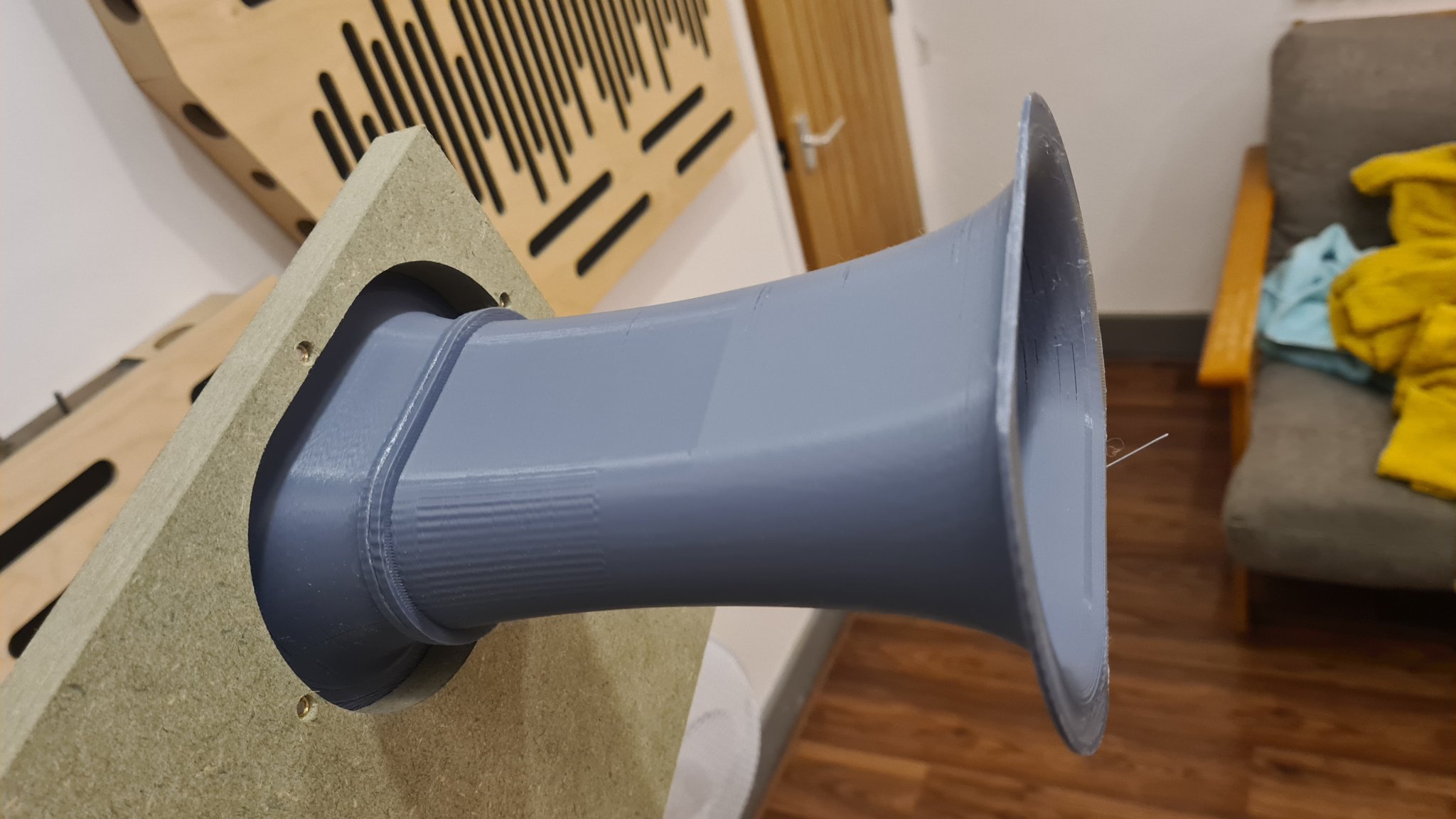

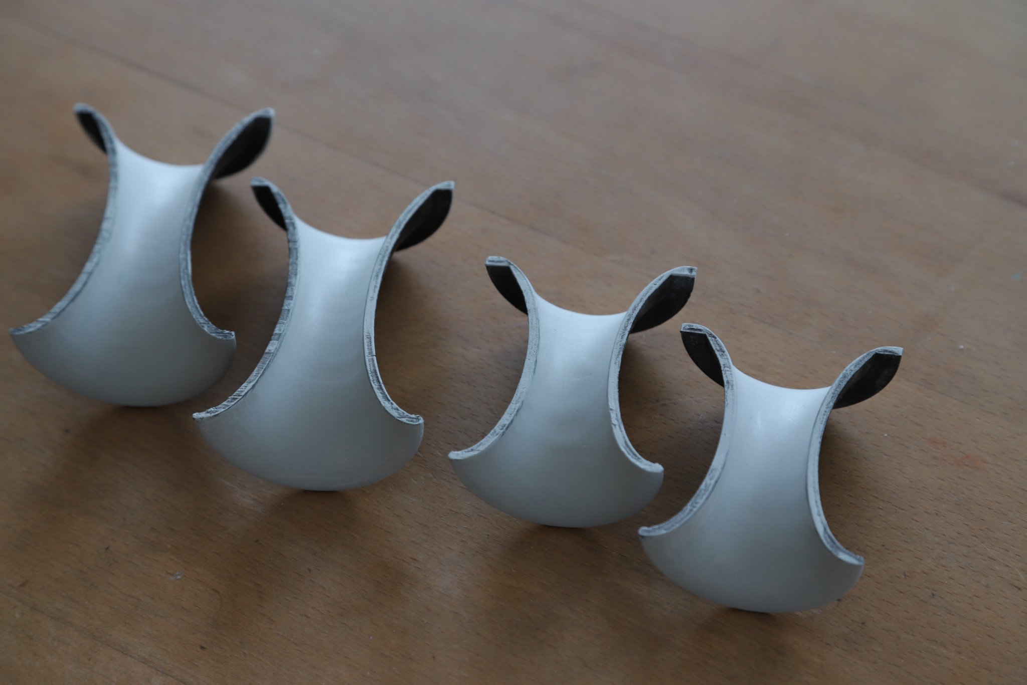

Picture of the corrected and the too short progressive port shells:
long progressive geometry port, glued, sealed, sanded, smoothed:

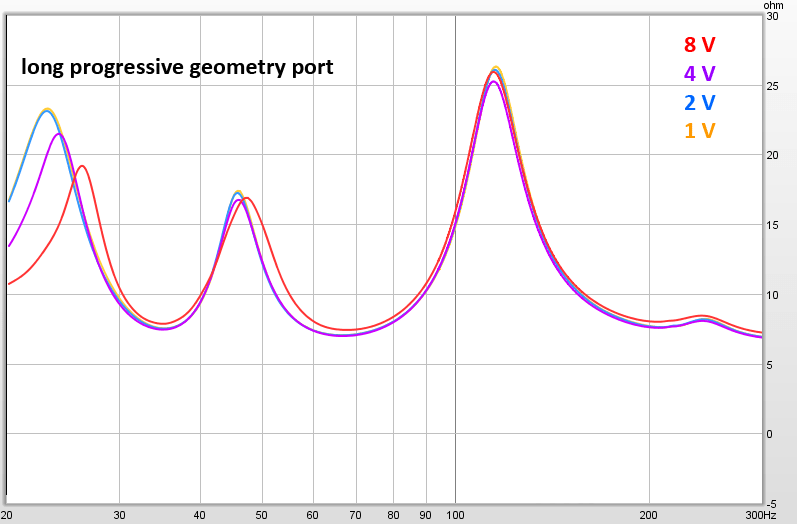

impedance of the port as described above, but now air tight and with smooth surface:

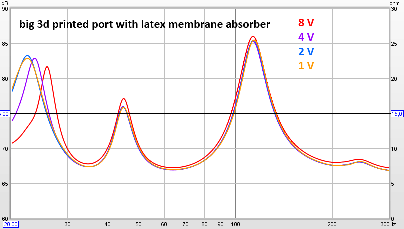

just for comparison, the big 3d-printed port (about double length, see #310):
the smaller port has a slightly higher frequency middle peak at 8 V.
as seen before, the smaller cross section reduces the lower impedance peak (slight flow restriction).
however this could be an advantage as it reduces the unloaded cone excursion below the big chamber tuning!
response and chuffing measurements come next ....

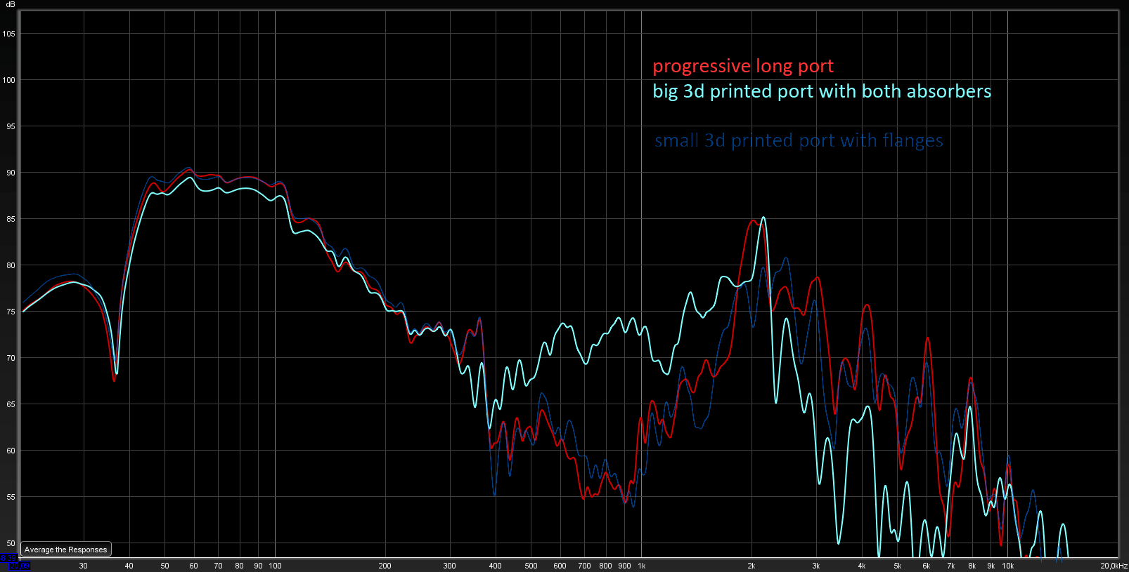

response of correctly tuned (long) progressive geometry port:
for comparison the optimized "dual absorber big 3d printed port" and the "small 3d printed port" are included.
it is clearly visible that the big port transmits much more interior enclosure resonances between 400 and 1800 Hz, because the cross section is much bigger.

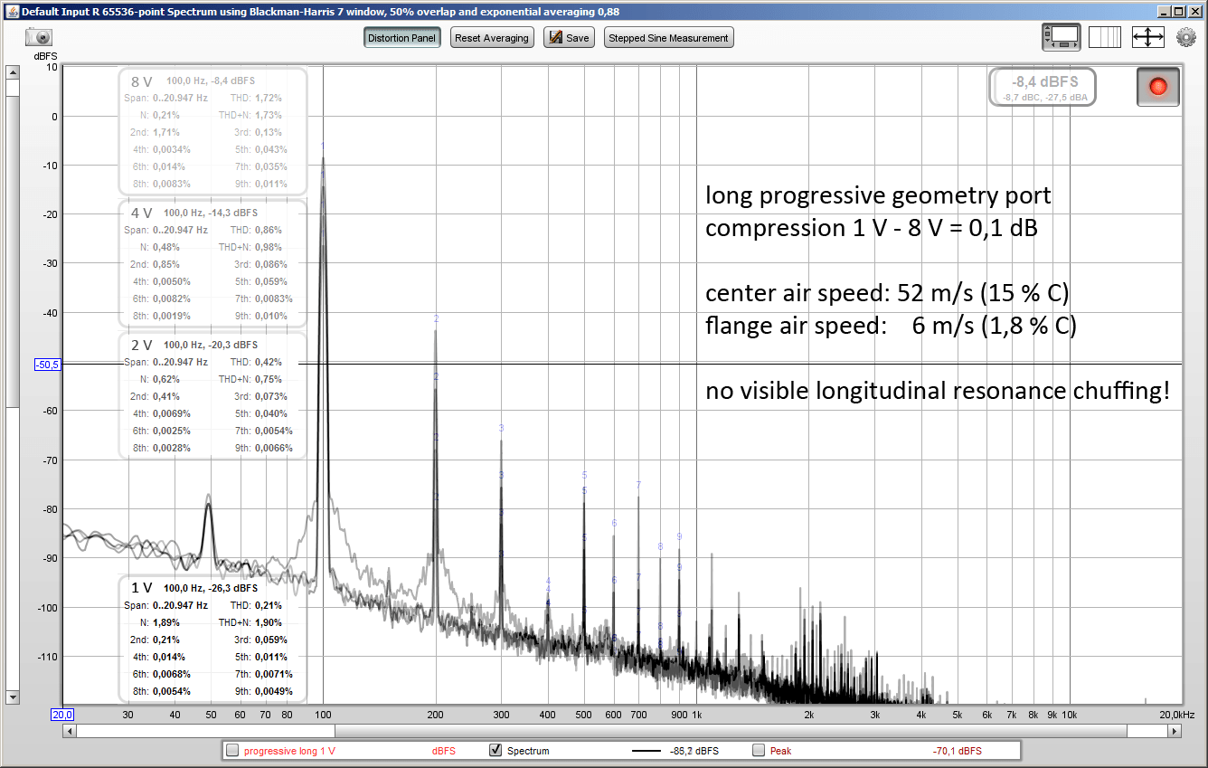

... chuffing measurement:
perfect!
no visible signs of chuffing, besides minimally widened fundamental and 2nd harmonic peaks!
even with 11,3 V signal (not shown here for better comparability) there is just a very small sign of beginning longitudinal resonance chuffing!
this confirms my hypothesis regarding the investigated case (with relatively low SPL) that chuffing is not related to the maximum air speed in the port center but only the critical transformation of pressure to velocity at the port ends. this is where noise and (of course) the longitudinal resonance are created.
it also proves that for home hifi use it will be possible to reduce the port size significantly and by doing so reduce transmission of all interior enclosure resonances and move the port resonances up.

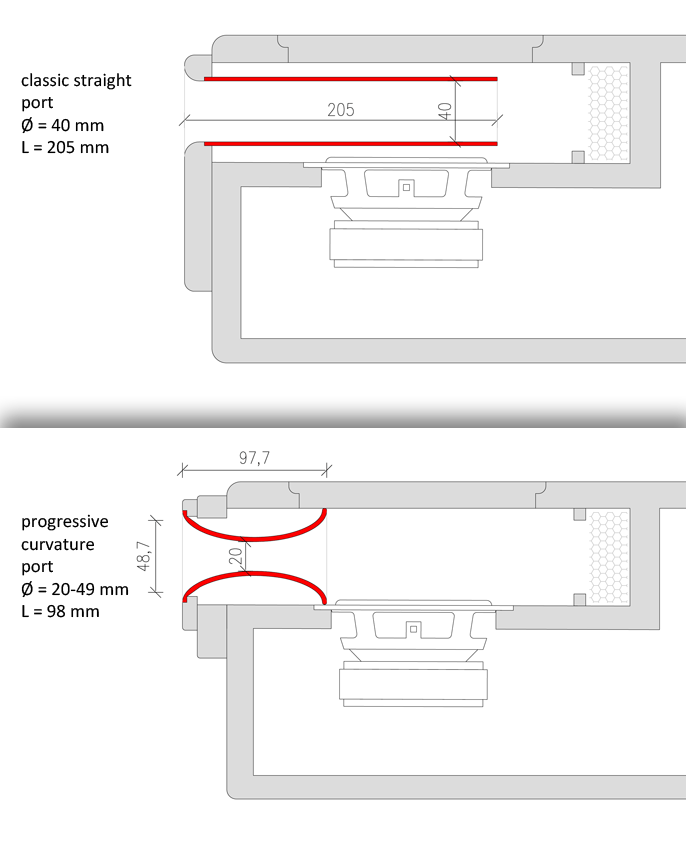

the longer port as shown in post #328 (98 mm lenght, ~5 cm flange diameter, 2 cm center diameter) results in the same tuning as a 4 cm diameter port with 205 mm length - but much improved response, compression, chuffing... everything.

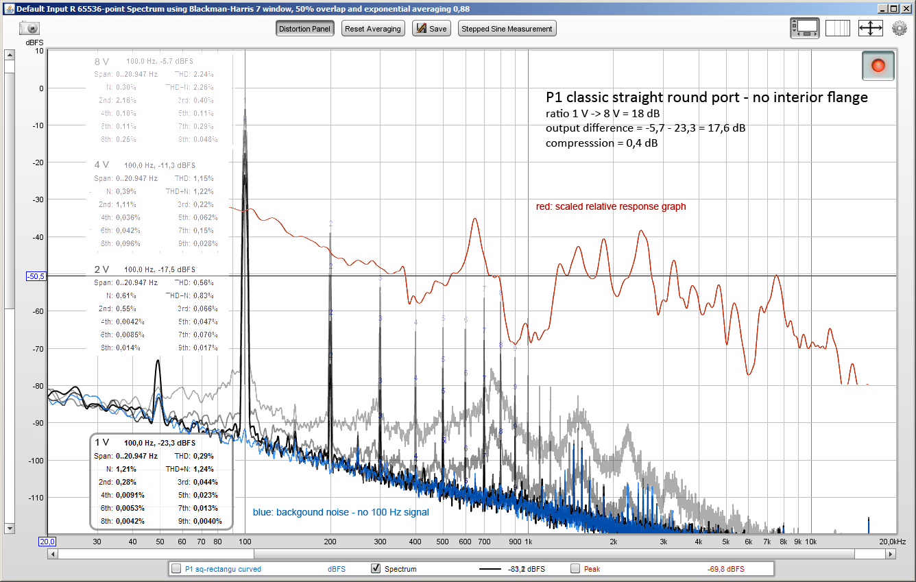

for comparison, here is once more the chuffing measurement of such a 205 mm long straight port:
next step: resonance absorber for the progressive geometry port!

For easy reference and comparison of geometry, would you be able to post a scale outsline drawing of the two ports being compared above?... chuffing measurement:

I'm a little unsure exactly which one is the straight port mentioned.
apologies - I keep inventing names for the ports and it's probably difficult to keep track.I'm a little unsure exactly
I will do a big overview of the most important variants.
in the meantime here are the two ports mentioned in post 133:
