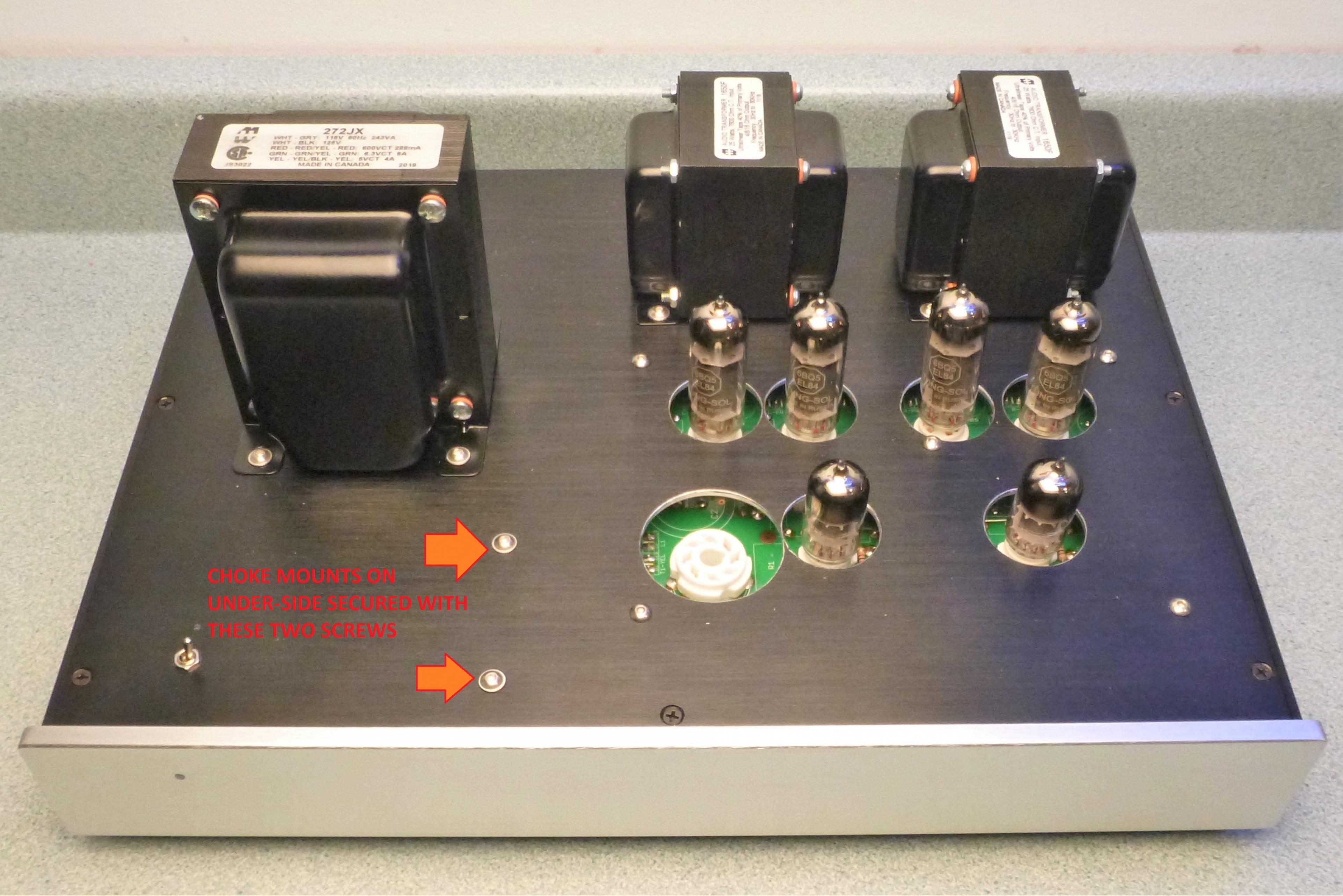

It’s just a drawing at the moment but in theory the leads could be very short, that’s sorta how I started down this rabbit hole to begin with. If it’s helpful I believe I have enough room to run the choke and/or PS cap on the electronics side (this could provide aesthetic advantages as well)
The SPP shown in the link above and the attached picture has tube sockets and higher wattage resistors on the top side of the board, low watt res. and caps on the bottom side. The board is spaced from the top plate with 6-32 x 3/4" long spacers from Mouser. The power trannie voltage was a bit on the high side for EL84s so I mounted the rect. tube off-board and added another cap and the choke before running B+ to the board.
A later version used trannies that don't require large cut-outs and the rect. tube is on the board. (See pic.)
The hum, though not very high, was reduced considerably when the choke was added. More through good luck than good planning this is a very quiet amp, noise-wise.
The SPP looks great, very clean with the choke under the chassis and demonstrates the concept I am going for...talking and seeing other people’s work is inspiring, you’ve got me searching and ordering parts!
You brought up something else of interest, I had considered the possibility of running the rec tube and preamp tube off board (mostly for aesthetics to be honest) but my assumptions were this a has some chance of adding noise and a good chance of adding complication, is that it pretty much the case?
