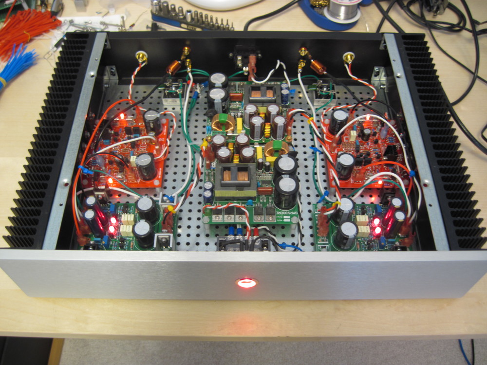

I am really enjoying my Circlotron amplifier. Something about the sound is quite musical and non-fatiguing.
No adjustments were necessary or even possible - this is different than most of my other amplifiers. Bias was about 205ma and DC offset was only 3mV.
Attached is a picture of my build. Configuration is dual-mono in a Modushop 2U chassis. Power is supplied two Connex SMPS300RE +/-36V power supplies that had been sitting on my shelf for about two years due to disappointing results when tested with a class AB amplifier (sound was rather lifeless and flat). Using a capacitance multiplier to cleanup any SMPS noise, add more per-rail capacitance, and improve transient response seems to have made a huge difference. I had planned to eventually replace the SMPS power supplies with a simple linear power supply but may now stay with the current configuration.
The only surprise was quite a loud turn-on pop. This can be easily fixed by adding DC speaker protection with a small power-on delay. Until then, I am using an external speaker selector switch box to temporarily disconnect my speakers.
Thank you for making your PCBs available to the diyaudio community and for your support.

Glad you like the Inverted J-FET Circlophone!
The non-fatiquing character of this amplifier must be attributed to the non- switching output of this configuration.
Your setup looks pretty neat! Enjoy!

After all this time I finally got around to test both J-Fet Circlophone channels.
The addition of the (optional) 5.6 ohm resistor next to the output pin got rid of the oscillation I was experiencing.
Everything works fine now even with faster MJL4302 outputs.
Thanks again.

Good to hear you got rid of the modest oscillations you experienced with the high Ft (10MHz) MLJ-4302. The Zobel is network is not strictly needed and that why it is optional with the MJL21193 with an Ft of 4MHz.
Can you confirm the sound-qualities (SQ) Pronk experienced?
Enjoy your build!

It works great so far but I did not try it at its best yet (still powered from a modest lab power supply).
A classic linear toroid psu 2x42Vdc with 2x20000uf is planned.
