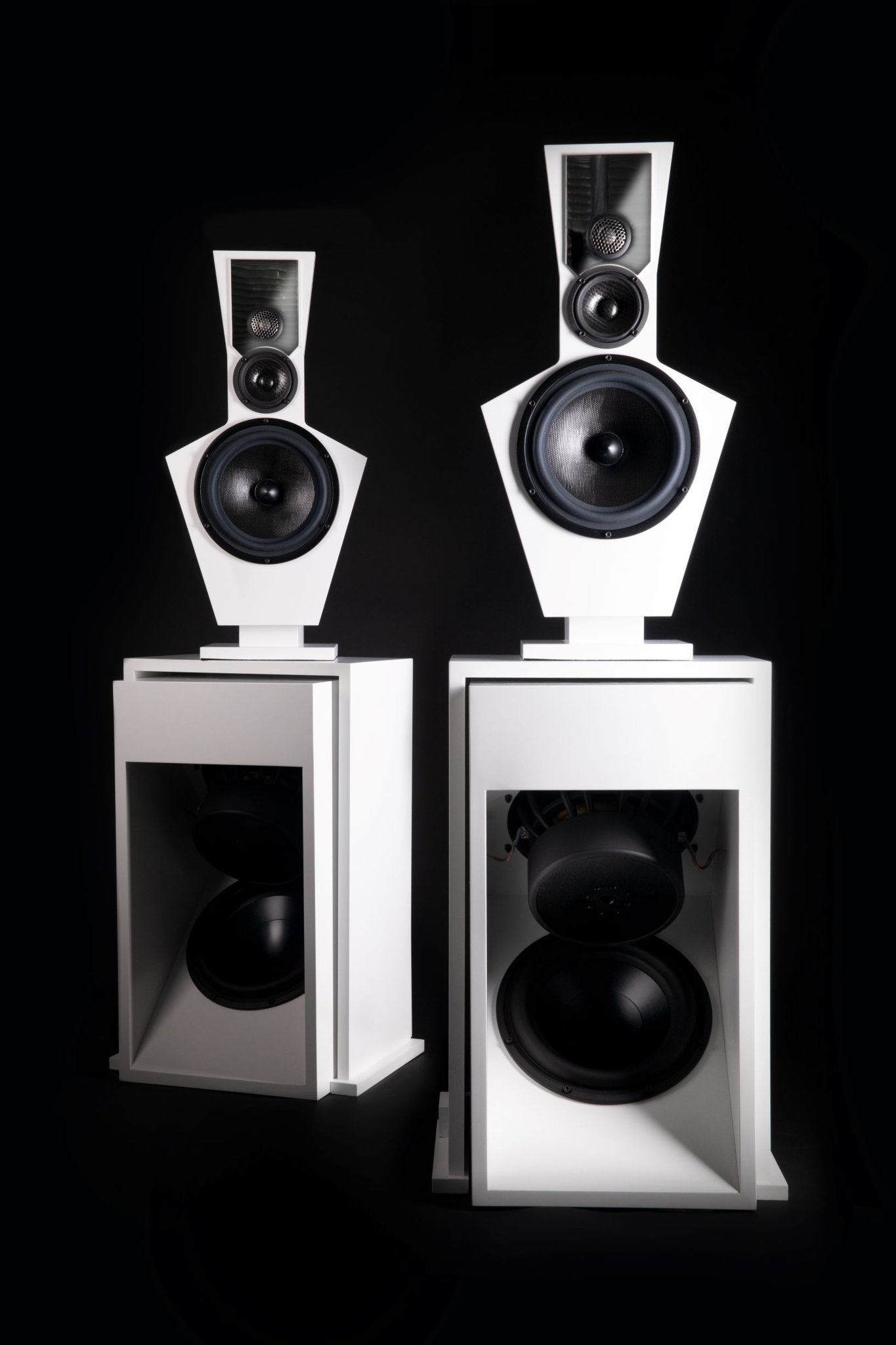

See here: https://wilson-benesch.com/
That’s clever. I kind of like it.

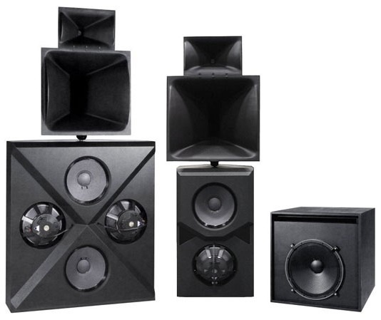

It was done to reduce mechanical/electrical distortion. And to increase power handling /headroom.
These are rather large, Cinema speakers.

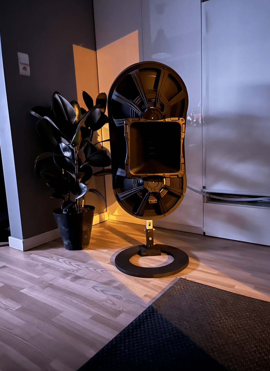

Using 2/4 TAD 1603, and 2 TAD TD-4002/Z one for each horn.
Having the "famous TSC-1118SW covering the bottom end in singles or multiples.
