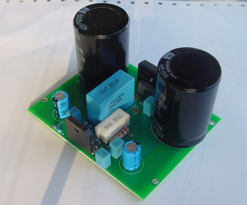

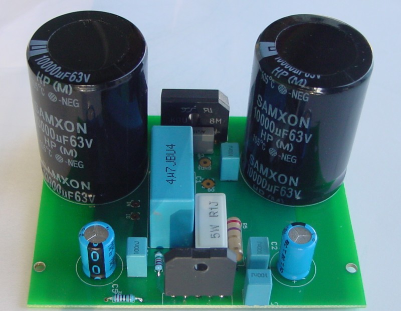

at last i did it
After near six month of inactivity on this front i found the time to send eagle file to olimex to have my pcb professionally done.
The first listening impressions are really positive, i have to try it without the .1 Rout and/or zobel network.
In the attached images the end result.

Olimex uses real silkscreen but many manufactures have stopped using this method. My supplier uses white photorestist which means that you can "print" really small details.anbello said:Thanks a lot Greg and Russ really nice comments for my first work.
As for Olimex i can say good overall quality for the price. The silkscreen is not so good, especially with one of the two boards as you can see.

This is the version i sent to Olimex to obtain what you see in posts 48 and 49. I only added the name of my project and site.
Anyway there are some thing to modify:
- the package of the LM3886 is wrong (in pads positions an drill), i got it on the net i don't remeber where, and i had some problems to fit this component
- the pads diameter for the resistance from the eagle lib rcl.lbr is too small (the drill is ok).
I am working (in the spare time of the spare time of the spare time ...) to get a better layout with better package and then make a kit to offer on my site.
ciao
andrea
