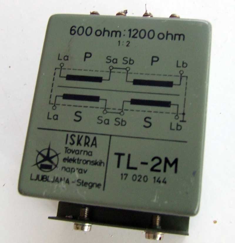

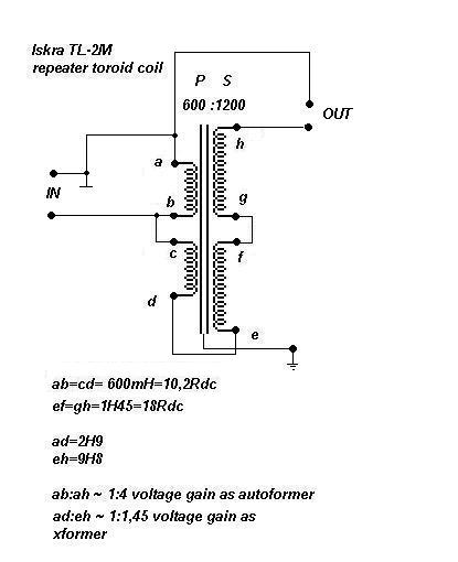

I bought two Lundahls 1674, connected primary and secondary windings to an autoformer and use them with a pair of modified F4.🙂
The sound has not the charm of the Semisouth solutions concerning the voices but in the sum it is a very very good solution!
It is a detailed, yet relaxed sound with much atmosphere.....🙂🙂🙂
I followed Nelson recommendation to try different transformers...😎
This time I tried Jack Ellianos PVA2-N from his Electra Print...
He recommends it as a transformer pre with a 10k pot
Electra-Print.com PVA Passive Audio Pre-Amplifier
I put it the crippled F4 as a gain stage, wired it as an auto former and......
I like it much more than the Lundahl 1674.......😀
and it costs only the half .....! (Lundahls 200.-€/ElectraPrint 120$)😀
So if you want to have a try I recommend you to start with Electra Print!

As I was reading this thread, I could not stop wondering if positioning a trans/autoformer between a stock B1 and a stock F4 would give you a "B1 with gain" (or an "F4 with gain" depending on how you look at it)?
Would this work?
yeah
especially if you use F4 (side) without Jfet buffer
thread is exactly about something like that and it's mentioned already as "crippled F4"
or if you need a higher input impedance put it between the buffer and the output stage.... that should work at least with the bootstrapped F4....

I had a look at the M2 manual and see that the arrangement is B-T-O (B=buffer, T-transformer, O=output stage). I understand that the output of T is enough to drive O.
Still a few questions though (sorry, I have an inquisitive mind).
1.
In the F5 the first stage performs voltage gain as well as impedance conversion (I assume). Not so in the F4. There it only does the latter.
In the F5 the input impedance in 100KOhm. I asume this to be due to the characteristics of the 1st stage. Is that correct?
2.
The B1 performs 3 functions:
- impedance conversion
- volume control
- input selection
Would a simple passive source-selector and passive volume control be better than a B1 as a front-end for an F5 (or any other poweramp with high input impedance)?
I guess the questions is:
is the output of a 25K or 50K pot (or equivalent circuit) too small to drive an F5?
