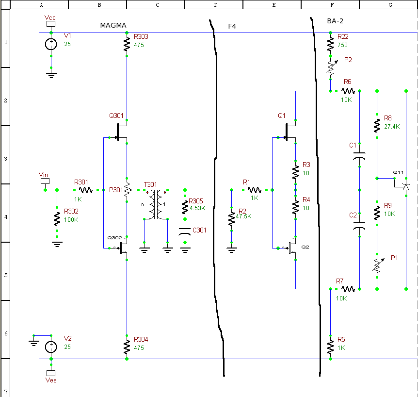

B1 - trans/autoformer - F4?
As I was reading this thread, I could not stop wondering if positioning a trans/autoformer between a stock B1 and a stock F4 would give you a "B1 with gain" (or an "F4 with gain" depending on how you look at it)?
Would this work?
Would this work?

or if you need a higher input impedance put it between the buffer and the output stage.... that should work at least with the bootstrapped F4....

Thanks for the reply Zen Mod.
I had a look at the M2 manual and see that the arrangement is B-T-O (B=buffer, T-transformer, O=output stage). I understand that the output of T is enough to drive O.
Still a few questions though (sorry, I have an inquisitive mind).
1.
In the F5 the first stage performs voltage gain as well as impedance conversion (I assume). Not so in the F4. There it only does the latter.
In the F5 the input impedance in 100KOhm. I asume this to be due to the characteristics of the 1st stage. Is that correct?

I can contribute that the transformer makes voltage gain in M2 but no current gain, current even goes down.... but this seems to be no problem for the following stage.
