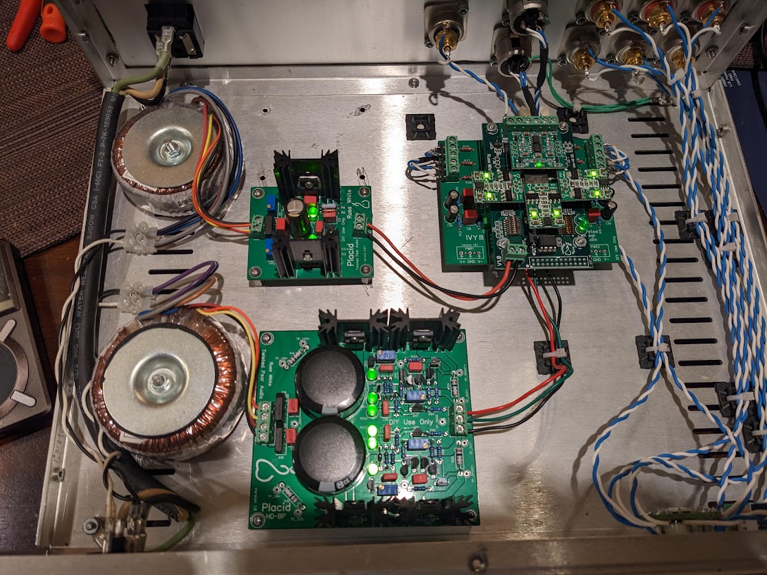

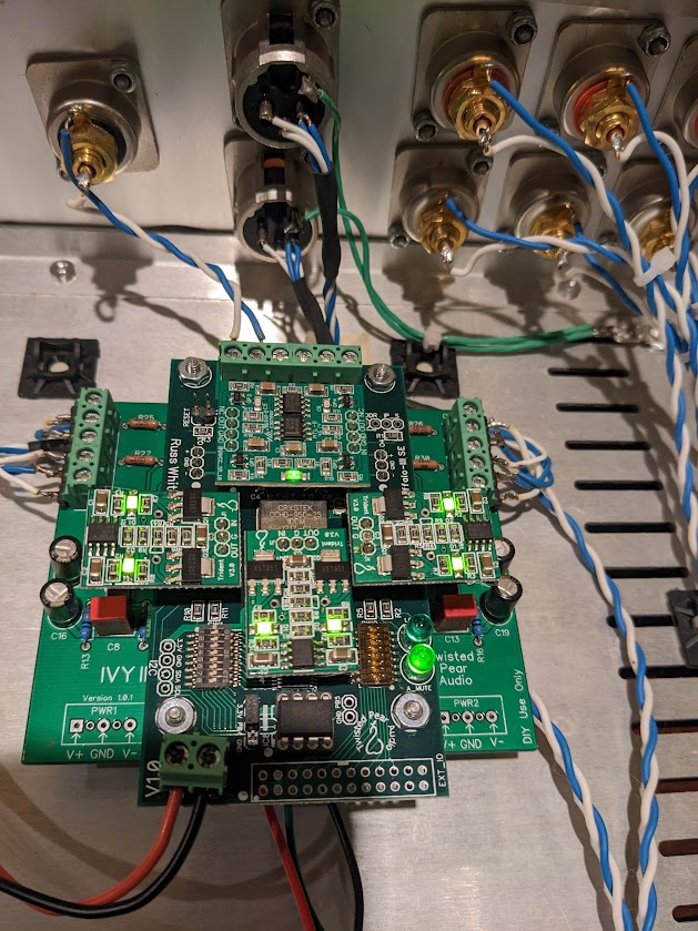

hi everyone, hoping to get some help here on my Buffalo III SE DAC. I'm seeing MUTE light on, LOCK light not off. Using SPDIF input only. I have tried another SPDIF input, as well as SPDIF input using optical to SPDIF converter. No luck.
When this happened initially I opened it up to see one of the regulators LED was out. I forget what little thing I did, might have just been reseating it, or resoldering the out/G/in pins that connect the regulator to DAC (at some point I did both), but got the LED back on. But have unable to get the Buffalo to lock on a signal. Measuring 5.5V on Placid, and 15V on placid HD. IVY III is output board.
Regulators measuring 3.27V on 3.3boards, and 1.17V on 1.2V board.
Any tips on how to troubleshoot this? Considering buying another board w/regulators as a last ditch effort.
Check your current on the Placid, maybe kick it up a little as the reg voltages are all a little low for 5.5 volts At the Placid. the leds indicate a not valid signal but a lock on a clock. unplug the spdif source and observe the lock led go out. The mute should still be lit. The default is for the I2S input to be selected, assume you have jumped the proper pins to select spdif 1 as input. Reconnect the spdif and if playing music the lock led should light and the mute led go out. Make certain you are feeding a spdif stereo signal and not an encoded multichannel. Does a hard power restart change anything?
Thanks for getting back to me on this. I have Version 1.0 Buffalo III SE board. Only SPDIF 1 input is wired. It was all working until at one point it stopped. In as far as jumpers and switches, what i can make sense is that SPDIF auto detect should be enabled, which it is. All switches are set to ON position, which manual says is default and only problematic if using external input selector board (like the SPDIF-4). I have tried to set jump "RESET" connection but no change. Otherwise jumper is between 3.3V and PB4 headers as digital volume control is not used.
I do see your point about mute being on if there is no signal. At this time I cannot get lock to engage in any instance. Have tried two other connections, which were verified working on my OPUS DAC (one spdif from phono cable, other optical to spdif converter).
Did try to increase current to 480mv on the placid, no change. When you say power restart you mean just off-on again? Or like a power flush with switch on and power disconnected? Have tried both, no change.
What I am suspecting is the 1.2V regulator. If someone might be kind to measure the voltage across theirs I would appreciate it as a reference. I am getting 1.18V out of that, wonder if that is damaged and outputting too low voltage.
1.18 V is low but should be fine for normal sample rate material. It would indicate the regulator is probably working. Your meter may not be calibrated as all voltages were indicating low. Check the batteries in the meter. If you have an I2s source you could try that. I would check the wires from the spdif to the board. Perhaps a cold solder joint or hidden break is preventing the signal from reaching the board.
Hmm, ok. I will pickup a replacement 9V battery in the next few days for the voltmeter. I don't have a I2s source currently, but in the process of acquiring a waveio i2s board. I have tried two different spdif connections than the current, no change there. Here are pics of the internals.
