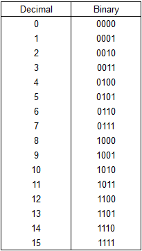

Attached is a binary to decimal conversion table. On the binary side, the zeros and ones are your switch positions, starting with 8 on the left and 5 on the right.But how does it work with all the settings in between?
Does someone has a matrix or logic for that?
if 'OFF' = 1, and 'ON'=0, then b0010 is the rather low bandwidth of d2. One step higher would be (#8->#5) b0011 or on, on, off, offCurrently I’m on the following setting:
5-ON, 6-OFF, 7-ON, 8-ON. Is this one setting higher than the lowest?
If you have DSD noise, perhaps start with the highest bandwidth (d16 or b1111 = all off) to learn if the noise can be diminished by bandwidth. If so, then tweak away... 🙂

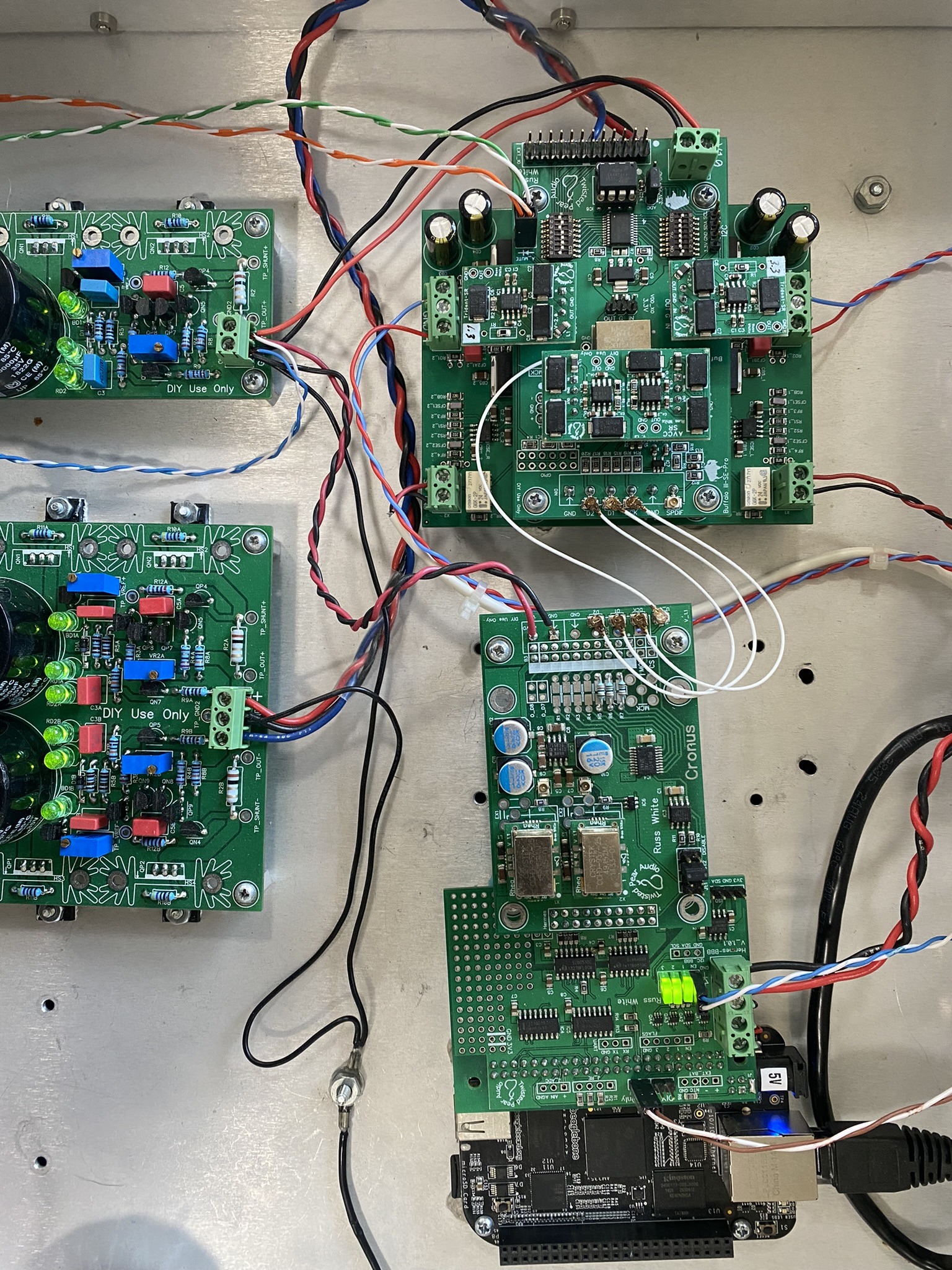

Tried sync mode with my BBB/Hermes/Cronus setup today. Been using async for years and has been working great. Reading back in this forum it seemed to be a simple matter of connecting Cronus master clock output to Buffalo and removing power supply to the Buffalo clock. Didn't work for me at all, just got silence. Changed DPLL to 1111, no luck. Using stock firmware and UFL cables. Am I forgetting something?
Perhaps it is a question of correctly initializing on power-up. Is there a way to be sure the Cronus master clock is started and stable before power goes to the B3, or the initialization reset is performed?Tried sync mode with my BBB/Hermes/Cronus setup today. Been using async for years and has been working great. Reading back in this forum it seemed to be a simple matter of connecting Cronus master clock output to Buffalo and removing power supply to the Buffalo clock. Didn't work for me at all, just got silence. Changed DPLL to 1111, no luck. Using stock firmware and UFL cables. Am I forgetting something?
If you can delay the B3 reset by 2-3 seconds I’d expect success.
Thanks for your suggestion Frank. I disconnected power to the DAC until a few seconds after the Cronus was powered. No dice, same thing.
I give up and go back to async. I will post a pic of my setup. Maybe someone here will notice something not right.
My next suggestion is to check the MCLK output. Got a fast scope?Thanks for your suggestion Frank. I disconnected power to the DAC until a few seconds after the Cronus was powered. No dice, same thing.
Hi,Tried sync mode with my BBB/Hermes/Cronus setup today. Been using async for years and has been working great. Reading back in this forum it seemed to be a simple matter of connecting Cronus master clock output to Buffalo and removing power supply to the Buffalo clock. Didn't work for me at all, just got silence. Changed DPLL to 1111, no luck. Using stock firmware and UFL cables. Am I forgetting something?

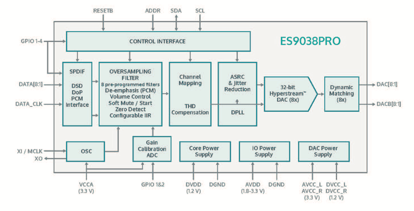

Yes, it is a bit confusing but the ESS Pro data sheets help to better understand the role played by the DPLL. First, look at the the dac's block diagram attached below. The raw data enter from the left side and are subjected to various types of tweaking (like deemphasis, slow/fast FIR filters, etc.). The last preparatory step (from left to right) before rendering the analog stream is the anti-jitter function carried out with help of the DPLL, which is driven by whatever clock the DAC is using. It basically moves early or late frames of data by small increments of time. The B3 onboard clock is 100MHz, which is fast, so those incremental time corrections can be pretty small, but still the data timing is usually just 'very close' rather than 'dead-on'. What if you just change the master clock frequency so that it is an integral multiple of the data sample rate (whether 128, 64, or whatever)? Then the jitter reduction function can more exactly meter the data 'time domain' into the analog converter block. It is actually pretty easy to hear the difference between the onboard vs. external master clocks from Cronus with the DPLL running. So that's what you are doing when you just hook up a Cronus MCLK to the B3 and pull the on board clock trident.
Now, 128_Fs mode (as is used in the true-sync firmware) is controlled by register 10, and 128_Fs mode DOES fully bypass the ASRC. Is this good? If you have very clean incoming data, perhaps so. If you are using jittery Toslink SPDIF out of your video equipment, perhaps that will sound worse with 128_Fs than leaving the jitter eliminator running. I have experimented with 128_Fs and I really don't hear a consistent difference compared to running the DPLL at the narrowest setting. [My PCM is pretty clean so it sounds good at the narrowest DPLL bandwidth regardless of the master clock source.] Therefore I leave the ASRC running from the Cronus clocks, which is also what happens when you use stock B3 firmware. So for my own system, the priority for using "True sync" 128_Fs processing comes into play only near the end of the "system improvement wish-list".
Frank
