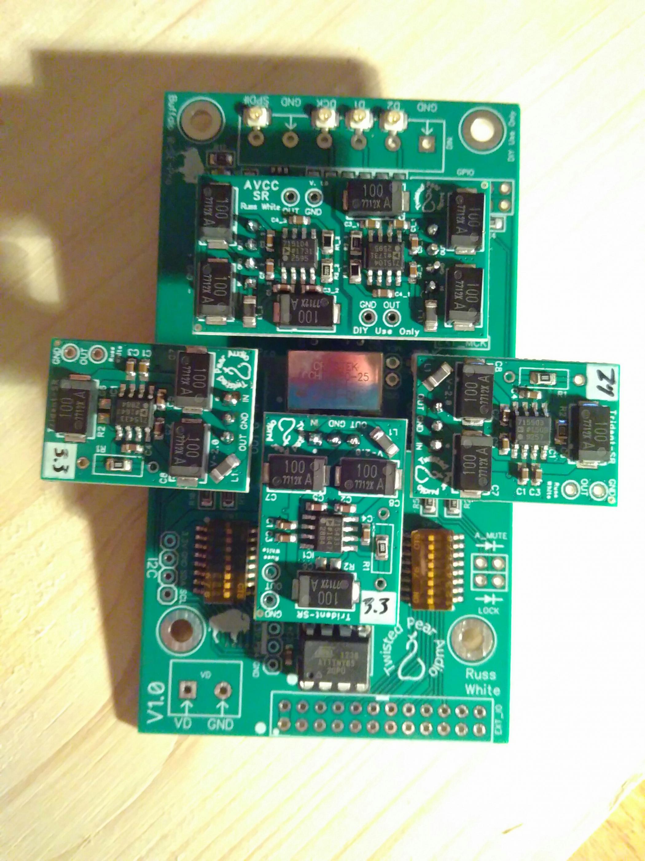

I am done assembling the Buffalo 9038 with Mercury but I think I may have an issue with the Buffalo board.
I cannot get a lock from the Amanero but the real issue is that DVCC is reading 0.5V on the Trident.
The input to Buffalo is 5.1V, and all other readings look good:
AVCC 3.6V, VDD 1.3V, VDD_XO 3.3V.
I swapped the 3.3V tridents and the readings are the same, so it seems that both tridents are working properly.
The input pins of DVCC read 5.1V.
I initially had soldering issues with the VDD pins and thought I may have damaged the board (one pad was partially lifted), but ultimately the reading there looks correct.
I also used an ESD bracelet when interacting with the board although not sure on their effectiveness.
Any idea's besides a damaged board?

It sounds like there is damage to the vias for the Trident from the desoldering. It's a four-layer board, so that damage is likely internal.
Can you see if either of the non-GND pads for that Trident are shorted to GND?
DVCC: (the problematic one)
IN-GND 300Kohm
OUT-GND 0.8ohm
VDD_XO:
IN-GND 250Kohm
OUT-GND 11Kohm
VDD: (desoldering of header was here)
IN-GND 450Kohm
OUT-GND 33ohm

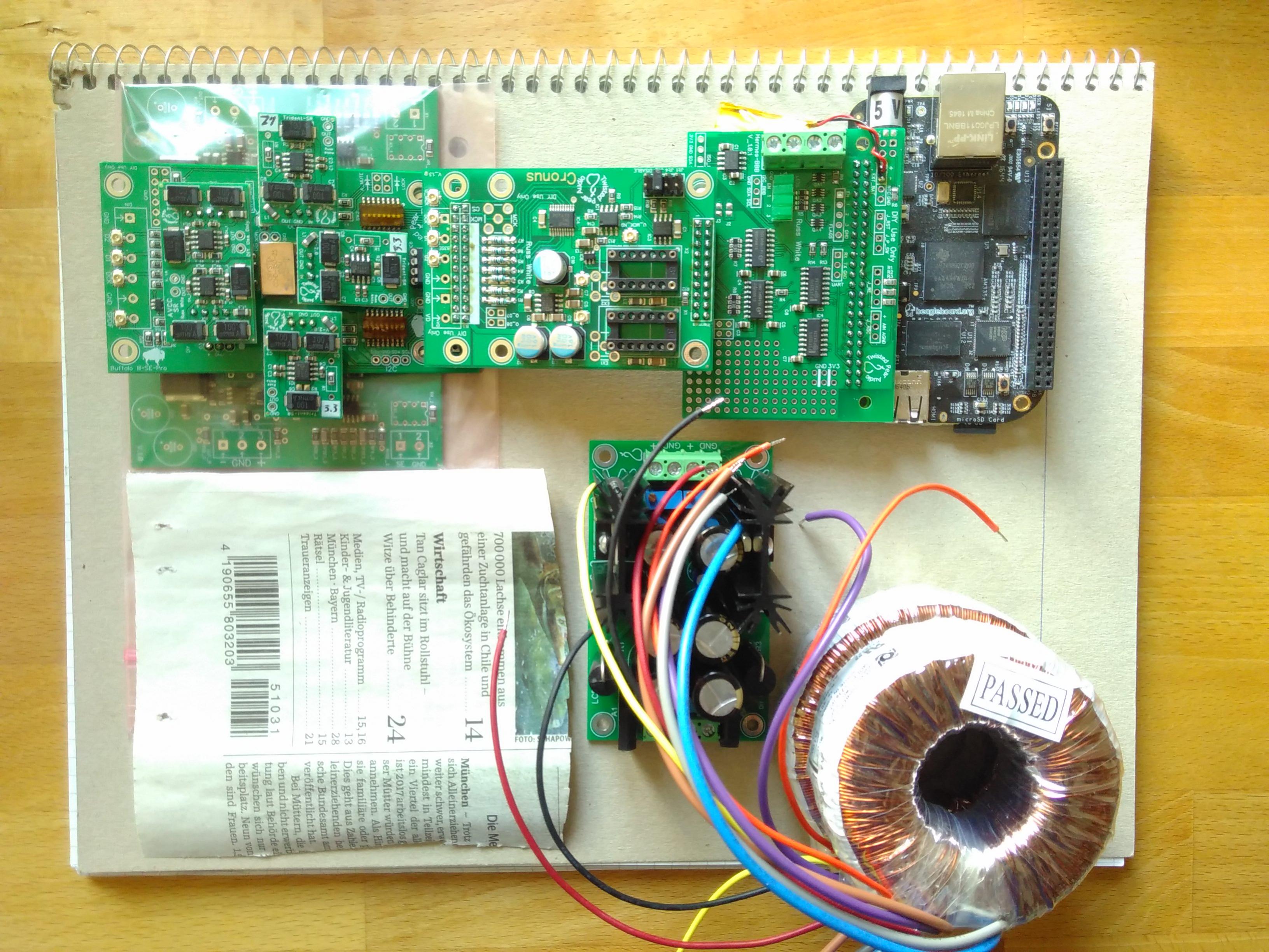

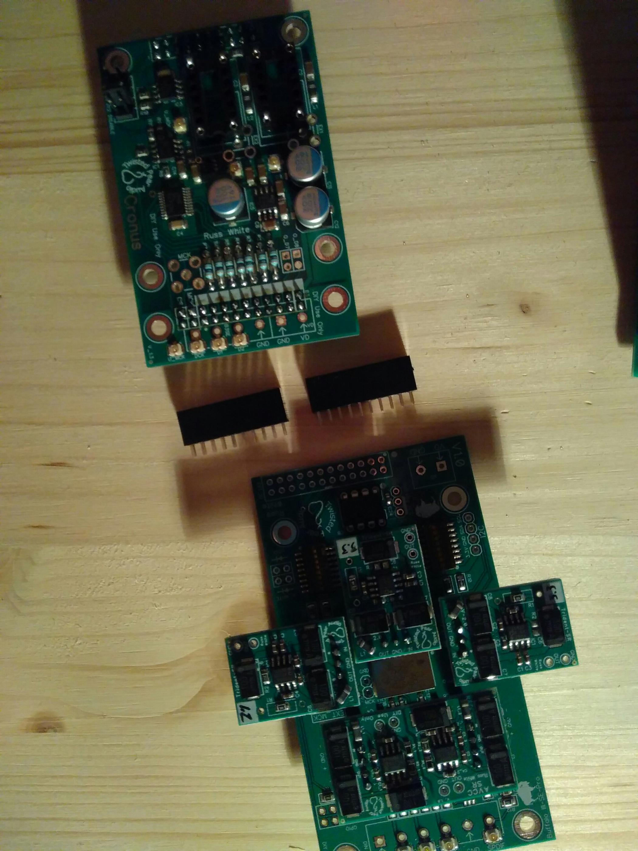

I finally started to build my Buffalo-IIIsePro38 and a couple of questions popped up (probably not the last ;)):
1. Related to the connection between Cronus and the Buffalo board. There are 2x12 connection pins, but I only got two 2x10 female connector. I will just cut one apart to build my own additional 2x2. Its correct to connect all 2x12 pins, right?
2. Are the two 3,3V regulators identical? So, the connectors DCVV and VDD_XO are interchangable?
3. Is there anything else except the male header to connect to the regulators? There are additional contacts and I saw soem pictures with LEDs.
4. Are the connectors LOCK and A_MUTE on the Buffalo board intended for the two LEDs? Can I use them to show that the Buffalo is powered on at the case? Or which one am I supposed to use for that purpose?
5. Is it a common choice to use the volume poti at the Buffalo? I think controlling the volume via software and at my amp will suffice or am I missing something?
Thank you!

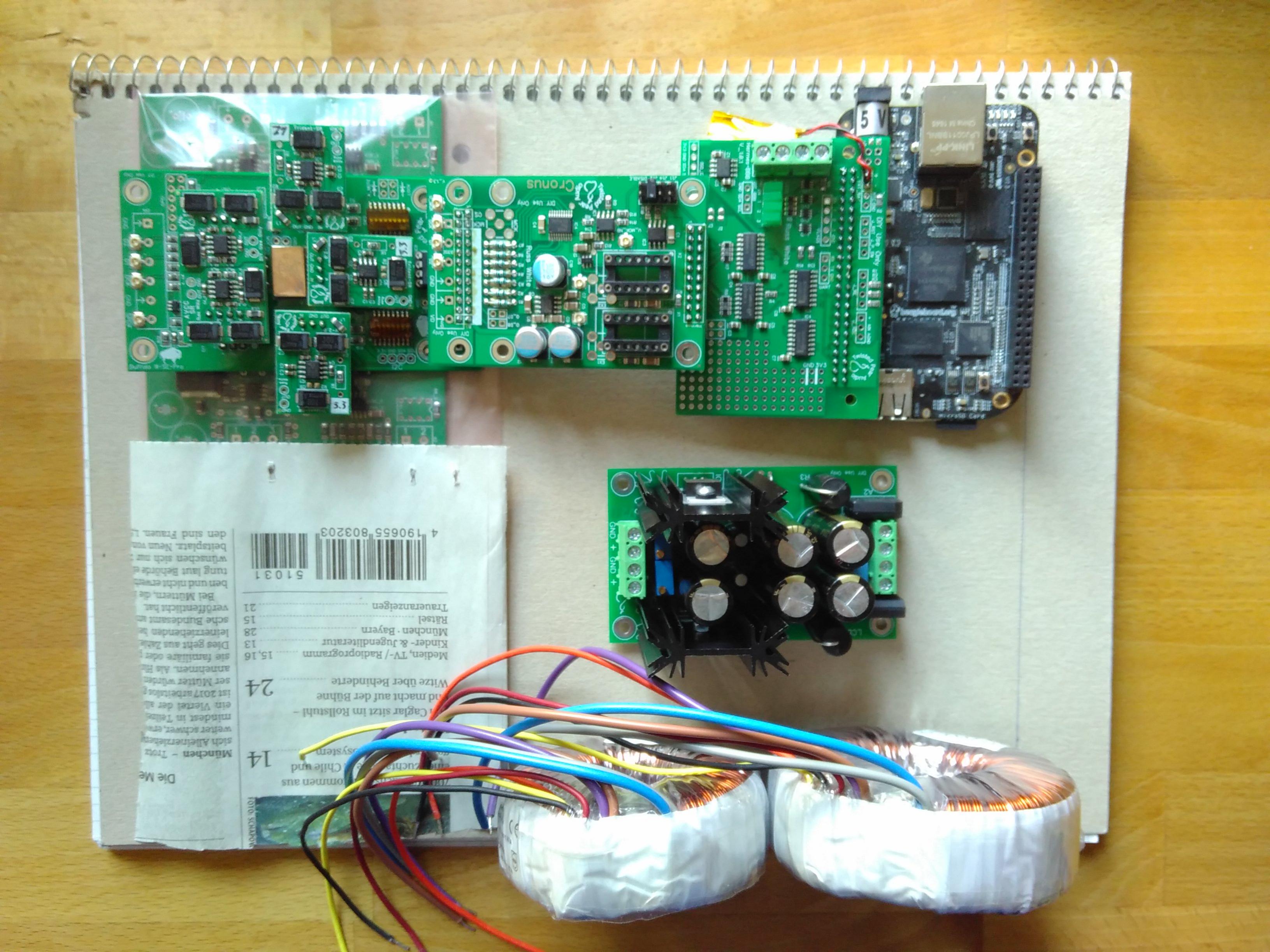

I already got a case matching my other equipment. I thought it will be plenty of space. I was obviously mistaken :).
The line on the cardboard marks the front border of the case. The piece of newspaper is the missing Placid HD BP Power Supply. And there still needs to get an SSD in there for storing my music. I want to put it below the beagle board. What do you think about these two setups? Is it a problem to stack the transformers?
