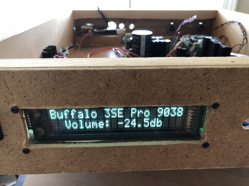

New firmware for basic LCD display.
For anyone interested here is firmware that handles both "pure-sync" (128-fs) mode and shows you a display of the current volume.
Also note that this firmware allows for clock gearing if you like (normal or div2) - this is handy when you want to consume less power and you don't plan on running 384khz etc. Another thing for people to tweak as they desire. 🙂
The display I am using in the pic is a VFD display with a 4-bit compatible LCD interface.

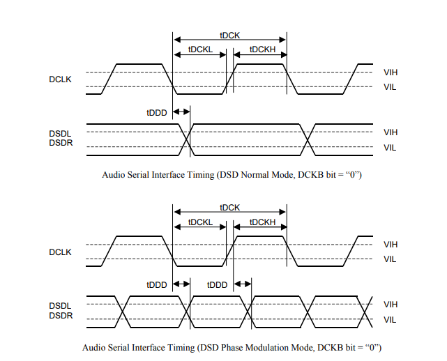

DSD normal vs phase modulation.
Here is a good illustration of phase modulation vs normal modulation in DSD.
From Cronus as very high rates it is much better to stick with normal modulation. Phase modulation works - but timing can be tricky and finicky at high rates. It also has zero SQ benefits over normal modulation.
