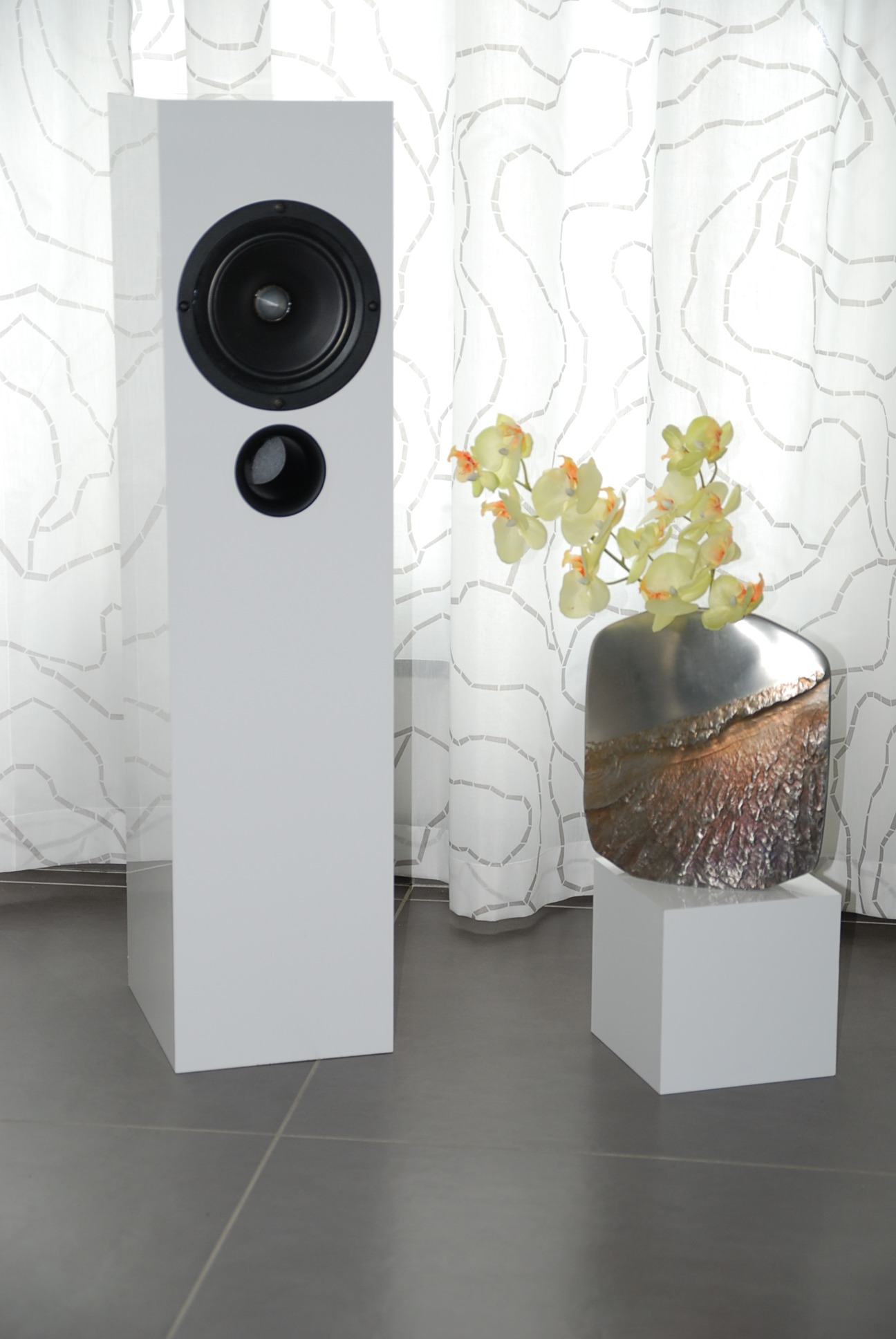

I have organised a SpeakerCamp to complement Nelson's AmpCamp. 40 pairs and everybody was enthousiastic.
Just saying ;-)
Jan
