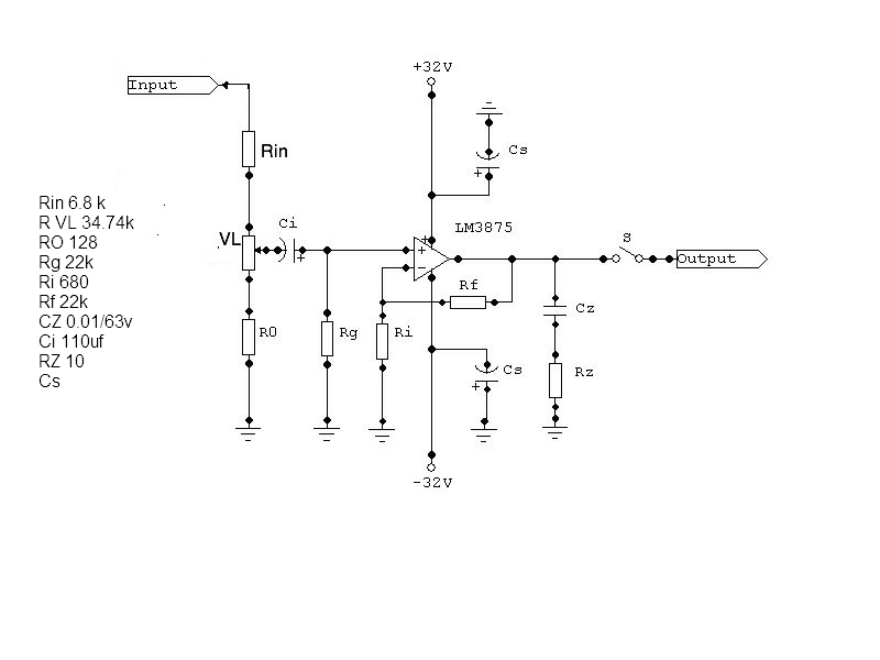

size & application with basic calculation for the crossover-frequencies + the datasheet. in other words: statistics.
i'll try to get a LC-meter to confirm my suspicion. but it all fits together.

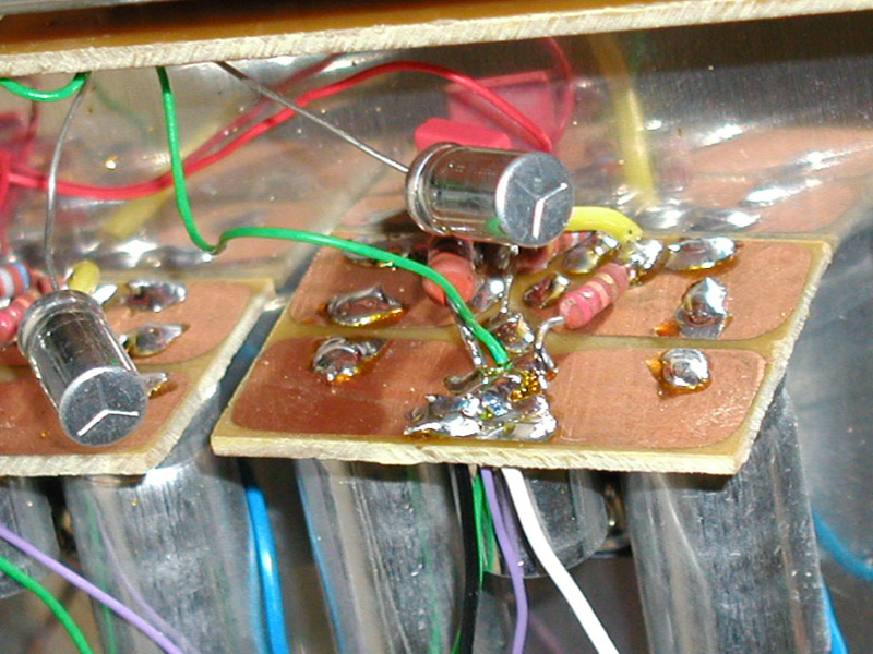

and the bipolar/polar thing: there are blue markings in the correct orientation (when polar) to denote the negative of the capacitor, but no markings on the 2u2 input capacitor. so the guys that removed the sleeves still needed some markings further down the production line 😛
Would you still be able to get an LC meter and confirm these values? I'm dying to find out these capacitor values.

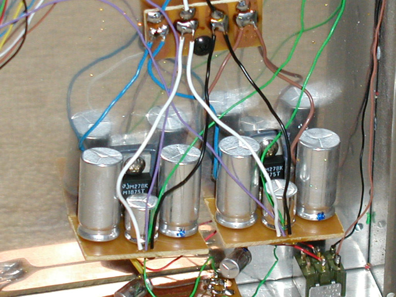

My estimation (by size and experience) is: 1000yF for the supply caps, 47yF for the FB caps and 10yF for the input cap. The supply caps of both channels are practically parallel counting up to twice the capacity, but sit individually near the ICs.

For the supply rail caps, 1000uf is what stated by 47 labs, judging by their sizes in picture, it should be correct. the feedback and input cap however, is what i'm trying to figure out . based on my calculations, 2.2uf(1/(fc=1/(2*pi*22000*0.0000022)=3.29hz) for Ci and 47uf(fc=1/(2*pi*680*0.000047)=4.98hz) for Cf makes most sense for me. although i read somewhere on the forums saying that the feedback fc should be always lower than input fc. whats your opinion on this?
It seems to be a common practice, if you use an elcap for the input the capacity should be about 10 bigger than the actual result of the calculation of the corner frequency, instead of using a foil one, where you use that value straight. I have found an explanation for this, but do not recall it at the moment.
So about 10yF seems to me about right - I use that and many others.
The feedback cap should be lower to "shift" the operating point to a "safer" area - sorry to try to explain it so un-scientifically. The detrimental effects soundwise from the feedback loop is far worse than that of the input "filter". I have tried that experimentally. So about 47yF could be right, maybe even more, about 100yF and low voltage. Low voltage caps seems to sound better here - I have tried that with certain types, but not throughly perhaps.

I am not trying to hold anybody back from trying small power supply capacitors but what will happen is this:
When you crank up the volume the capacitors are responsible for delivering (a part of) the current to the amp, if the capacitors are to small (they can't deliver the peak current) the voltage will drop, ultimately causing distortion of the output signal. Now this can sound o.k. if you like distorted sound but as an engineer I would rather design my power supply to match the amp..

you can't avoid the drop in voltage. If the capacitor provides power, its voltage will drop. Q=C V => I=C dV.
if the C is very big, the dV will be small and that is what we are trying to achieve. The capacitors are there to provide current for as long as the AC power supply's voltage is below what is requested from the amplifier

Yeah I was curious about that 110uF too - seems a bit excessive?! Not sure how they arrived at that value (caps are all skinned) unless they actually measured the cap out of circuit?

The brand of capacitors. They are also unmarked, so they use bipolars also for supply??
