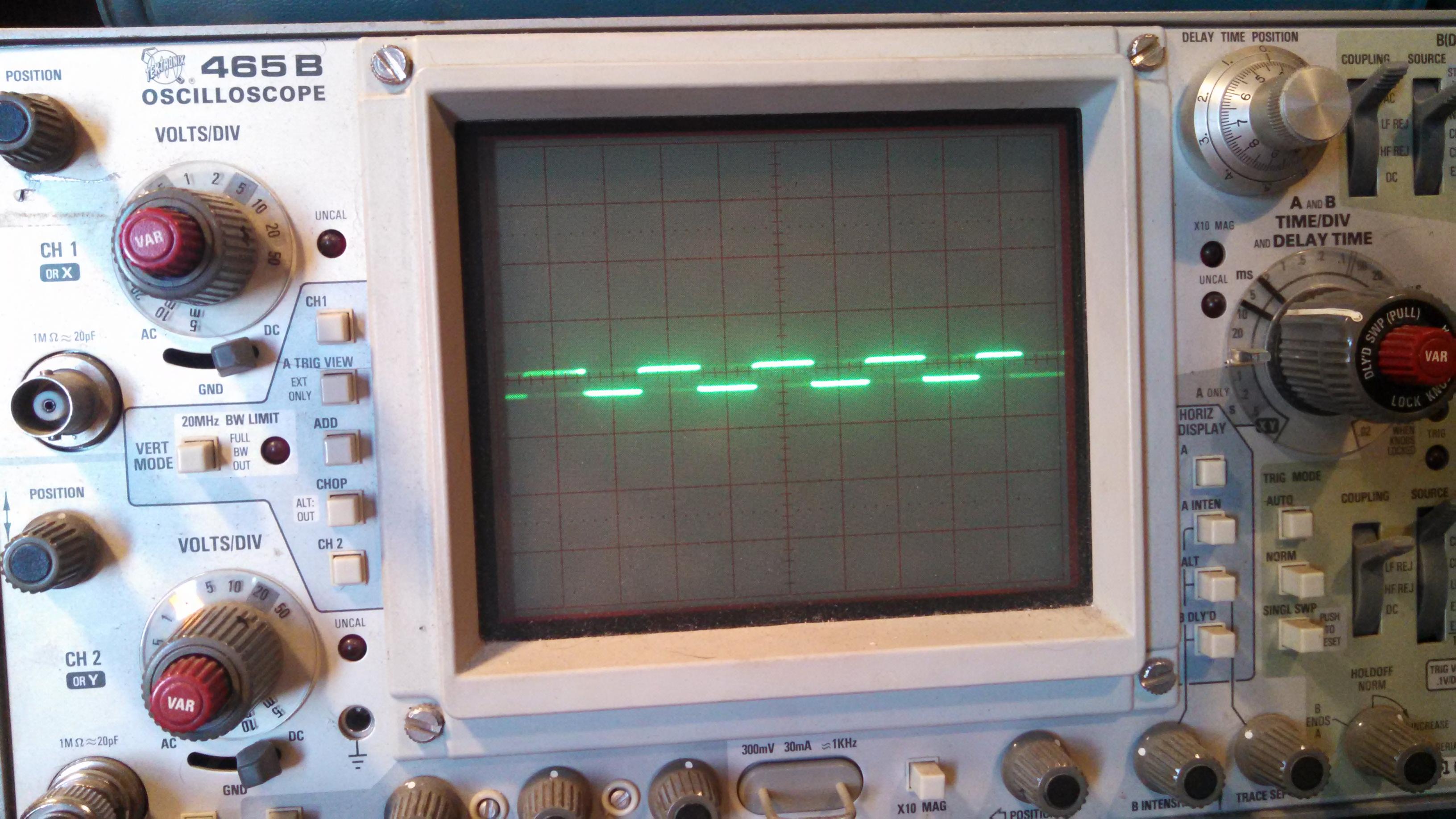

Everything seems well on modulator board.Replaced both ic's and transistors.It will produce a squarewave with input signal(audio board removed).
With audio driver board installed it produces a very blurry squarewave to outputs and draws tons of current.

With input signal.The modular board output is perfect squarewave although, the 100hz signal into modular has severe crossover distortion.Not sure that matters at the moment.Because when I turn the amp on with no input signal it draws excessive current.

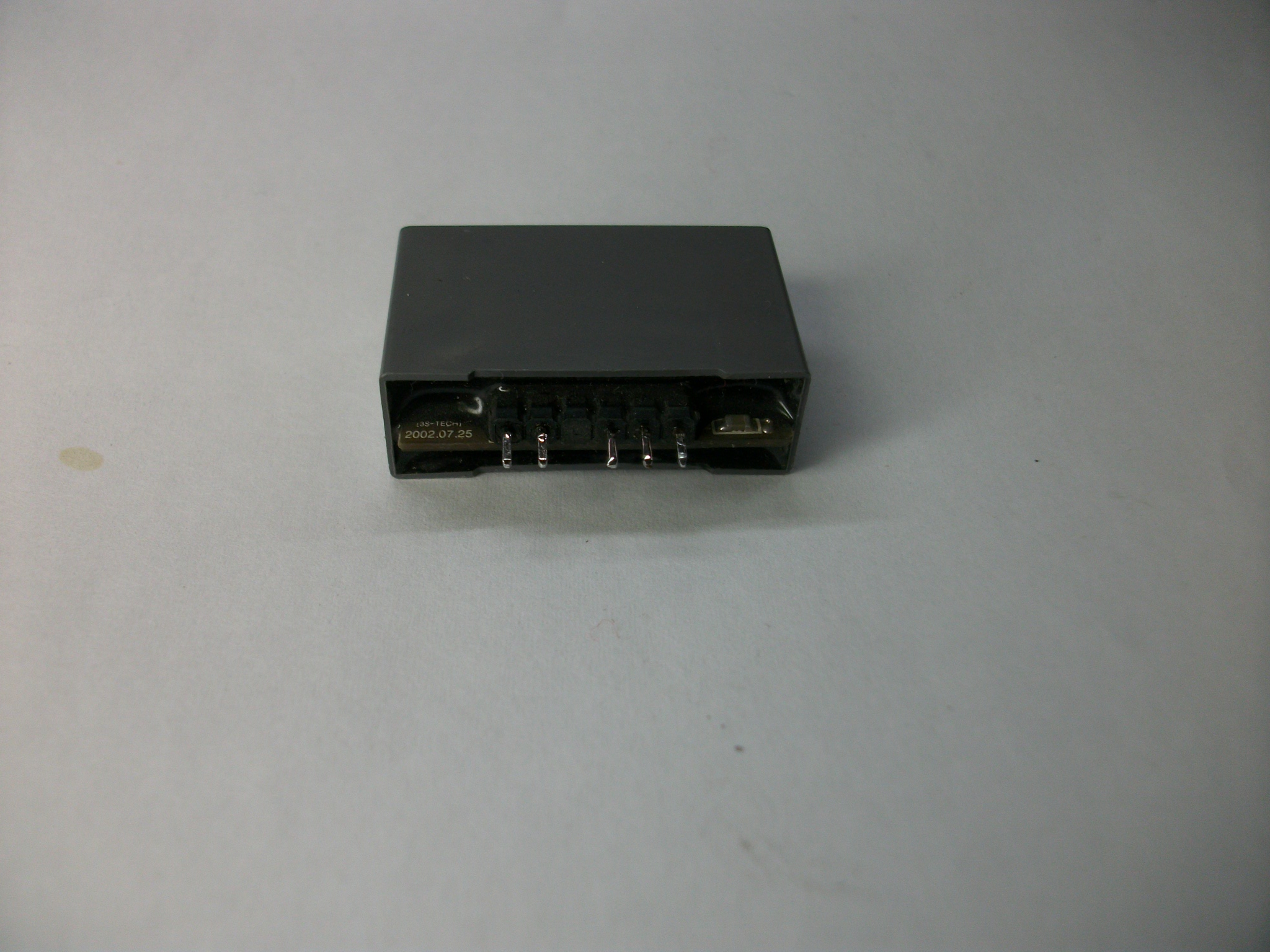

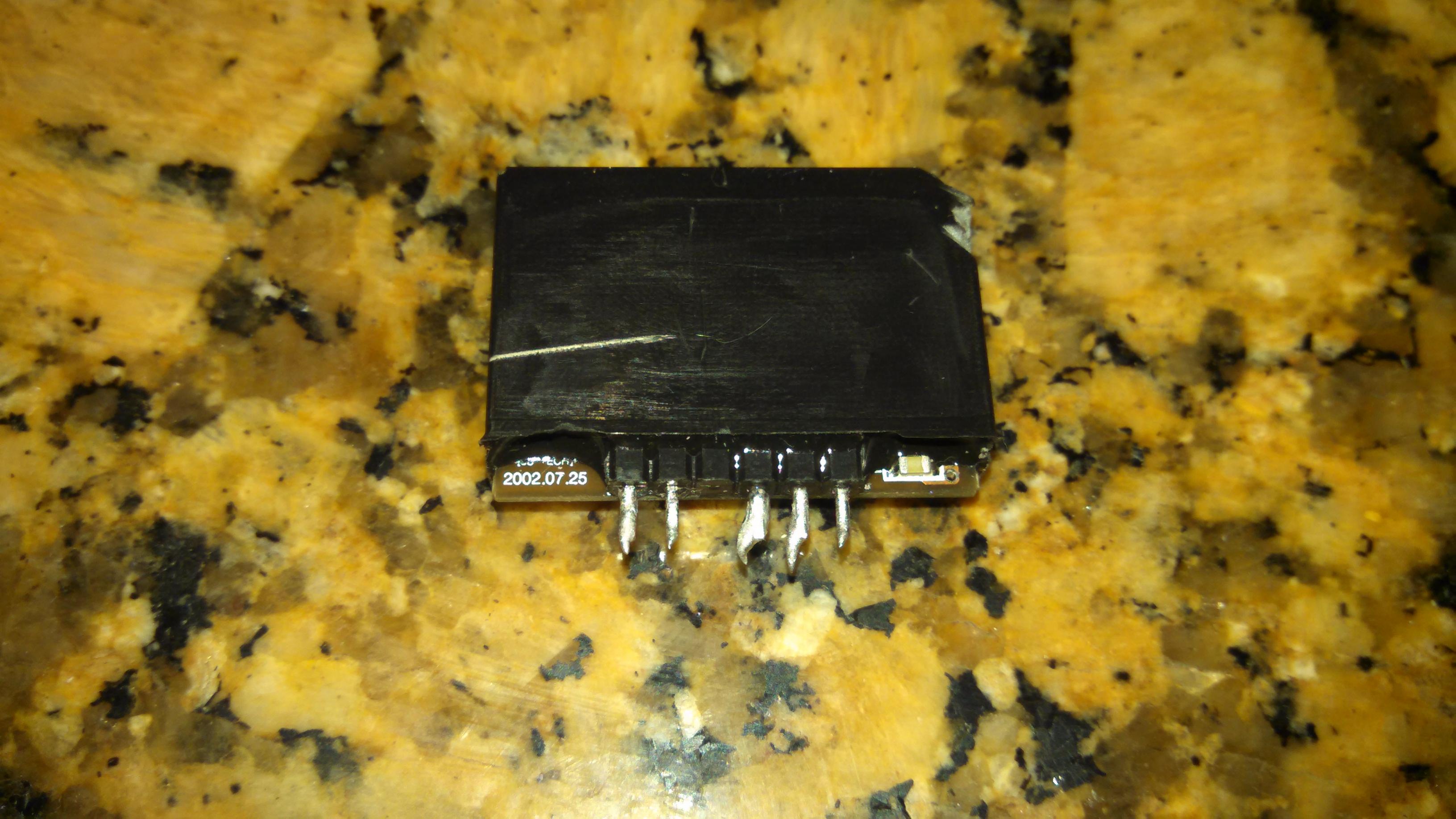

Hello Sirs,
I'm new to this forum, I searching for this amplifier repair and I came to this
My problem with the same amp is that small board that's inside the epoxy box, I tryed to remove the epoxy and retain the small pcb intact but I couldn't retain the small ics. Does anyone knows the numbers of the U1 and U2? Are theese Tl072 and Lm211? and whick one is for u1 and whick for u2. Any hepl would be appriciated
Greeting from Greece
Here is the picture of the pcb without the epoxy.
U1 is on the right U2 in on the left
It write's on it woofer module v30 3s tech.
