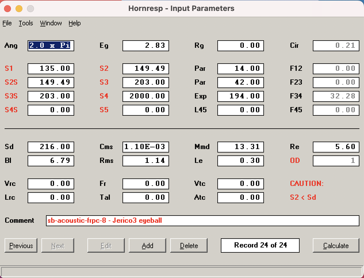

Some kind of 6th order corner loaded horn. I learned after studying theory of combined reflex chambers. Who knows what the frequency curve looked like
Does it look something thing like this, ignoring the absorber chamber for the moment and assuming an exponential expansion from the throat area? The coupling chamber seems large at about 9.5L though. For the driver I just used a sb acoustics full range that is reasonably priced here.

I used the wizard and set is a tapped horn with the driver between section 1 and 2.
It sounds like you may have used the Input Wizard to create the initial tapped horn record...

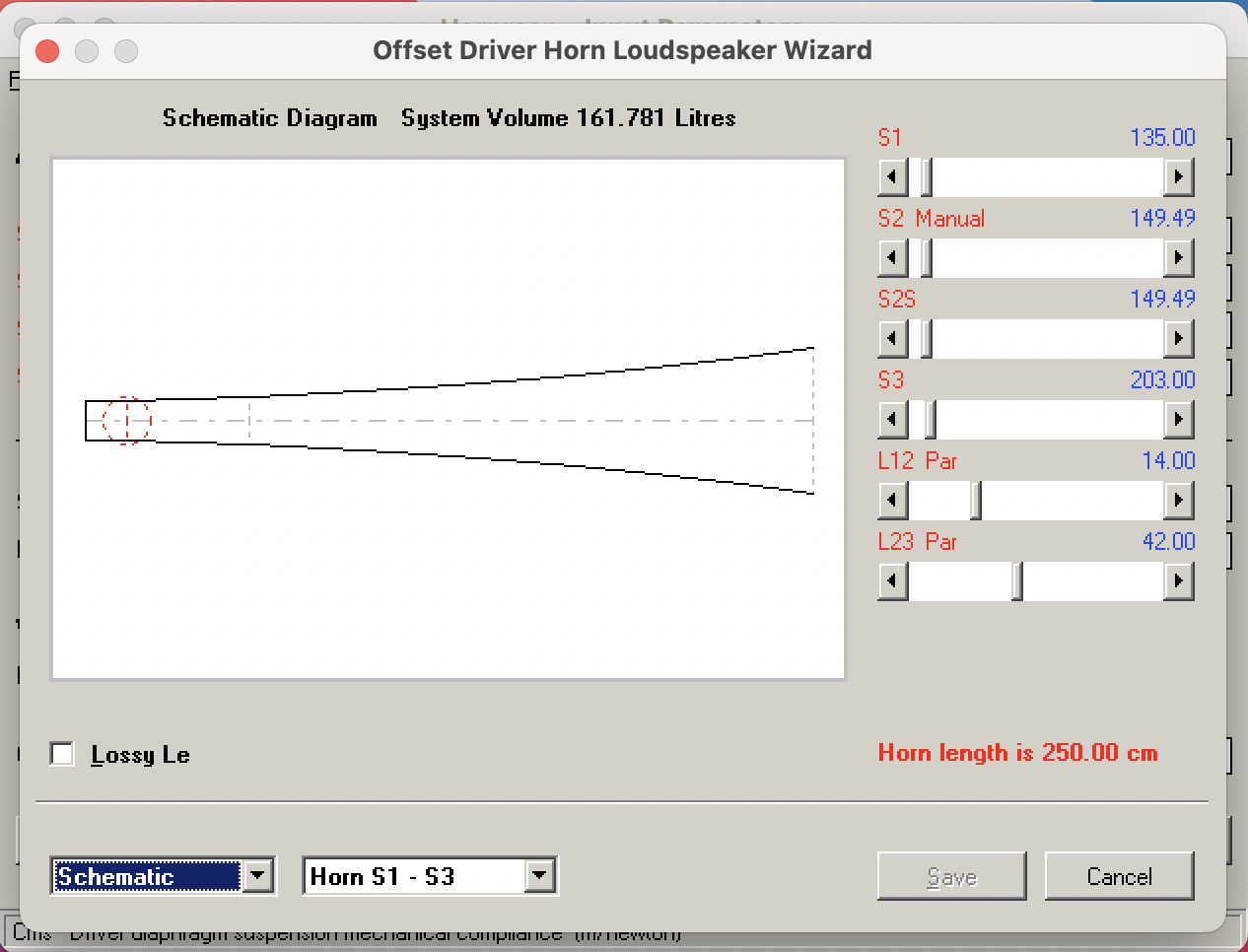

I wanted to slide the driver 14 cm into the horn but I can not get the sliders up.
To do that you would need to use the Loudspeaker Wizard, not the Input Wizard.

Starting from the startpage not using a wizard and ended up with a frontloaded horn and a back chamber. It looks pretty good
I have the drawings but many with measurements are not marked. Angles and lenth of inner baffles are shown. I will draw it in full scale and then measure it. I will then divide the 5 sections of the horn into 4. I also have to change the layout a bit to accomodate a 16 cm diameter magnet.
So I should make an "offset driver horn" in the wizard, add a chamber and then I am all set to simulate?

Using the hypex approximation, and changing from exponential to parabolic, increases the volume substantially, by about 30 litres. If it were possible to put accurate dimensions for the segments making up the 194cm L23, the difference might be reduced using all the 4 allowable sections. Even so, it is a fairly large box and not sure whether the resulting response will be worth the woodwork compared to a tapered TL or bass reflex. It would be great to hear from those that have one in their listening room 🙂Parallel sides with board dividers = parabolic.
