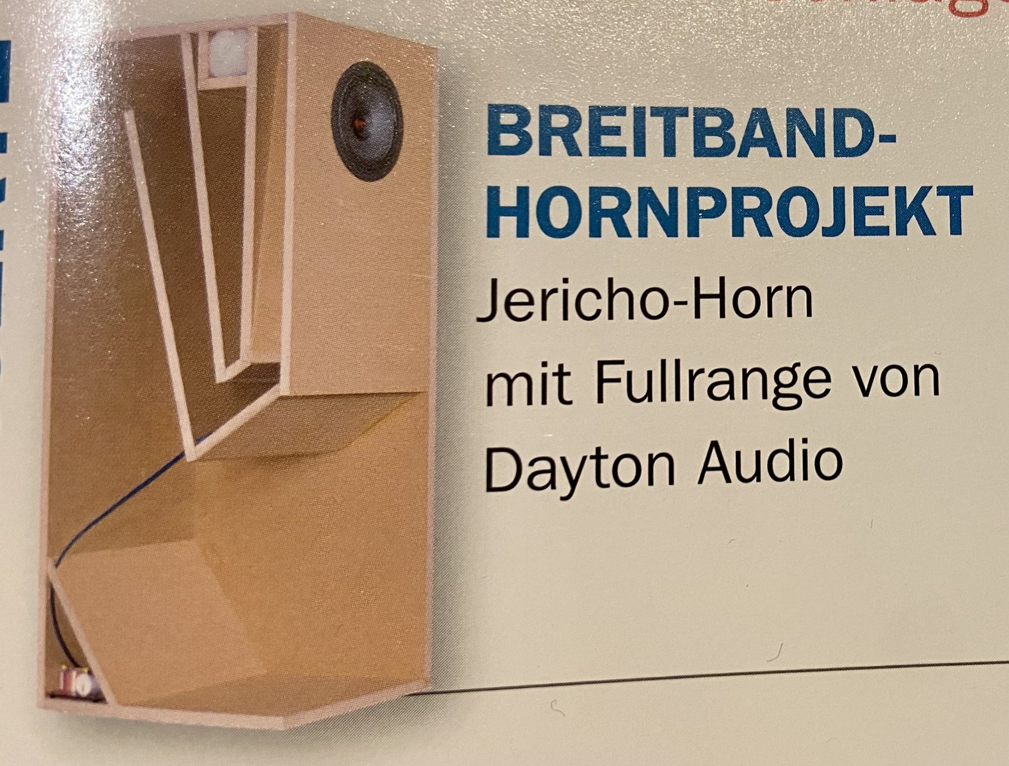

Interesting new Jericho 2023 using Dayton
I remember that closed box with 25cm system sounded OK but bass reflex ending too into the compression chamber of the Mauhorn with some added liters really gave the kick***
You had the impression that it can play unlimited loud

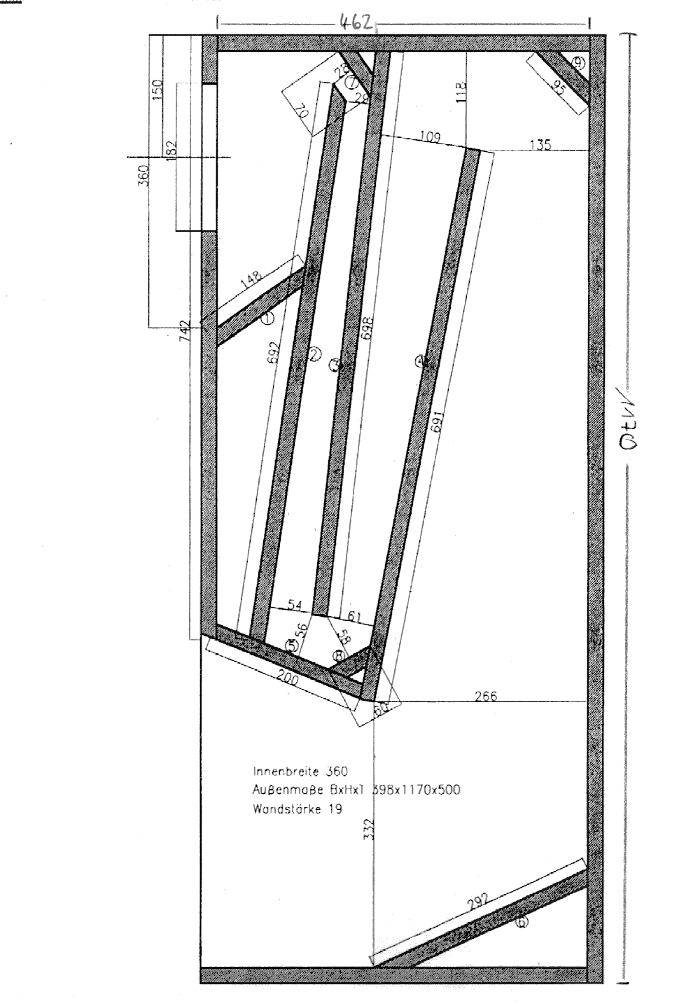

I have the drawings but many with measurements are not marked. Angles and lenth of inner baffles are shown. I will draw it in full scale and then measure it. I will then divide the 5 sections of the horn into 4. I also have to change the layout a bit to accomodate a 16 cm diameter magnet.
So I should make an "offset driver horn" in the wizard, add a chamber and then I am all set to simulate?
Reactions: woodo
Parallel sides with board dividers = parabolic.
Using the hypex approximation, and changing from exponential to parabolic, increases the volume substantially, by about 30 litres. If it were possible to put accurate dimensions for the segments making up the 194cm L23, the difference might be reduced using all the 4 allowable sections. Even so, it is a fairly large box and not sure whether the resulting response will be worth the woodwork compared to a tapered TL or bass reflex. It would be great to hear from those that have one in their listening room 🙂
